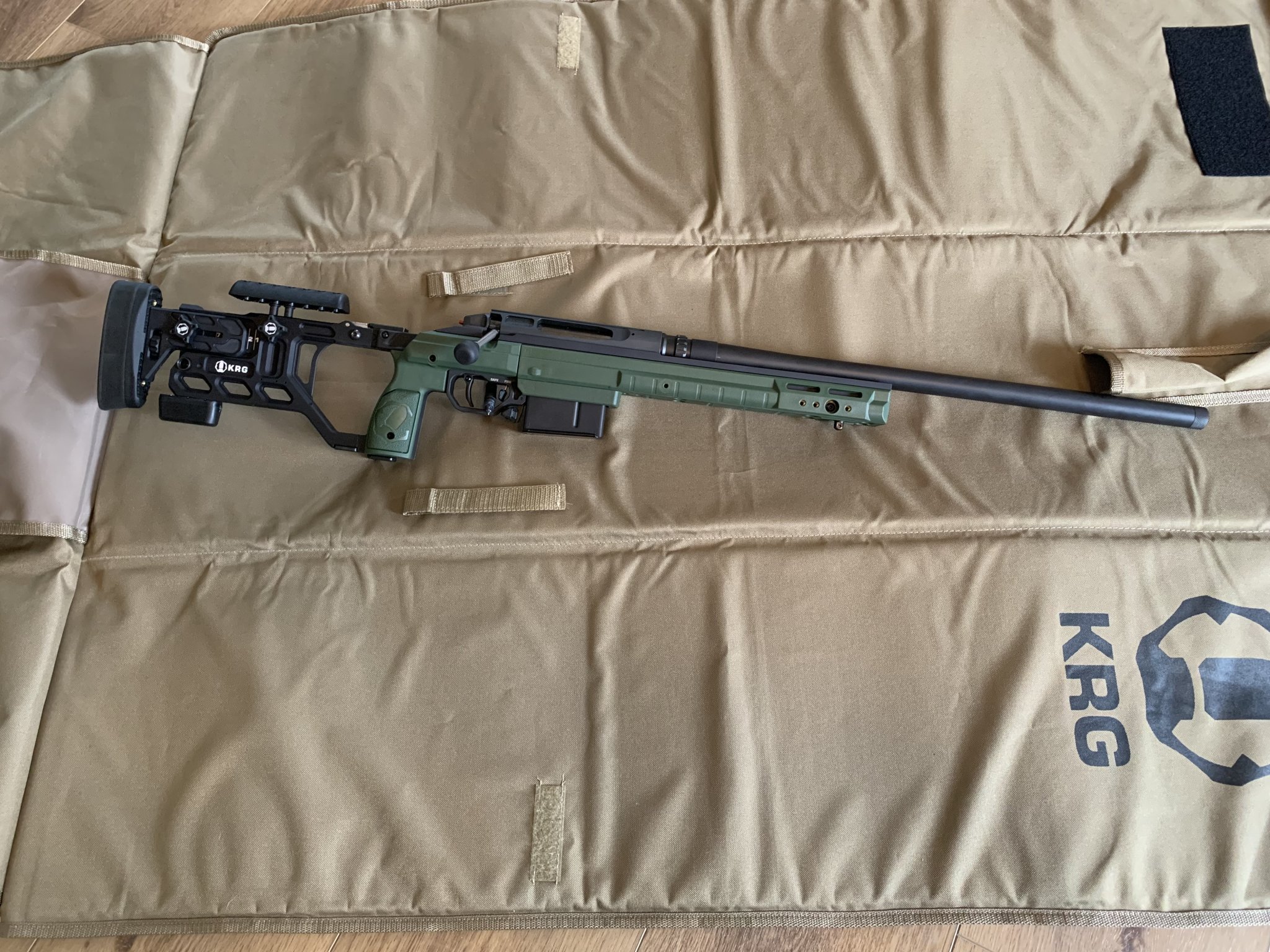

Bringing this thread back to life
Hell yeah, nice! I'm OCONUS for work at the moment, but I've got Southern Precision making me a 6 Creed barrel right now... 26" of Heavy Palma goodness. There is some life left in my original 6.5 Creed, so I'll hang onto it. It'll be a nice challenge to see if I can get back stateside, bolt it back together, zero it, and get it to TN for a training course in about a week. Hopefully it goes back together easier than it came apart ;-).

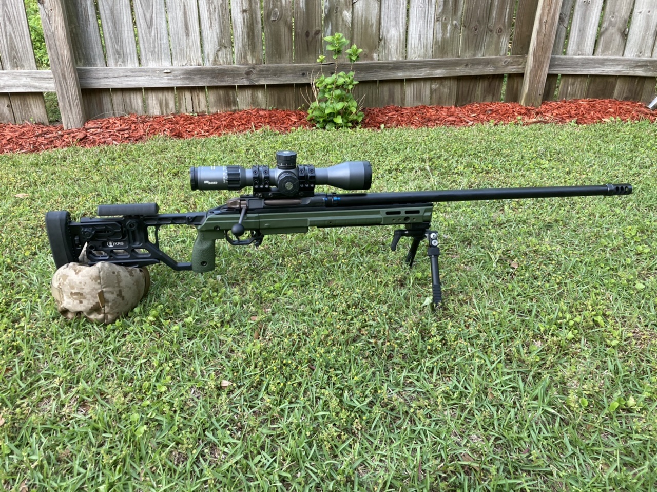

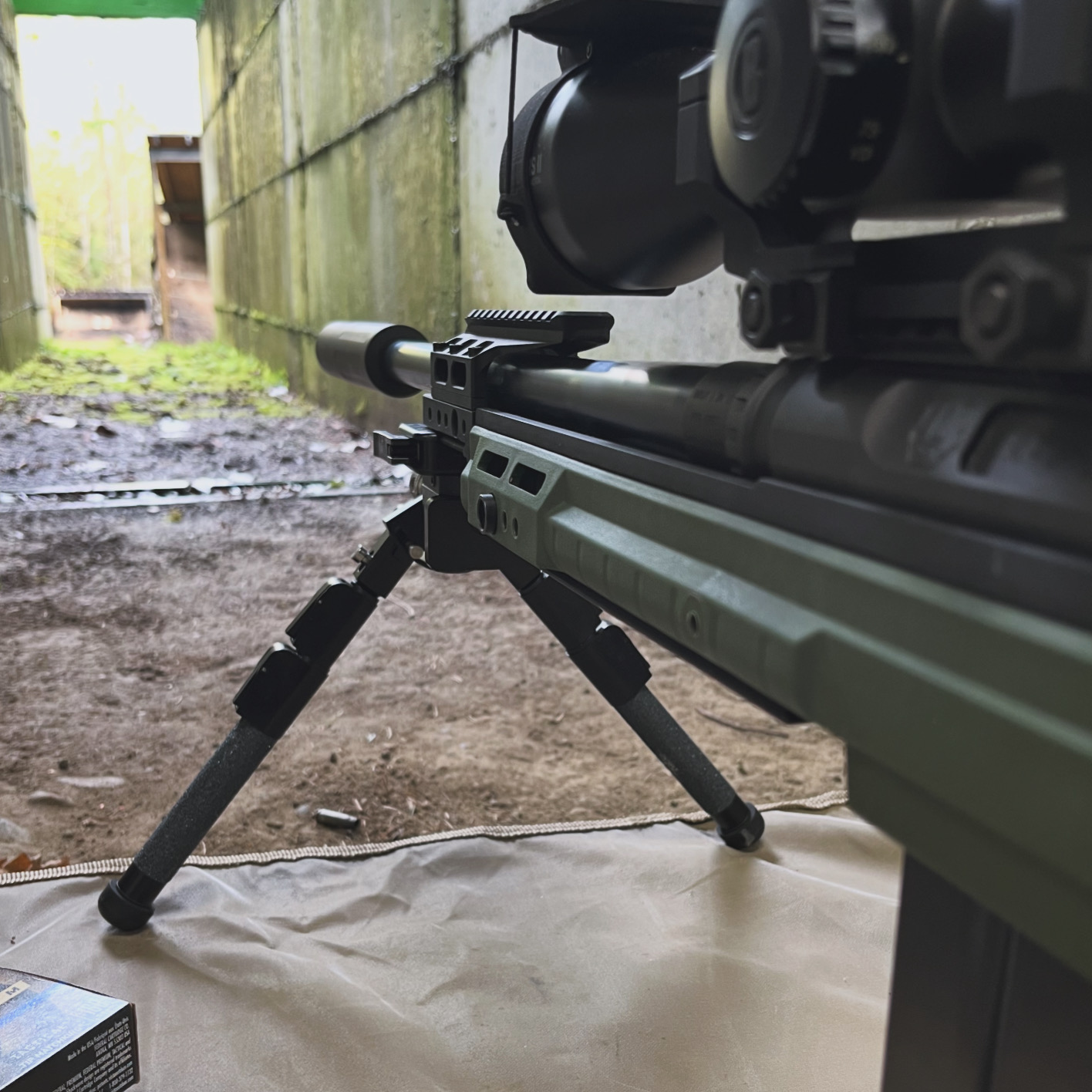

Well, here she is now. I did get her back together to go shoot my course at K&M. Still not a heavy gun by current standards, but A-OK from prone at least. The dudes at SPR are super modest - there’s not an identifying mark anywhere on this stick.
The W-3 back end is back on - I’ve made piece with it; it has a better pistol grip and trigger reach for my hand.
Best thing I can say for the rifle is that at no point during my shooting was I thinking about the gun… nor did it give me any issues. Gonna miss it when I PCS.

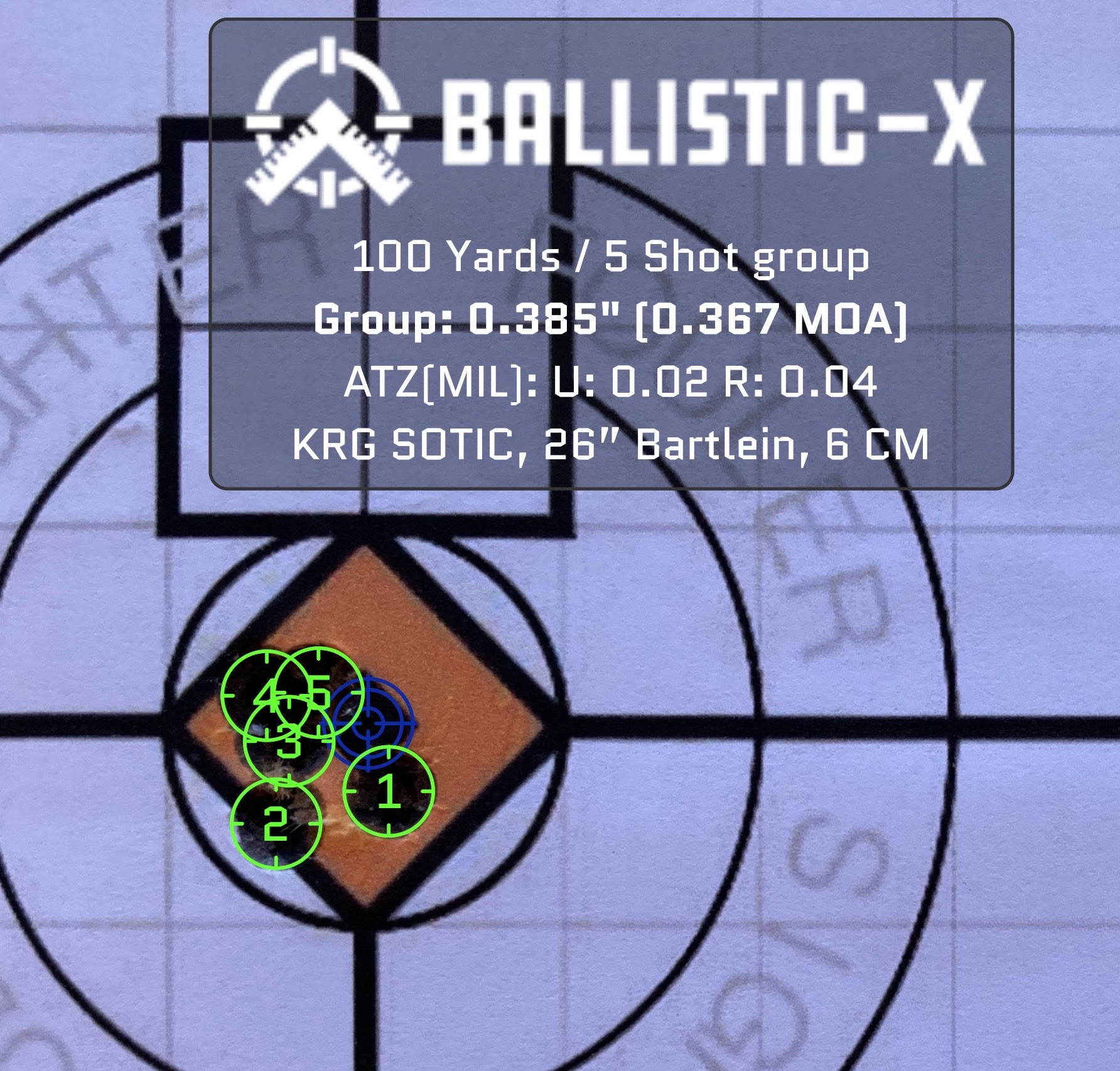

Misc note - the factory ELD-M ran a sedate 2940 fps from this rifle (79 RDS down the tube) and the 4DOF prediction was right on to 1000. To use any other solver I had to bump the G7 to .275 versus .270. One of my best moments at the course was shooting at 800 (for DOPE) and the instructor had me move off the IPSC onto the 8” circle because the rifle was that tight… and I punched it about two inches left of center in a light wind and put a second within a hand’s width.

Did you flame-anneal that barrel nut? Looks cool!
What barrel is that, did you get one spun up and who made it for you if so?
Southern Precision Rifles (“Bugholes”) made it for me, very quick turn, off a Bartlein Heavy Palma blank they had in stock. They were quite good to deal with and didn’t leave a single identifying mark anywhere - quite the modest bunch. I would have just ordered another barrel from KRG if 26” 6CM had been an option. Can’t say I’m displeased ;-).
That group was some 105 Berger Hybrids I got from… somewhere, loaded by Spark Munitions (in Petersen SRP brass… smoking deal considering the loaded ammo cost me less than the components would have).
