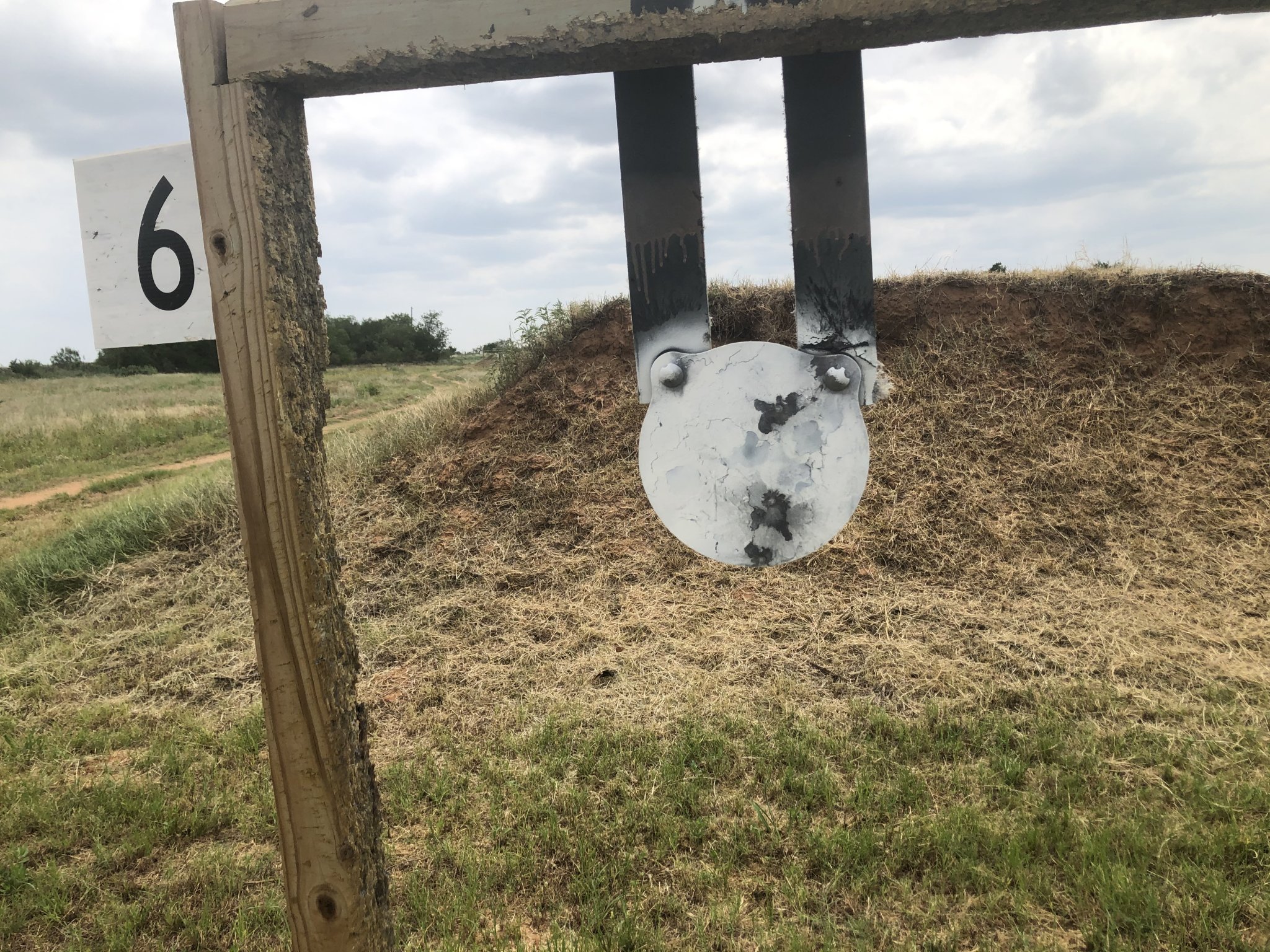

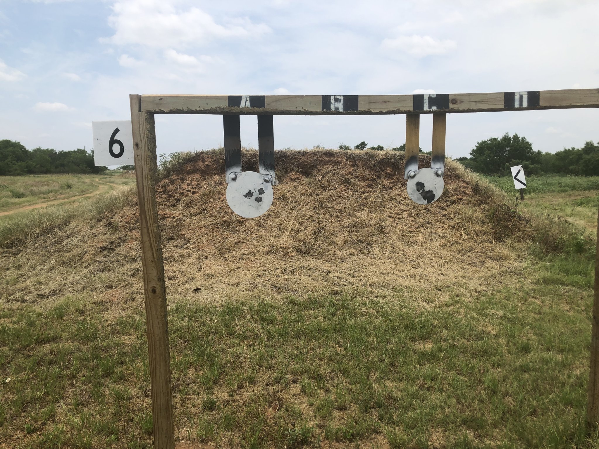

Man, this thread makes me feel like a chatty Cathy. I went out to the RSC here on FBGA today - 417", ~60F, 29% hum, don't remember the baro.
My absolute worst group of the day was 2.5 inches at 300 yards and included a .1 mil adjustment after the first shot (because I forgot) and a ~.1 mil hold for wind (that I ought not have bothered with).
My first group of the day included my cold (and, I think, clean) bore shot and was ~.55" @ 100 yards (American Gunner 140 BHTP) and my second was ~.54" (ELD-M 147). Both shot to essentially the same POI - no effort to cool the rifle between shots or groups. Honestly, that's a reflection of me and not the rifle. I've known from the beginning that I'm holding the rifle back and not the other way around. At least the magic continues.
I struggled a bit at 300 yards. I fired two "massive" 1.7" (AG BTHP) and 2.2" (ELD-M) groups. I say massive because I suspect a competent shooter would've managed about half the above. The worst group of the day had 4 shots in 1.2 inches with a .1 mil adjustment...if I'd just held center for the 5th shot...

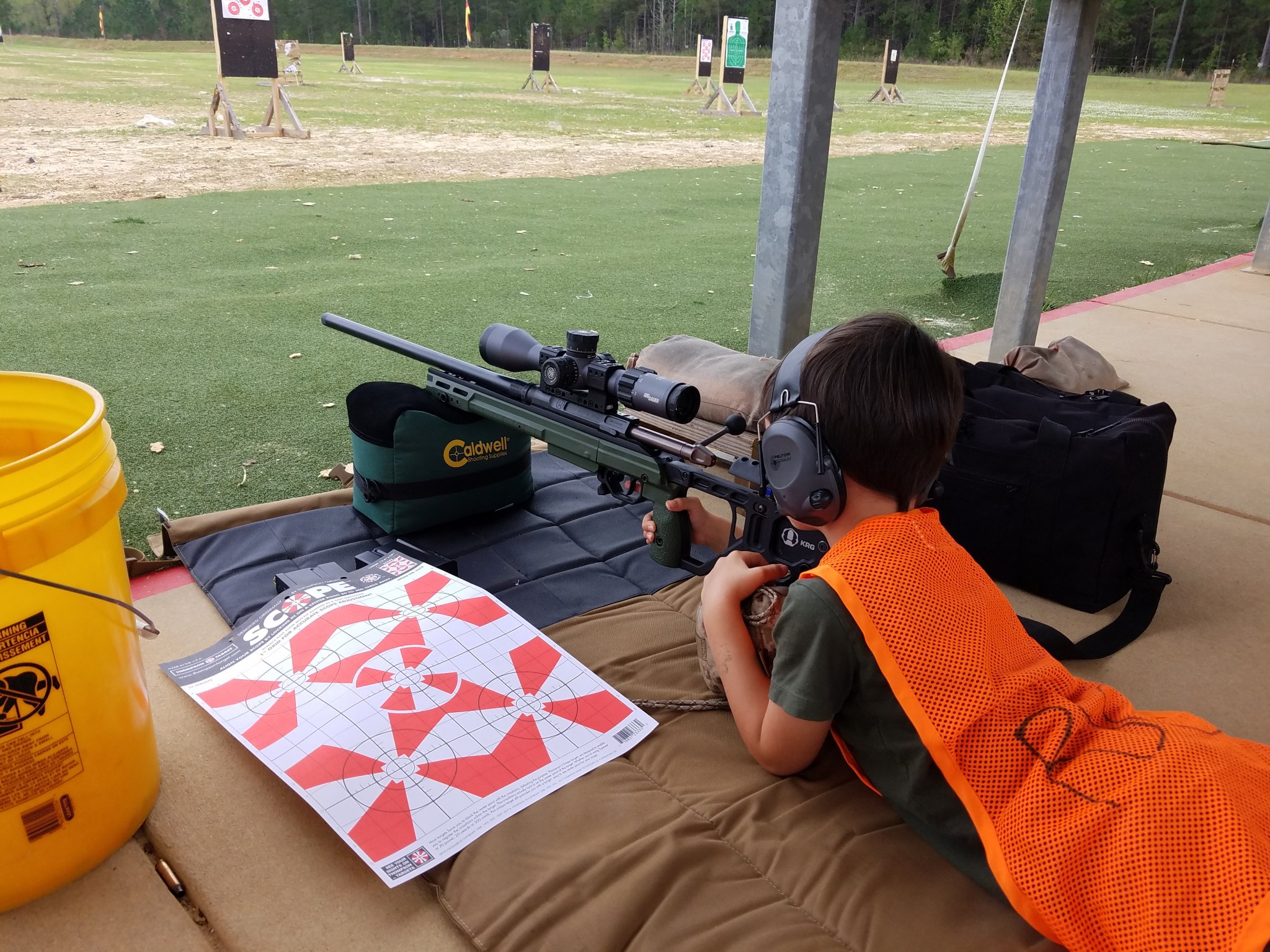

I'm glad to hear that I'm not the only one who has really young children shooting long range rifles. They will be SO spoiled with such nice equipment. My 10 and 12 yo load rifle rounds that are single digit SD and shoot 900 yards.
Yeah, my littlest is a quick study and LOVES dry fire after seeing his big brother and me. My oldest is slightly built - he's G2G when his technique is on point, otherwise he'll struggle. He can run it himself at the range now, so that's pretty cool.
It's been hard to find shooting buddies, so I'm trying to grow my own. I'm looking hard at a PH2 in 6CM or 6.5CM to that end.

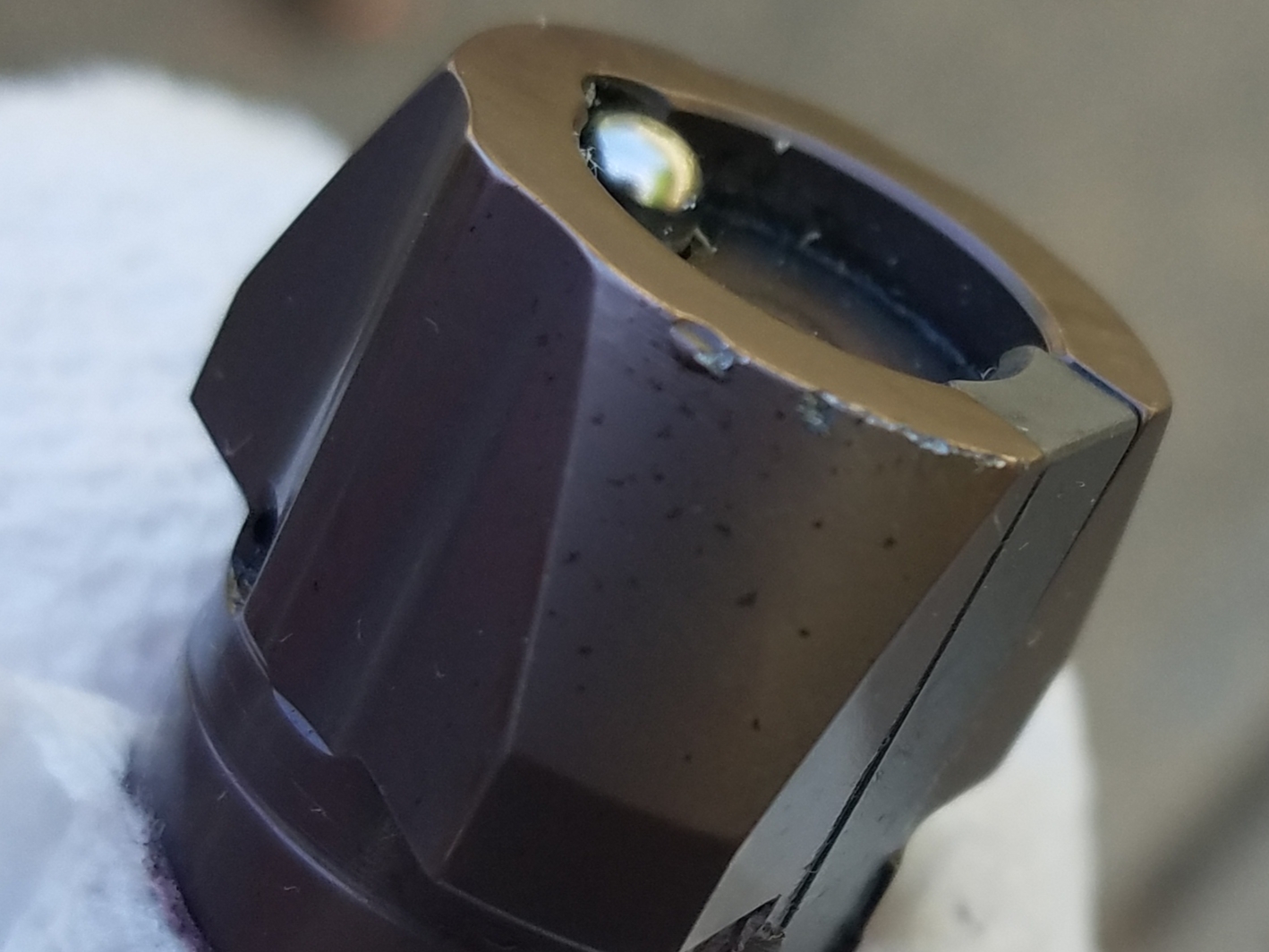

How to have bad day in one easy step:
1. Drop SOTIC bolt, lug first, onto concrete.

Yeah, I got out my Brownell's abrasive and lapping polishes. It's not jagged now, at least. It didn't seem to create deformation forward, so my hope is no real impact on engagement/alignment.

You could just remove the high spots with a file and then lightly buff the immediate area with some emery cloth and you will never know it is there. Seriously not a big deal, completely cosmetic.

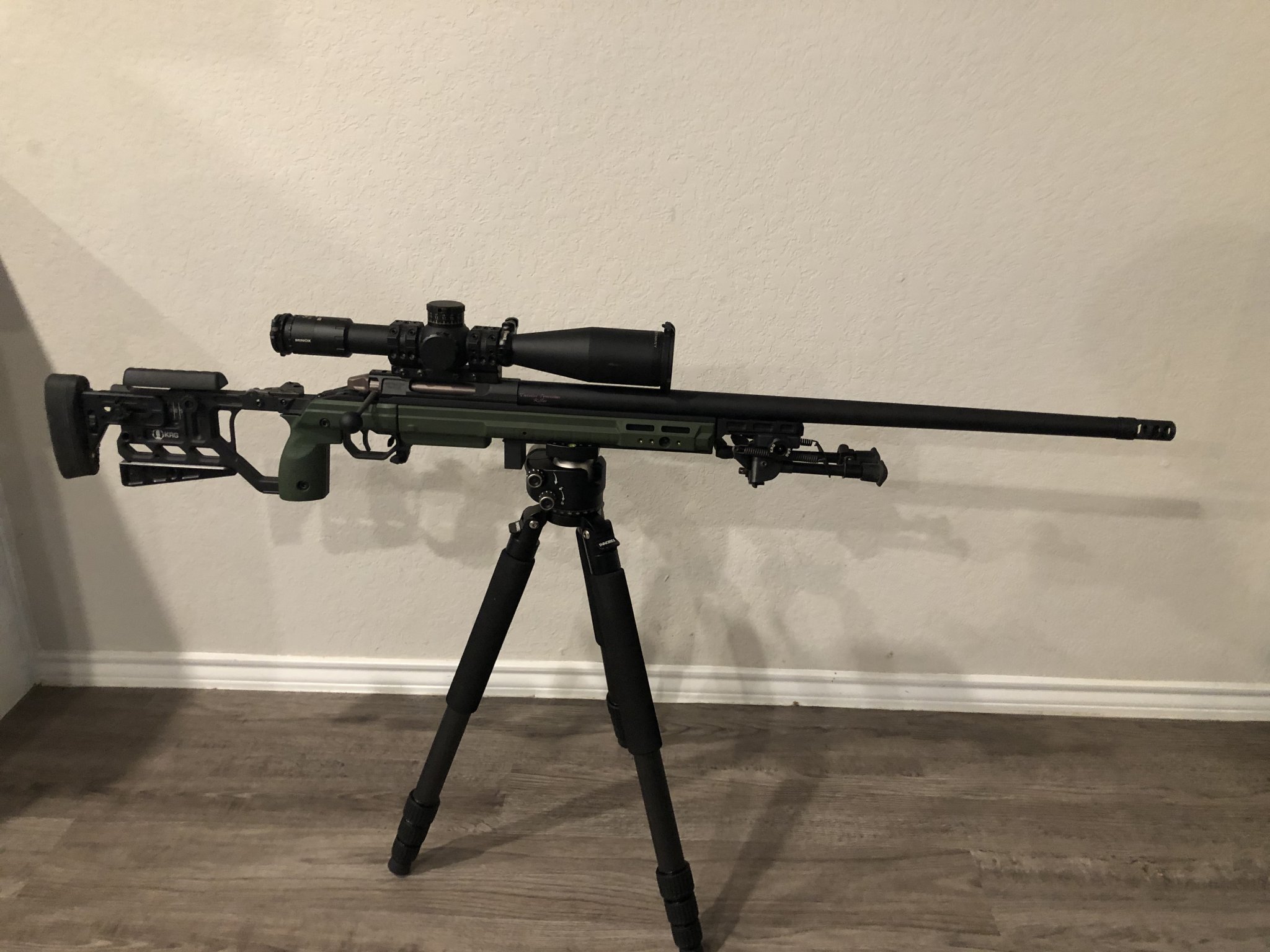

Pics with the bravo back end please.

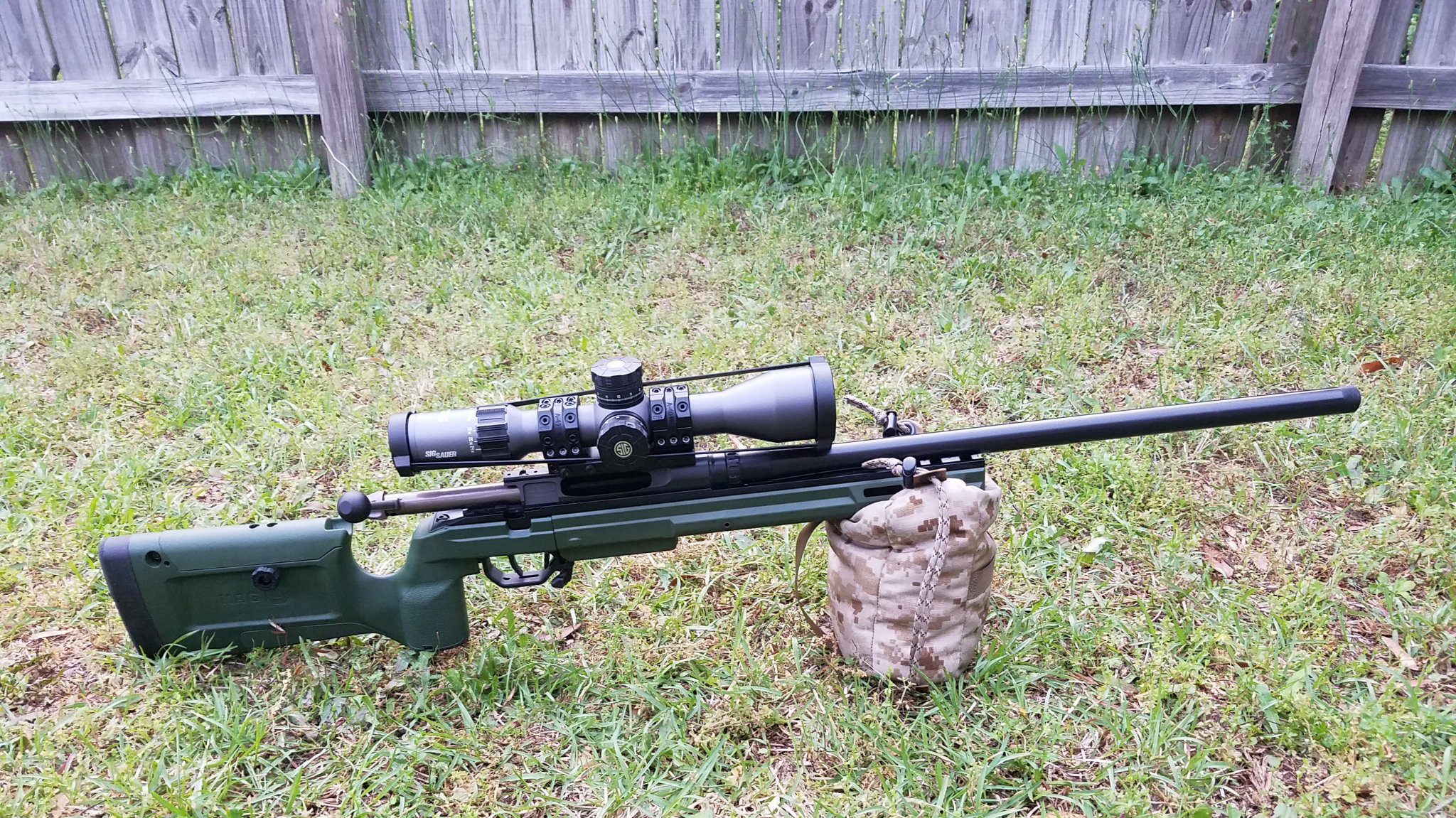

I'm not much of a glamor shot guy, but...
ETA: my oldest working on "spotting" for me... I'm not sure that's helping my groups. :ROFLMAO:

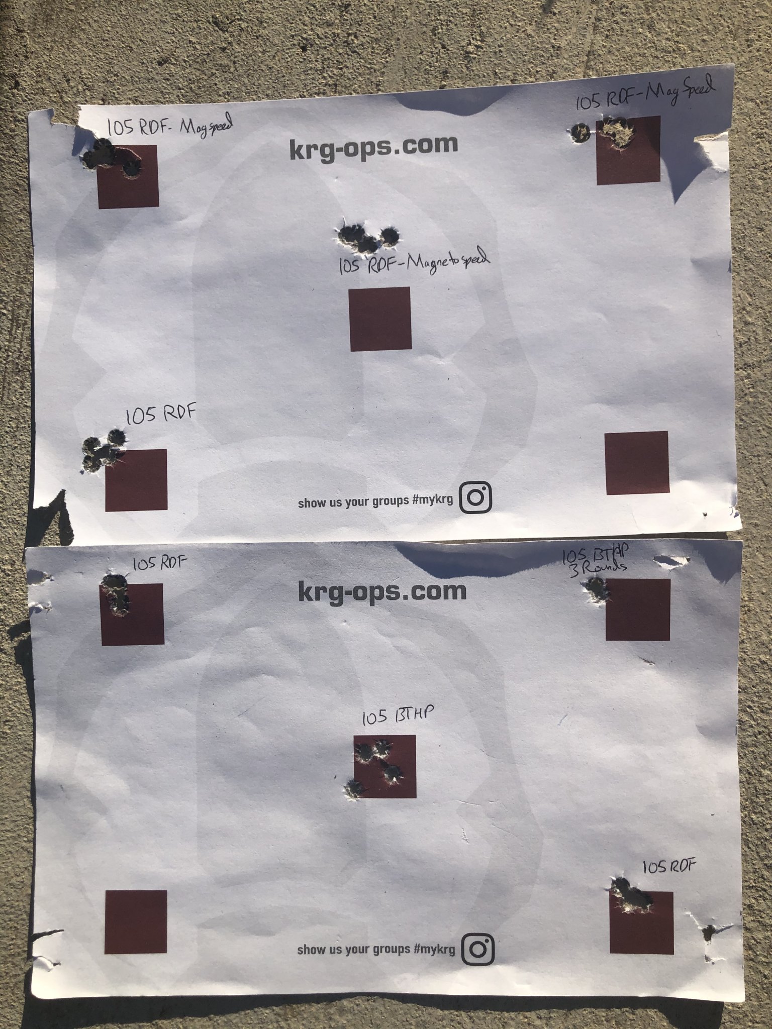

Well got it out to the range to do some fireforming, these 105gr rdf bullets really aren’t bad. Walked it out on my dope and it matched the velocity perfect. But together a 5 round group on a 1 moa and 3 round group on 2 moa targets at 600 yards laying on the culvert pipe. Then shot the 2 moa target again standing with the tripod and put a good 5 round group on the 2 moa target at 600 yards, the upper shot was the last and pulled. Overall the gun runs awesome with br cartridges, the only issue I had was when I inserted the magazine with my chamber flag still in. Every time I inserted the mag before removing my chamber flag, I would have issues with the bolt locking up. I never looked into seeing where and just tapped the bottom of the mag and it would start running again. Looking back I wish I had trouble shot it instead of just clearing and moving forward. The gun is a blast on barricades, way way less movement than my 6.5 creed.

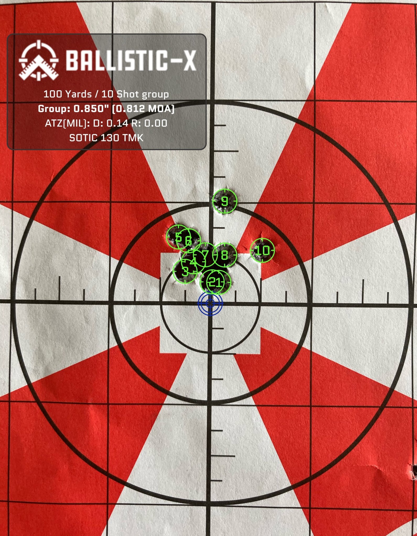

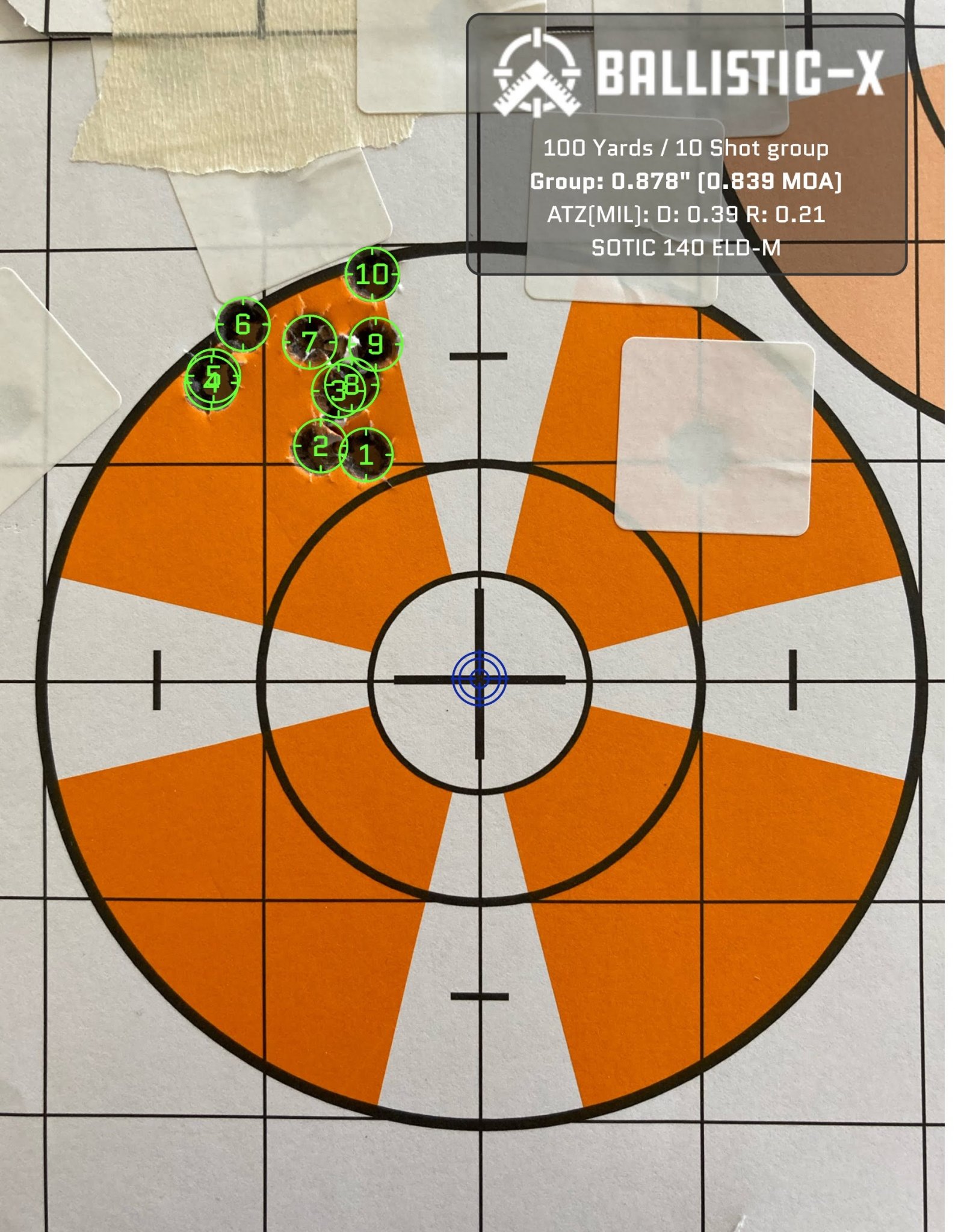

I wanted to post these to say that KRG did an first class job putting a rifle together that is truly sub-MOA. Not "it prints less than an inch for three/five shots when I do my part," it prints 10 shots into less than an inch even with me shooting it because it's just that good.
The SOTIC has been an awesome tool that has helped me identify my limits and weak points as a shooter (and a hand loader). The groups here were fired a couple months apart. The 130 TMK was my hand load that I used for the F-class match. The 140 ELD-M I fired today on a lark. I think the groups tell a somewhat unflattering story about my ability as a shooter, but you damn sure can't fault the rifle. Most folks, I think, would actually consider that pretty good for a rifle that weights about 13.5 lbs ready to shoot.
