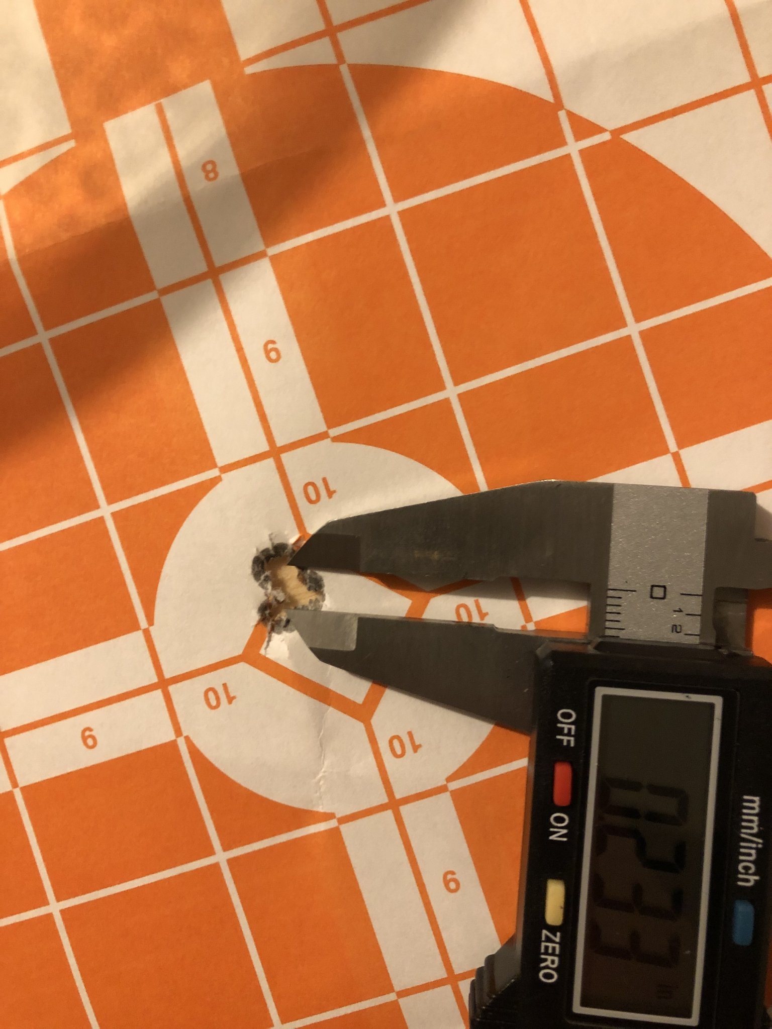

600 rounds
2730 FPS

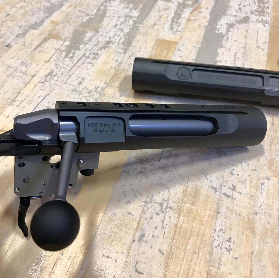

Quick update: added the arca spigot, lop weight, weighted angled bag rider, backbone weight, and weighted barrier stop. Really like the barrier stop if not for just carrying the rifle around. I fit it between my index finger and middle finger, and is balanced really well. Went to the range and am still shooting 140 eldm Hornady match ammo, yet to get my reloading bench setup. Shot many small 5 round groups but always threw the fifth one. I imagine it’s more of the drivers fault on the shooting, but the gun is starting to break in very very nicely. Hope to do some load development coming up.

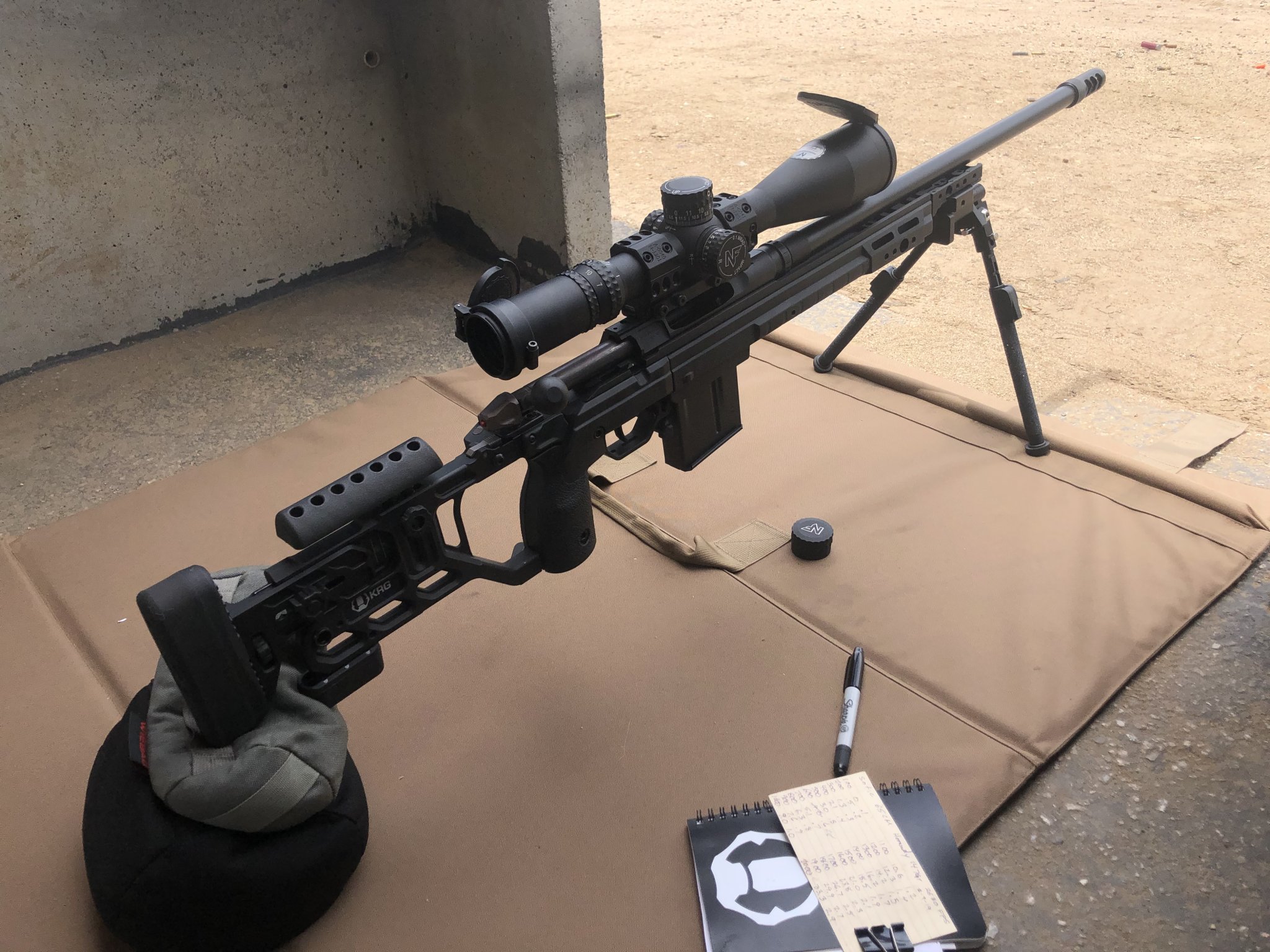

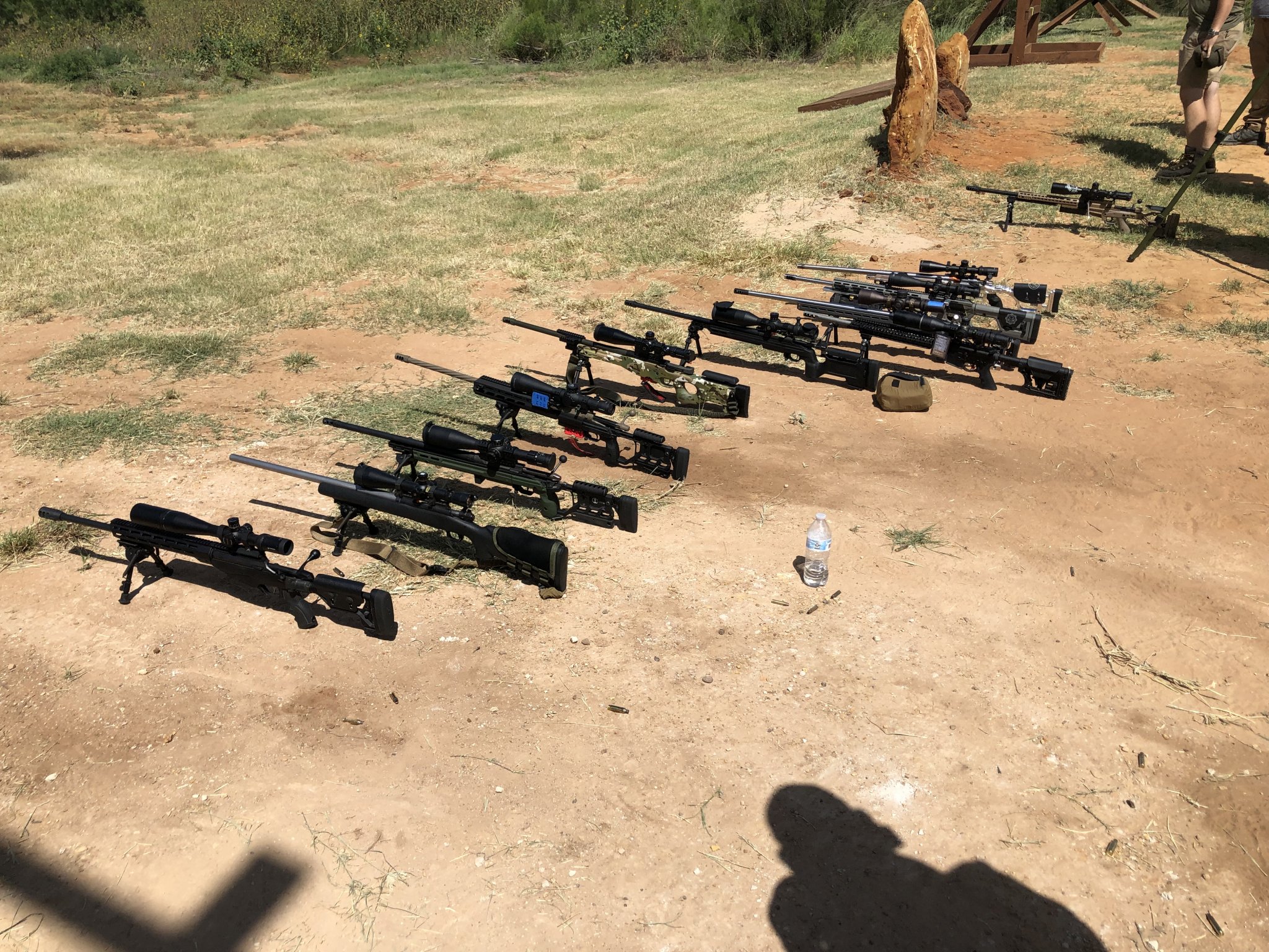

@Massoud a few sotic pics in the wild and another 5 shot group I put together with some factory 140 eldm.
Still finalizing some load development but so far looks pretty promising. Figured out what my issue with closing the bolt was, my extractor was very sharp and cutting into my brass rim. Took it out and sanded the edges smooth. Also opened up my mag feed lips to have the rounds sit a little higher, instantly noticed how much easier it is to run the bolt. Those two mods have made me like this gun soo much more, just wish I did it more justice at the match ?

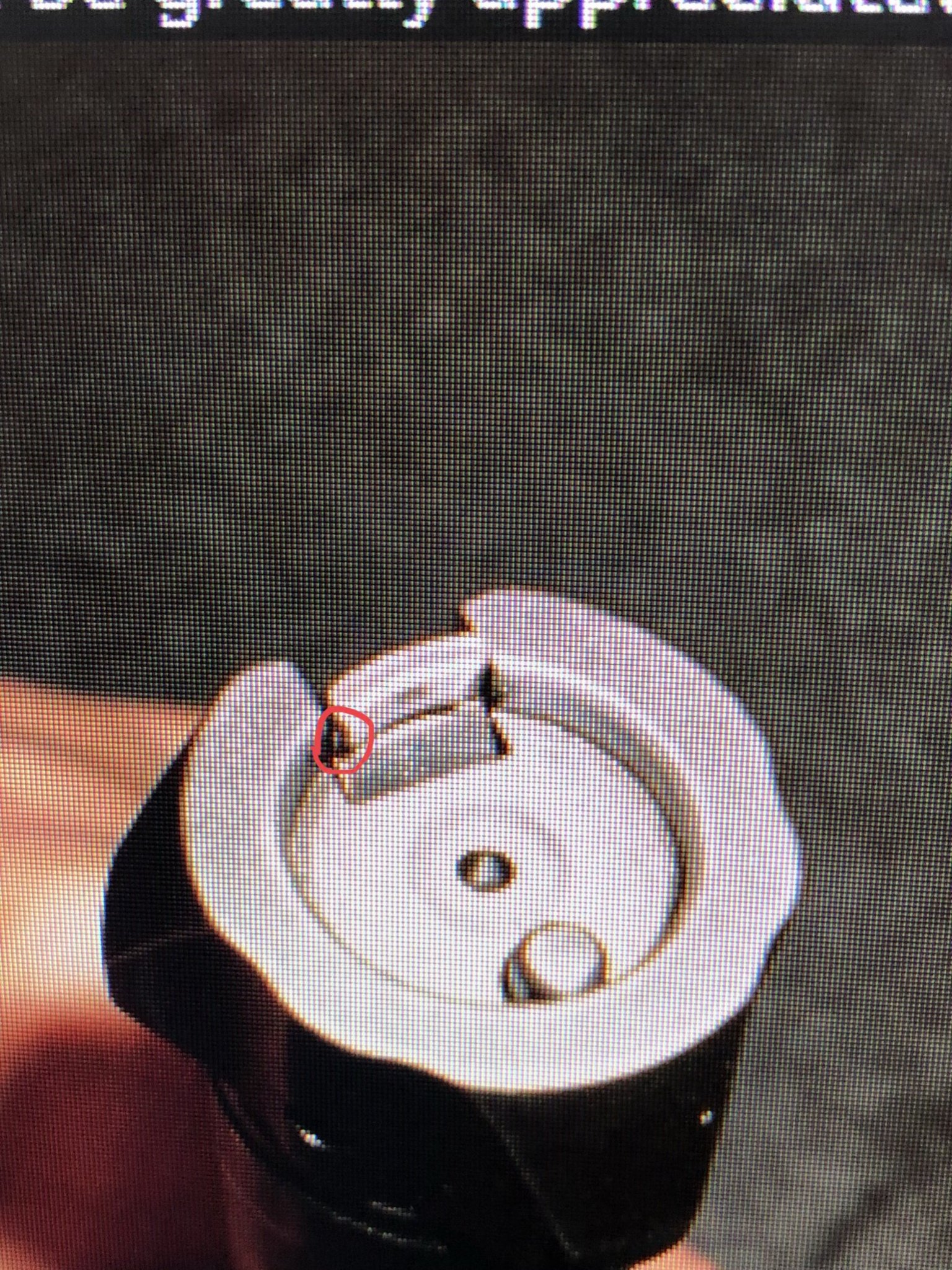

@never_summer would you mind posting a pic of where you smoothed out your extractor?
Mags are always a headache, with a bolt gun or a gas gun. We do recommend to take some fine sandpaper to the inside edge of the feedlips of a new mag and polish them up a bit or they dig into the brass. Then of course there's the tweaking of the feedlips which could improve/alter the feeding if needed as never_summer did.

I will have to wait to take some pictures, out at work. I'll attach some pics of a trg bolt redlined for reference. It was the leading edge and came to a sharp point. Noticed that whenever i had issues with running the bolt home, the brass would have a good gouge out of the rim and i was getting small brass shavings around the inside of the action and on the bolt. It only happened once at the very end of the day after the match, and a very good deal of dust/dirt had blown into the action by then. Signed up and gonna give mammoth a run with this gun.
@Massoud edited to add pic of bolt area

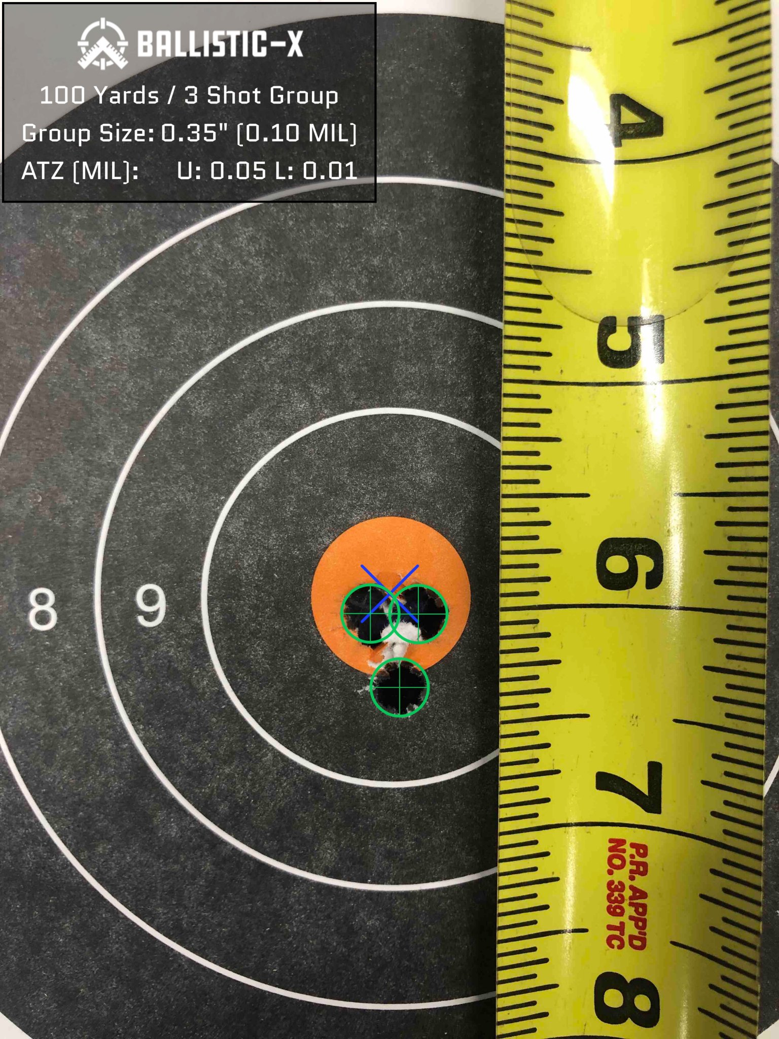

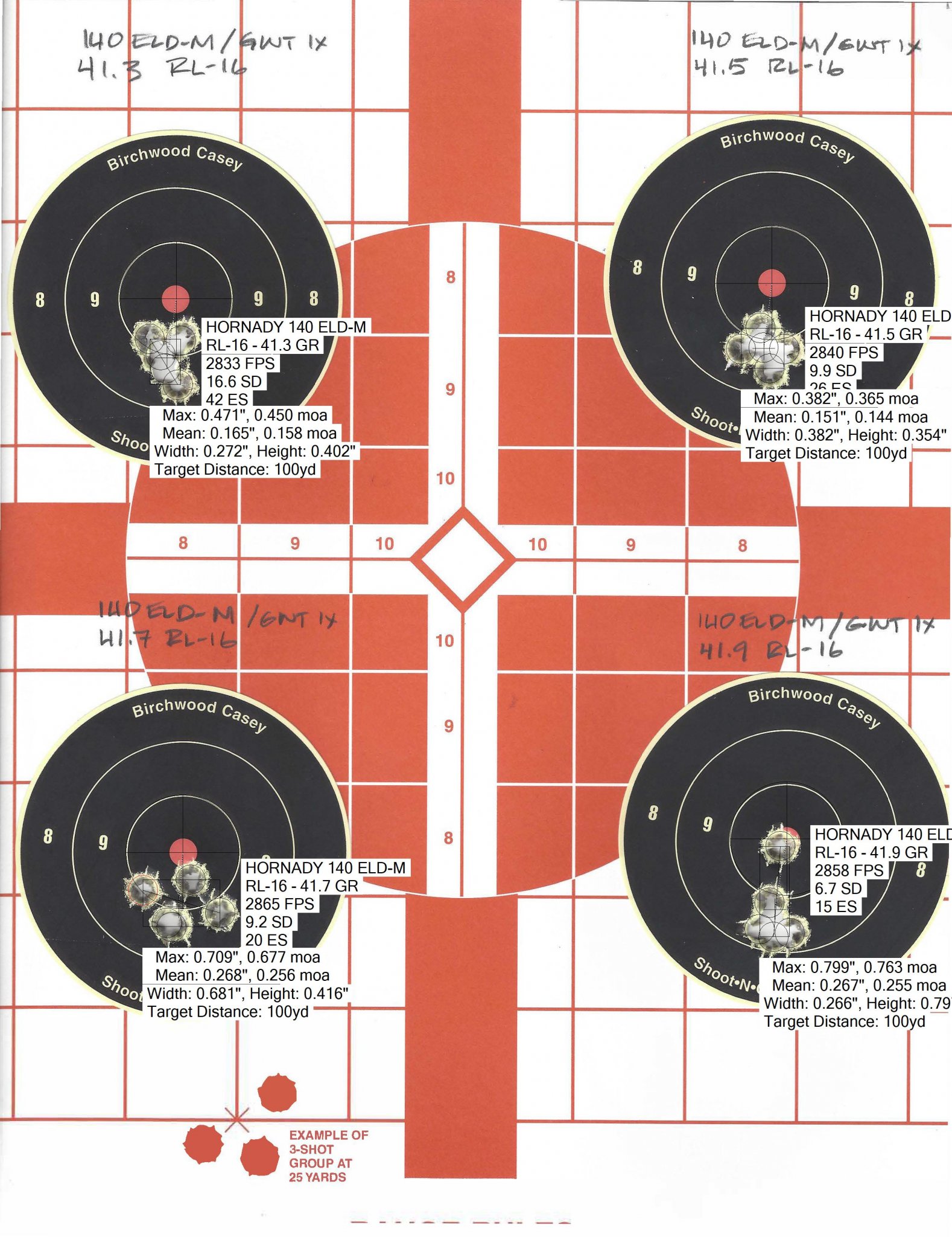

Dialing in my load on the SOTIC and it's showing promise. The bad groups I believe are a result of hideous mirage (my suppressor cover was at home) so couldn't get more than 5 shots before mirage made it almost impossible to see the target. That's what I'm telling myself. Cooled off barrel groups were sub-half which I'm happy with.
The Berger 140 VLD's are awesome and I'm about 50 thou off the lands.
41.1 of RL-16 in GWT brass which is super thick and has 3.5 gr. less volume than Hornady. Getting 2865 fps with no pressure.
By the way, I confirmed that the 26in Chanlynn barrel is indeed a Left-Twist rifling.
307 rounds down the tube.

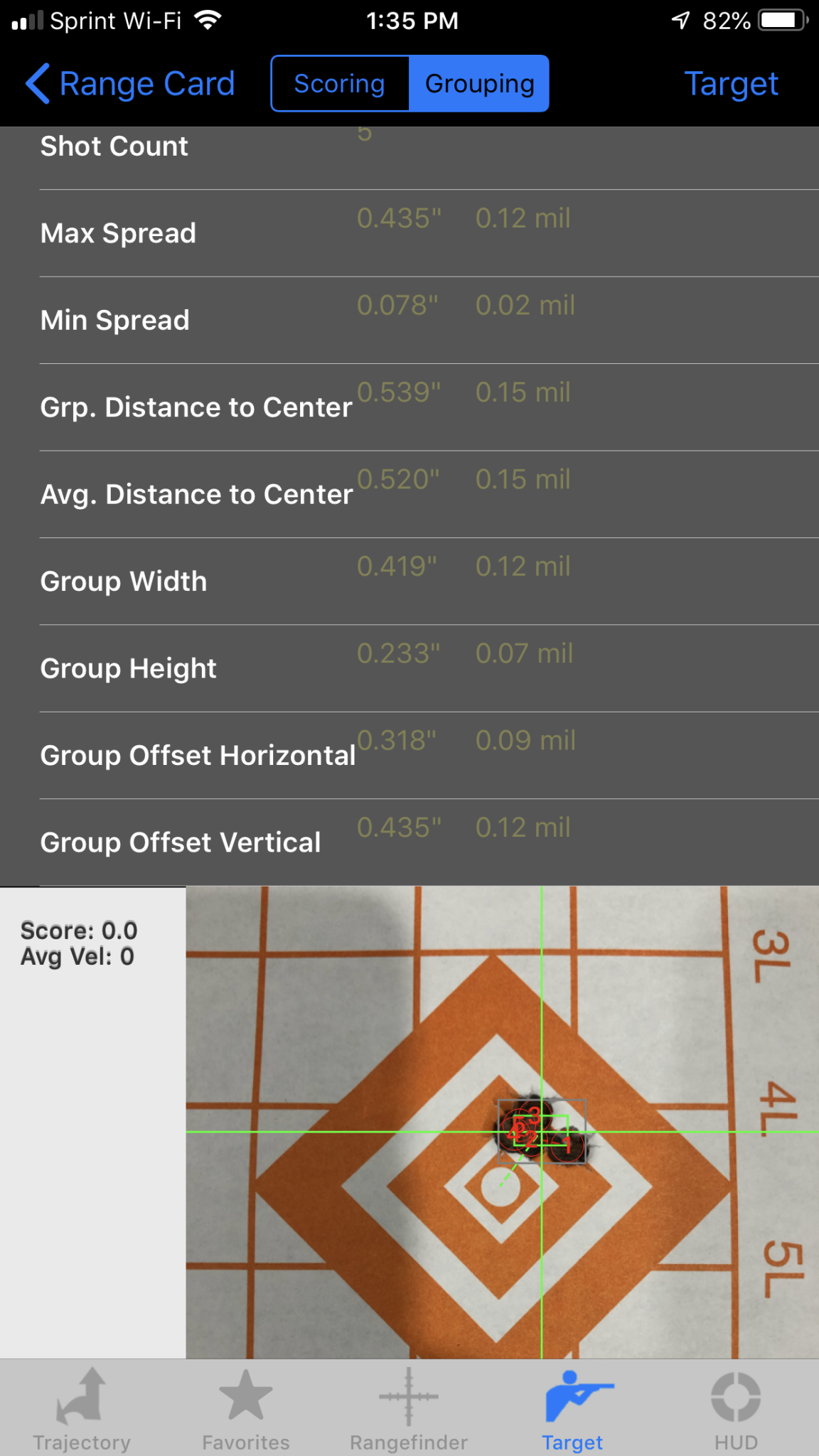

Got my load dialed in, pretty good es/sd just gotta see how it does at range. 5 shot group @Massoud
140 eldm .025 off the lands
41.4gr rl-16
Hornady brass
CCI br-2 primer

I tried that exact same load a few days ago and also got very good accuracy. However, velocity was a bit disappointing; 2670 fps from a 22" barrel. That's about 90 fps slower than my normal "go to" load of 42.2 grains of H4350. I was thinking of bumping it up another 1/2 grain and see how that does.
Did you happen to chronograph your load?
Nice shooting!
Yeah I ran 15 rounds over a magneto speed sporter after doing some groups with it. Had an sd=9 and es=18, but it was also ammo I loaded at 1am prior to a match I didn’t go to haha. I’d like to get it a little tighter, but my velocity avg = 2698 FPS.
I’m also on my fifth reloading of Hornady brass and everything looks to be holding up, so that’s one good thing about not running it hot.
