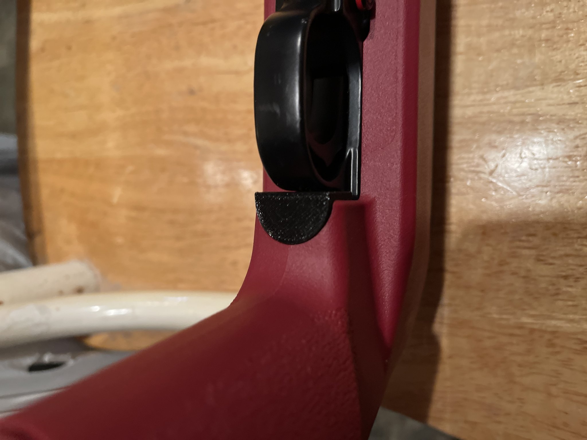

I made a plug on my 3D printer for the gap in the stock at the rear of the trigger guard. It’s more comfortable now.
