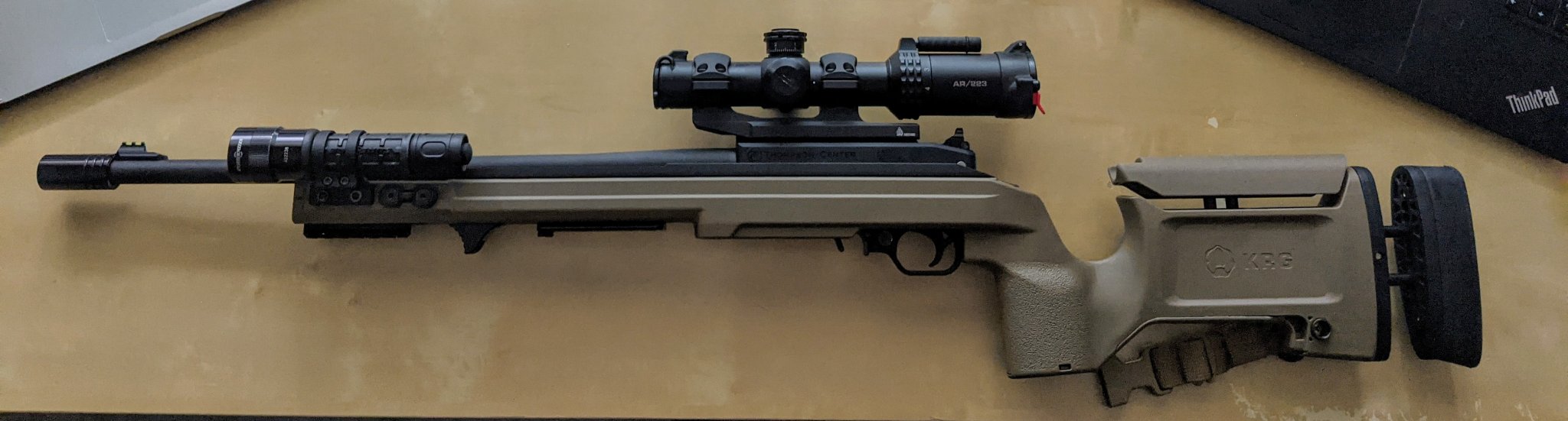

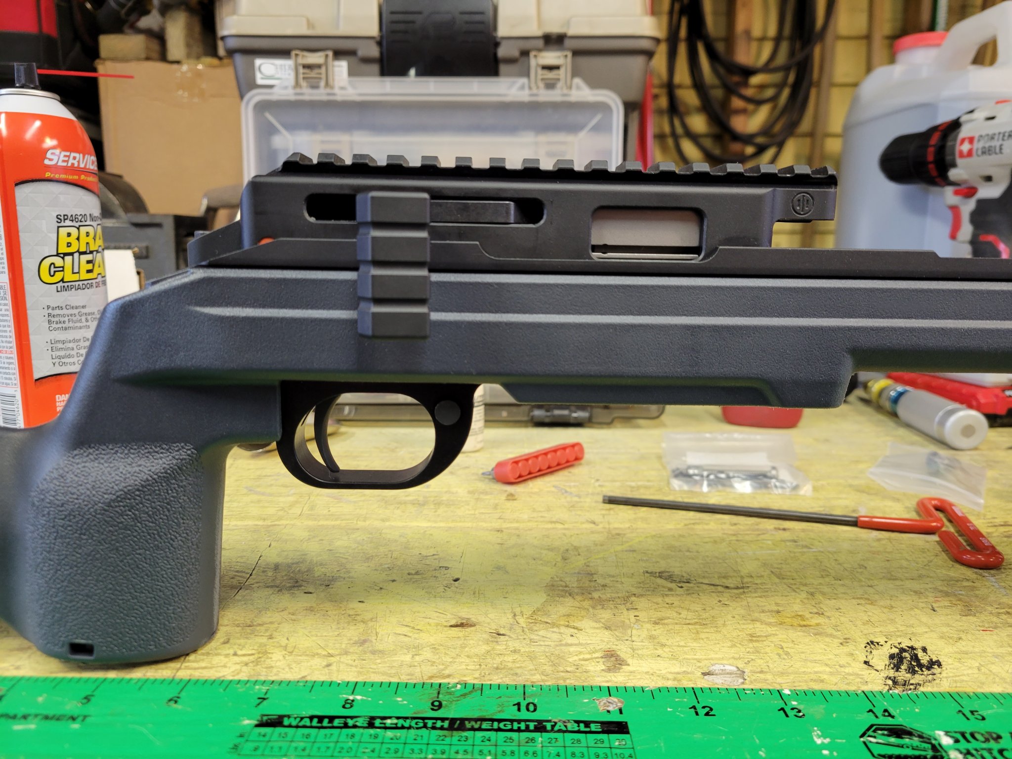

Here it is mocked up. I'll need to get a black buffer also yet, maybe.

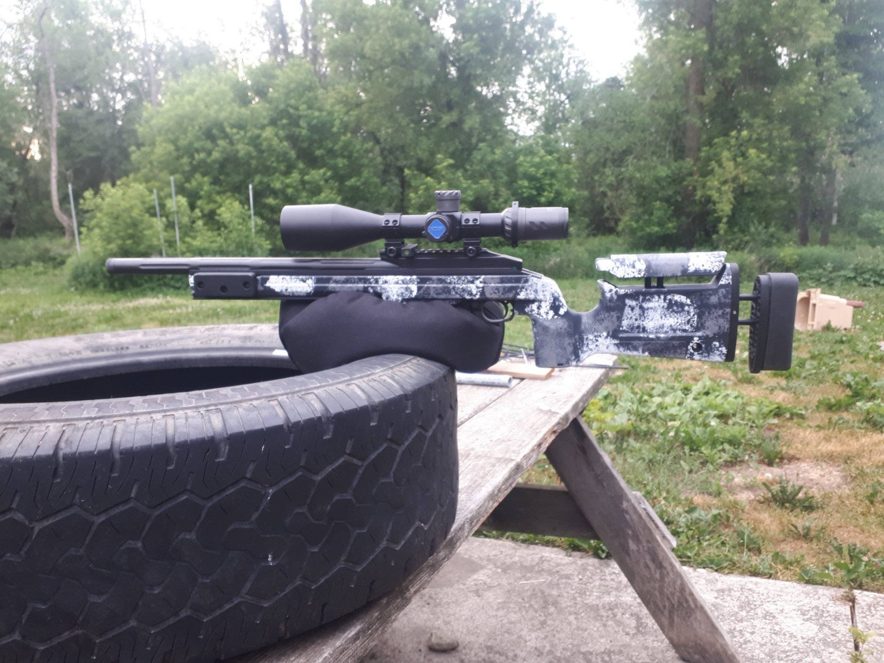

Finally had time to take it to the 50yd lanes to test and rezero... when the bx1 magazines didn't jam or have feed issue it felt good... used Remington Bucket of bullets =)

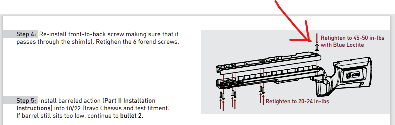

Question for people with the Kidd rear tang. What torque are you using for the tang to stock screw (rear action screw)? I've searched for hours online and not finding anything conclusive. I put mine together last night and have it currently at 20 in/lbs to match the front action screw.
KRG shows 45-50 in/lbs for their original screw in that location, but nothing mentioned if using the Kidd rear tang. And Kidd doesn't show anything either on their site. They also don't mention a torque spec for the receiver to tang screw, which I found a bit odd.

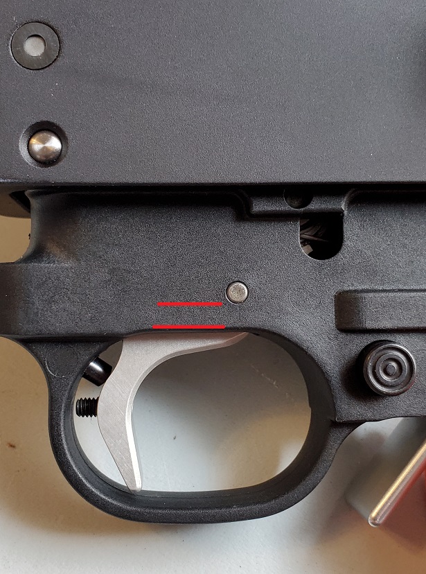

Maiden voyage on Saturday. After about 50 rounds the trigger began failing to reset. I assumed it was because of me using the lightest trigger return spring from the Kidd assortment. I manually reset the trigger each time and continued shooting. With the intent of changing that spring, I later found the trigger pin had backed out. Further research showed the area in the stock that should cover/retain the pin is about 0.145" tall and wasn't covering the pin on the sides, allowing it to walk out. I had the front action block flipped around with the "B" block on top, from a previous install of this stock using a TCR22 receiver instead of the current Kidd one. I flipped that back around and it allowed the trigger housing to go just a tad lower in the stock. If that doesn't resolve the issue, I'll just glue/epoxy a small plastic insert on each side inside the stock.
Maybe I need to remove the Kidd rear tang and see if that allows the trigger housing to sit even lower in the stock? Anyone else run into this? It's a factory Ruger trigger housing, FWIW.
Reactions: MackDaddy1962
Funnily enough I just had a very similar issue. Trigger was failing to reset. I tried to take it out of the stock to tape the pins and make sure it was all good, but the pin was caught a channel between the backbone and the stock. When trying to get it out it cracked the housing on the trigger. Thinking about it now, if I had unbolted the backbone I may have been able to get it out without it breaking. Pretty annoyed, but glad I only have a bx trigger and not a kidd.

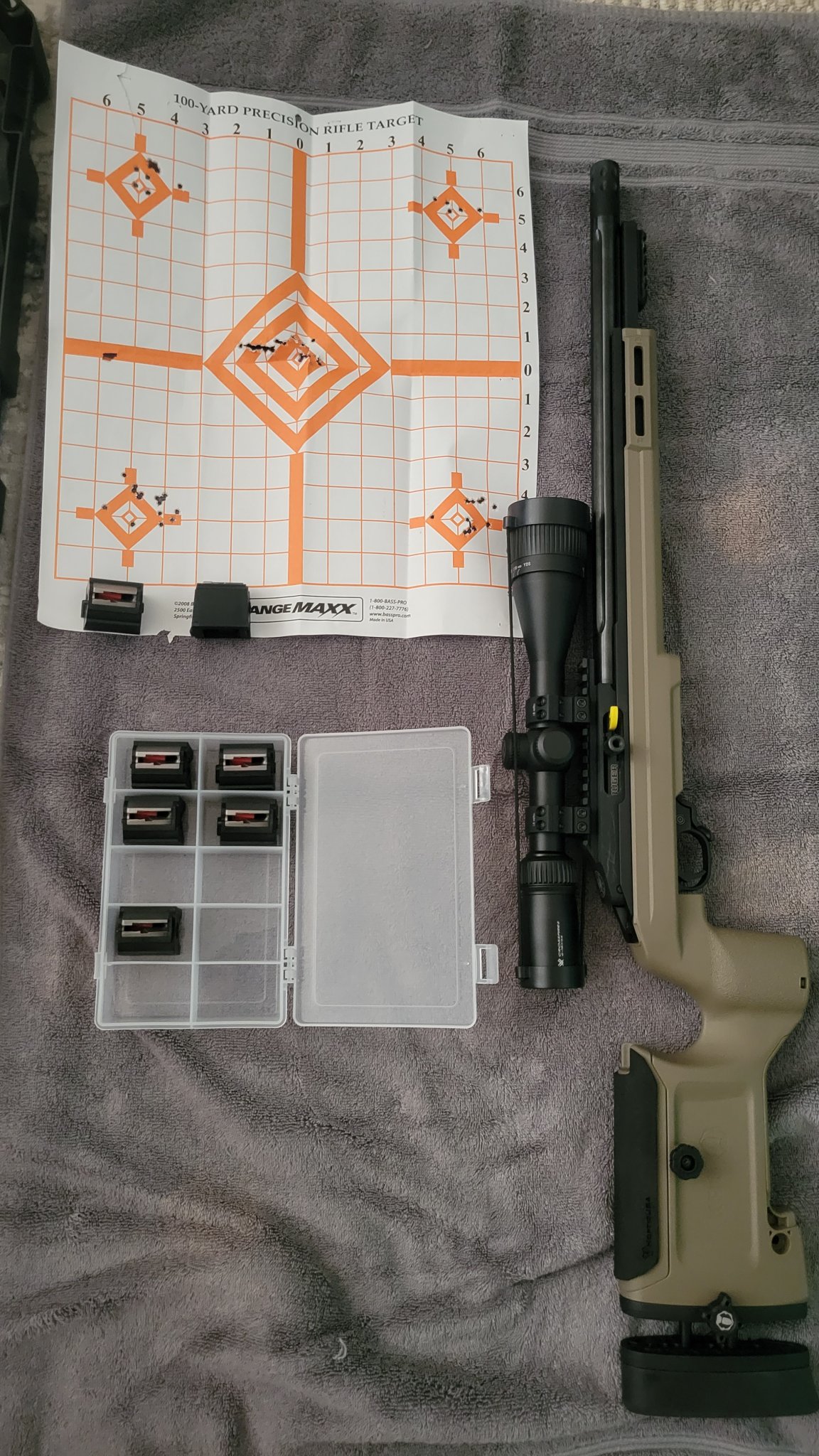

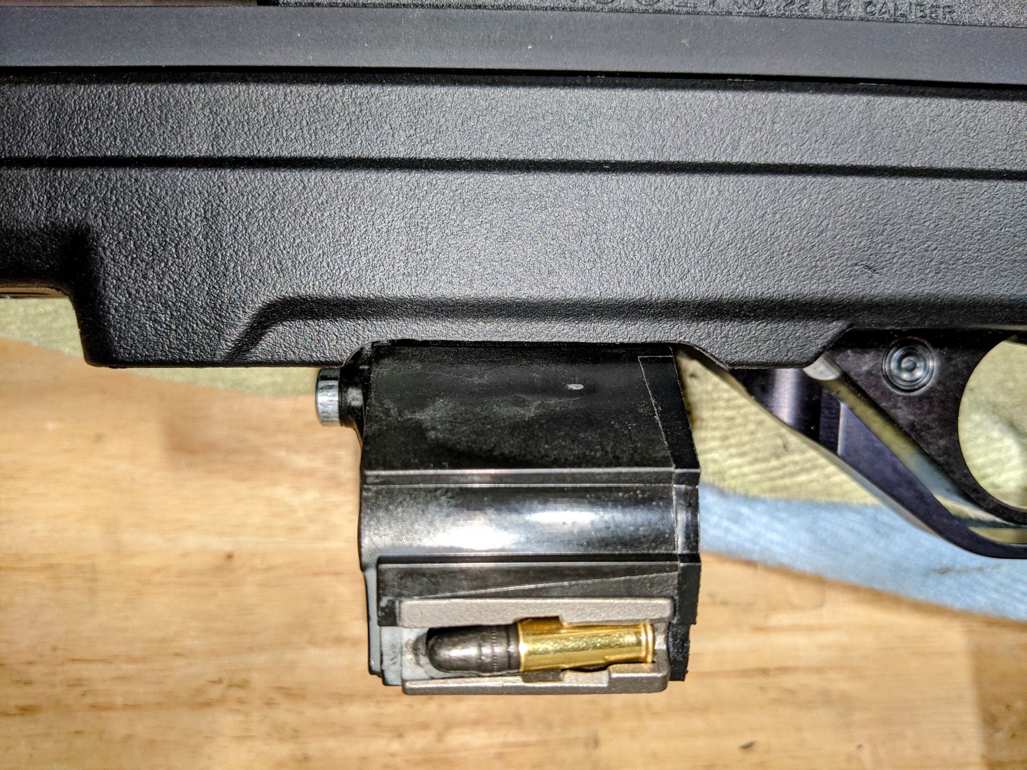

Got mine in today from Snyder thanks!! Reading thru the thread again looks like others are also having issues with their magazines not falling free. Can anyone comment on how to remedy this issue? I also have a few 10rd mags connected via alangator setup and the mags will not even seat properly. It looks like the magwell protrudes too far down and doesn't allow the mag to be fully seated.

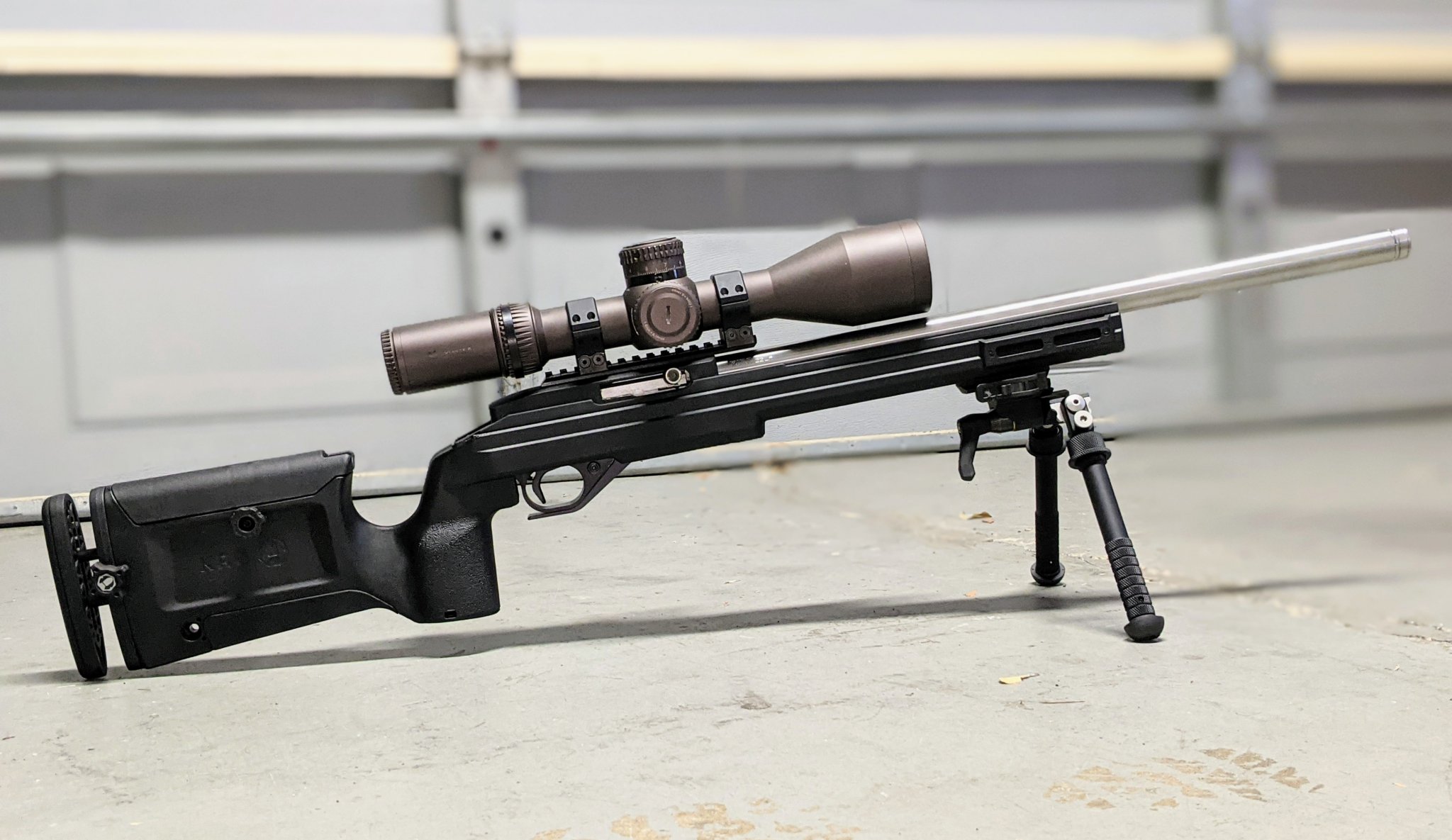

Oh and my obligatory pic:
I've got no issues with factory Ruger 10 round mags seating & dropping free. That's all I use. This is with both Kidd's classic slip-fit, and supergrade receivers.
My 10 round mags drop freely. I have a factory Ruger receiver.
Thanks guys. I de-coupled my mags and my individual 10rd mags also drop freely. It's the BX25s that won't. I also took a Dremel to walls of the magwell area to open it up and remove material so that it will now have space to accommodate and properly seat my tri-coupled 10-rd mags. Now to get out to the range!
