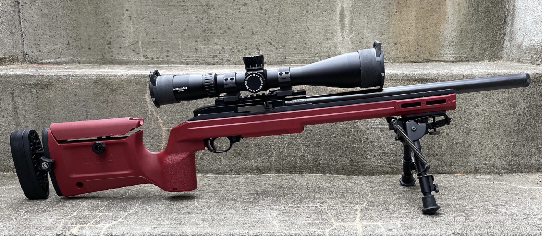

I just received my stock today. I put my rifle together using Brownells receiver and everything thing else Kidd. It dropped right in the stock. I was able to slide the folded instructions between the barrel and stock. I have the adjustable buttpad coming but I may need more shims. The LOP is really short.
Got mine all assembled and needed to add a personal touch. Knockoff manners style. I have a GRX recoil lug I may install and bed it later on. Guess we will do before and after groups.
Factory Ruger receiver
FJ Feddersen 18 in barrel
EGW 20MOA rail
Vortex strike eagle 5-25x56
Ruger BX trigger

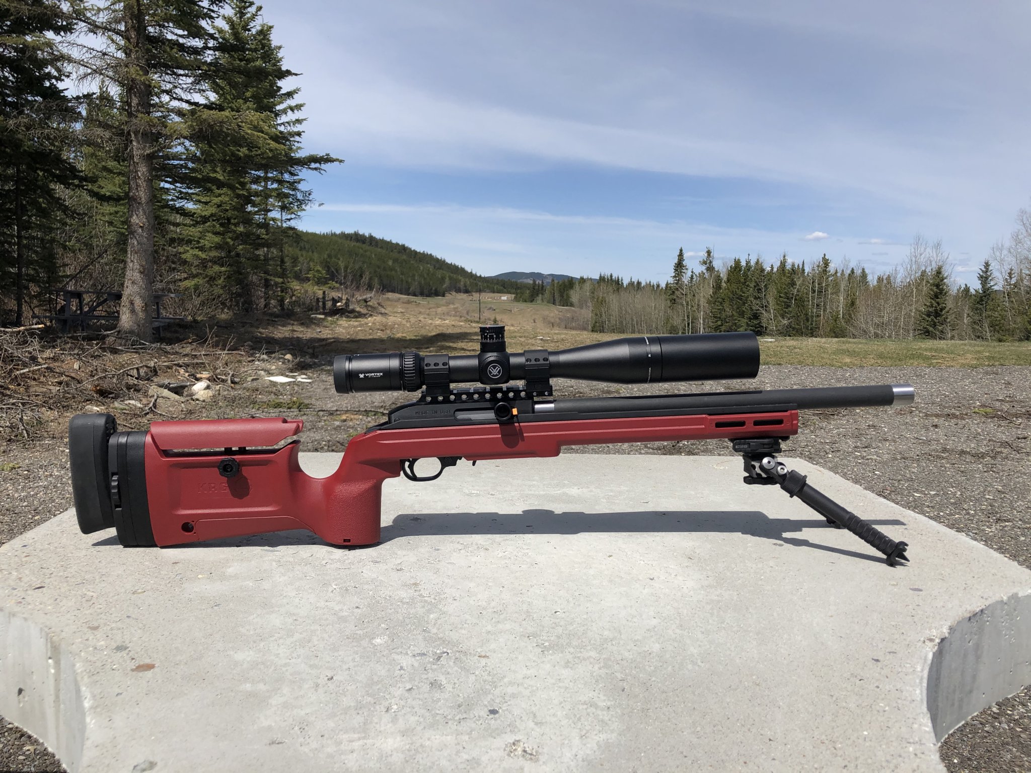

@jingle98 how is your setup shooting? I have a Feddersen 16.25" barrel in a Ruger receiver and am getting 5-6" groups at 50 yards with CCI SV. It looks like I am going to have to try bedding it or something.
Ruger receiver, Feddersen 16.25" stainless bull barrel threaded, brimstone trigger.
I had installed the thicker "B" plate from KRG so the barrel would fully float as well as the thicker shim for the rear of the action to tighten up the rear of the receiver. With that configuration, I was getting 5" + at 50 yards.
I removed the shim from the rear of the action and my groups are down to 2" at 50 yards with CCI SV.
I had this barreled action in a laminated stock before the Bravo and with the laminated stock, I was getting under 1" groups at 50 yards with the same lot of CCI SV.
Those with the Ruger receivers, what size groups are you getting with your Bravo?
Those with the Kidd receiver and the rear tang, what size groups are you getting?
Trying to figure out if I need to order a Kidd receiver with the rear tang to be able to get the Bravo to work well.

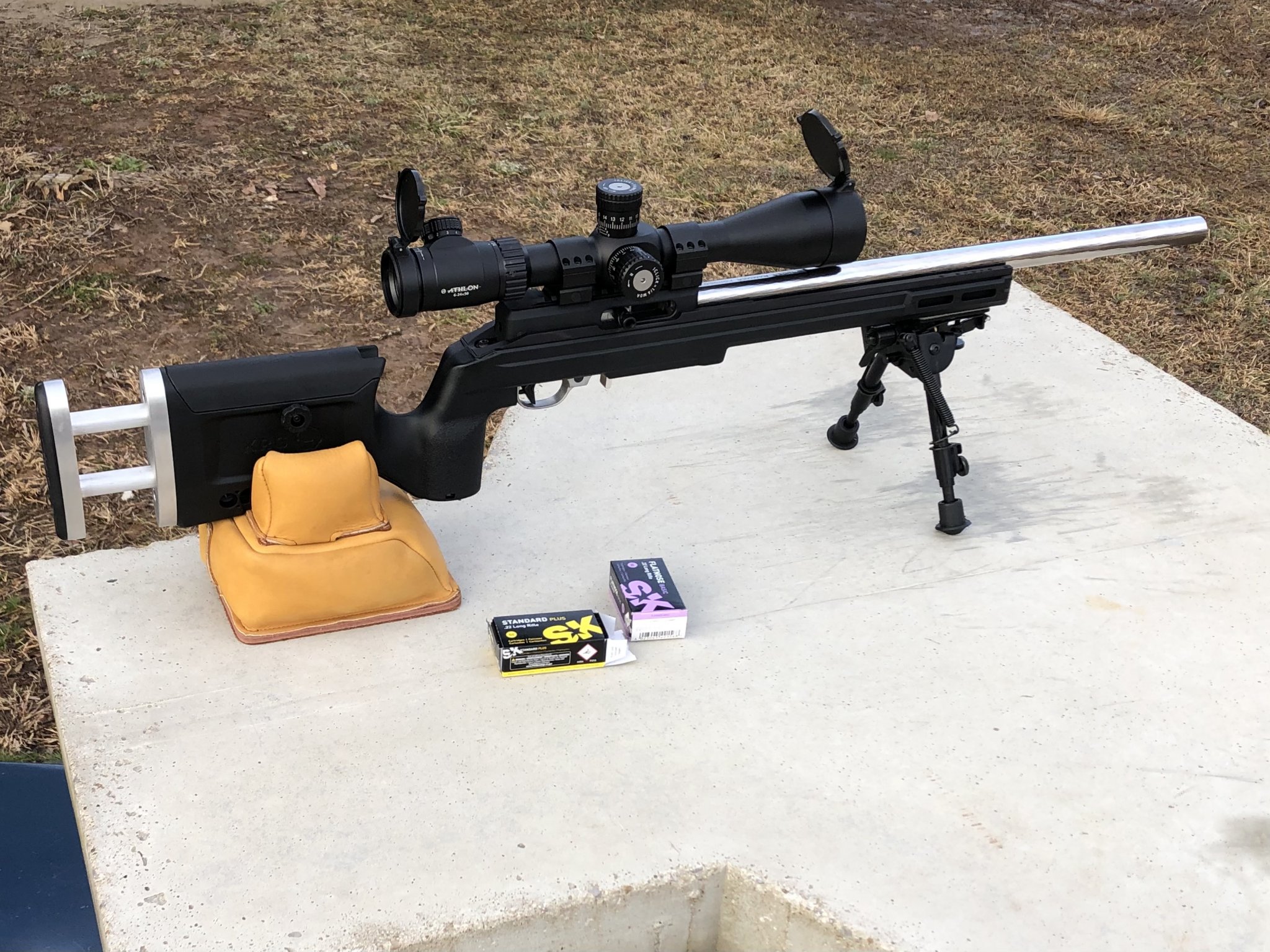

With a Kidd and ammo it likes, just under an MOA average at 50. Ten groups of five shots averaged .427 inch with a stddev of .17 inch. Very reliable MOAish average. This is with correcting shots for. wind of 3MPH or less. Higher wind, even with correction, i would get larger groups.

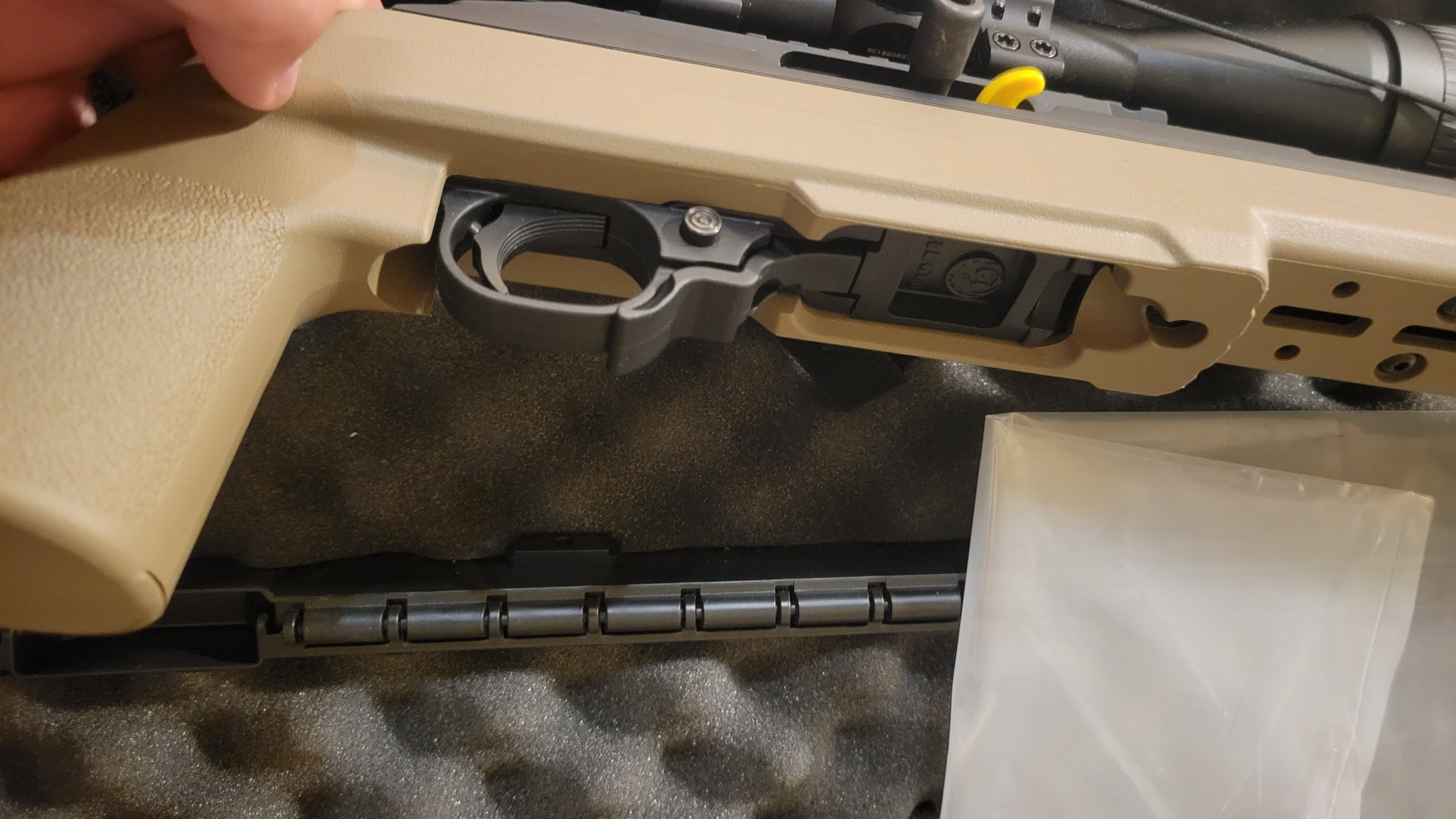

For grins and giggles, I decided to see if I could drop a Ruger Custom Shop build into my chassis. The rifle has a rear receiver screw that screws into the receiver's screw housing from the bottom of the Custom Shop stock, but it turns out that when you flip the receiver over, the screw housing is bolted on to the receiver, so I removed the rear screw housing and the barreled receiver dropped into the KRG Bravo. I'd put an Eotech with a 4x Sig magnifier on that rifle, and the KRG stock geometry is much kinder for that optical setup. It appears possible to make a replacement screw housing that would mate to the rear screw setup of the KRG stock, but I haven't taken what I've got out for a range trial yet.
I've got the same thing, and experienced the same thing.
I pointed it out to KRG and they basically said that all 10/22's attach from the front bolt and that should be sufficient.
I don't entirely think that's the case, and the custom shop 10/22 is pretty heavy... but they are right that most 10/22s mount in the front.

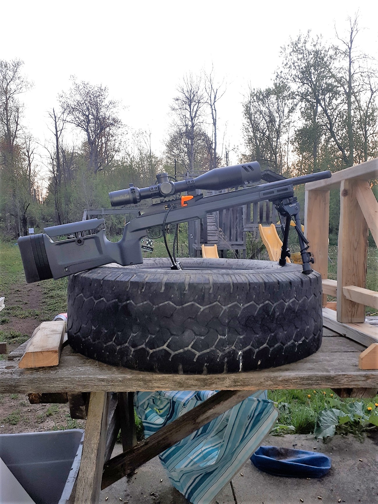

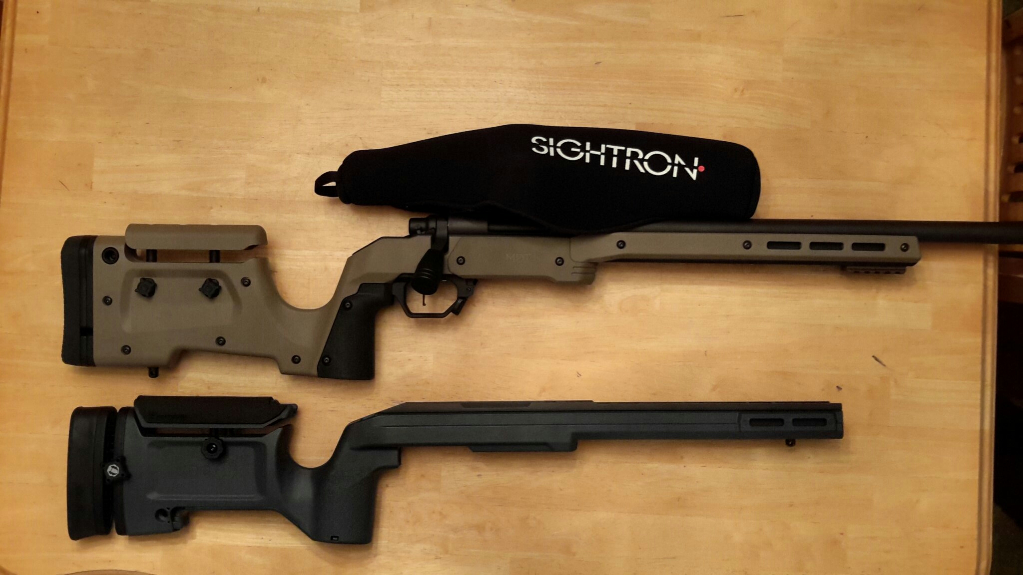

Just ordered a grey Bravo to replace a Titan
Stealth Grey
Hook style cover
KIDD hardware
Adjustable LOP kit
KRG recoil pad
Also, curious if the Titan anchor can be modified to fit the bravo. Would appreciate some feedback whenever someone has the opportunity to compare side by side. Have a great weekend.
I dont have both in front of me but I doubt they will be cross compatible. The bravo uses the kidd anchor and the titan uses its own that is taller if memory serves.

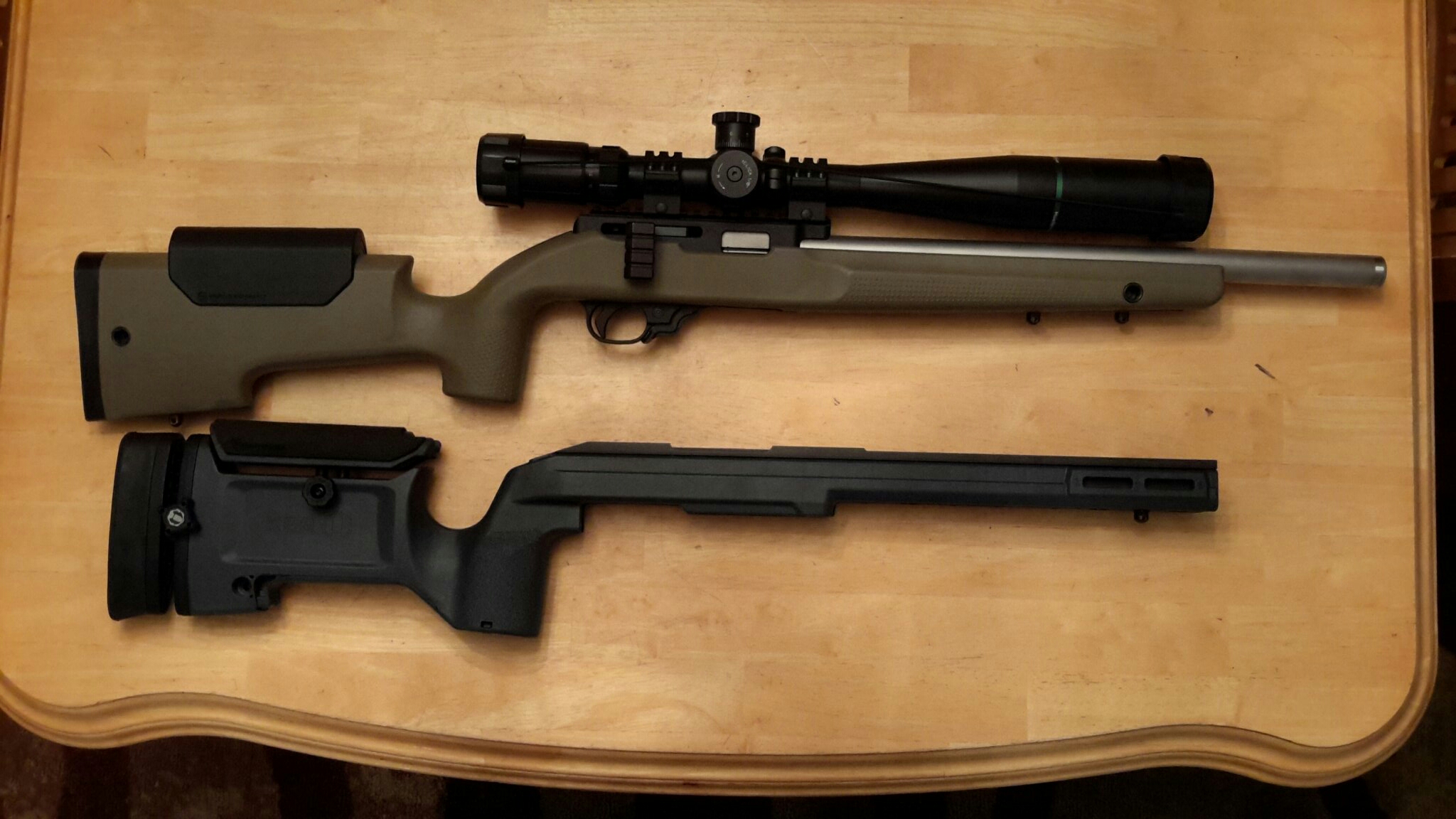

Here's a picture of the Stealth grey with adjustable LOP kit and recoil pad compared to a Victor Titan
