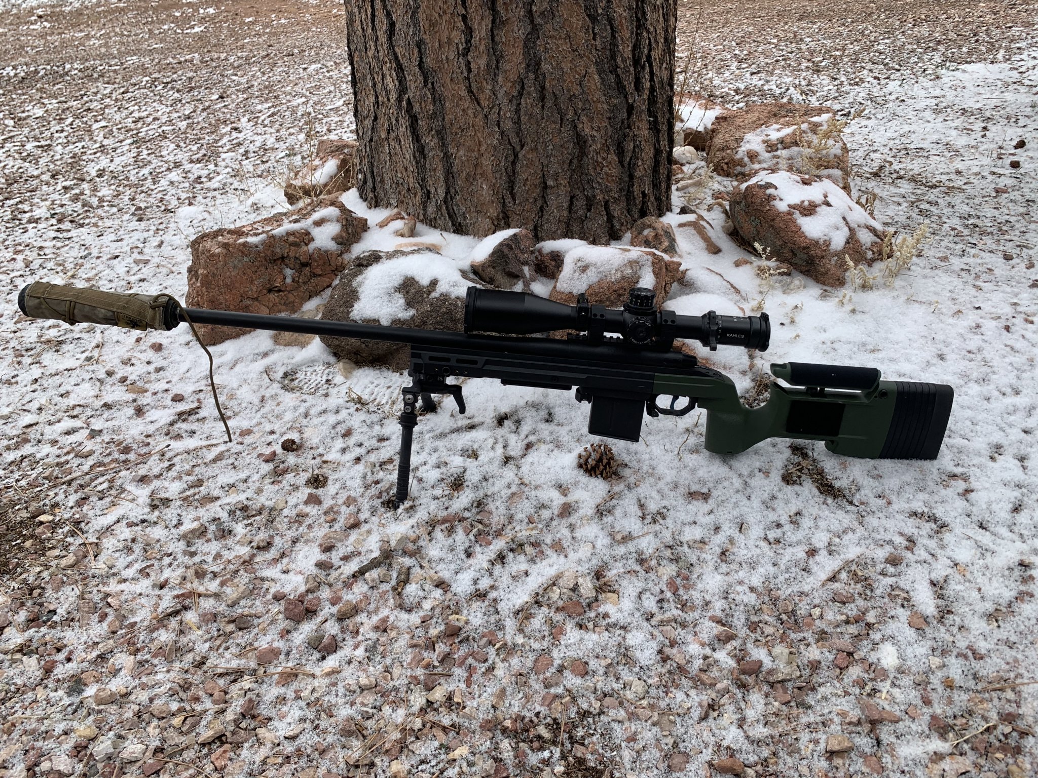

I've sold my two AIAX chassis and one REM700 LA as well. Now down to two REM700 SA both in bravos.

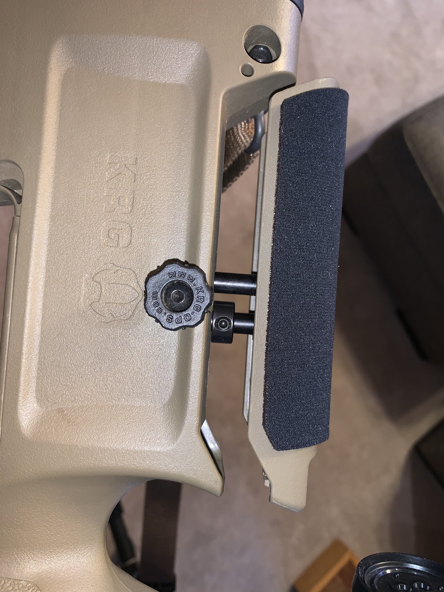

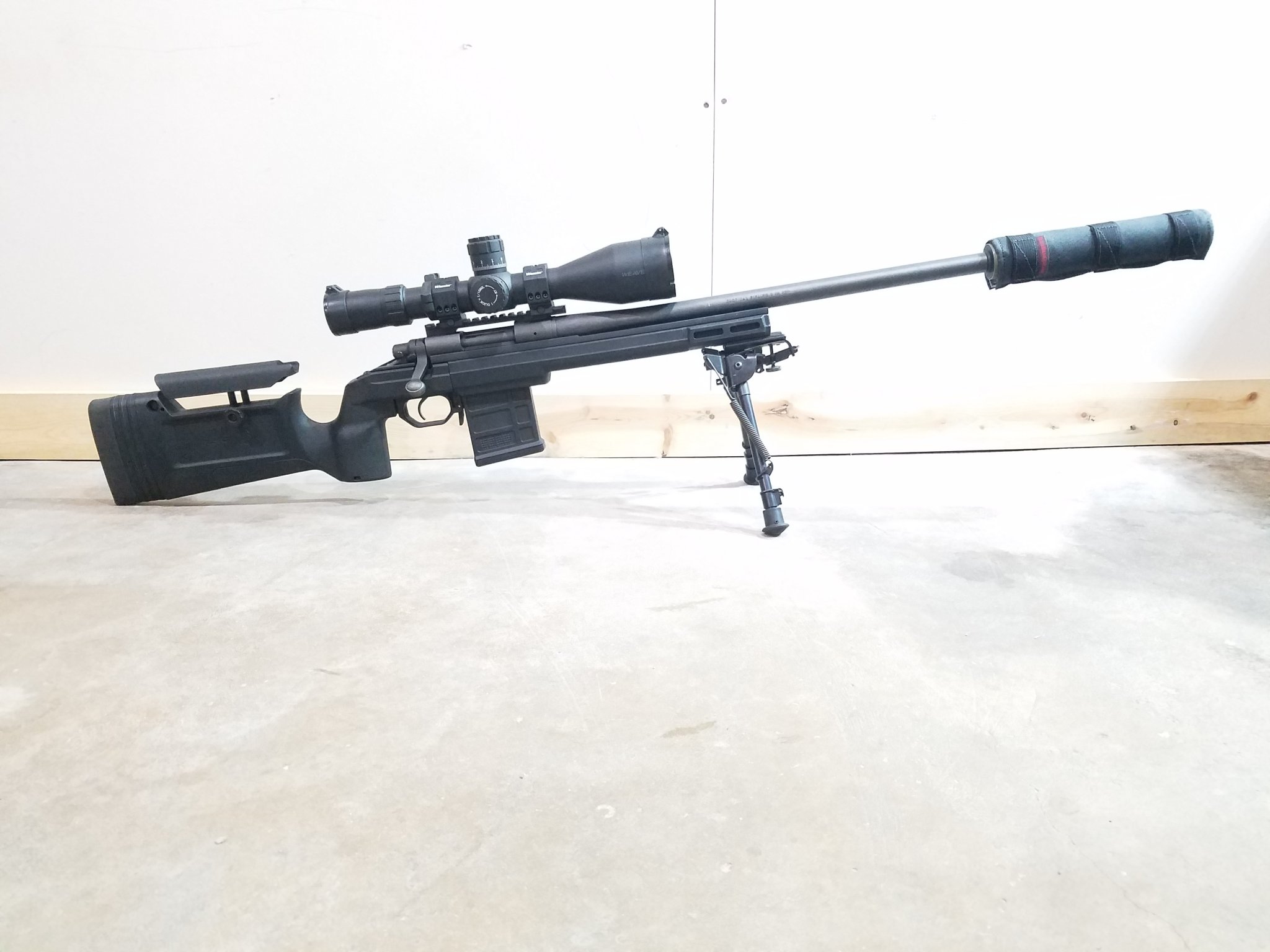

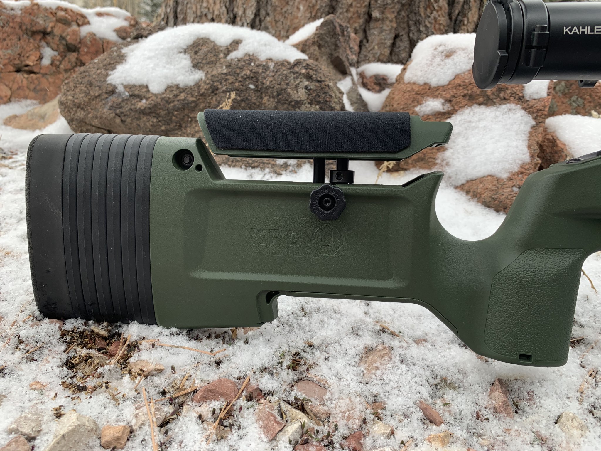

Did a few upgrades to my 2 bravos this weekend. Got tired of not being able to get the cheekpiece back in the exact same location each time after cleaning the rifles so I picked up a few shaft collars to create a stop that will allow me to put the cheekpiece back in without having to fiddle. Here are the collars I used https://www.amazon.com/gp/aw/d/B07TSF9KTG?psc=1&ref=ppx_pop_mob_b_asin_image
Next up I wanted to put something to soften the cheek pad and keep it warmer in the winter. I found CDS online but they didn’t make a pad for my beloved Bravos so I contacted them. They told me to send in pattern and they would cut it for me. Very cool guy to deal with and ended up sending me pads for my bravos and seekins 10x stocks. Doesn’t look like they are on his website yet but he has the patterns now.https://www.convergentdesignsolutions.com/store/c16/Cheek_Pads.html

Looks good! The cheek pad is a stick on? Update on the original post, I ended up borrowing another bravo from a friend while the lgs orders in a new one for me. I put the .223 BA into it and ran just over 100 rounds out of the AICS mag with no problem, so maybe my original bravo is just a bit finicky.
yep, some type of really sticky backed dense foam.
Two plumbers silicone O-rings did the same for me.

Just got my Bravo from you guys...
I was a bit incredulous at first. It is really light, and is going on a heavy gun. But once I realized how solid it actually is and how I could add weight to the buttstock to counter-balance a 28" MTU barrel, it really is the perfect solution for my problem.
