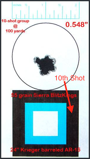

Internet Commandos are always looking for an excuse for their lame marksmanship skills. The 10-shot group pictured below was fired from one of my Krieger barreled AR-15s at a distance of 100 yards with only 10 rounds loaded in the magazine. Where's the shift in the point of impact?

The last round POI change idea... is more likely to be someone psyching them selves out. Lol
Just kidding. Nice group.
Reactions: drewthebrave
Fake news

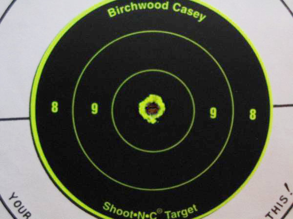

oh yeah Molon? Look at my 90rnd group fired from my custom Highpoint 6" barreled AR15s at 1200yards from a moving donkey. Only one round in the magazine. I hand loaded each shot with the same bullet and same brass. Who's the internet commando now?
