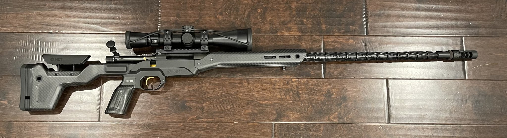

I think @lowlight nailed it pretty much. I have two GT barrels. On a 20” GT 260 gas gun I don’t think I see the benefit since I’m already giving up so much speed in the 260 with a 20” barrel. That build was more an experiment in building a tac driving DMR rifle best suited for 800 and in with the ability to go further if need be better than a 308.
the other rifle is a 6mm creed. I have t received it yet but I’ll let you know once I do and get to shoot it. That’s a 24” barrel.
both are also Left twist as well.

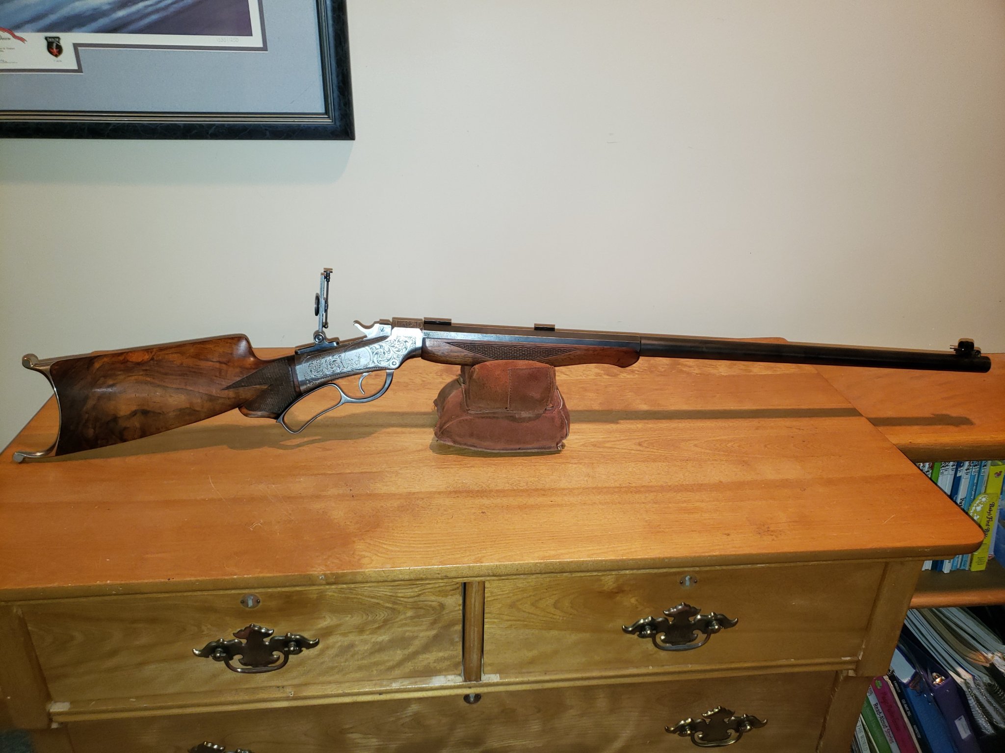

Remember back in the hey day of schuetzenfest shooting/rifles….Off hand rifles had a weight limit of 10.5# if I recall correctly. An average caliber was .38 and .40 caliber. Later on .32 and even .28cal. The average bullet weight of a .40 was 330gr.
Pope would only make LH twist barrels. He said all the south paw shooters could suffer. Think of those heavy bullets and being a right handed shooter in a light weight rifle. That was one of the things he always said, “it helped the shooter control the rifle better.“
He also stated that the GT helped reduce fouling (remember these are lead bullets these guys are shooting) and that the bullet started easier into the rifling. I’ve got his book and actual word for word comments at work and I can post them on Monday if you like.
I just recently sold a Marlin Ballard #4 variation Rigby Ballard offhand rifle that Pope converted to 22rf. The barrel had 8 grooves, left hand twist and was a gain twist. From what I could measure I would say it was a 18 to a 16.5 twist. The bore condition of the rifle was flat out mint and it was made around 1905.
Steve Garbe asked me if he could put the rifle into a Pope machine rest that he had (gun was sent to him to repair the original broken stock) and shoot it. I told him to knock himself out. That gun shot 10 shot groups in the low .3xx’s at 65 yards outside. Wasn’t shot in a indoor range. Even new guns made now a days would have a tough time beating that. A action/rifle made in the late 1800’s (think it was around 1885ish) and a barrel made well over a 100 years ago.
I’ll post a picture of the rifle on Monday. I’ve posted it before on the hide somewhere.

Q.) What are the benefits of the gain twist type rifling? A. I'll quote what Pope (Pope was one of the great barrel makers from a bygone era. His barrels along with Schalk who he learned from and gives credit to and Schoyen, and Zischang made barrels for the Schutzenfest type of guns/shooting in the late 1800's to early 1900's) said around a 100 years ago first. "The advantages of the gain twist are three. 1st The twist being less at the breech, gives less friction to the bullet; it there fore starts easier and quicker, giving the powder less time to burn on in front of the chamber, which there fore fouls less than in a barrel of uniform twist at the same necessary muzzle pitch (twist). nd 2 The slight change in angle of the rifling, in connection with choke bore (lapping choke into the bore of the barrel), effectually shuts off any gas escape of gas and prevents gas cutting, which is another case of rd imperfect delivery. 3 It holds a muzzle loaded bullet in position much better than a uniform twist .... Now I will add some more to this. First off I feel this applies more to a lead bullet shooter than a jacketed bullet shooter but some of the why's and why nots do over lap. With a gain twist barrel the bullet cannot go to sleep. The rifling is always putting a fresh bite on the bullet as it goes down the bore of the barrel. This is why I always go back to a cut barrel being better than a button barrel. A cut barrel even with a straight twist is more uniform and consistent than a button barrel. With button rifling the button can hit a hard spot/soft spot in the steel and it will slow the button down. The button could speed back up and do the twist it's suppose to be doing but either way you end up with a non uniform twist and if the twist keeps getting slower towards the muzzle these two things are a accuracy killer and lead consistency problems/fliers etc ..•1 feel even a slight gain twist will help accuracy wise and not hurt a jacketed bullet shooter as well. For the most part I would say there is no velocity gain in a gain twist barrel with the same load. What has been conveyed to us and it goes back to Popes 1 st point is that shooters have noticed that they can run a slightly heavier powder charge vs. a shooter with a straight twist barrel. As the bullet is starting easier into the rifling my only guess is the pressure isn't spiking as fast or is delaying the pressure curve. Hence forth they can get more velocity out of the gain twist barrel. I feel pressure is pressure and that the twist doesn't have anything to do with pressure for the most part but my only guess is that the gain twist like I said earlier is delaying the pressure curve. So you don't see problems as early like hard bolt lift etc... Also it's noted that even nowadays our military in some 20mm and the 30mm barrels like on the A10 Warthog ground attack aircraft have gain twist type rifling in the barrels.
Above is the pic of the Ballard with the Pope GT type barrel. 8 grooves and left hand twist.
Also above are some quotes from Pope on GT and my thoughts about it as well. Wrote that up a while ago.

Finally have a LHGT threaded up! Can’t wait to see how it shoots, which requires… ammo. Terrible inconvenience, really.
Bartlein MOD400BB, 28”, 1:8.5-1:7.5, M24ish profile plus the @LongRifles Inc. Pattern X fluting. The entire rifle weighs in at 9.5lb, compared to 8.8lb with the Proof savage prefit that lasted ~1500 rounds.
