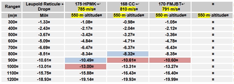

I'm interested because I have the same scope for .308 (175 gn HPMK at 2575fps/785 ms)
I also have it zeroed at 50 meters - I also saw the mixed message on the 200 meter zero
I played with the elevation and found that the figures worked best about 550 meters elevation or 1800 f)
Temp was 15 C (59 F) - I didn't try too much harder than this.
Hope that helps...
Cheers

But, I basically figured 'close enough' and tried to get the projectile to basically follow the curve.
With the complete drought of Varget and 175 HPMK around here, I've had to do some projectile substitution.
That's why I look at using the Lapua 170 FMJBT at 791 m/s which seems quite close out to subsonic range (900-1000 meters)
My theory is basically that I'm not after a first round hit - it's a quick target acquisition, use reticule, fire shot and should be within a 50-100 cm radius - correct and impact.
Seems to work so far out to the 700 plus I've tried it.
