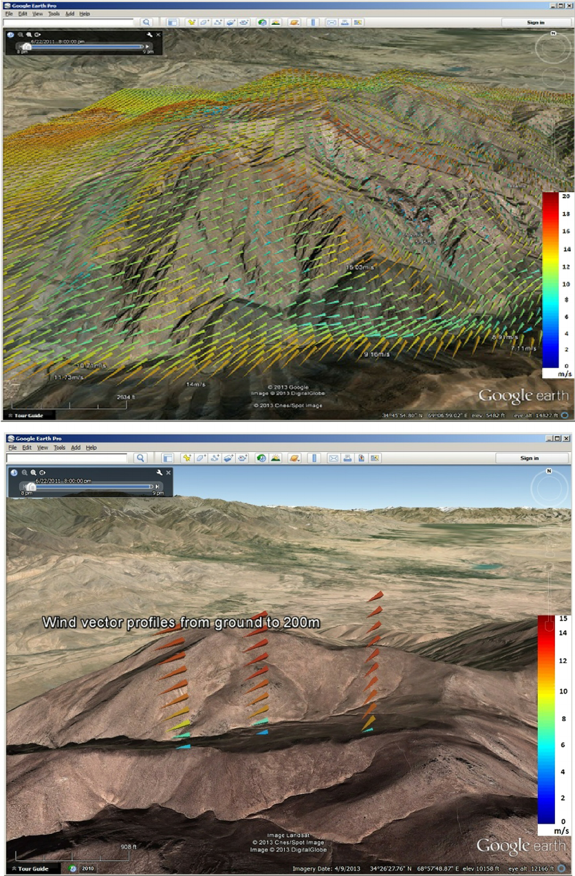

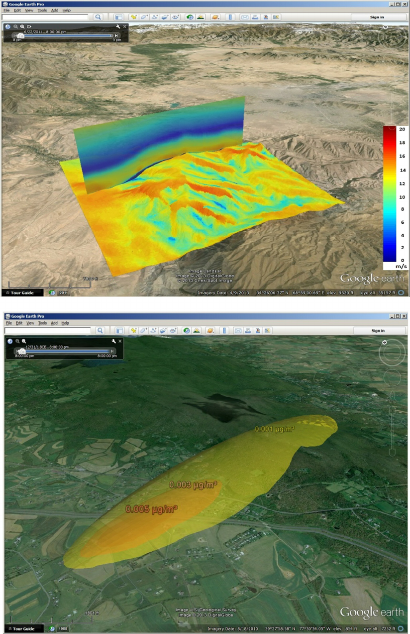

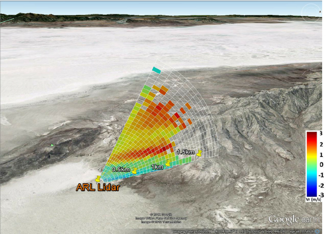

Hi,
I am just starting my in depth research on them right now but the below images of wind are pretty damn awesome!!

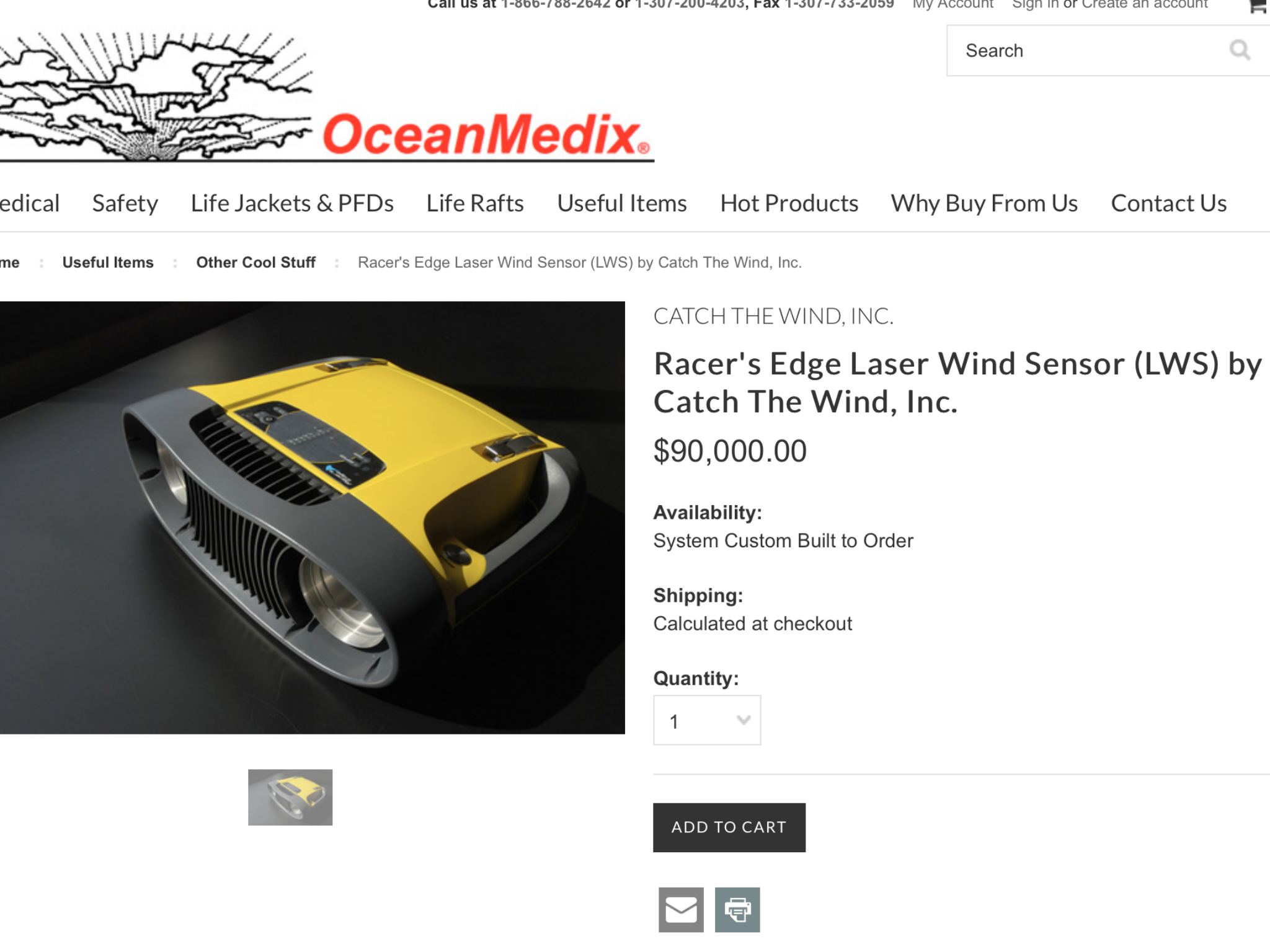

I can see huge value in wind lidar as a training tool. Being able to relate mirage, visual
cues like dust and vegetation movement with the graphic representation on screen
should be a great asset. Sometimes we use a variety of wind flags on high poles to
show the effects of updrafts etc; a pita to set up but great for training. There are lidar
binos that are quite portable, but at $70k + that might not be for me just yet ; ) .
Don't get me wrong I'm all in for technology! just pointing out the pros and cons of such approach which is very nice for an instrumented range for obvious reasons. On the other hand, LIDAR comes in several flavors, the binos are not meant for wind surveying.
