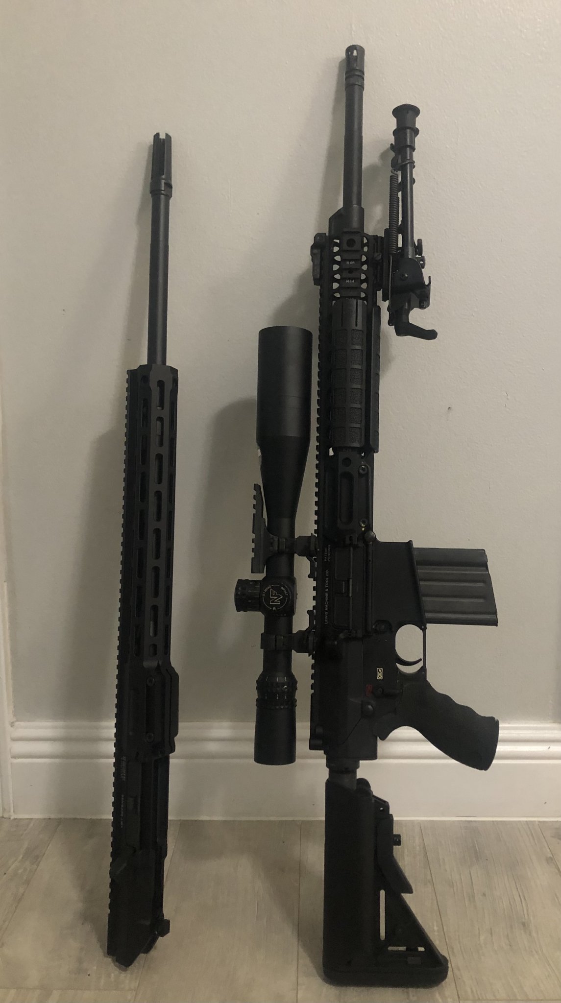

Speaking of modularity, today I got my 6.5CM barrel from V1 (June alloc.) which brings another issue, I don't have an optic for it.
My initial idea was to have 2 barrel/optic setups:
1. Battle rifle (current one) - 16' 7.62 CL LW barrel with LPVO (currently Razor-E 1-6)
2. LR setup - 20' 6.5CM with some high mag scope - Cronus BTR, Delta Stryker, Burris XTR III
However, I'm pleasantly surprised how accurate the 16' barrel is with a wide variety of ammo, plus I also have an 11.5' Colt EPR which also needs an optic.
So I'm thinking instead of having two separate optics for the MWS, to get a compact scope with 18 to 20x magnification (NF NX8, XTR III, Eotech Vudu) plus an offset RMR, maybe on a Badger Condition One mount. By doing this I will better utilize the accuracy of the 16' barrel and avoid switching optics, plus I will put the Razor on the Colt, so I will be a cool kid with an LPVO on a short barrel rifle.
As a drawback, I'm thinking about the increased weight on both guns, plus I don't have any experience with offset red dots so I don't know how close in terms of speed and cqb usage they are compared to LPVO with good 1x.
What do you guys think? Should I stick up to the original plan and buy a decent high mag scope for the MWS and probably Aimpoint T2 for the Colt or the other option is better?

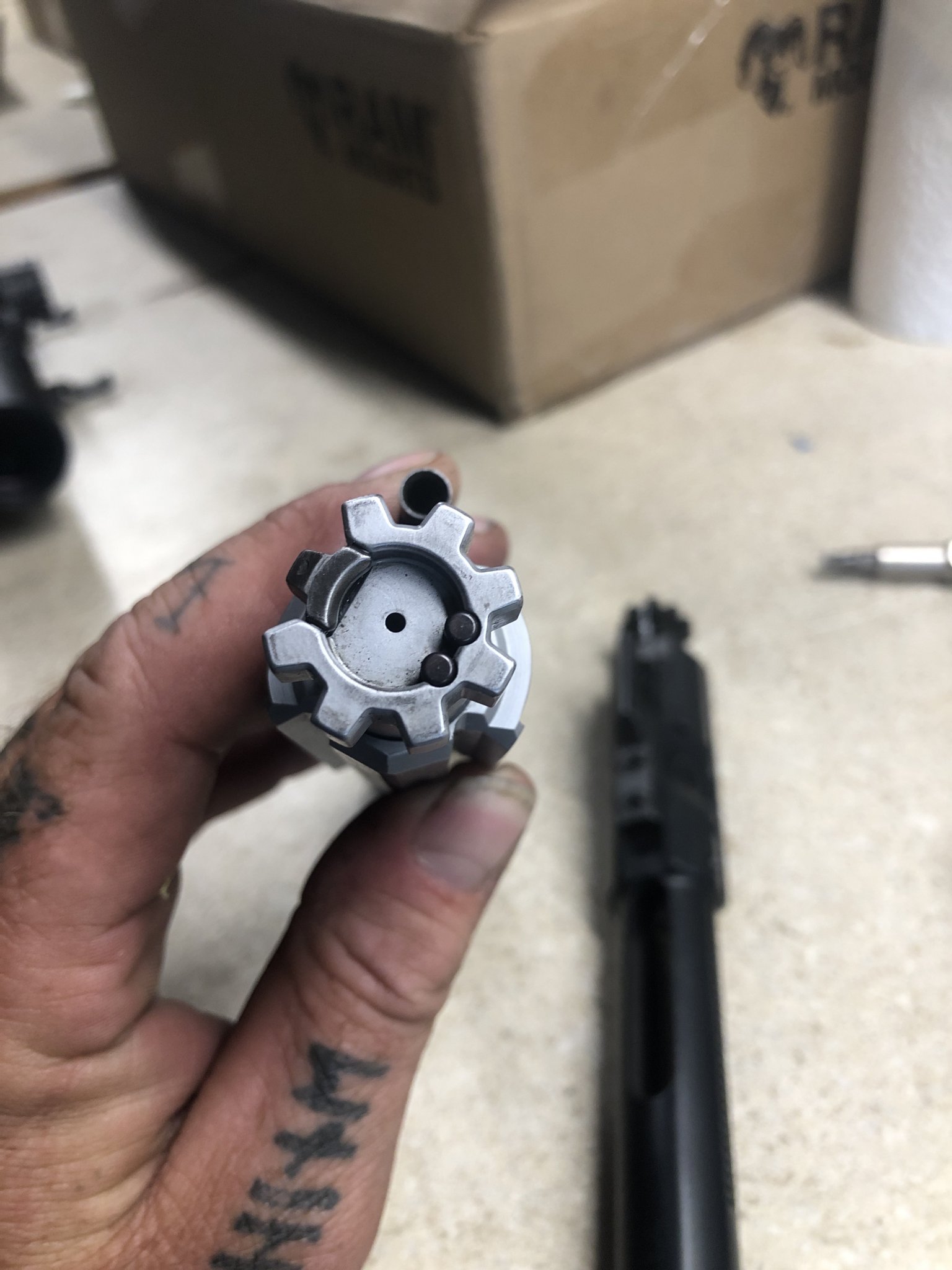

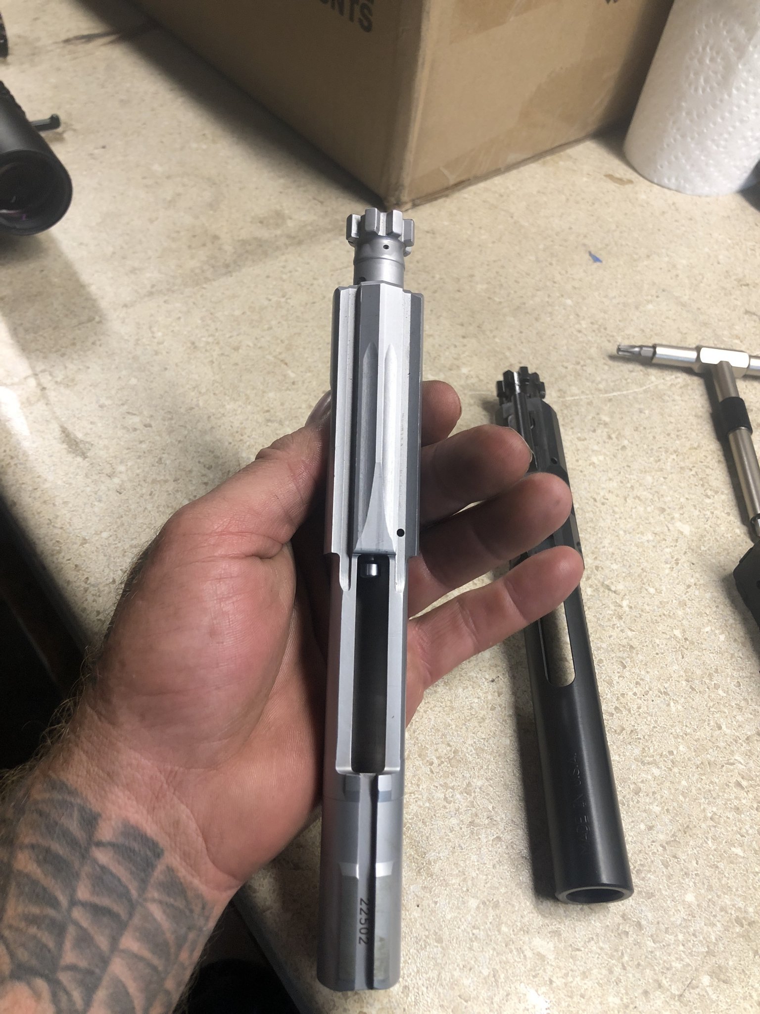

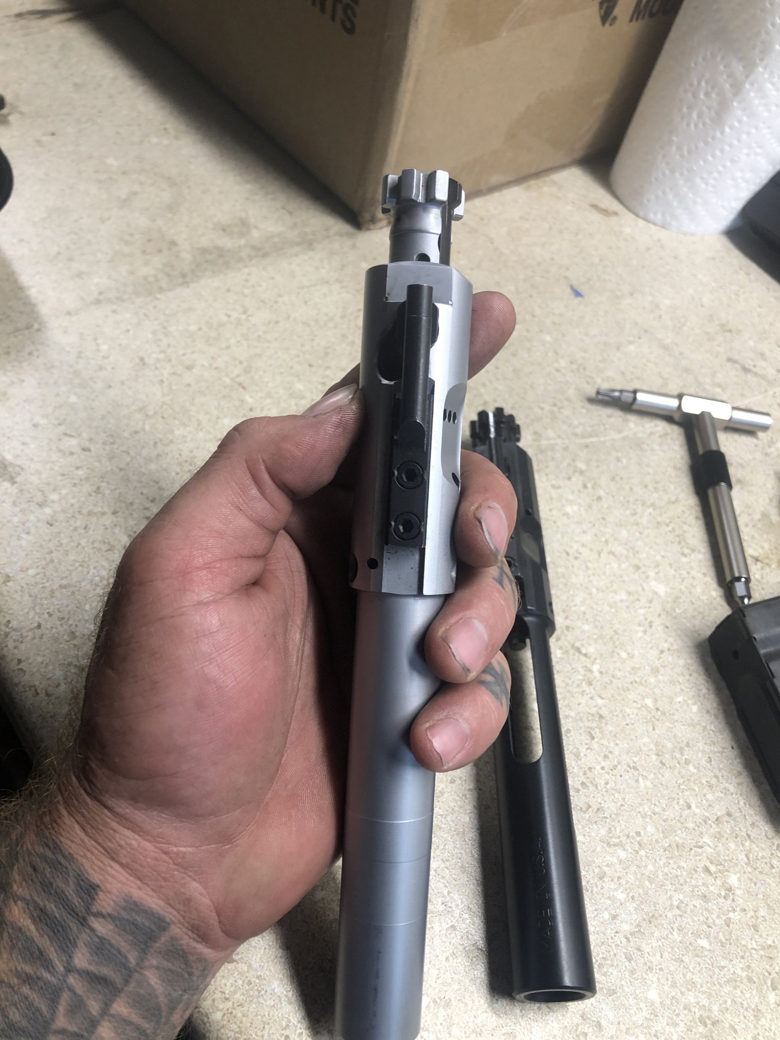

So I picked up and LMT Bolt carrier with a KAC E2 bolt and for some reason if I ride the bolt home, it’s fine. But if the bolt slams home it doesn’t want to unlock. Gotta whack the charging handle to break it loose. Now if I use a standard 308 DPMS BCG, there’s no issues. Does it with 2 separate em uppers and 2 separate barrels.
Any one run into this issue before. Or when mixing LMT carrier and KAC bolt?

No idea there. I have a LMT complete BCG in my KAC ACC upper. It's ran fine for the couple hundred rounds I've shot it. If I get a chance and remember in the next day or two I'll swap some bolts and carriers around between my MWS and KAC guns and report my findings.
I'm guessing your running the KAC bolt in a factory MWS barrel?

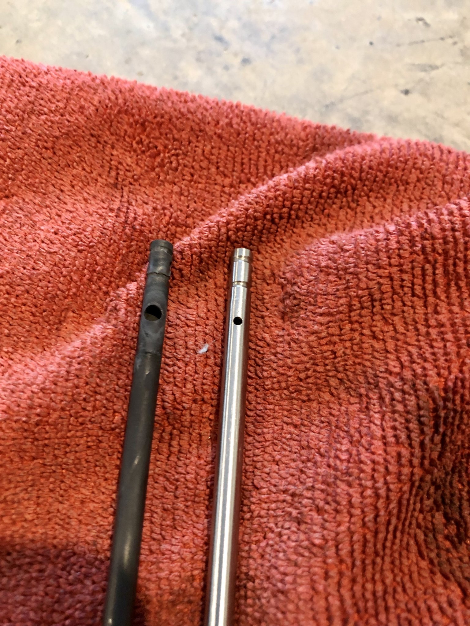

They function flawlessly and will cycle absolutely anything due to the monster of a diameter gas tube hole, which causes them to be grossly overgassed.
Your BGC, ammo, and mags will be absolutely caked with blow back when using it factory configured.
I have switched to the BRT EZTune gas tube, as seen below on the right, and hope this helps. I have yet to use it in the current configuration. This is my last ditch attempt before rebarreling and going with an AGB.

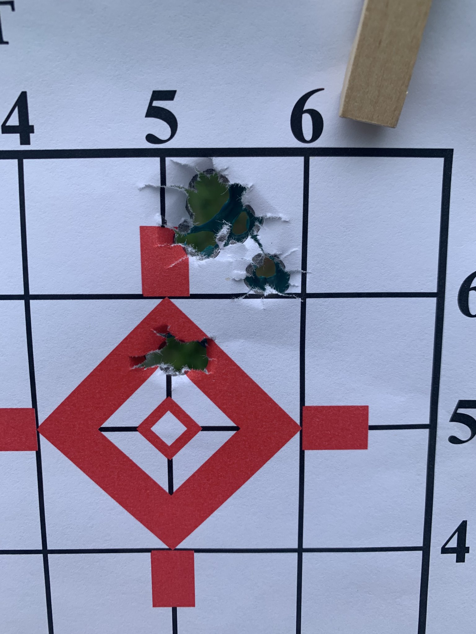

otherwise my sharp shooter is at 1 Moa consistently with 168gr FGMM. Going to try some FGMM 175’s tomorrow to see if anything changes.

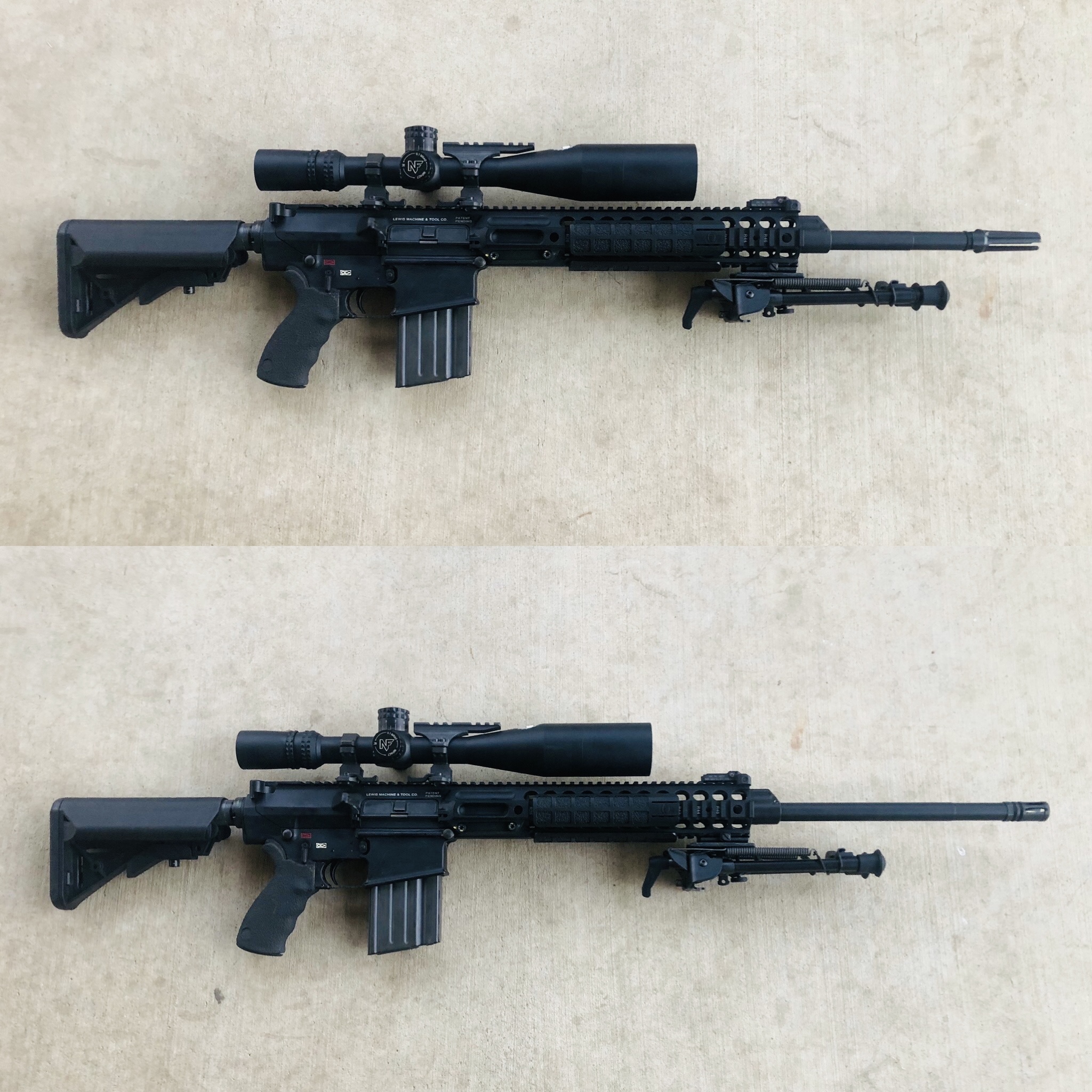

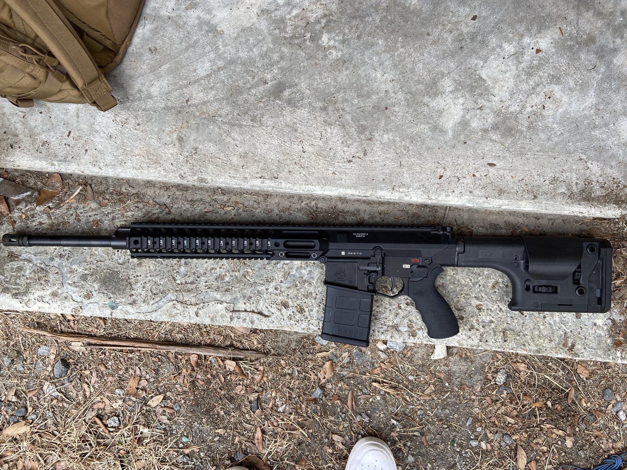

Here’s mine. Just got it togethe
20” SS LMT 7.62 on the Quad
24” SS LMT 6.5CM on the 15.5” MLOK
NF F1 3.5-15x50 H58
The rings are issued ARMS 22 Highs but they’re a bit to high for my liking so I have some NF A108’s on the way
Looking forward to getting her to the range especially to see how that 24” 6.5 runs

Well I definitely like the results that FGMM 175’s did.
ignore the warm up group we’re I was trying to get comfortable….
but man this is a sweet shooting rifle can’t wait to get out to longer ranges.

What type of velocity are your seeing from the 24 and what load are you shooting. i really like my 20 inch 6.5 with 140's Considering cutting back to 18 with a Socom upper
Nice,
Thanks man. I haven’t gotten it out to the range yet. Just got this together last week. I am curious to see if the velocities on the 24 tho. Ill Be running either the 140’s or 147’s.
what are you getting out of your 20” ?
Reactions: TacticalPlinker
I was not able to get a chrono on it and am overseas currently.
Its a shooter for sure.

I ordered a brt gas tube for my 16" ss barrel. FA carrier, H3 buffer and 762rc it went from throwing brass into the next zip code to making a nice pile 10ft away at 3 o'clock. With the can off and just the surefire brake it almost has no recoil. I may try out a h1 or h2 if I get a chance.
Iirc the tube they sent me was a .073" port.

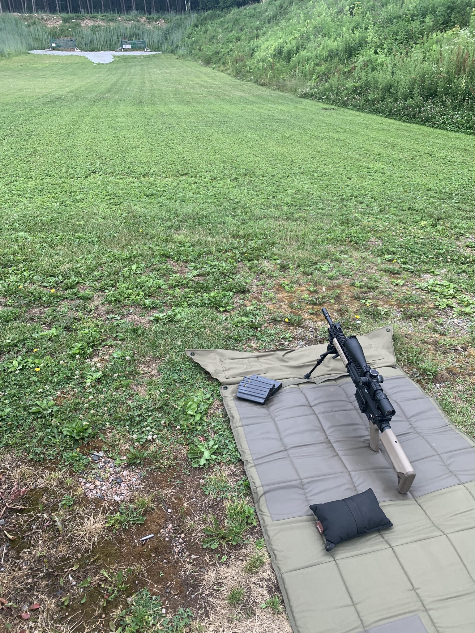

Finally got around the running the LMT MWS with the JP SCS H2 and BRT EZTune. It’s a noticeable improvement compared to the XH and factory gas tube but it is still overgassed with the Dominus CB. Instead of having my brass become a second projectile I now have a nice little pile of brass 10-12 feet over around 2-3 o-clock.
Still only about a 1moa shooter. Don’t know if I am expecting too much from the factory 16” CL 1:10 .308. Might try 168grs and 155’s. Definitely has potential, I’ll get 3 in a nice clover and 2 stringers that open it up. Could be me not running a large frame gasser properly, but thats hard for me to believe when the AI AX gives sub 1/2 moa groups without effort running the same 175gr handloads.

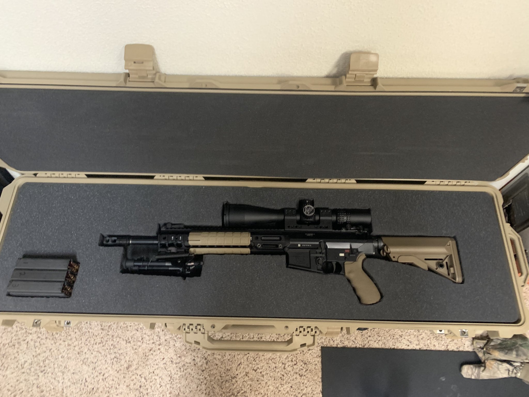

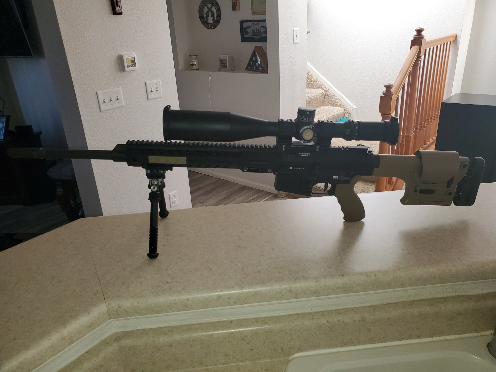

Last year during the crazy spring of 2020, I got the major components and assembled a LMT MWS with MARS-H DMR lower, CQB upper, 20 inch SS 308 barrel, full auto BCG for added weight, and ambi charging handle. All for a little less than $3000 with military discount from V1tactical. I'm in the Army and I was about to spend 9 months in Korea, so I got this thing together thinking even if the situation deteriorated further back in the States, I would at least come back to a rifle that would practically last forever. Just in case things kept getting worse, and either gun control was ramped up or the market left every "combat ready" firearm out of stock or at extreme prices/short availability.
Now I'm about about to go back to the US and ETS in a few months, and I have had a lot of time to see things get better back in the States, do more research (including this entire thread), and think. In my opinion, a person should own and train with "practical" firearms before getting into extravagant, and less useful firearms. By "practical," I mean practical for self/home/property defense, for building skills in various types of shooting, and as well for a theoretical SHTF.
I was only able to put around ~50 rounds through it before I left for Korea. The LMT MWS seems like a fine rifle, but I think I should sell it (not trying to advertise, I'm aware of that rule for new accounts). I think I would be better off with a nice $1500-2500 .308 bolt gun, or maybe even a $1000 Bergara HMR, to properly learn long range shooting before getting into any fancy stuff that complicates things, like large-frame semi-autos. I already have a DMR-style AR-15 that is good out to about 600-700 yards, so this 308 AR is just extraneous when I can get a bolt-action rifle that is more accurate for less money, and already has a longer effective range, when I'm ready for that.

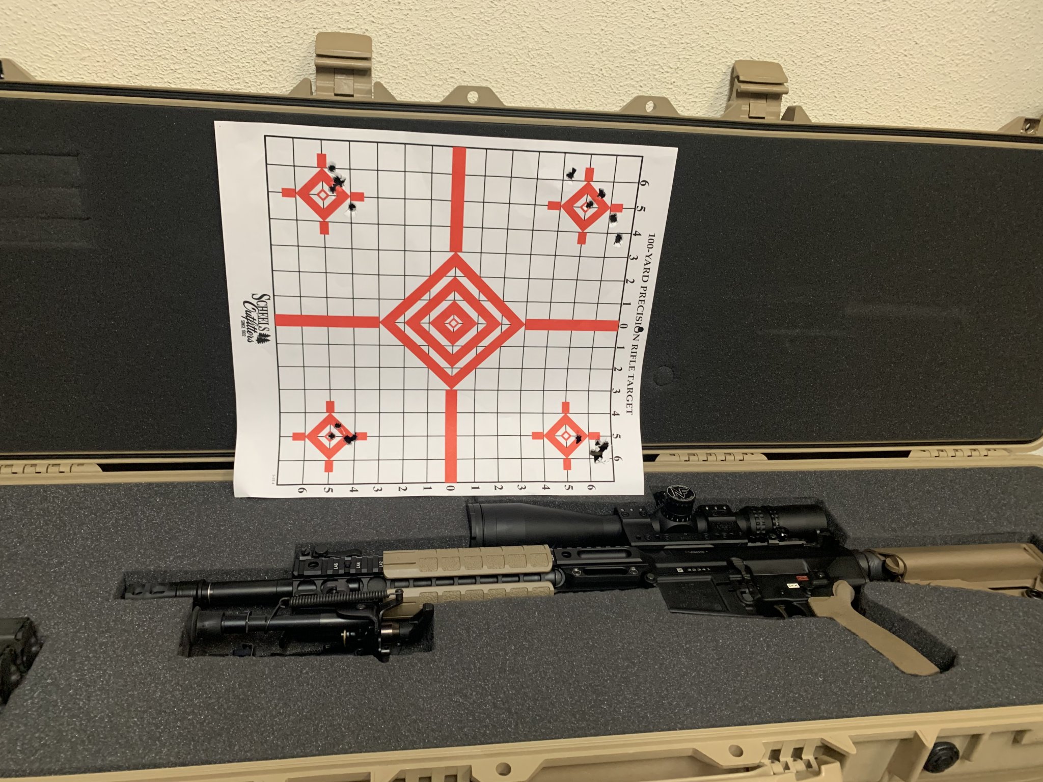

Okay I will try to go all in on it. I already have a Harris bipod, a Geissele Hi Speed National Match trigger (waiting to be installed), and I'm thinking about a Nightforce SHV 4-14 in mils. Maybe a suppressor and offset red dot one day.
I really wanted this thing to be the ultimate bomb-proof-reliable, and with 1 MOA accuracy, 0-800/900/1000 yard gun, but it was just starting to seem like that was a flawed goal in the first place. The amount of people complaining in this thread about issues and difficulties with the MWS weren't really helping my confidence on this. But they are probably just a loud minority considering how much praise the MWS and LMT get in the real world.
