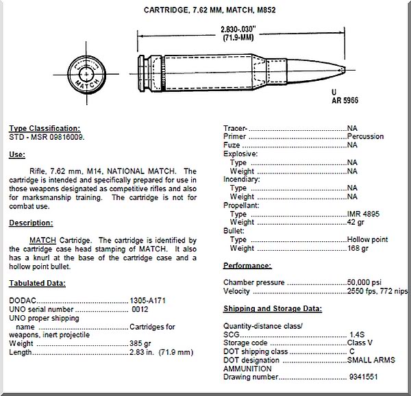

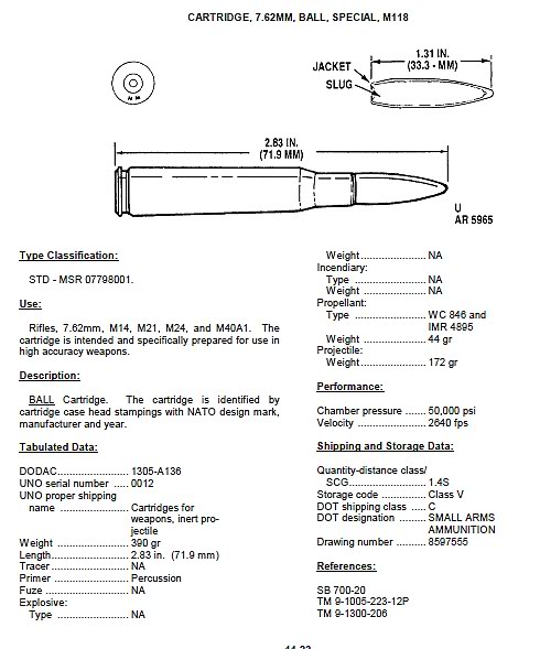

Here you go!

M118 Special ball was loaded with IMR 4895 and a 173gr FMJBT projectile

You mention the bullets as weighing 175, and this sounds like it's causing some confusion or concern. It shouldn't. Nominal specs for the M118 (or M72, same bullet) call it a 173 on most military ammo boxes, and specifys it as a 172 grain bullet in some of the paperwork. I've also seen it listed as, "175.5 grns, -3" meaning anything from 172.5 to 175.5 grains is perfectly within spec. Civilian match grade bullets will vary by tenths, military match often by several grains. Surprisingly, it really doesn't make that much difference, and I've shot a great many lots of M118 that shot quite well, out to and including 1,000 yards. The jackets on the M118 bullets are a lot thicker than those on SMKs or other civilian Match bullets on the market, and that's far and away a bigger issue in the accuracy question than a few tenths (or even grains) in weight. Load 'em up and enjoy! They'll do just fine out of your 1x12", no problem at all.
