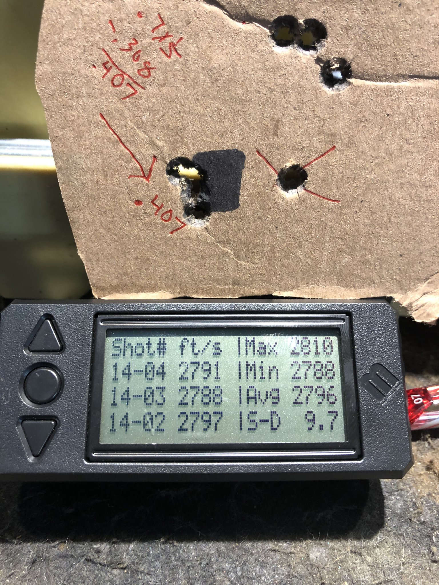

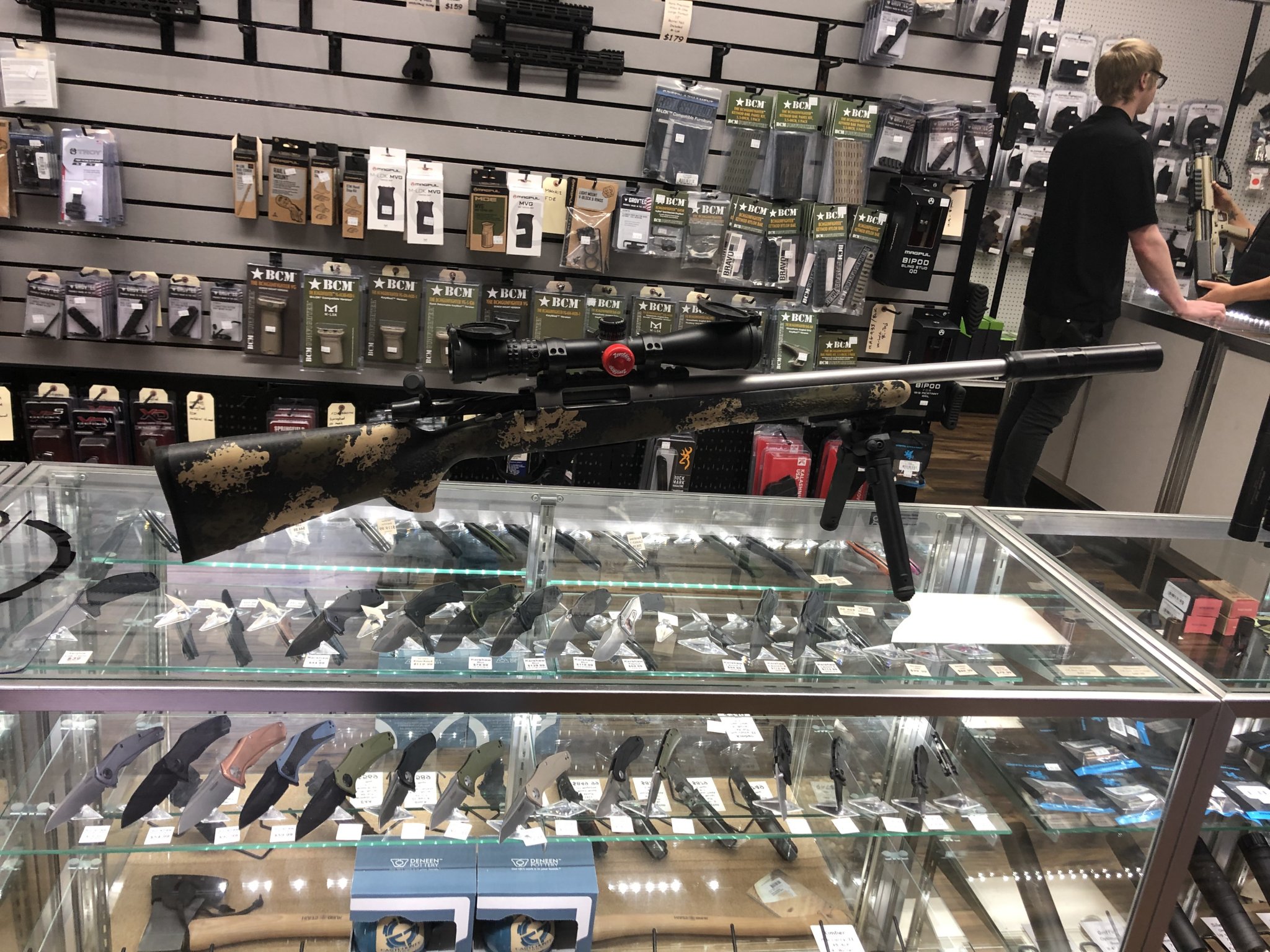

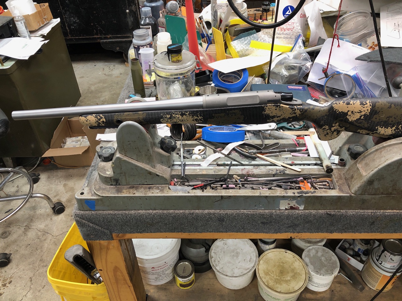

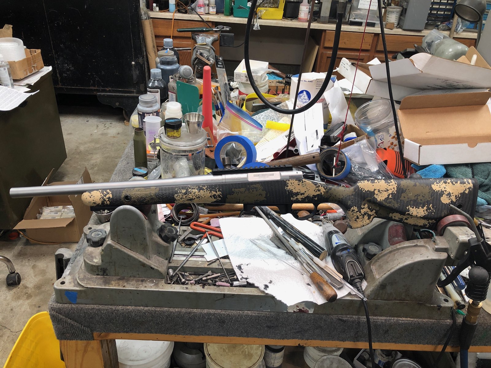

Absolutely shoots like a dream.
308 win.

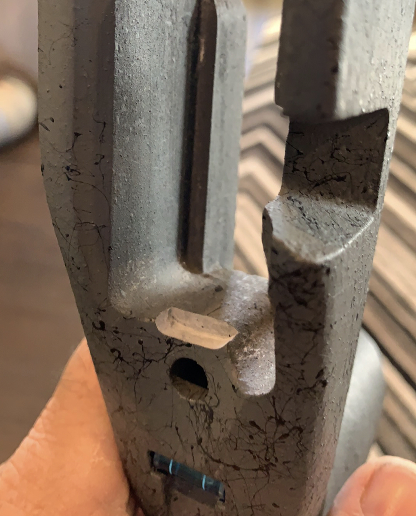

I put in for one last week. I'm jacked to get it. For those who have 1, did you have to notch your stock at all to make room for the trigger connection piece? I thought I saw someone have to do it to their chassis.

Yes i had to inlet my Greyboe for the trigger hanger

Yes, I had to notch my XLR chassis. I used an end mill bit with my drill press. It doesn’t need much material removed to get enough clearance. You can measure how much to take off. I should have taken a picture.

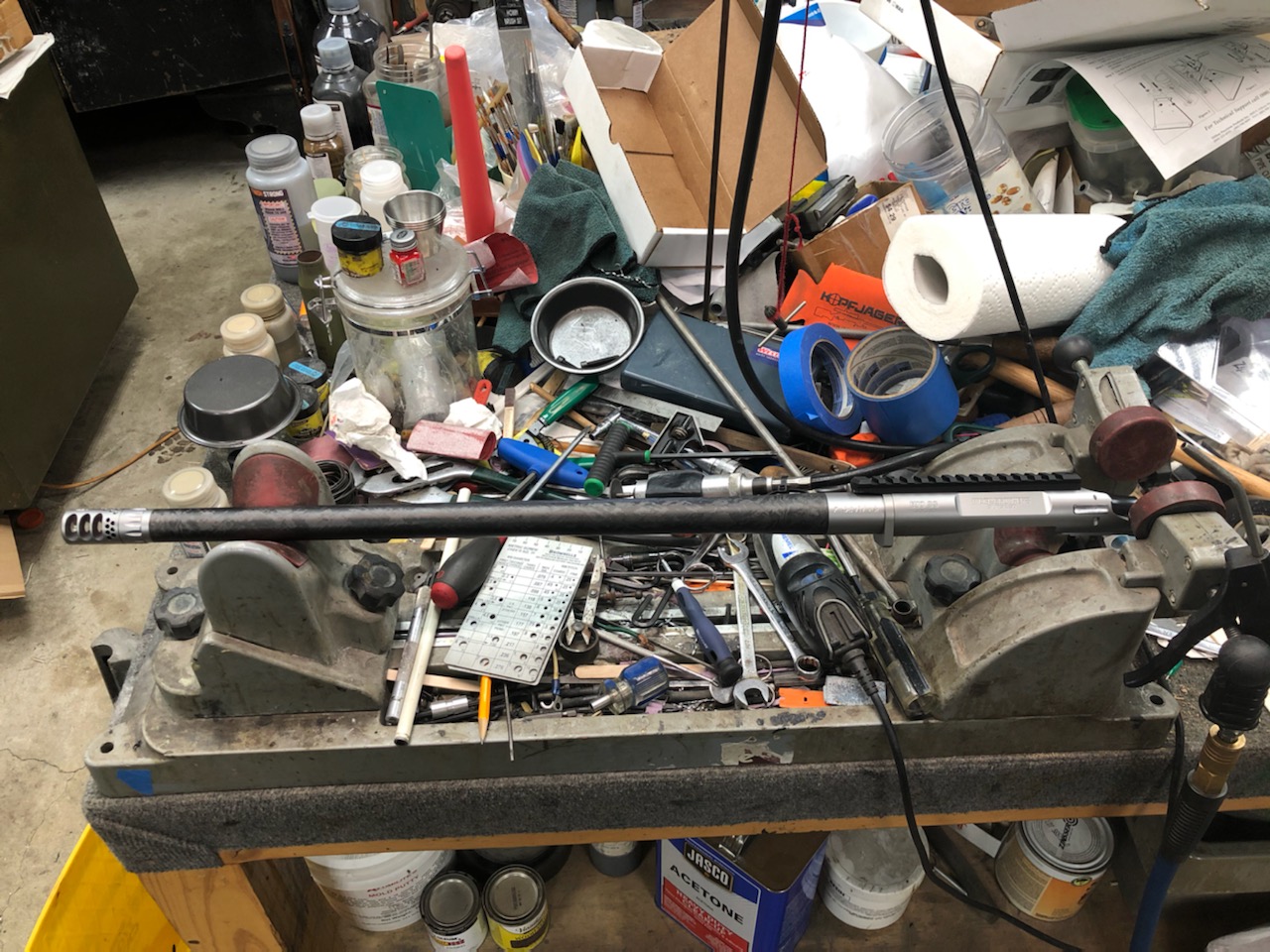

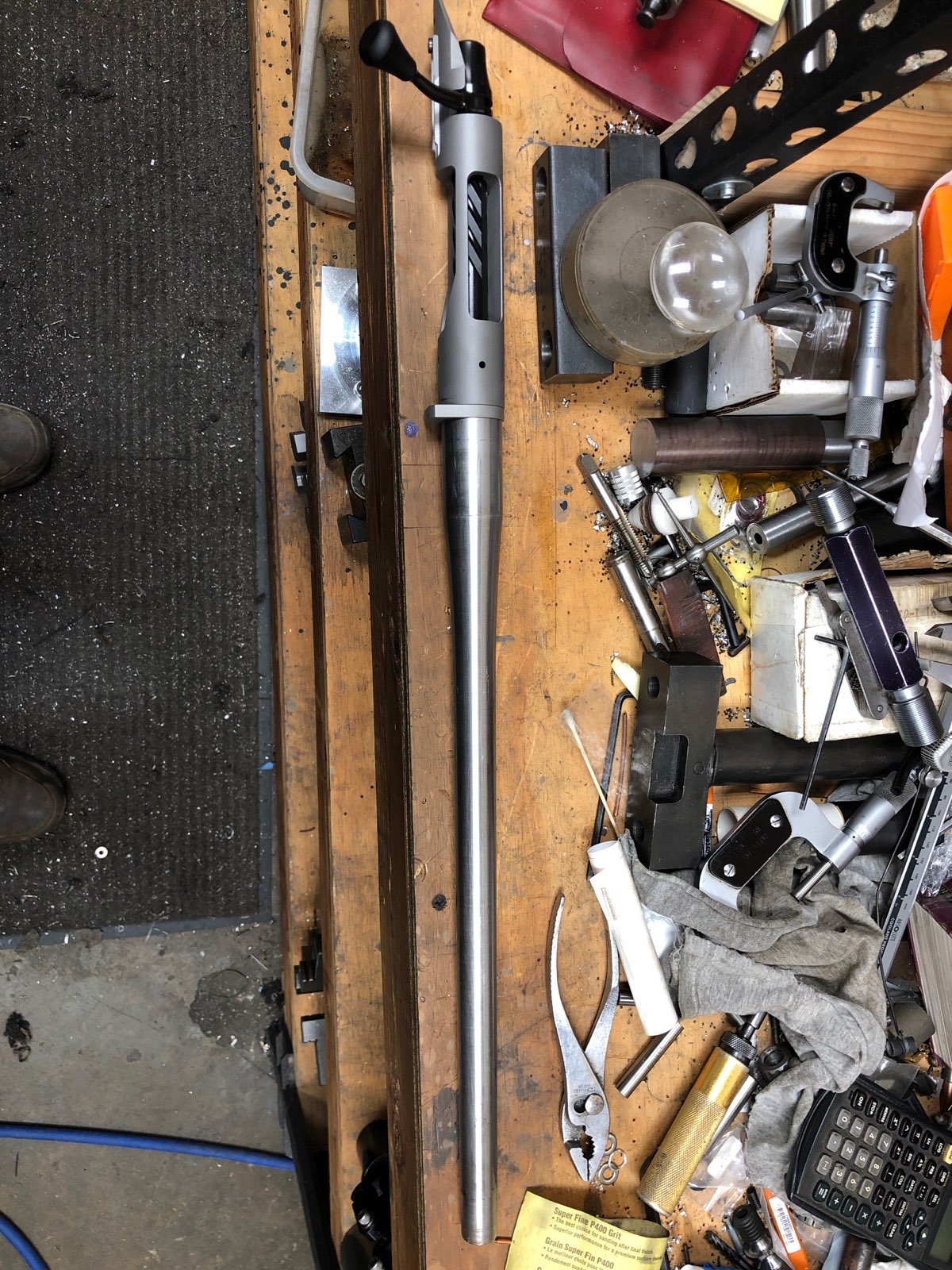

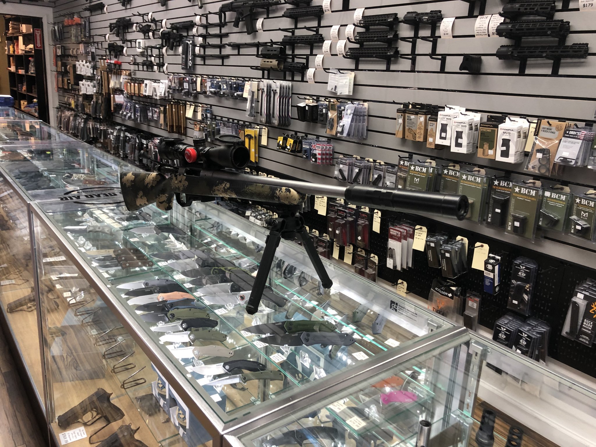

Received my Evo a couple days ago. I had gotten an email that said it was on backorder but it showed up at my FFL rather unexpectedly. Havn't spent a lot of time with it but first impressions are its a lot of value for $575.00 I like my Origins "better" but its hard to point to a particular reason other than they seem a bit smoother and I like the interchangeable bolt heads. For sure though there is zero reason to ever build on another Remington if paying someone to "true" it up. Don't have any particular build plans at the moment so I'll hang onto it for a bit. The only real negative I've got about it is that is mag feed only, no feed rails. To most folks that won't matter so thats more of a personal preference thing. I'm hoping these turn out to be consistent enough for someone to start offering prefits for them. Macbrothers has a sterling reputation so I would assume the machining to be first rate so I'm hoping thats an option in the future.
308 win.

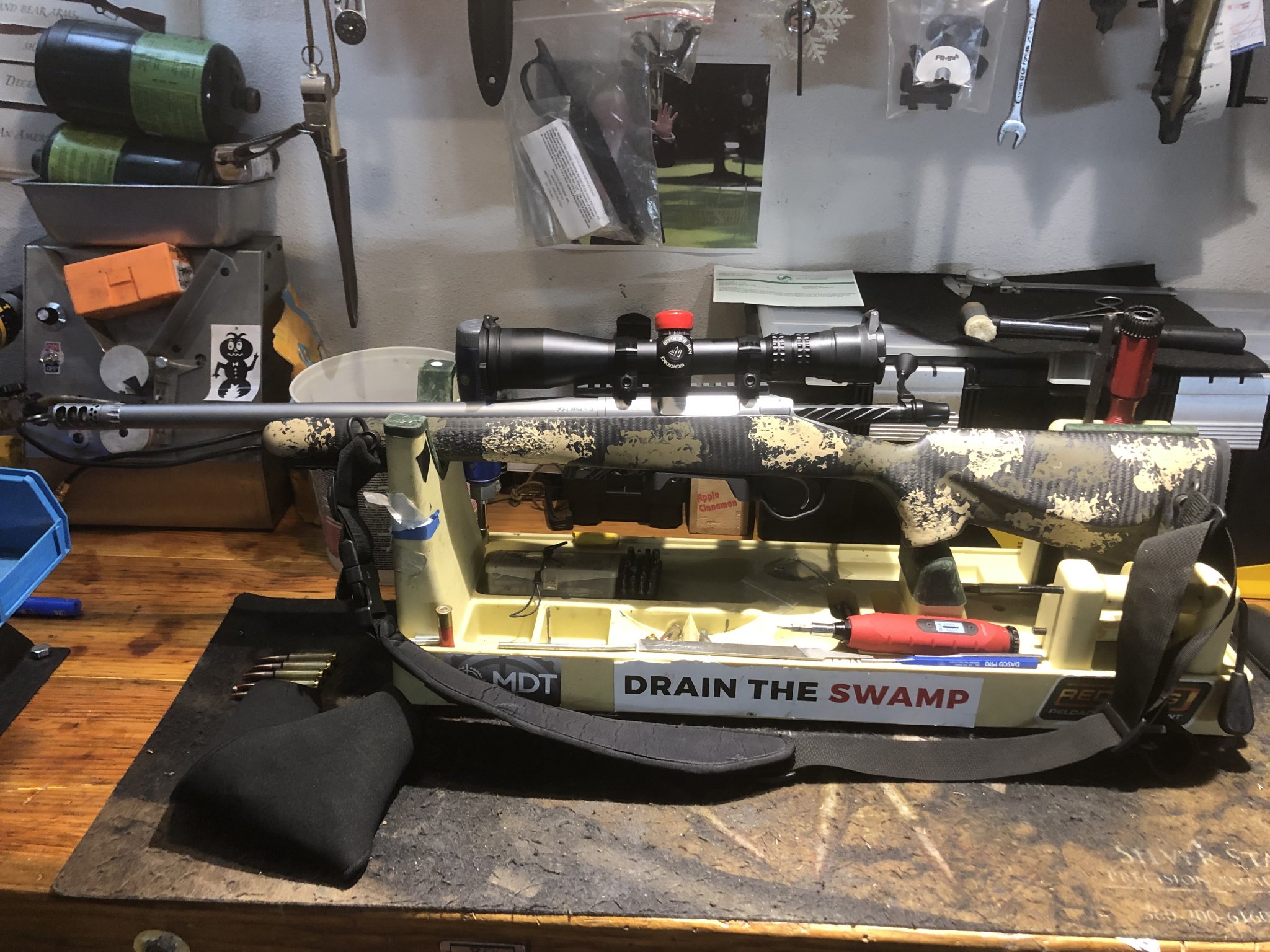

After seeing that picture of the workbench, it makes me feel better about mine! :)
308 win.

sticking with my Tactical division shooting, it was either try to max out a .223 Rem or just bump up to .308 and I think this, along with a long talk with a very experienced pro shooter has me convinced
thanks for the photos

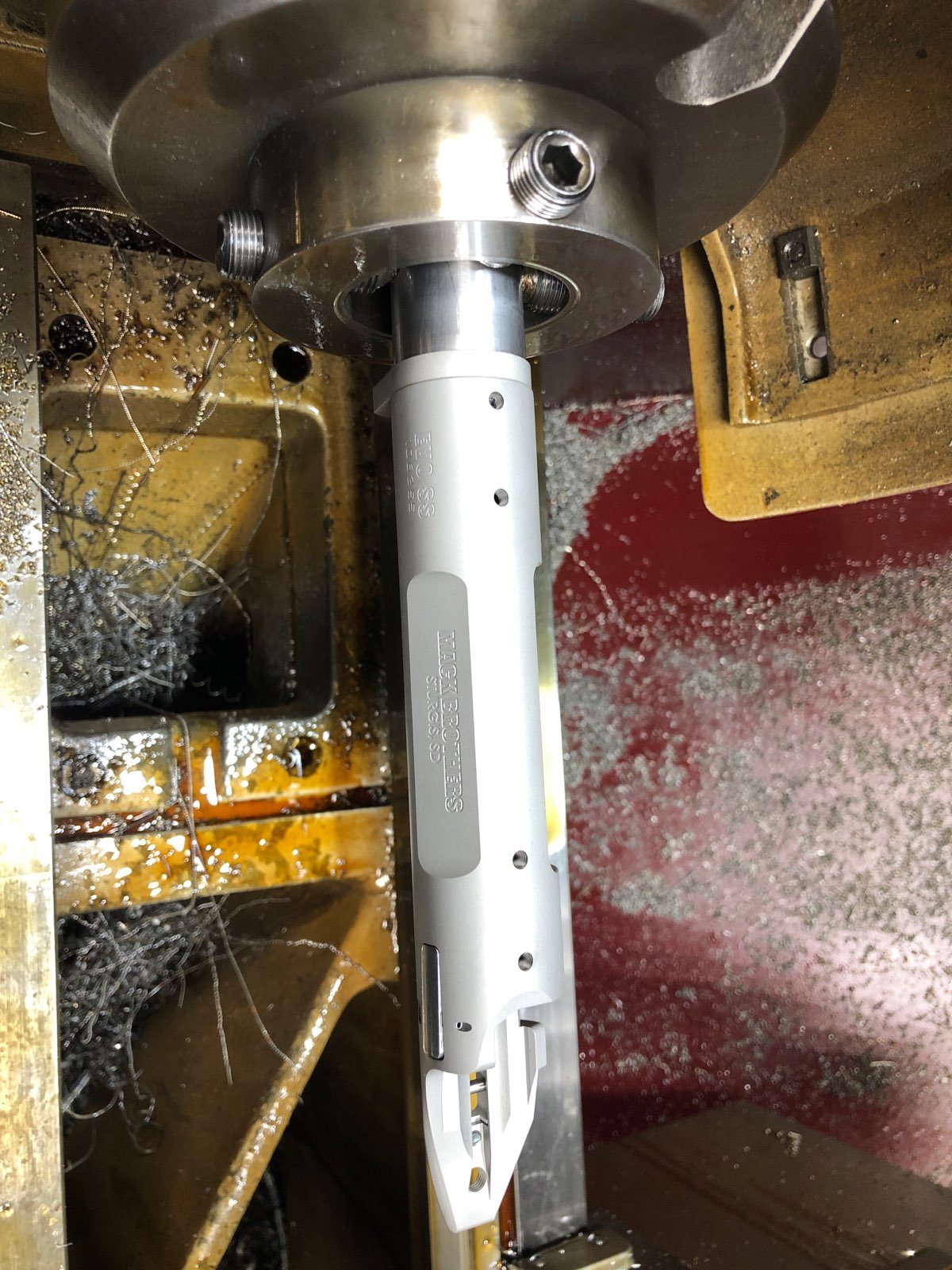

There is a difference in counterbore diameter. A standard remage would need the counterbore diameter opened slightly

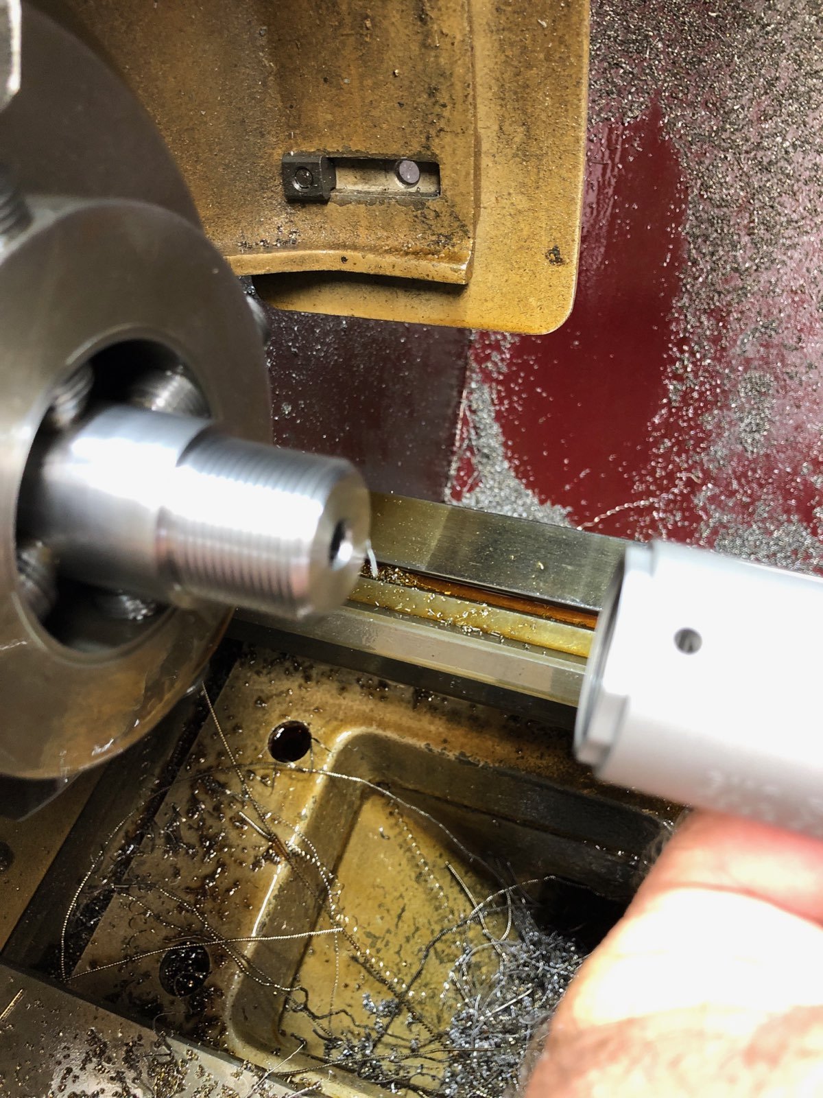

I was all-in on getting at least two of these until I found out about having to take 0.015" off a barrel tenon to use a Remage prefit. If one doesn't own or have access to an endmill or have the tools in their shop it's a huge bummer.
The few local smiths in my area are all backed-up forever, even for something so easy, and in the "era of the prefit" having to go "custom" (and therefore deal with the "custom" lead time) instead of just grabbing an in-stock prefit is dumb as fuck, even if it was the best action ever.
The extra money for an Origin or a Nucleus or whatever is absolutely worth it in order to not have to deal with that nonsense IMO, saving a couple bucks isn't worth the headache.
BTW I'm not just saying this to be a jerk or whatever, I really dig the simplicity of the design and it looks like a great action.
Northland shooter supplies will sell remages with the .015” removed already.” Direct from Criterion I believe. More prefits will show up as these get popular too.
