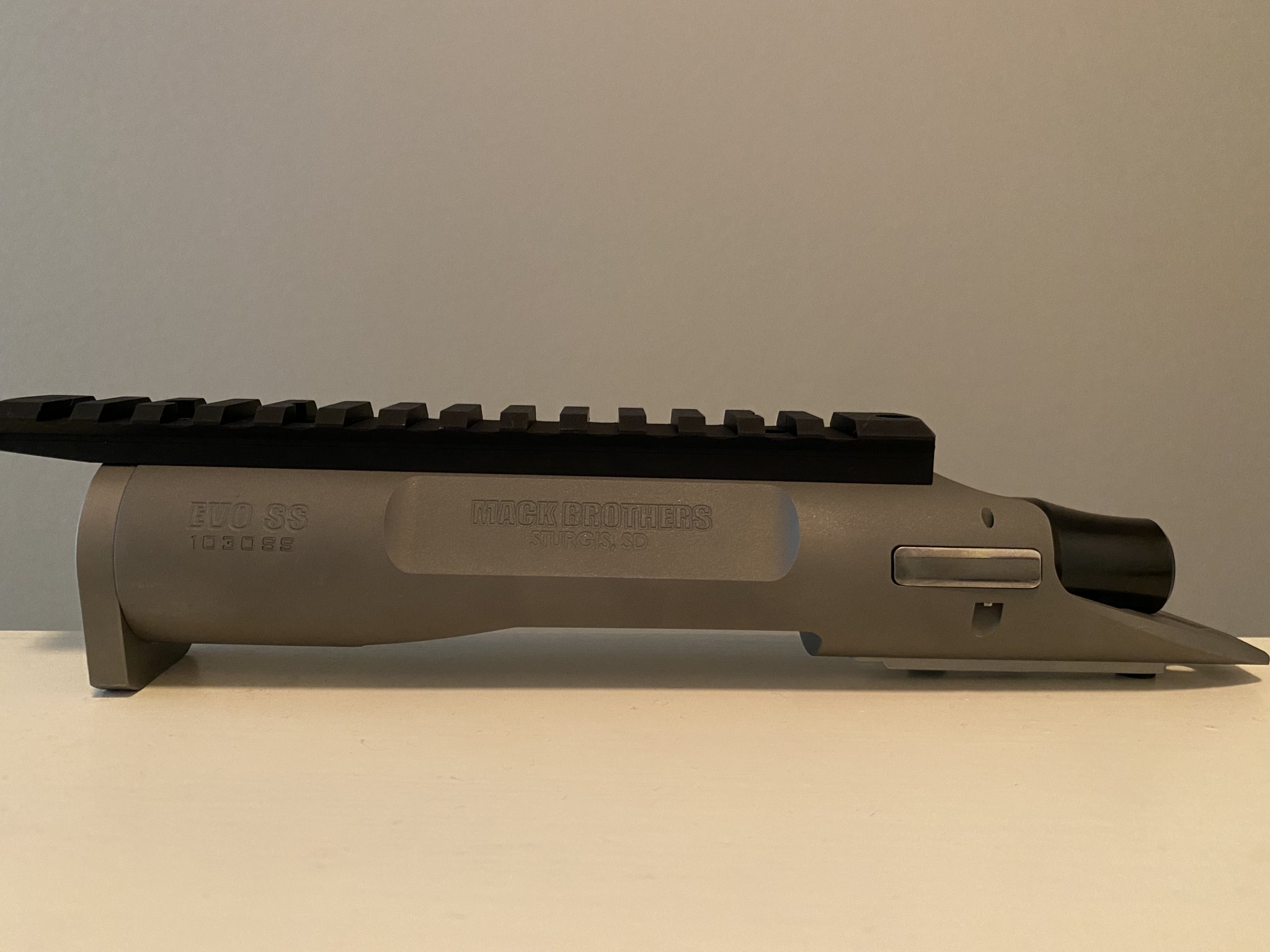

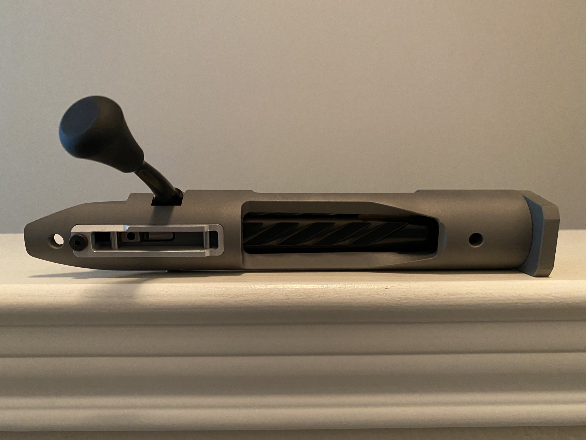

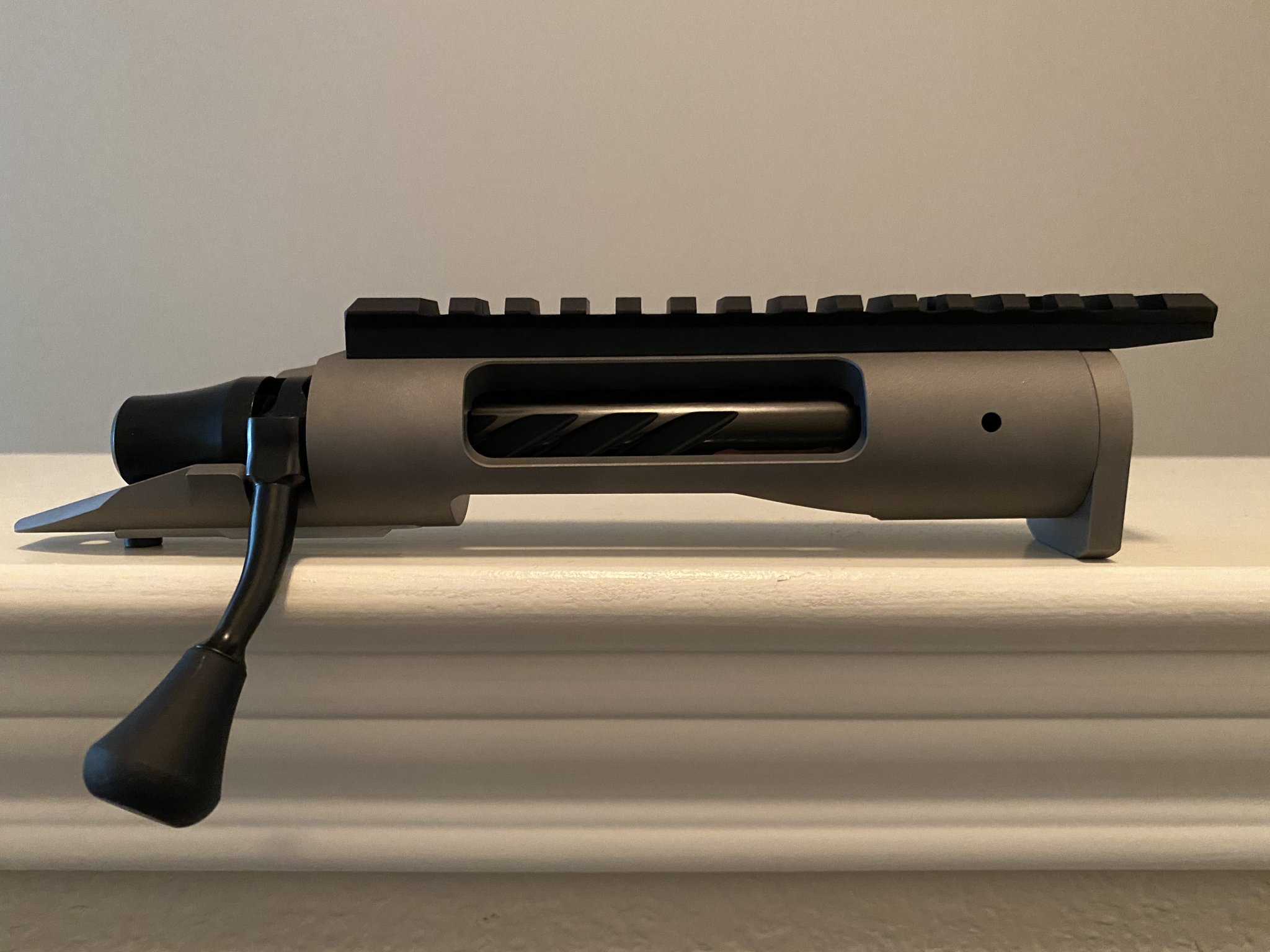

Just received mine. First thoughts. The quality of the machining is superb. It has a matte finish on the receiver not sure if its bead blasted or coating. Dull grey in appearance. The lug is machined with flats on one side and it locks with the receiver. The bolt is coated black. It is a small firing pin which is a plus for SRP cartridges. It has a swept handle that is not welded but machined as one piece with the bolt. Primary extraction is very positive and as mentioned before the firing pin fall is hard. Not sure what firing spring weight they used but you can feel the weight when cocking(not too heavy). Not a bad thing but worth mentioning. The firing system is a bayonet style and comes apart very easily without tools. The trigger hanger uses one small hex screw on the rear and was very easy to install also. Not sure if Mack Bros offers different hangers to tune different triggers. IMO the action is very well machined and the features it comes with compared to higher end actions is a bargain. The action does bind when trying to manipulate it fast. Hopefully when it is well broken in it'll bind less. I plan to have this action DLC'd to see if it will run smoother.

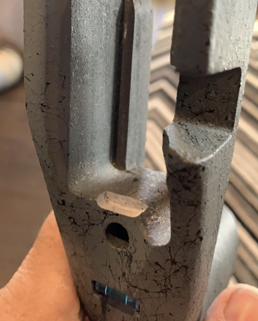

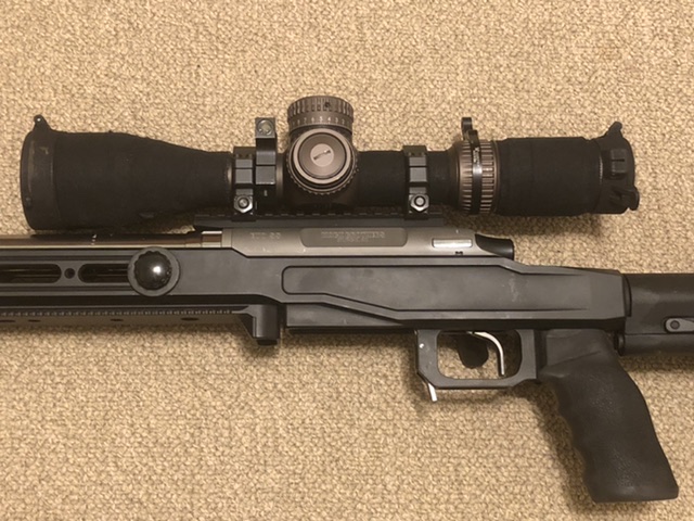

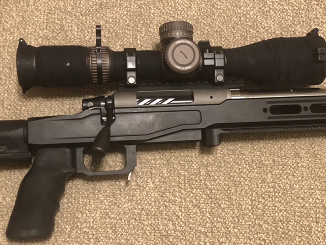

I back ordered an action mid-July and received it the end of July. I used the action to replace a factory Rem 700 with a Criterion barrel. I did have to remove .010” off the barrel end to headspace the chamber. I‘m using a first generation XLR Element chassis and had to cut a slot in front of the rear action screw to allow clearance for the trigger hanger attaching screw.
The finish on the action is nice and it functions well. The combination action/barrel is very accurate. The action does not feel as smooth as my Kelbly Atlas, however I’m certain it will improve once it’s been cycled more.
Overall I think it’s a great action, particularly for the price. I will probably buy another.

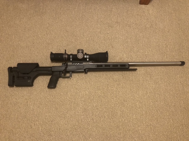

Here’s my rifle with Mack Brothers action that replaced a factory Rem 700 action. Criterion 26” MTU profile SS barrel with Remage nut, Timney trigger with straight blade, first gen XLR Element chassis and universal Area 419 Arca Swiss rail.
I like the rifle and am planning on getting another Mack Brothers action and Criterion barrel to set up for 6 Creedmoor. The only thing I did not care for with the action was the bolt knob that came with it, so I replaced with a longer one.
I really like the trigger hanger, however I did have to drill the chassis to allow clearance for the attaching screw.

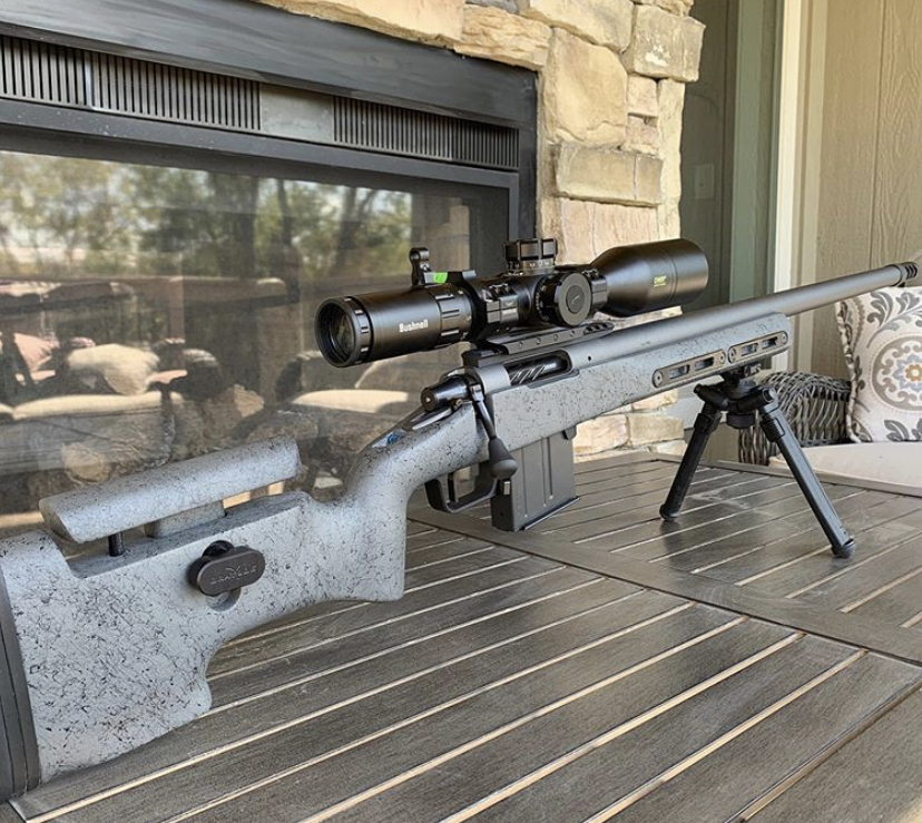

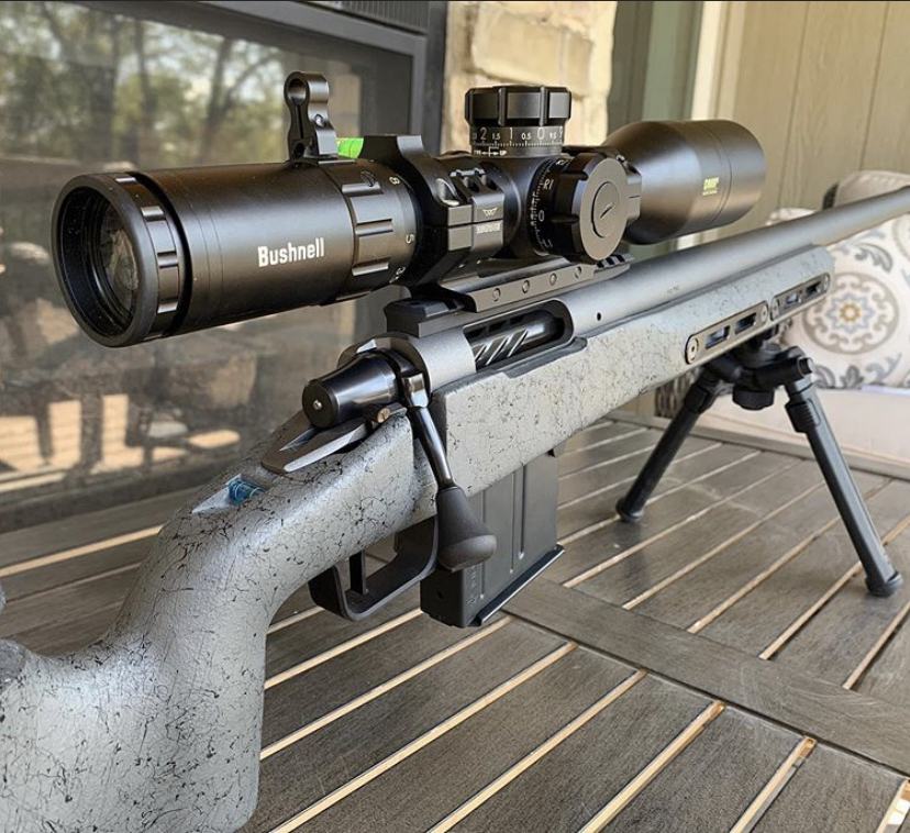

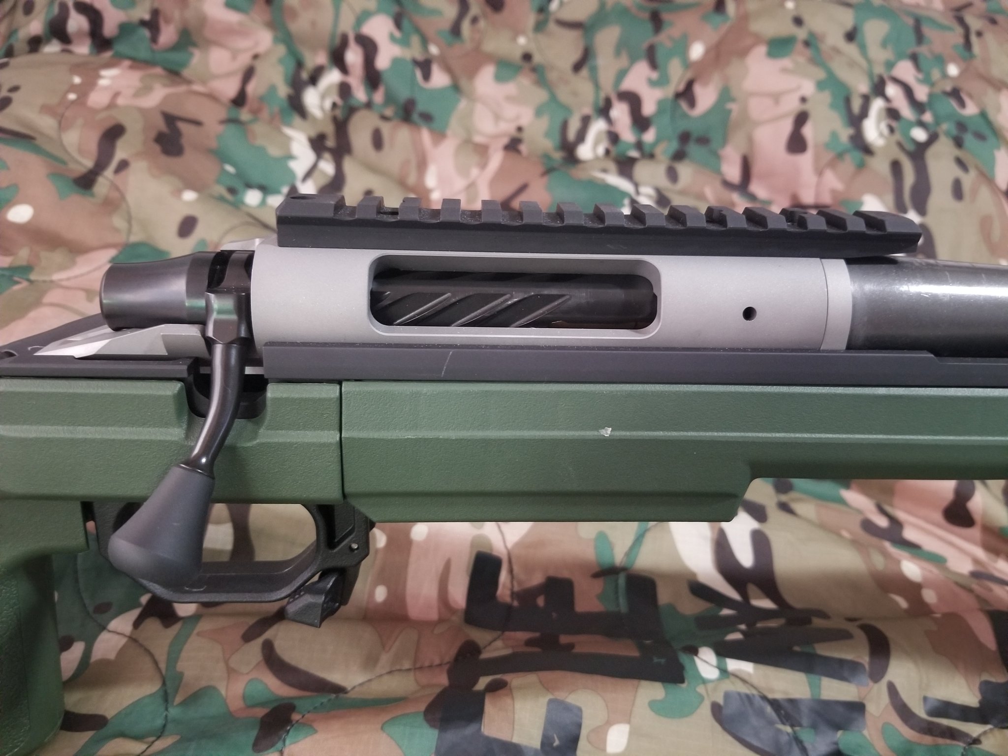

This Action is a stellar deal. Very smooth bolt and the primary extraction is excellent. Had this one built out as a 6.5 PRC with a Proof competition contour barrel. Dropped into the grayboe with minor inletting for the trigger hanger. Still need to open up the ejection port area as soon as i get touch up paint for it.
