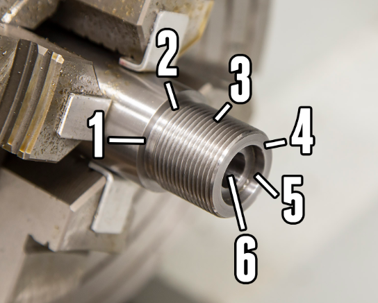

So, if I am understanding, a standard Remage (I understand this pic is of a shouldered barrel) needs to be shortened along #5 because the face of the barrel chamber #4 is touching the bolt face or lugs?

Yes that is also what I understand. I'm bringing it to the smiths with my action once it arrives to check for contact. I'm not too worried about it as I was going to have my barrel threaded anyway and the price is very reasonable for the additional cut.
For 15$ my guy talked me into it. I mean you could take off 10 though with a file in not long though.
Didn't seem worth it even on a "cheap " $350 barrel just a lot of heat, chips, and uneven stress on a brand new barrel doing it on a grinder

He could cut the threads on the muzzle end with the lathe and use a file on the end sticking out, and save the hassle of chucking it twice. For $15 bucks I bet that is all he does, lol.

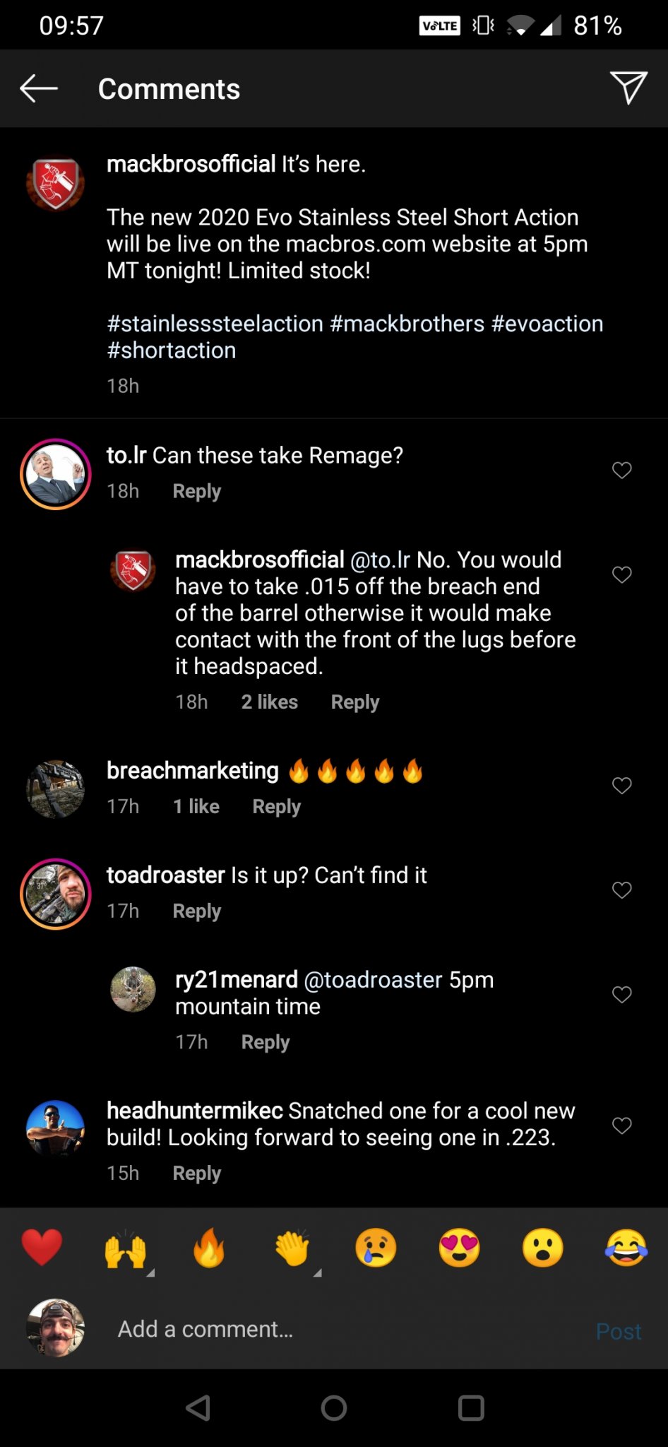

Is the 0.015" cut from one of there actions or from the bolt in a standard 700 action and the reason I bought one is because it is my first custom rifle and for the features it has it looks like a great deal. I almost bought the ARC 4th sale but the weight of the rifle was more then I wanted right know. the only down side I can see is not going with the savage threads.
Does the shorter barrel stub mean you need a custom remage barrel? or will a standard remage prefit work properly?
Look at the pic in post 155 above, my understanding is the area #4 in the pic on the barrel is too long on a standard Remage. Just need to cut back a standard remage barrel, or it appears Criterion will do it for you. It doesn't affect the chamber or anything to cut it back.
A few months back I talked them into sending a remage for test fit and Mack Bros confirmed the clearance issue with the bolt lugs hitting the barrel right at headspace depth.

OK, Based on this message from Mack Bros, can you take 0.015" off of the front face of the lugs in the lathe and be free to Remage to your heart's content ?
I would just do the barrels, as lazy as I am it makes little sense to mess with the action.
You could trim the lugs back but you would remove the nitride coating so it won't be worth it. you would be better off reducing the depth of the counter bore on the barrel or removing it all together. As you would still be able to use the barrel on another action.
