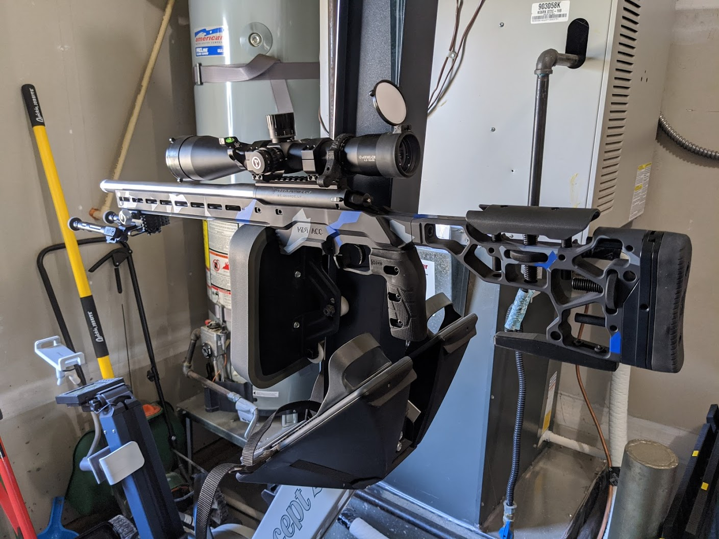

I've got my ACC with 300PRC down to a slim trim 21lbs now....going to add maybe 1.5lbs soon with the difference in scope and mount. Going with the 5-27 ZCO MPCT3 with a Spuhr mount. That weight is with the Atlas Bipod, Hoptic quiver, and an empty MDT CIP mag. Add 5 rounds to the mag and 2 in the quiver and it pushes the weight up. Feels like a pig...kicks like a kitty.

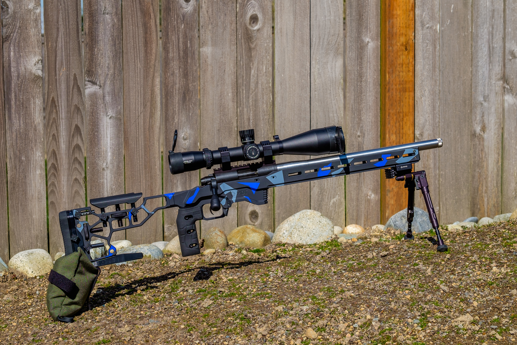

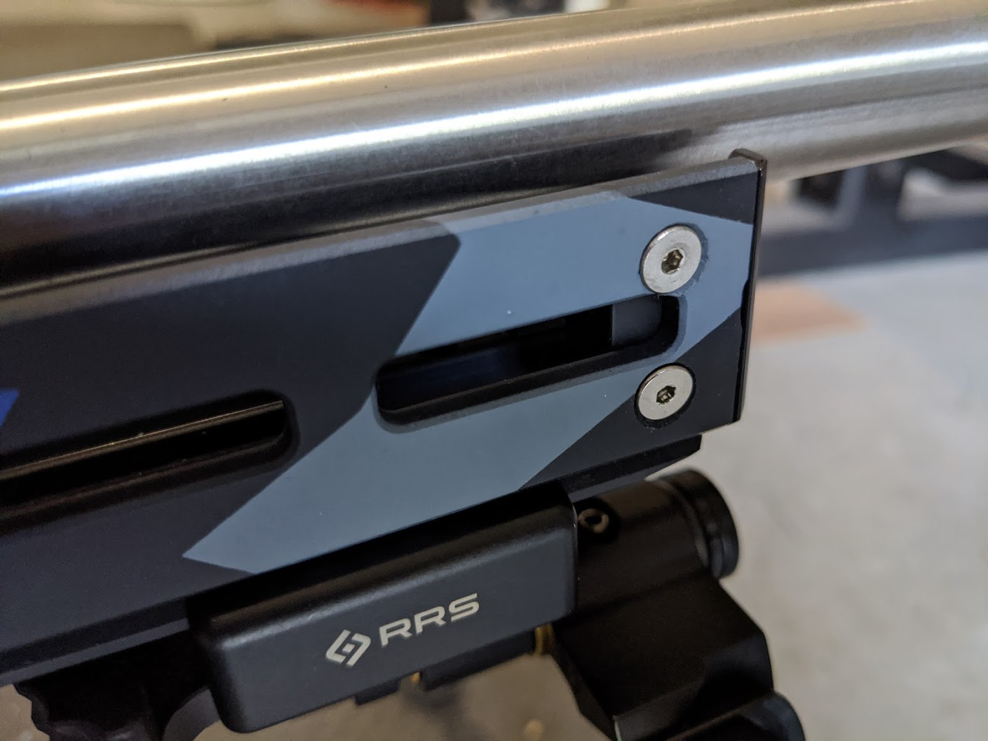

Here's the ACC cut down 3.5" to make it fit a nice 18" Vudoo.
Thanks man...I wanted to see exactly where you did the cut and added the screws.....looks very nice. I hope that setup works wonderfully for you.
Thanks! I'm excited to get this Vudoo out there and get used to it. I've been shooting a 10/22 in an Oryx and a MDT ACC with a Tikka T1X 20" all season long for NRL22. 2 months to get used to it before NRL22 nationals.

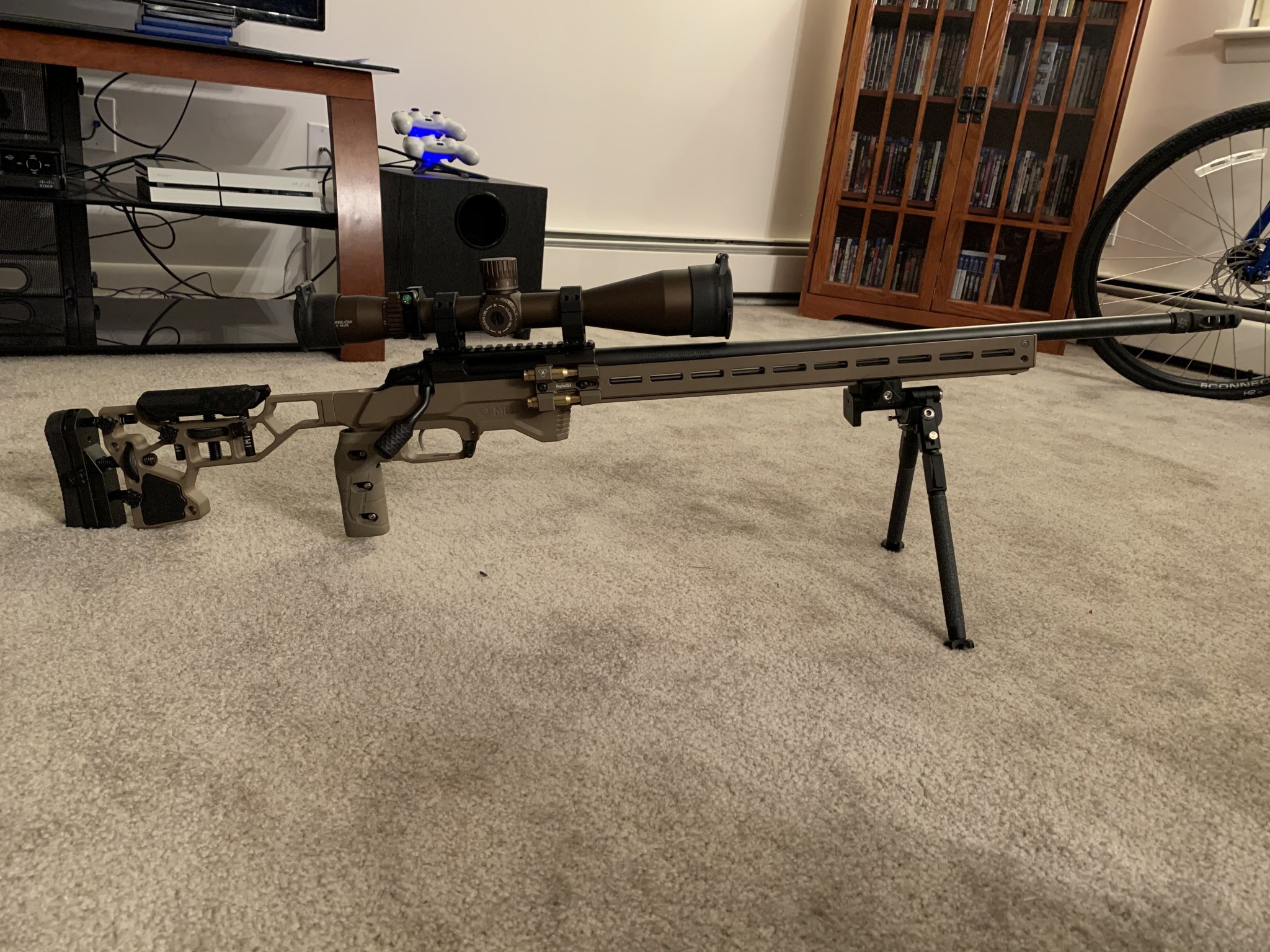

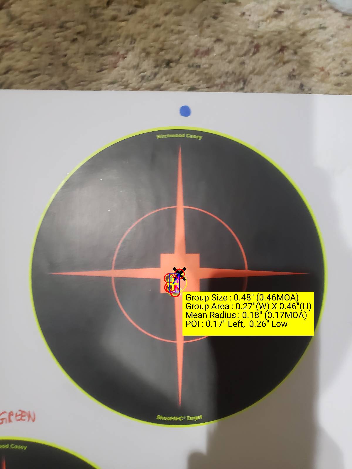

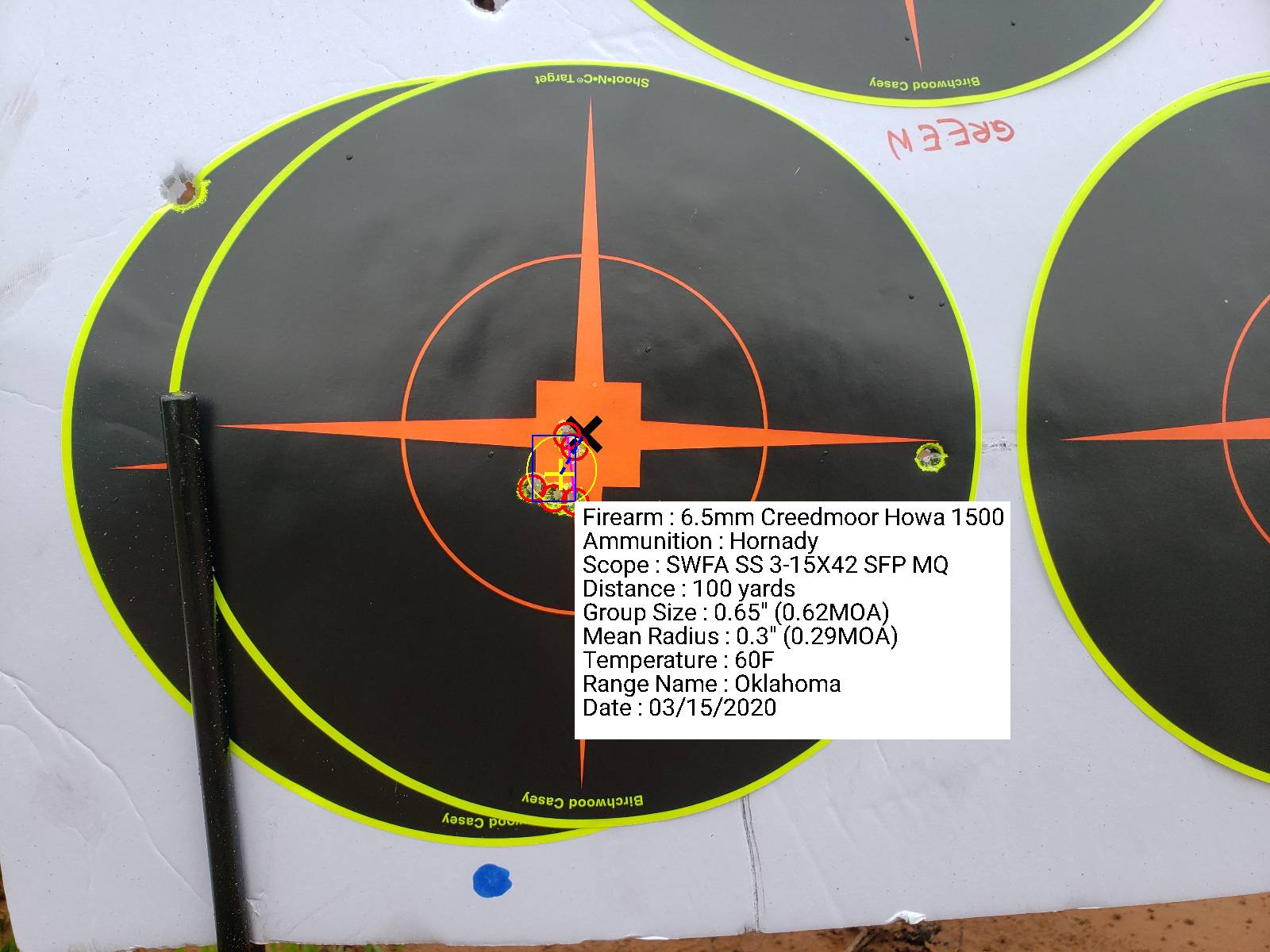

I dropped a Howa 6mm Creedmoor barreled action into one. I like the ergos, and it definitely feels solid.
I can't say if it improved accuracy, because this rifle hasn't had any other stocks. However it holds .6-.75 moa with factory hornady pretty regularly... and it did this with some Copper Creek Berger 109 loads a little while ago:

Looks good! The Howa's are really solid factory barreled actions.

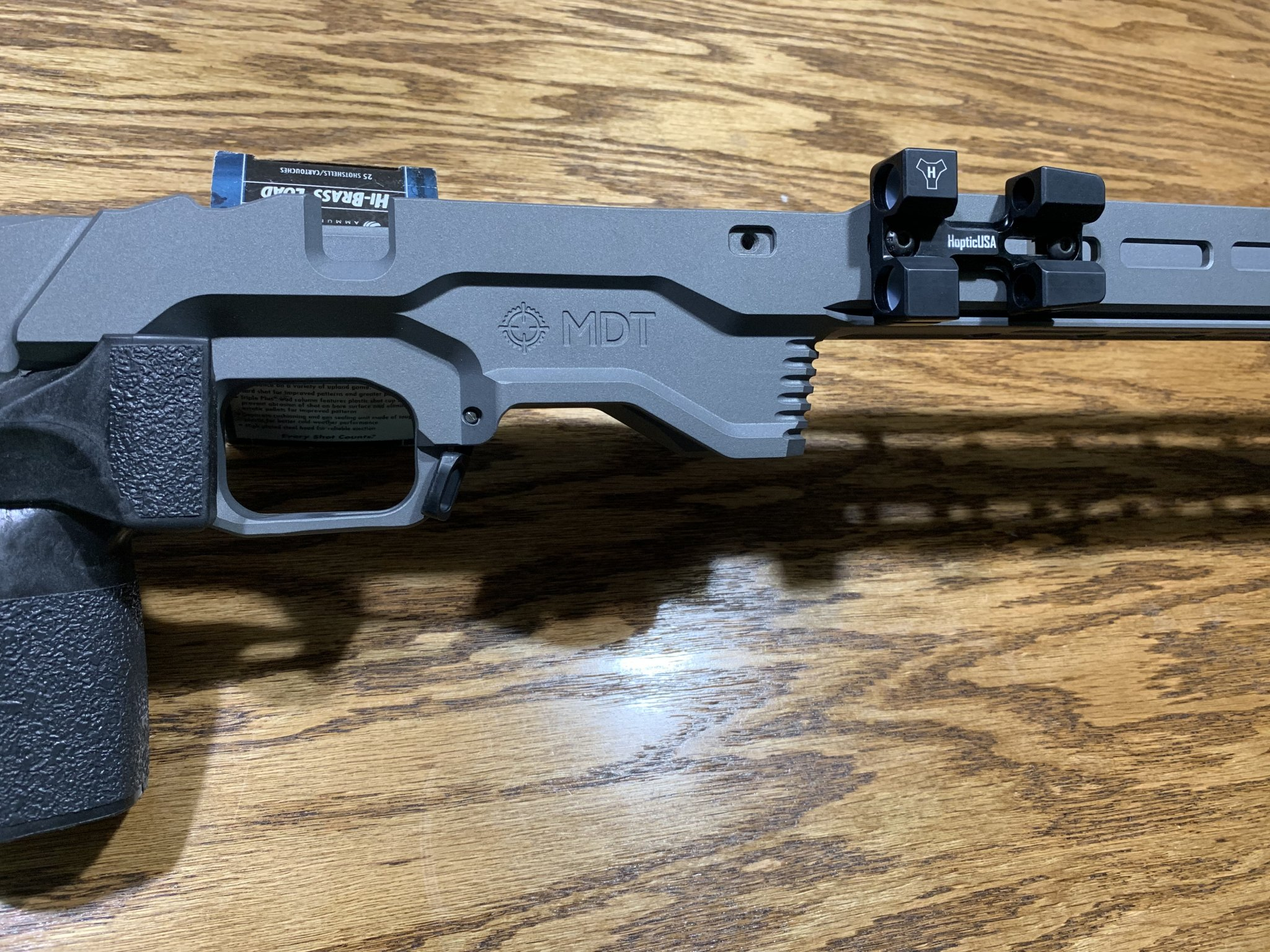

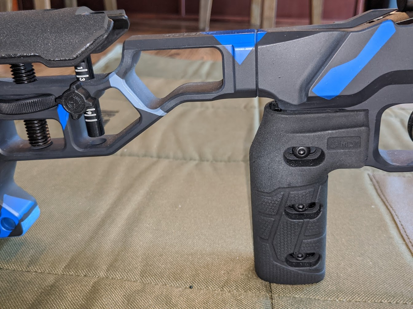

@MDT_Josh question regarding the LoP. I am switching over my Tikka ACC to a R700 ACC, the ones I bought were in October/November so they're at the 13.5" LoP. It looks like the one I'm trading with was purchased in March of 2019 direct from you guys which I am guessing was around 13.75-14"?
Was the extra length on the fore-end or on the buttstock?
I run a 13.5" LoP, so I'm worried now that what I just traded would be too long and looking for solutions.

Hey @littlepod , good questions!
So we removed that length from the buttstock side (as you can see in the photos you posted) and added it to the forend, as well as minimally shortening the buttsock itself. So we went from the roughly ~13.75" LOP down to 13.375" by doing so. The chassis that you will be trading for has the longer buttstock and longer interface, meaning that the minimum LOP on an R700 SA chassis should be 13.5-13.75" depending on the buttstock it has on it.

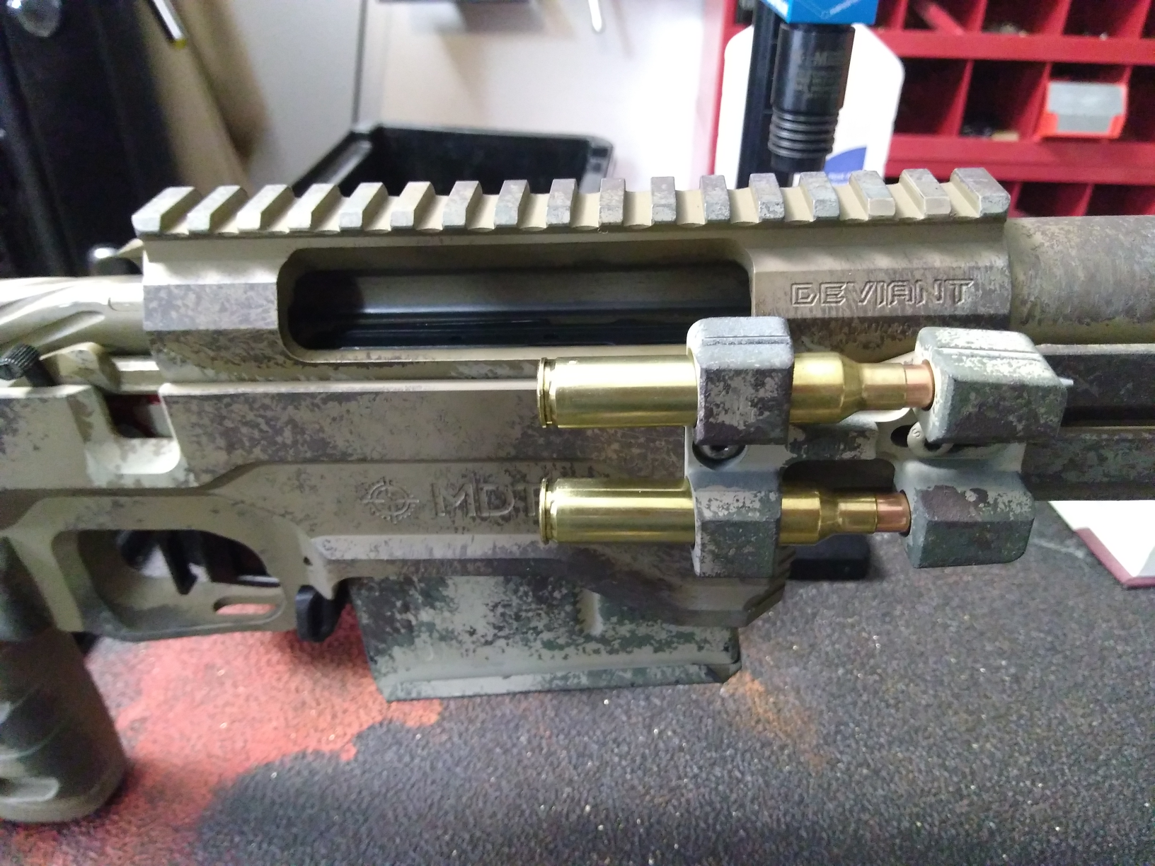

I wanted to grab a quiver for the ACC, but it looks like mounting it in the spot that it was made for might be too close to the ejection port.
Noticed that someone else ran theirs -
In general, feedback on pros/cons for the Hoptic Quiver? Someone recommend something differently? I think I can just buy the m-lok version and replace the left side with a screw that goes into the hole.

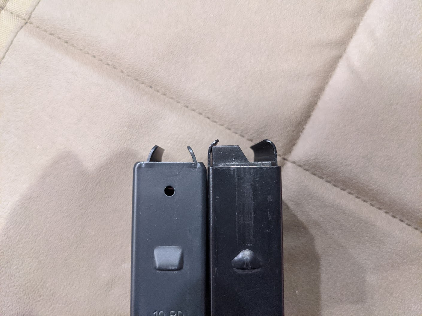

@MDT_Josh question, as I've only run AICS mags, I just got a new action that accepts AW magazines so I bought an AW magazine but it won't lock.
It looks like the feed lips on an AW magazine is a bit longer so that means I'd need a mag release that's shorter? I guess I won't be able to interchangeably run AICS and AW mags... was hoping AW for 10 round stages and AICS for when I need to do the 12-15's.

Good question @littlepod ! What action and chassis combo are you running? Is your action cut to accept AW magazines?
Most R700 clone actions that are cut to accept AW magazines, when dropped into the ACC will latch AICS and AW magazines without issue :) If anything, you may need to remove a little bit of material off of the magazine latch (or we can send you a slightly shorter one), to account for the variation between the mag latch heights on the back of the magazines. You shouldn't have any issues being able to run both styles magazines in your gun and chassis, some setups require a little more tweaking than others though.

I'm running the MDT ACC with a Terminus Zeus right now. It is cut for AW mags, and the feed lips do curl in correctly into the action. It's pushed far enough up that it won't go any further, and if it did the bolt would be hitting the feed lips. So it seems a slightly shorter mag latch would really help.
I'll PM you. Thank you.
