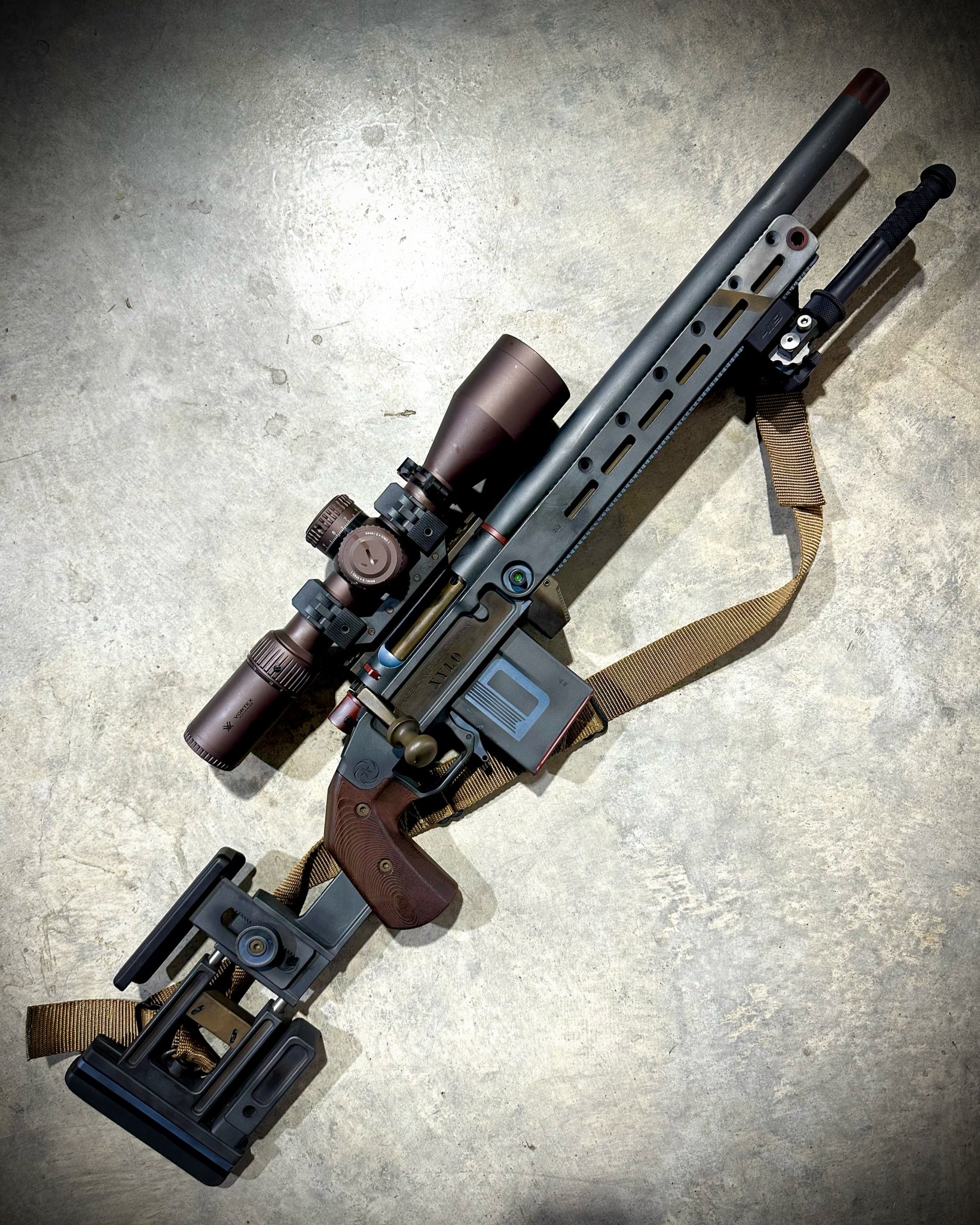

I think I like it angled back best, matches the ATX top cover (among others). Forward just doesn’t look right. Ideally they’d angle toward the middle on both ends /——————\, but it is what it is.

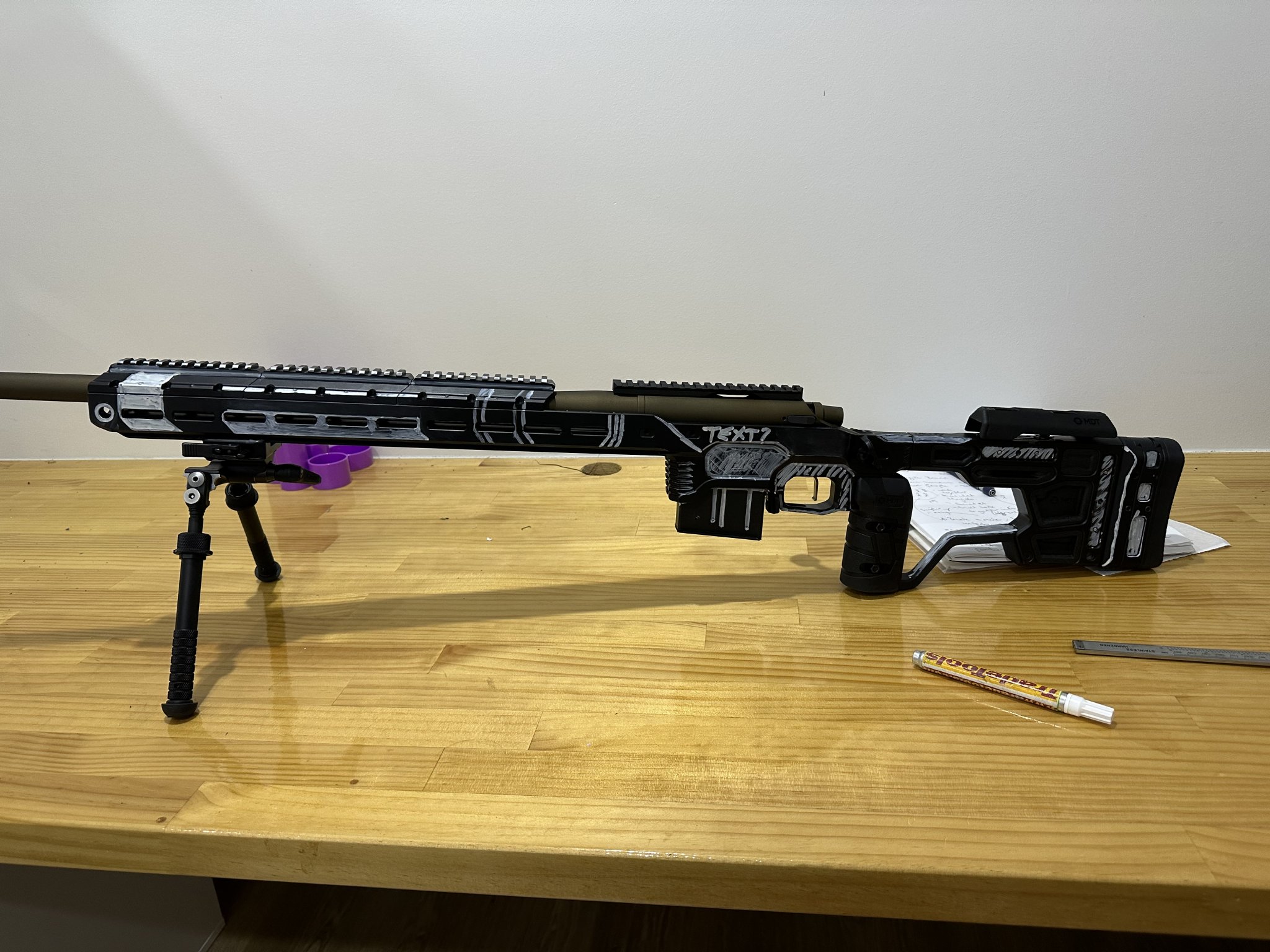

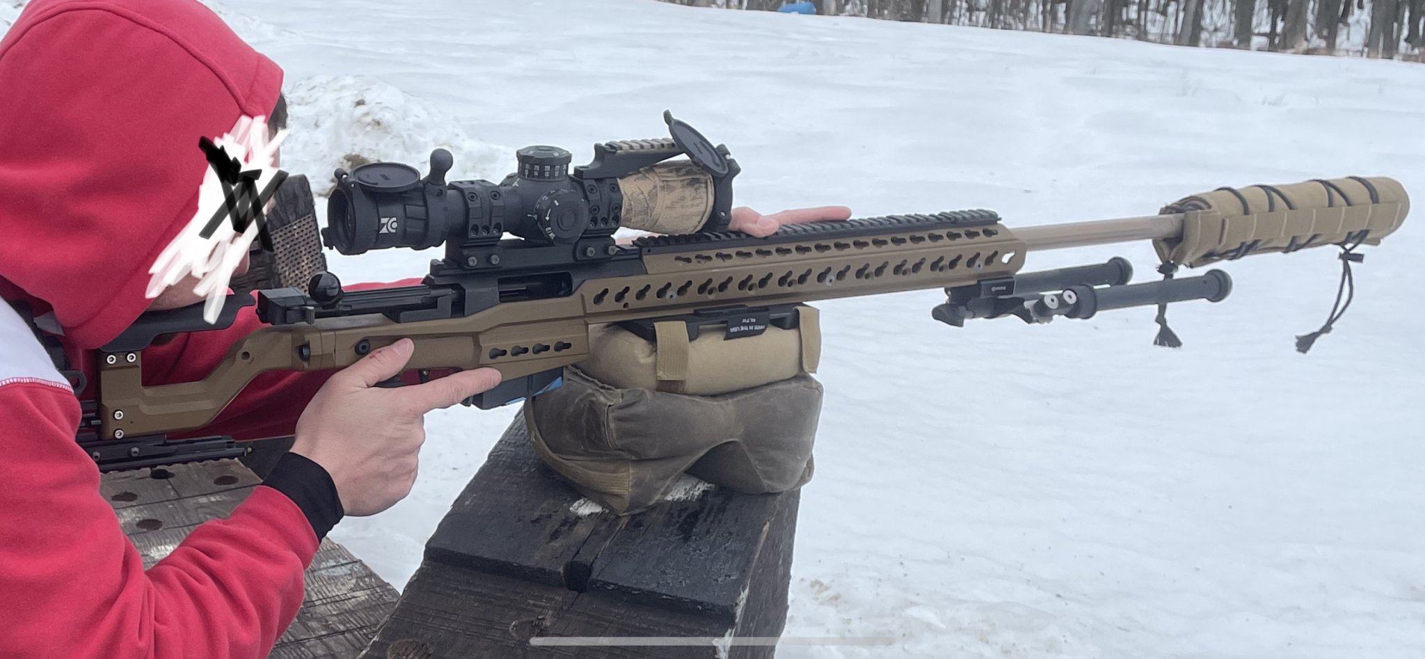

I’ve been messing around with a paint pen for the scheme on this elite - doing something a bit spacey-something schemed, in a similar vein to my little 223ai.

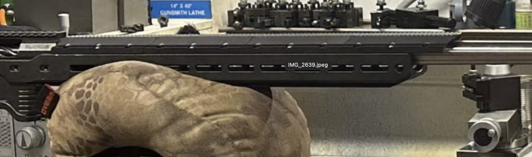

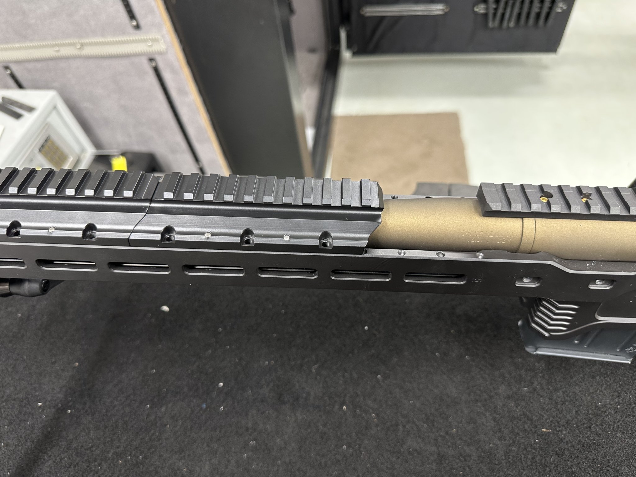

@MDT_OFFICIAL and @MDT_Josh
Just a generally curious question.....what is/was the reason for the control/nvg bridges not being able to cover the entire forend without some overlap?
I generally place my hand anywhere from right under the optic objective to as far out as I can reach comfortable in the middle. So, can just run two bridges.
But just on the aesthetic side, IMO, looks better with the entire rail covered. Also covers entire barrel to help with mirage.
Again, nothing bad. Just generally curious the thought process on not making the bridges a little shorter or a littler longer where 3 or 4 bridges would completely cover the forend.

Good question! In many cases of aftermarket R700 clones, the scope base rail sit's flush to the end of the action, but on an actual Remington with a bolted on scope base rail, it is extremely common for them to overhang further forward (including our design). In that case, it is illogical for us to make the NV/Control bridges flush with the front of the action because we'd almost certainly run into compatibility issues.
Poor engineering? Maybe they assumed nobody will want a perfectly flush fit covered rail? I understand the short rails in the ability to mix and match if you want a Pic rail atop the bridge. I don't like their execution of the bridge sections, I however have two atop my chassis.
Bold claim cotton! We generally avoid anything leaving our doors without being properly vetted, tested, broken and revised numerous times by internal and external testers, so the claim of "poor engineering" is a little hurtful. Regardless; I didn't anticipate shooters wanting to fully enclose their forend with control/NV bridges, and rather saw most o internal/external development testers running 1 or 2 of them along the forend to actually mount NV or use as a forward control point (hence the name). Furthermore, as the bell of your scope undoubtedly extends forward of your scope base rail (or integral rail) then it is not necessary to have the bridges extend rearward to cover off the chamber in the event that you are trying to bock mirage.
Finally, we do not try to Nickle-and-dime our customers as we were founded on the principal of our founder not being able to afford an AI chassis, so he made his own! We try to provide premium products at an affordable price range where possible ;)
<3 Josh
<3 Josh

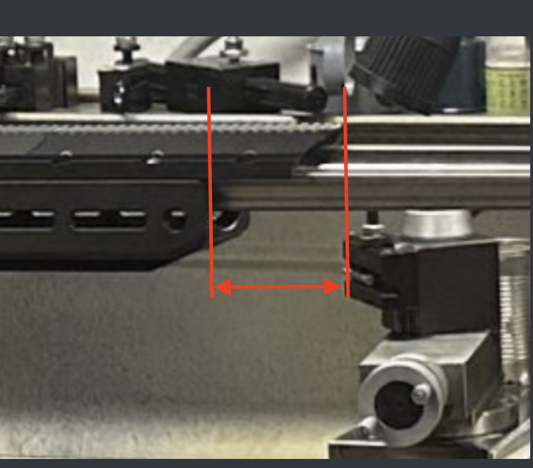

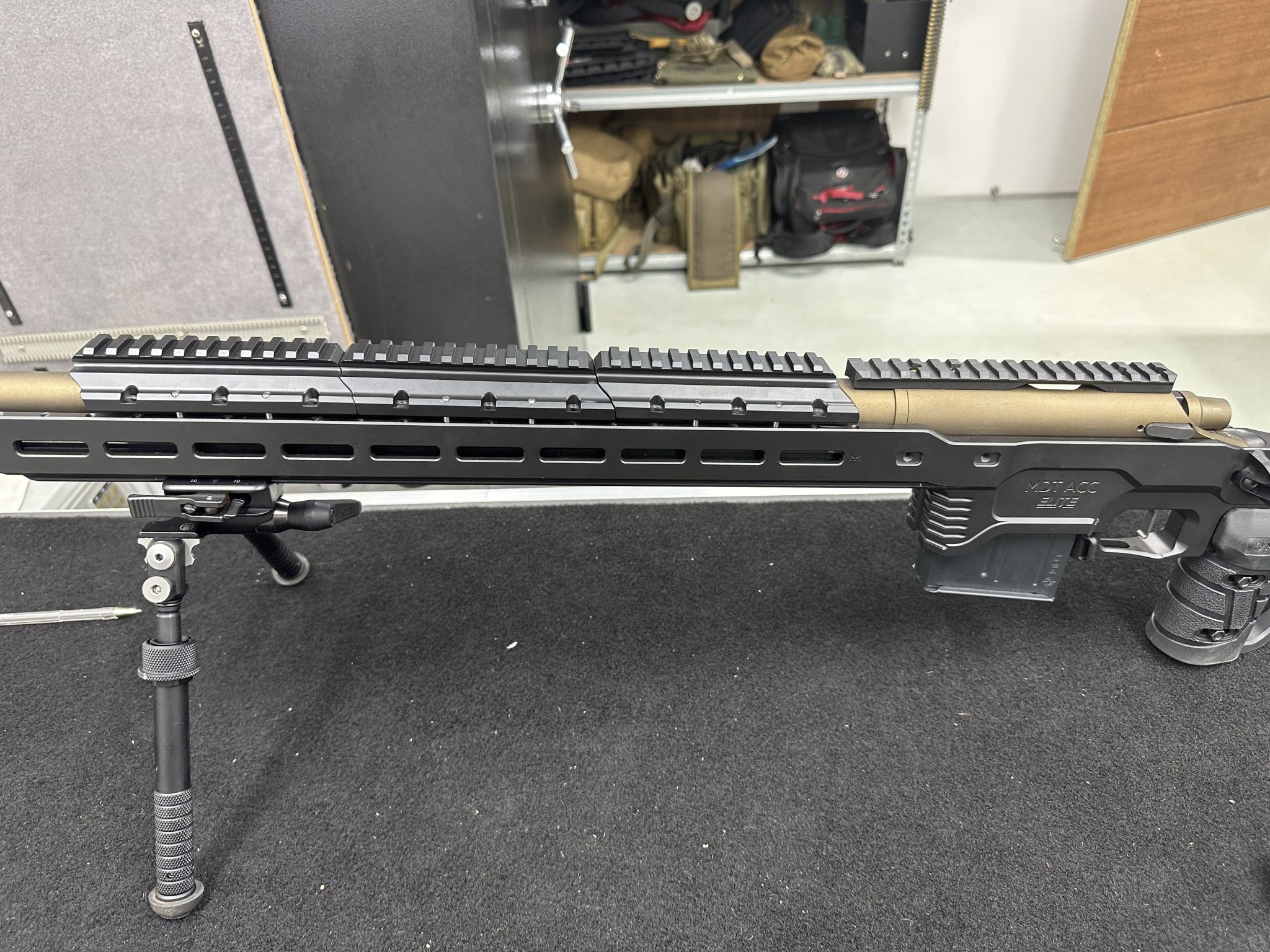

Thanks for the reply.
I wasn't asking for a bridge that sits flush with the action. I'm asking why you didn't size the bridges where one would sit flush with the muzzle end of the chassis if they were to also run a bridge all the way to the rear (as many actions don't hand over as you pointed out).
Seems like a very small dimensional (length) change would have made this possible. Just food for thought for future parts/chassis.
You could likely take the measurement between the two lines below, divide by 3, and add that length to the bridges and three of them would work. Then just have hole spacing in the forend which allows virtually unlimited placement. This would also align with not milking customers as only three sections would be required instead of four.
Could also offer a single piece control and nvg rail that covers the entire forend. Not sure if it would be popular enough to warrant a run of them. But if it was profitable enough, it would also add even more rigidity to the system.

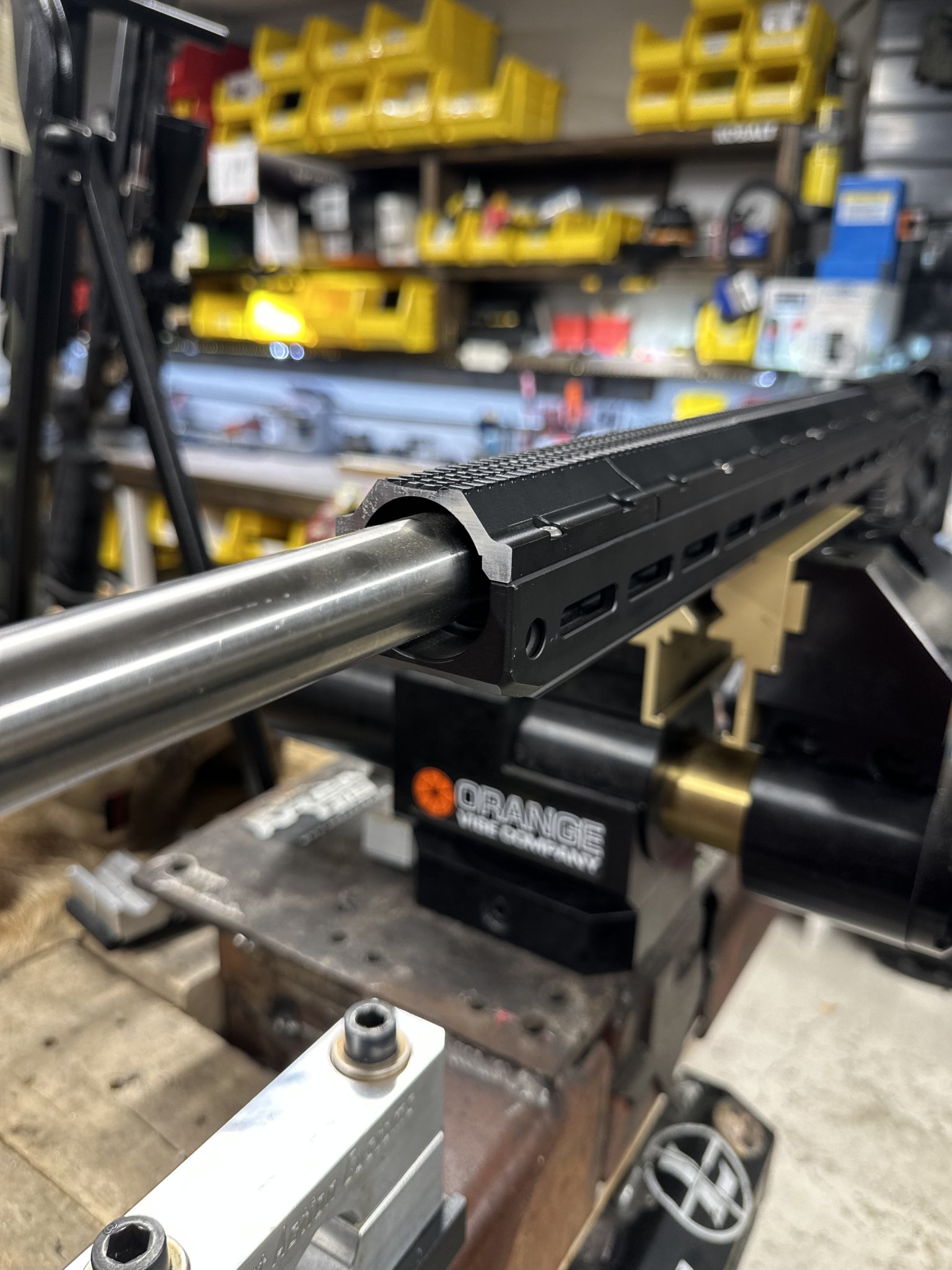

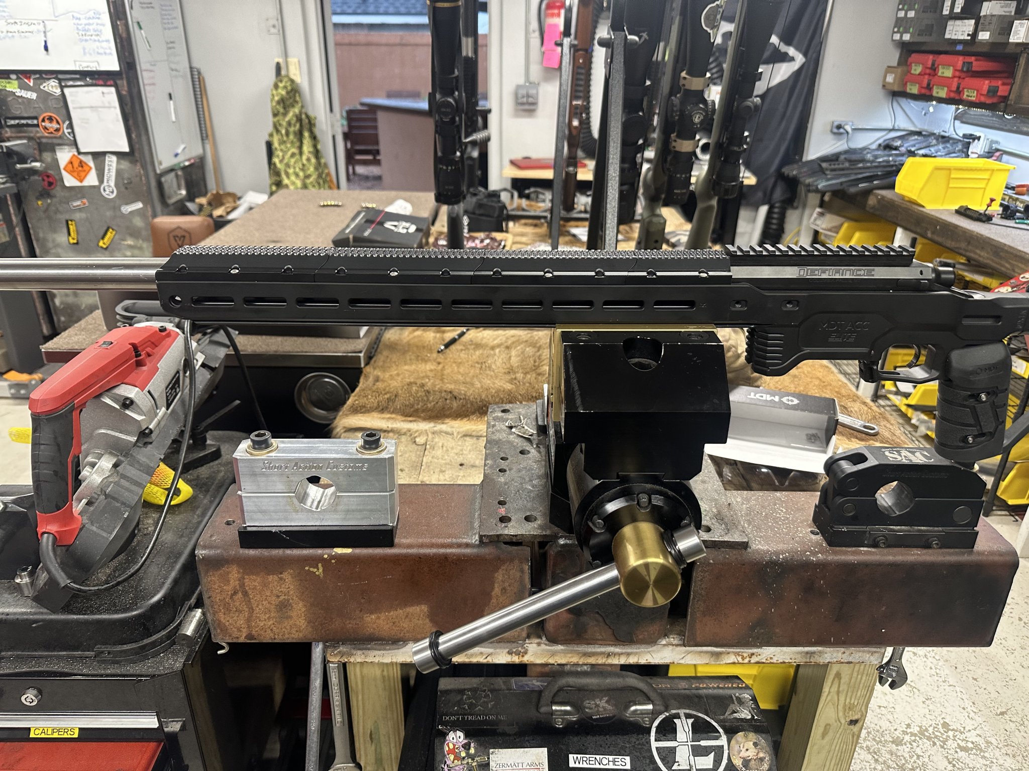

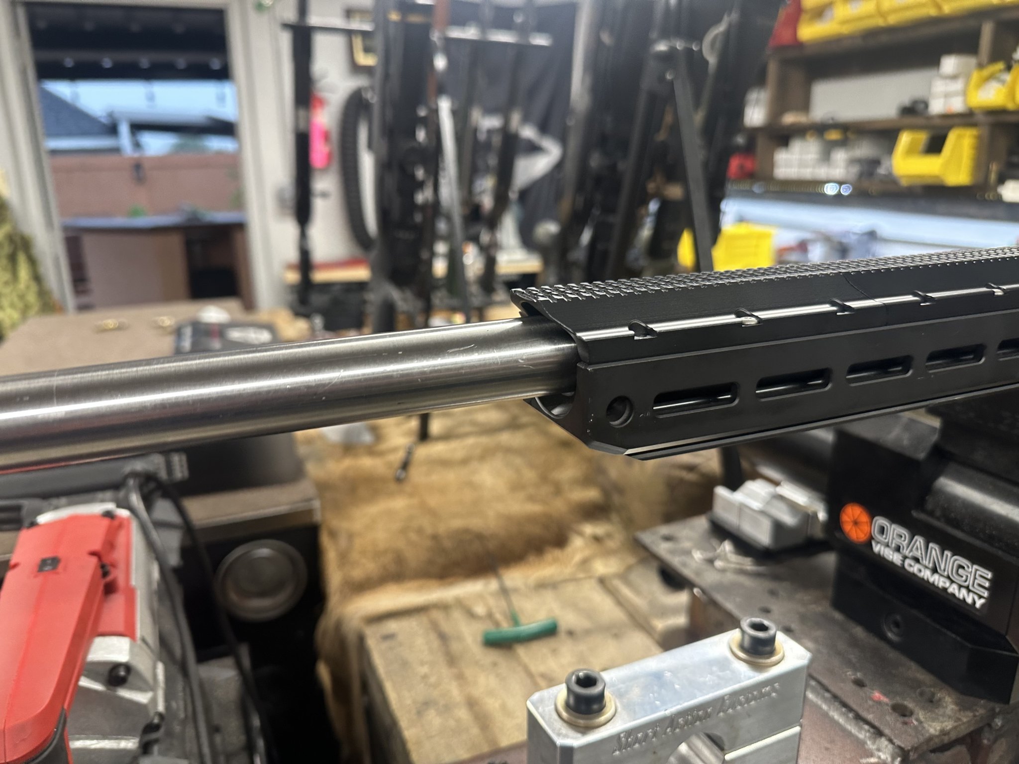

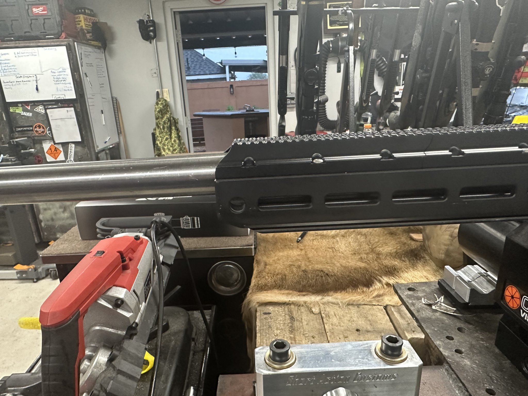

Gah, it’s so annoying that 3 top covers doesn’t give you a fully enclosed chassis. Im still trying to figure out if I like them pointing forward or back, but nonetheless, it’d be cool to have an option to have them run further back.
The picky/dumb part of me wants to buy a 4th and mill it to suit, but I already feel like a dumbass for spending $450 on these when I bought an entire KRG Arca enclosed forend for $280.
The things we do to make shit look cool.
View attachment 8205190View attachment 8205192View attachment 8205191
Hadn't read through the whole thread. Glad we aren't the only one's who would like to see a full rail.
Probably will do something ridiculous tomorrow and either mil or cut off the end of one to sit close enough to action for the 4th to sit flush at the end.
I understand what you're saying, and I think that we both agree, we're just handling the problem from wither side of the forend in this case! What I am saying is that in order to remove that overhang at the front, you'd move the bridges all back a notch on the forend, but then you'd run into your action/scope base at the back. We never intended for anyone to want to run a control bridge(s) all the way from front to rear, and maybe
that was a mistake on our part.
Regardless, we can look into making a single piece control bridge or NV bridge, I am also just not sure how big the demand is!
- Josh
Reactions: Ronws
- Josh
