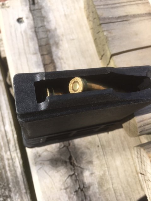

I put an Oryx on a Savage 10 308 that I've really liked. So, I decided to put one on my Savage 10 .222. I had a laminated thumbhole stock on it and thought an Oryx would be a better setup. However, I'm having trouble with the poly mag I got with it. My bolt has to be COMPLETELY back and just barely clears the top round enough to pick it up. When I try to chamber that one the bolt drags on the next round enough that it pushes the round forward and somehow forces it to nosedive into the front of the magazine!! I can't figure out what happening here. Any ideas?
Do you know if the bolt is coming back far enough? The shorter calibers have a longer baffle/bolt stop so you don't need to cycle the action as far. If you load two rounds in and make sure they are pushed to the front of the magazine, will it feed then?
I've loaded the mag as I normally do with any type, that's pushing the cartridge all the way to the back of the magazine. If I do that I can't get sloppy with my bolt cycling, I have to pull it all the way to the stop. This barely clears the rear of the cartridge at this point. I haven't tried keeping the cartridges forward at all yet because I was unsure what the issue was. That'll be contrary to everything I'm used to but I can give that a try.
@coyotewillie I could be wrong, the smaller cases like 223 have the longer front bolt baffle stop. (small protruding section on the side of it, a picture of your bolt would help.) So if the 222 has a long silver section on the front baffle, that can be switched for one without too allow the bolt to travel further back.
@loveha Is right, the bolt stop/baffle can sometimes stop the bolt from traveling back far enough which is why if it feeds with the rounds forward in the magazine we can confirm that if that is the issue.
OK, but the bolt in fact does pick up the cartridge. Barely, but it does catch the cartridge. However, the main issue is the fact that the mag seems to be sitting too high and the bolt drags on the next case so much that it moves it forward and for whatever reason forces the tip down into the magazine. The bolt then sometimes catches on the raised rim and won't allow me to finish chambering the first cartridge. If I can get it to chamber, I fire the round, then the bolt sometimes catches going rearward and I have to release the magazine to bring the bolt rearward, ejecting the fired round.
I'll try to get a picture of the bolt posted. This rifle started out as a .223 but since I've always liked the .222 I just used it and rebarreled to the .222. And the action has been in the original stock and a laminated thumbhole stock and I've never really noticed it not catching a round before but it could have been close the whole time too. But the main problem is the second round nose dive into the mag. It seems like the mag is sitting too high, OR, is the action sitting too low in the receiver?
It could be seated to high, however, when we've seen this issue it mostly seems to be related to the baffle. This would probably be better moved to our support system so we can help you directly. It is [email protected].
Thought I ought to update on my feed problem after installing the Oryx stock on my Savage SA. Contacted MDT about it and after a couple of emails and a phone conversation back and forth we determined that the problem was in fact with my bolt. The problem was that the bolt head retaining pin hole (approx 1/4" Dia) was not chamfered at all on the bottom of the bolt. When the bolt is in the lifted position the pin/hole is vertical, and as you push the bolt forward to chamber a round the sharp edge of the pin hole would drag over and catch the rim of the next cartridge in the mag. This would push the cartridge forward and drive it down into the front of the magazine. There never was enough upward spring pressure on the original blind magazine to cause any problems before. But the higher spring pressure on the MDT mag pushed cartridges up so they contacted the bottom of the bolt more. All I had to do was disassemble the bolt and put a nice chamfer on the hole and it was fixed. No more sharp edge to catch the rim of a cartridge!
Anthony Bujak from MDT contacted me and was a great help in fixing the problem. Took the time to call me, went to their safe and grabbed their Savage sample rifle, took pictures of that bolt and sent them to me to compare with mine. I'm very impressed with MDT's customer service! Excellent service!

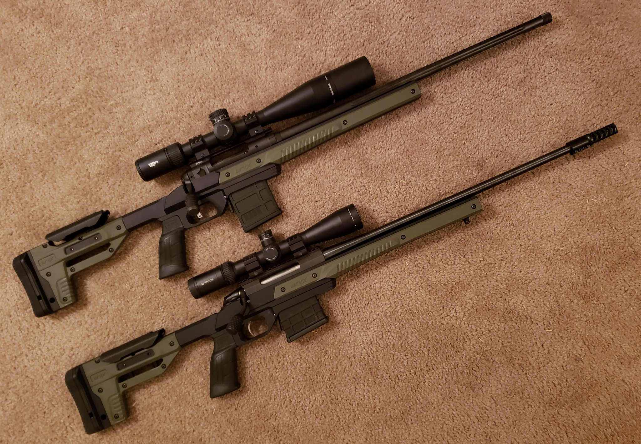

Just got my second Oryx Chassis! Now both my Tikka t3x lite 308 and Savage 110 6.5 creedmoor will be riding in chassis. Just like with the tikka the fit and finish is great. My only gripe is that the "offset washer" was not in the box anywhere to be found. I'm frustrated that I won't be able to shoot/zero it until I get that part.
@MDT_OFFICIAL any chance of getting one of those overnight shipped? I put in a request through the ticket portal (I know its a weekend I don't expect a response until sometime Monday) and it would be awesome to get the part ASAP.
