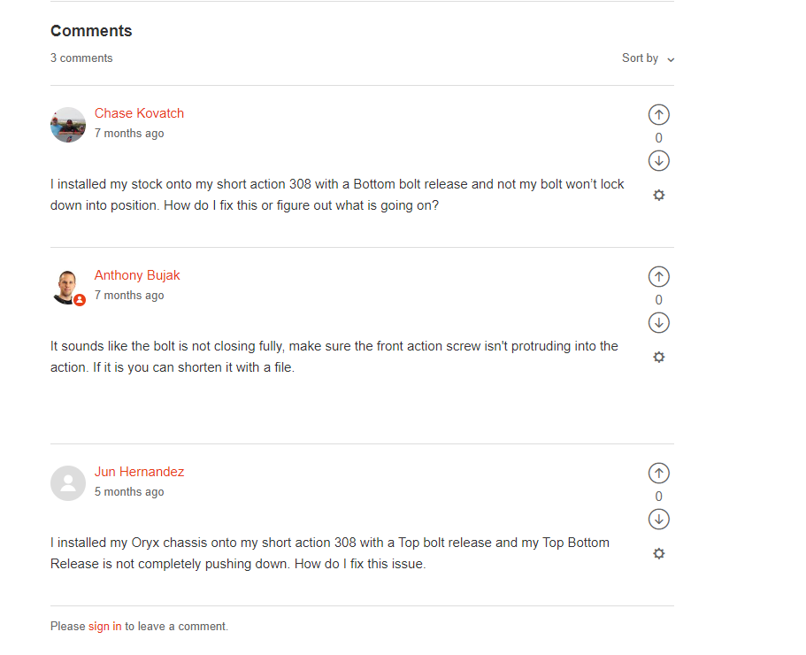

I see multiple folks saying the savage bottom bolt release model is having issues with the fitment and bolt closure. Can someone let me know if this is a real issue? Any happy savage bottom bolt release oryx owners here? Thanks
I'm thiiiiiiiis close to grabbing one of these for an upcoming rimfire project (Tikka T1x). The only thing giving me pause, really, is how much support it will get from MDT in the long term. I know I'm putting MDT on the spot by asking this, but do you guys have a plan for more accessories in the future like redesigned stock panels for riding bags? I would think you have an opportunity to build a little ecosystem around the Oryx based on the kinds of feedback and requests you're getting here.
We haven't had any reports of this.
Here's where I'm reading these issues on the Oryx website.....
Yes, the first one was just a slightly long front action screw, the other one I never saw. Likely, the trigger wasn't being pressed enough it can be tricky on a new Savage if you haven't cleaned it.

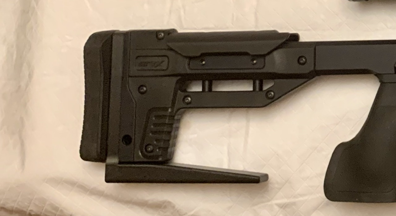

Guys. just an FYI for those that might want to color change the side panels/butt panels without buying a new set. The polymer that MDT chose REALLY absorbs the Rit Dye extremely well. I went from the green to black for about $2 and it looks perfect. I got the black and let the water almost get to boiling and used about 3-4 tbls. Let sit in there 5 mins. No purple huing either. I think Rit updated their black dye formula. Looks perfect.

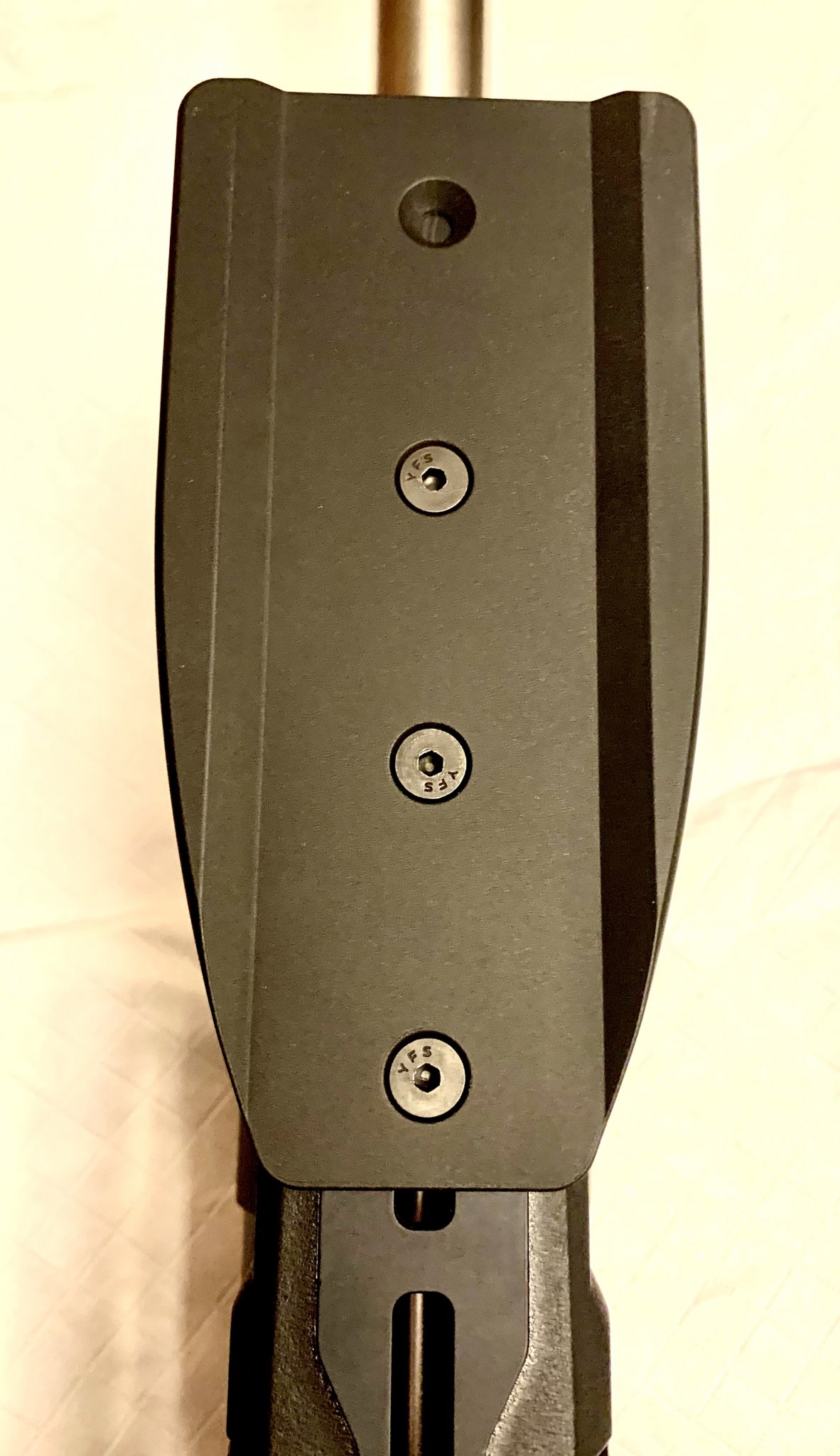

I was wondering if anybody has photos of just the chassis without the polymer plates on?
I haven't been able to find any photos online how just the metal underneath looks like.
Reactions: ggladck
Just wondering how it looks underneath.. usually a new product is disected within one week of released. But haven't found a single photo or video yet :)
You should make one for the SSG 3000 rifle!!

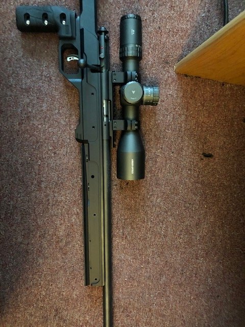

Here is a picture with one of the panels off.

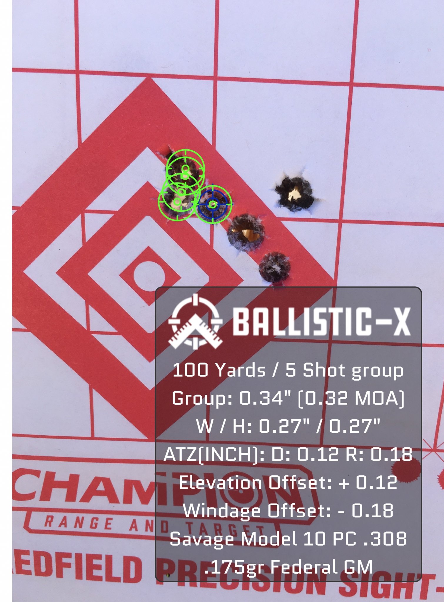

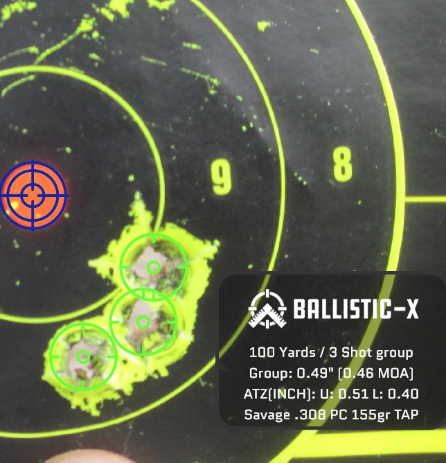

I dropped my Savage Model 10 Precision Carbine .308, in the Oryx stock. What a difference. While always fairly accurate, I would get fliers. This stock really tightened up my groups. That last group on the sight in, those other 3 rounds are from my Armalite TAC18 .308
