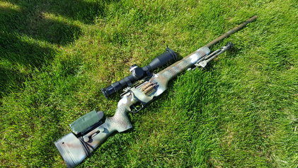

Got my minox today! (thanks cstactical) mounted it up this evening in a set of ARC rings that were in the box with it. Initial impression is great. First thing I noticed, it's light as a feather compared to a gen 2 razor. Reticle is awesome. Much better than the EBR-1c of the razor. For my shooting, I need something between the half MIL hash and the AMG as well as this MR4 are a god send. The clicks are not bad but I would say that both vortex scopes, the AMG and the gen 2 razor, have better clicks. I was real hoping that the minox would have clicks like the premiers did. The AMG is just about the same as they were. All in all, so far so good. The razor served me well for a few years but I'm at the point where the weight, reticle and stiff mag ring made me part ways. If they ever come out with the gen 2 razor with the EBR7 reticle of the AMG in it, I'd think about coming back. That may be worth the weight of that beast again to me at least. This minox is pretty F'ing sweet. Hope to get out tomorrow and do some load development with it.
Looking forward to your report... What do the clicks compare too? And how does it feel going from rev1 to rev2? Is the glass that much better than the AMG? Thanks
I'm wondering the same thing, the Minox with mr4 reticle and the AMG are what I'm looking at for my next rifle. Turret feel and low light performance are the main things I'd like to know about between the two. I've had many of Vortex optics and stil have some. For the most part they are great, I've never tried anything but Leupold and Vortex. I do have a Steiner p4xi but I know that one isn't made in Germany.
Haven't had the glass outside yet, or even set the diopter so hopefully we will see today. The clicks are similar to how I remember my gen 1 razor being. I haven't had any other scopes worth mentioning than the gen 1, gen 2, AMG and premier. That premier really ruined me on turret feel. Again, the minox isn't bad but you do realize how nice the gen 2 is once you spin these. It's really my only place for improvement in the minox that I can see so far. The first to second turn on mine is hard. Like hard enough that had I not already been aware of it being an issue I would have thought it was a single turn turret. Most people would probably think they were breaking the scope by the force it took. I've read that they eliminated that from US scopes. My box didn't have plastic around it and wasn't taped shut, so maybe it was a return to cstactical or something and an earlier model. Maybe it will loosen up with use, I don't get into the second rev much if at all anyway.
