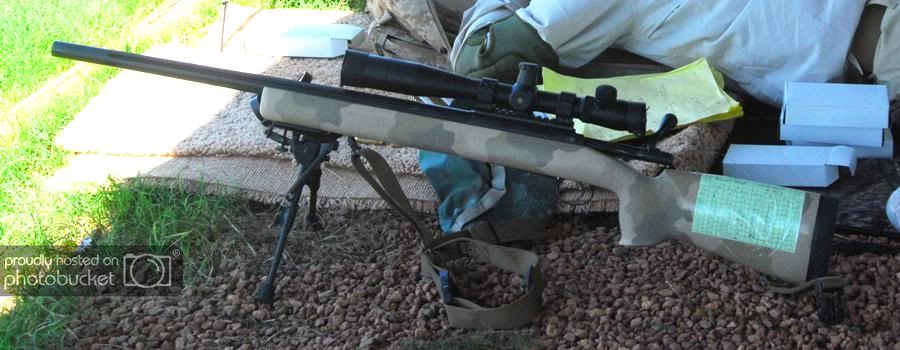

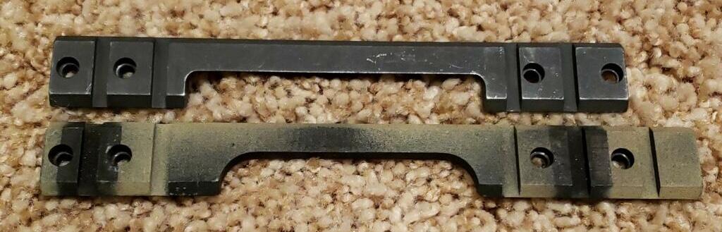

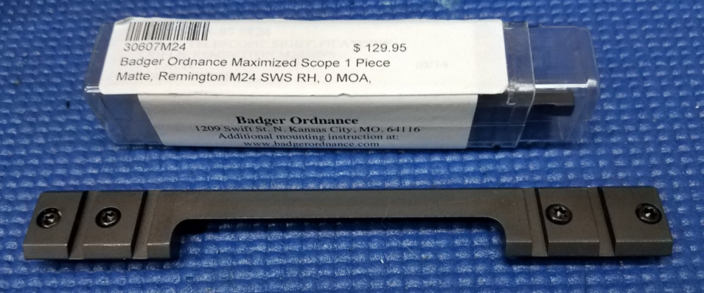

As shown by USMCSGT0331, there were 3 flavors of one-piece scope rails that were used from roughly the early 1990s to early 2000s on the 300 WinMag sniper rifles. They include a Crane scope rail (or more likely Leupold rail, per NSW personnel) with Weaver slots, (top) an early PRI rail with Weaver slots, that is about 1/2" longer (bottom). Both appear to be 0 cant rails. The 3rd and final rail used a Pictatinny style rail. With his permission, here's a picture of the unmarked rail with Weaver slots that looks just like the original M24 scope rail, along with the slightly longer early PRI rail that is marked "217" on the bottom. Both of these were used on Navy 300 WinMag rifles before the Mk 13 Mod 0 McCann rail was adopted.
Honestly, I think the top rail is the same early Leupold part used on the M24 SWS circa 1988, based on the identical physical aspects of the rail, and the fact that Leupold supplied the Ultra rings to Crane at that time.
7092831
(Note: The discontinued Badger Ordnance M24 rail as shown below is identical to the rail used on the early 300 WinMag
rifles and would be a good choice for someone making a replica of a "pre-Mk 13" rifle.)
7092835

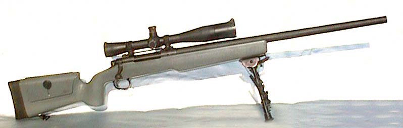

Here's a picture of US Army personnel using what I would call a ‘late pre-Mk 13’ 300 WinMag sniper rifle. Note the Picatinney scope rail, 10X Leupold scope with SIMRAD cap, and black barrel. My guess is this configuration was probably the final version before the platform got the standardized Mk 13 Mod 0 designation and the McCann rail.
7092833

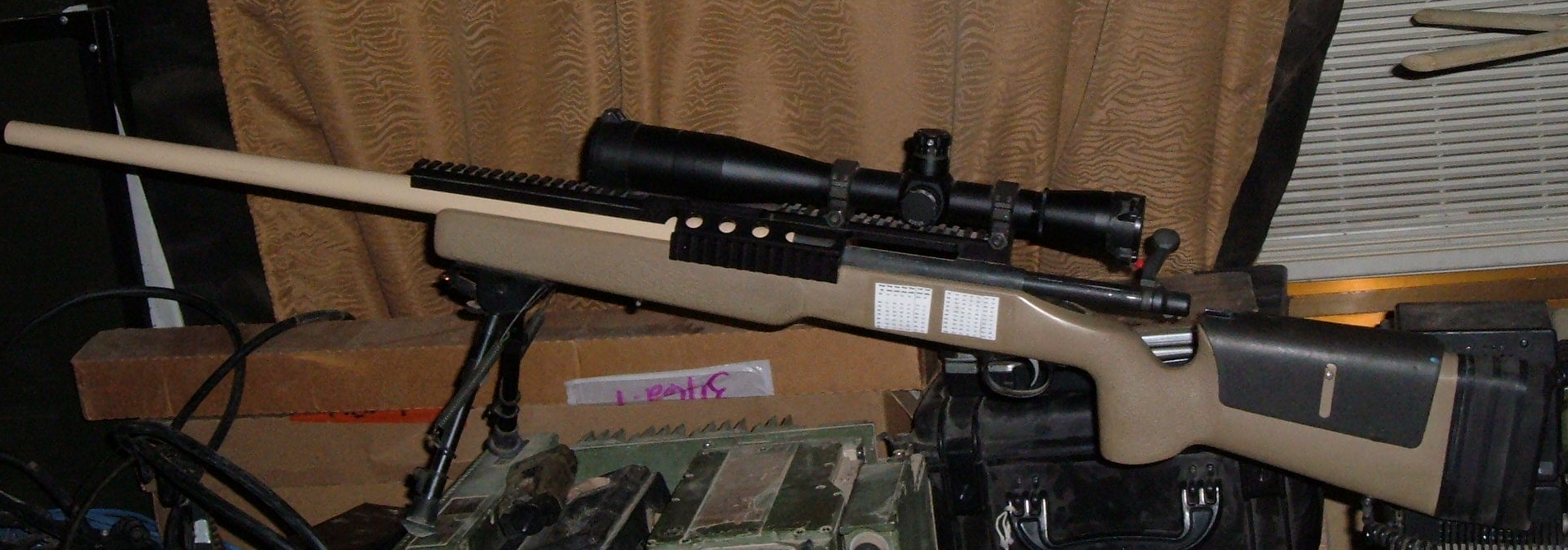

In Army we transitioned from Remington 40Xs in commercial MacMillan prone and A2 stocks to 700s in MacMillan A2s after Larry Freedman and a few other guys departed the new SF Sniper School in the mid-80s.
I had a number of McMillan 700 7.62 rifles in blue-grey, desert, and woodland smear camouflage A2 stocks. These were before the "Big Foot" or "Boot Lug" recoil lug, and had Sako-style extractors. All had Leupold 16Xs. I don't think the Mark 13 designation came until the mid- to late-90s when Nightforce started becoming popular.
This is kinda-close to the 7.62 700:

Many had problems with the Leupold bases "Springing." I think those were eventually replaced with Badger Ordnance rails after Marty Bordsen moved the factory from Wisconsin (I think -- I can't remember) to Kansas City.
The flat Badger was for use with the Leupold M3, and the 20-MOA for M1-16Xs.

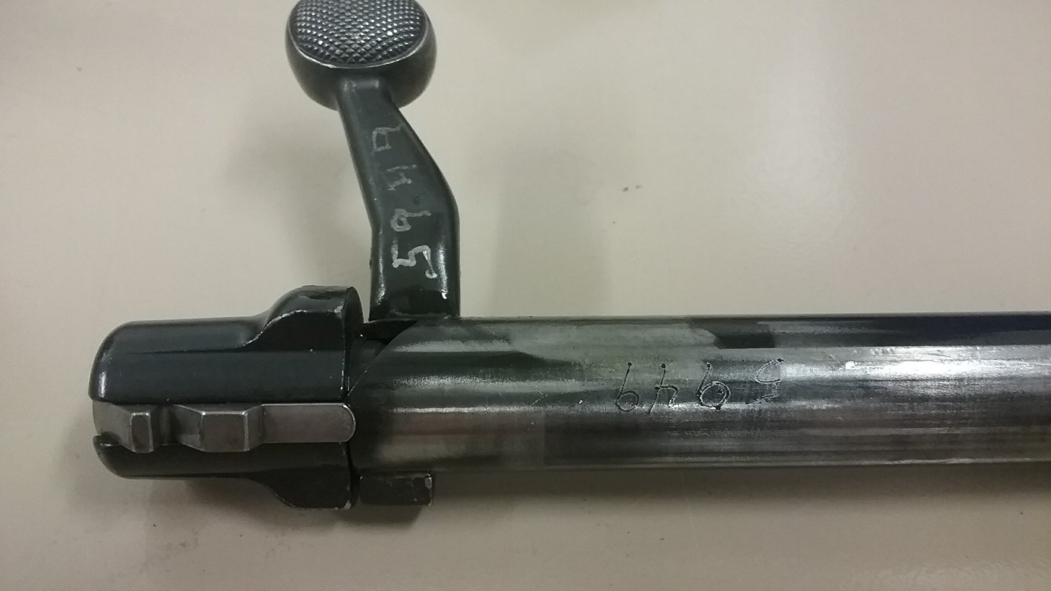

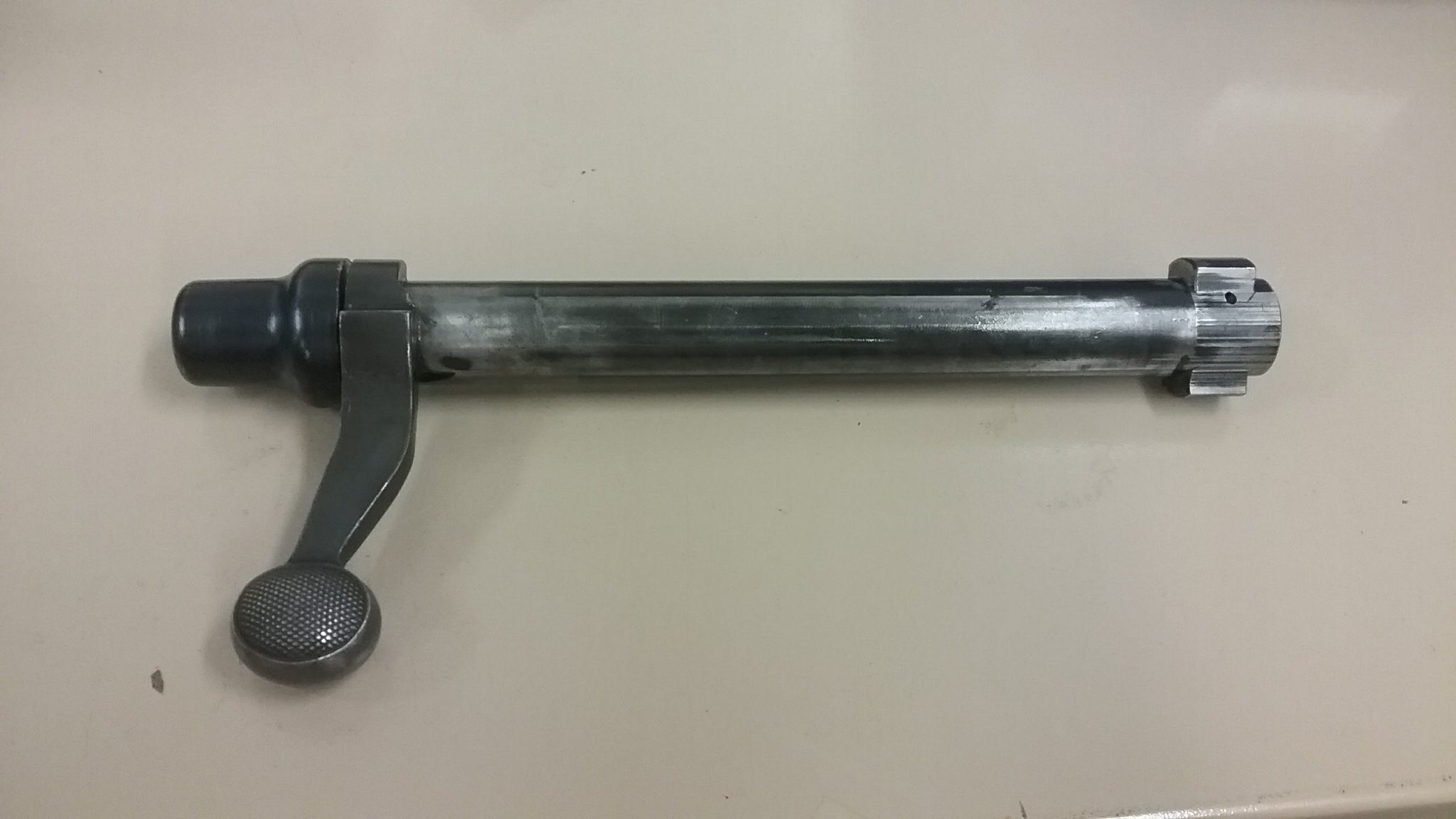

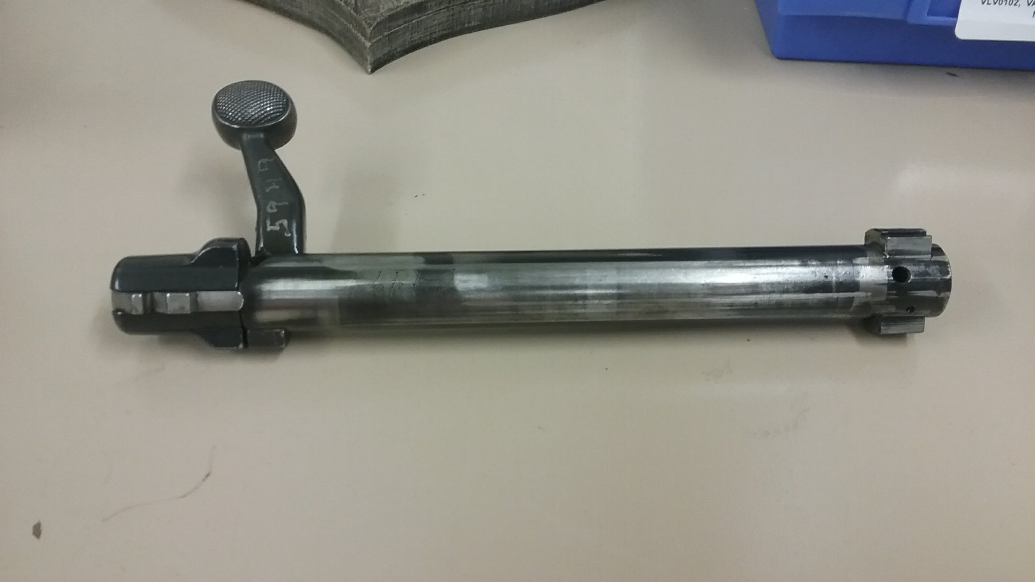

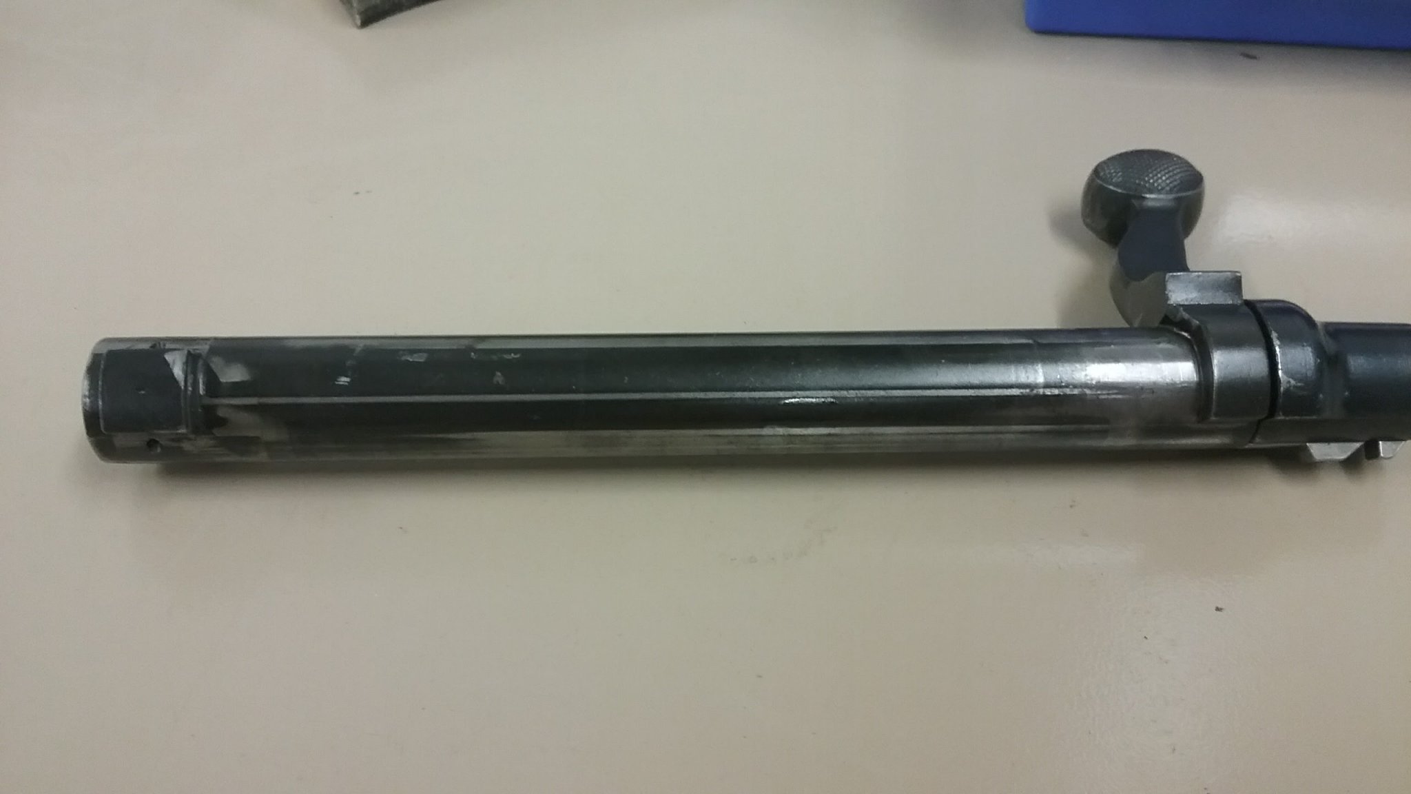

This is a original MK13 or pre MK13 bolt. I was fortunate enough to pick this up with one of the two stock I purchased. As you can see it doesn't have the extractor mod. It does have the original riveted Remington extractor. I do remember looking at some pics of the return stocks and you could see where some had the rail installed when they were rattled canned. Others were rattled canned but its apprent there was no McCann rail installed when painted.

Spooledup: Thanks for the pics. The SAKO-style extractor timeline is unclear, but its good to see how they were marked by the Navy. I've made a mental note on that detail.

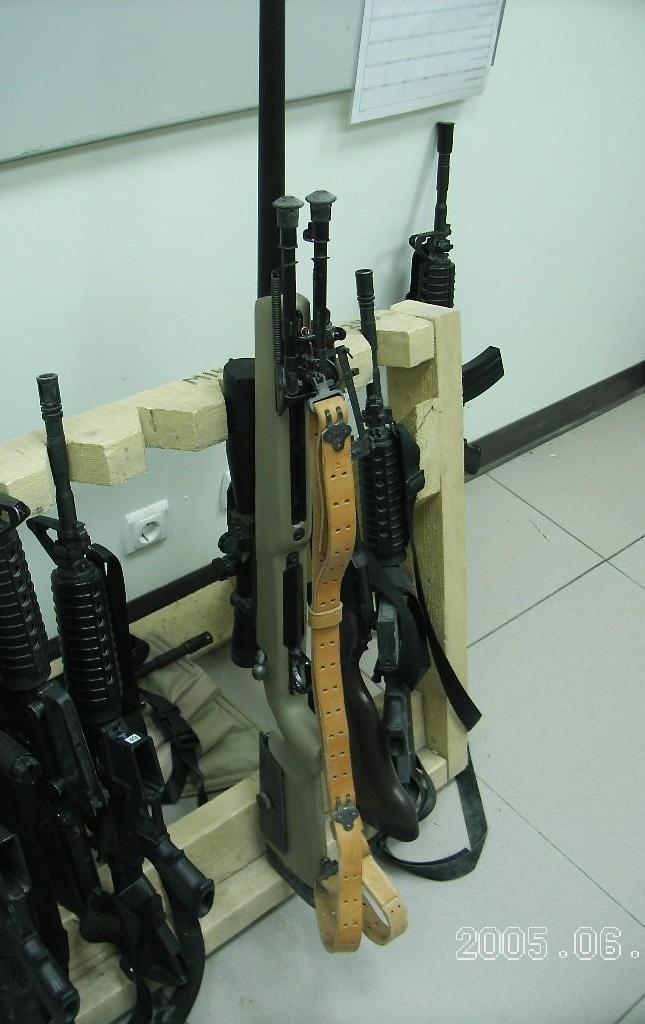

In Iraq in 2005, this was my Mk13. I can't remember if we deployed with it or fell in on it. It did have the Sako extractor and as you can see a Lupy scope and Mccann rail.View attachment 7092906
I really like the look of the tan barrels with the later medium tan stocks. The tech manuals say they're powder coated, but does anyone know for sure what powder coat color was used? What would the closest color match be if one were to use KG Gunkote or Cerakote?

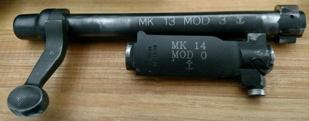

Mk13 Mod 3's were not common. In May of 2009, there were only two at LOGSU 2 on the East Coast. G63943XX and G65539XX. Both with Mk11 suppressors.
From my understanding and looking at photos, the MK13 Mod 3/4 used a kind of indexing collar/donut to mount/index the MK11 can.
By 2009 wouldn't many of them been sent back for conversion to Mod 5s by then?
I don't have any info on the rebuilds...just some inventory info from that time.
The lowest serial number Mod 5 I have info on is G65538XX (that was inventoried as early as December 2008), so that would overlap with the known Mod 3 at the east coast teams.

Based on the pics I have seen of other clones, it is very tight. I think 1 or 2 millimeters of clearance is the norm. (Not on my home PC right now, otherwise I’d post a pic or two). Nice build.
ON EDIT: Here's the clone used in the movie, and the scope shows clearance (note rings used are 1.265")

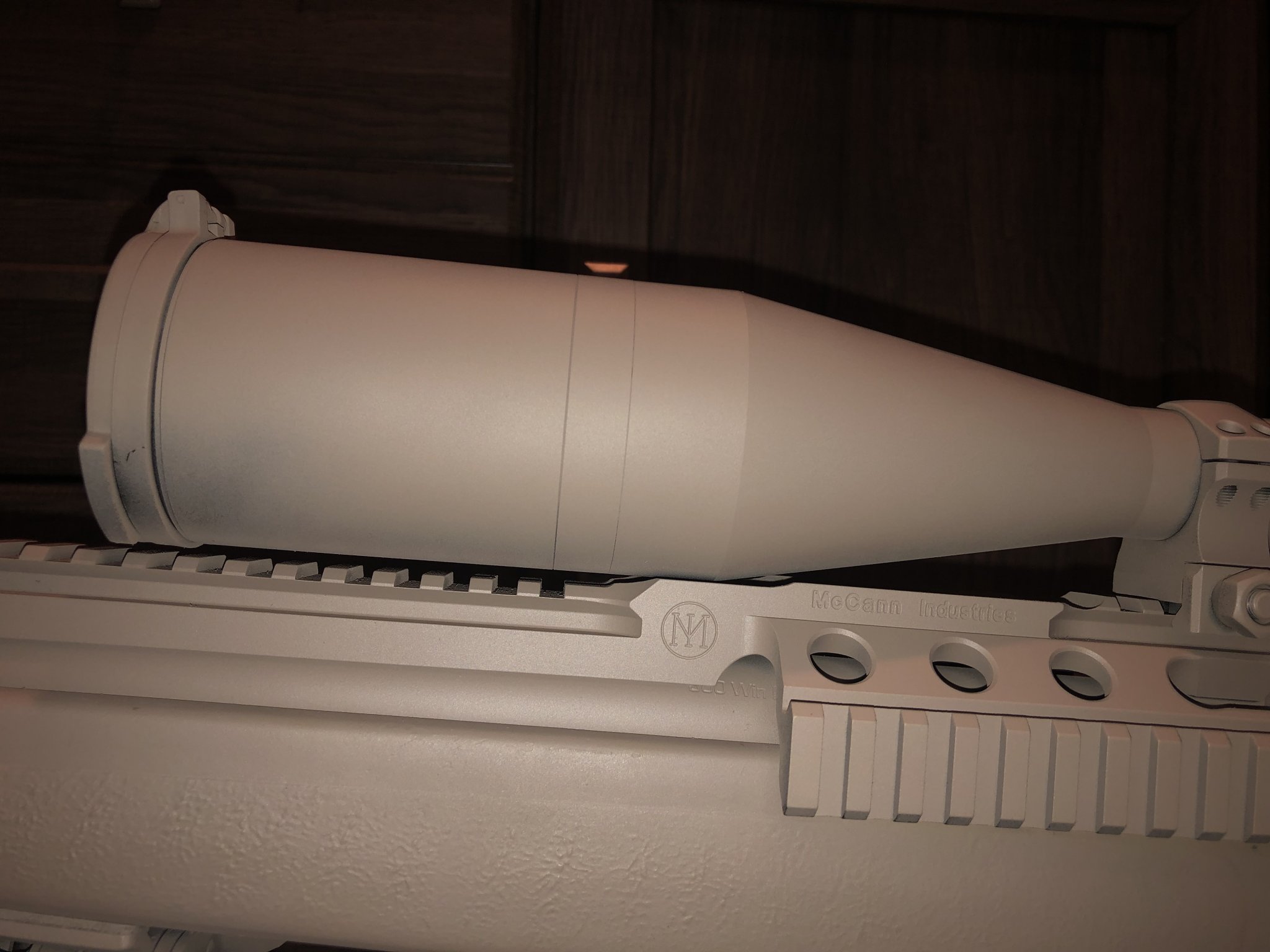

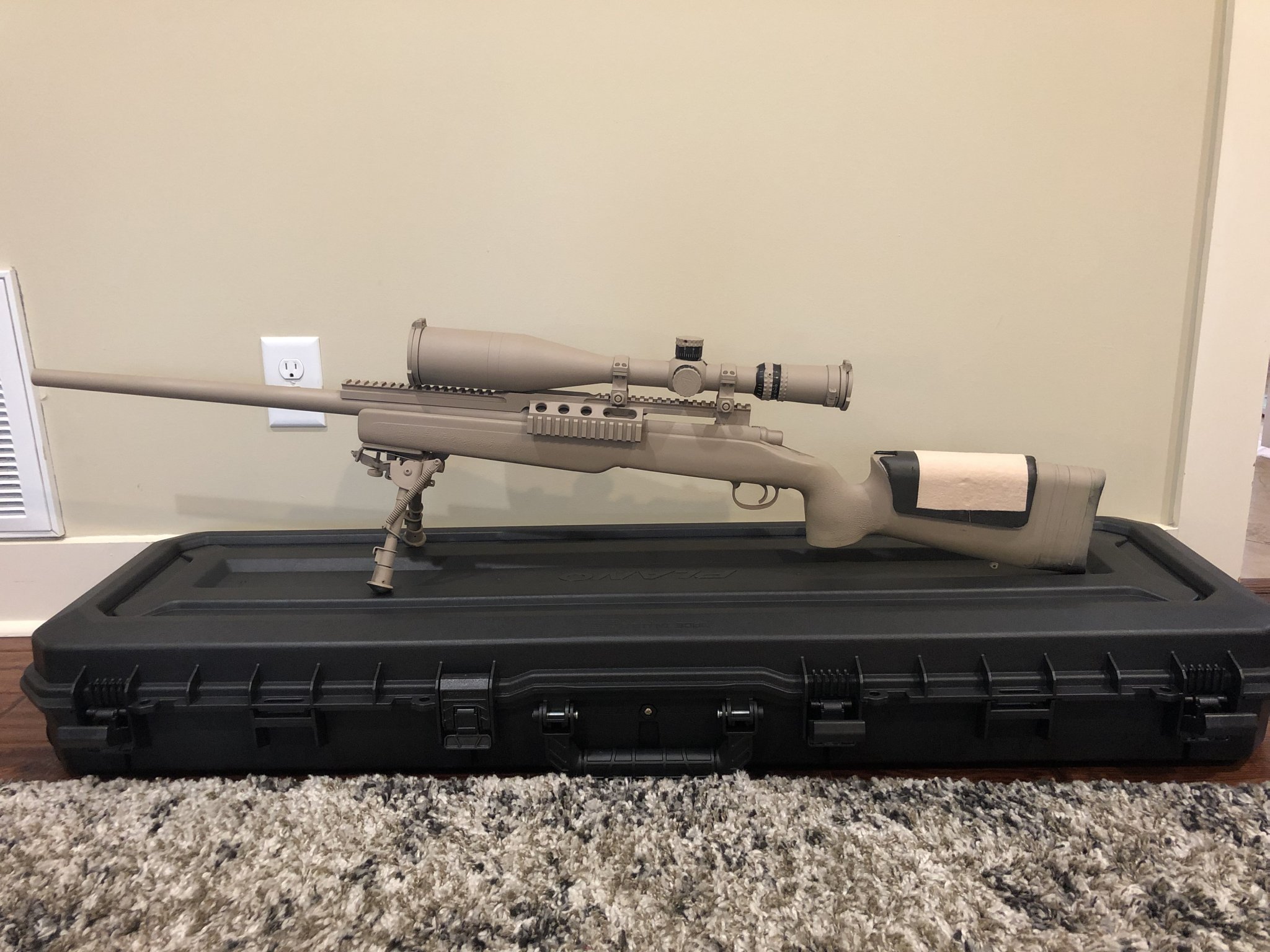

Hey Gents,
Sorry to change the subject, but I need so info from the experts regarding my MK13 Mod 0. RWS Gunsmithing recently completed my build on an official stock from USMCSGT0331 and it is awesome. I mounted my NXS 5.5-22x56 in Nightforce X-Treme Duty High rings, (1.125") and the objective housing is extremely close to the rail. Are these rings the correct height for a spec build? Anyone notice the scope hitting the rail during recoil? I have not taken it to the range yet. Any thoughts? Thank you,
I have a "spec build" on a return stock that has the "correct" scope/NF rings ... and mine sits very close to the MIRS rail too.
Reactions: BullGator1
I am not an expert, and this issue seems a little confusing as it looks like both ring heights have been used.
1. The Technical Repair Manual from 2005 for the Mk 13 Mod 0 lists rings as being 1.125" tall. (see below picture)
2. However, as noted in my earlier post, some builders use 1.265" rings (like the clone in the movie, American Sniper).
That difference in ring height is only 0.14" or about 1/8" (or 3.5 mm). Alan Brown is probably one of the few people that might know if the Navy switched to the slightly higher rings (1.265") at some point during the Mk 13 Mod 0 build era. Others may know more...
My opinion? If you can't slide a standard (paper) business card between the scope's objective bell and the McCann rail, then I would consider the slighter higher rings. You won't know if their is enough "barrel whip" upon firing that would cause the rail to perhaps rub on the bottom of the scope's objective bell, unless you try it, but obviously that would be bad if it did rub due to 'barrel whip' - as it would put a lot of stress on the rail's mounting screws and other components.
The challenge is that your rings are already painted and thus you'd have to ask your builder to Cerakote or paint the higher rings. So, if you are worried about the tight clearance, discuss it with your builder, swapping rings isn't a huge deal as long as they can be painted to match the current rings. The manual lists the lower rings, but its at least theoretically possible that might have changed. My 2cts.

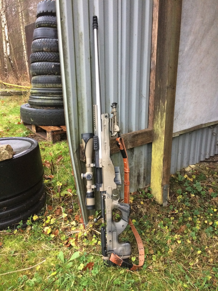

As stated before, its not a full on spec build but it is as close as I can resonable get it. Probably the only Mark 13 mod 5 (ish) in Scandinavia. This time with the Ase Utra Muzzle brake, as I am giving it a try.
Is the mod5 still in use somewhere, or has it been replaced with the mod7 and soon enough the ASR?
Looks nice man. I think you can pass since knights doesn't distribute in your country, lol. Much easier to do a MOD 7 clone nowadays no matter where you live though.
The Navy might still have some kicking around, there's photos of Eddie Gallagher with a stiller action mod 5, not sure how recent that was but I assume it was relatively recent in Iraq/Syria. Then like 2 years ago a SEAL ran one at a sniper comp.
Reactions: Vargmat
Doing full spec builds is not a thing around here. There was a norwegian guy who built a m40a5 some years ago, but that is about the only other one that I know of. Im still on the look out for an older AICS folding stock, they do show up on the used market every now and again, so there is some hope on getting one. It would make it look a bit more authentic. Thanks for the feedback on my question.
