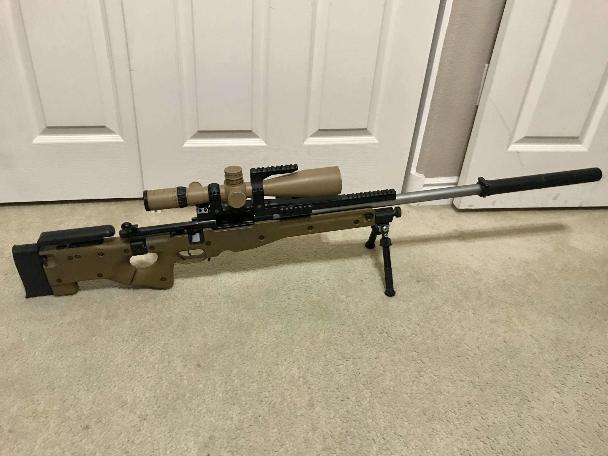

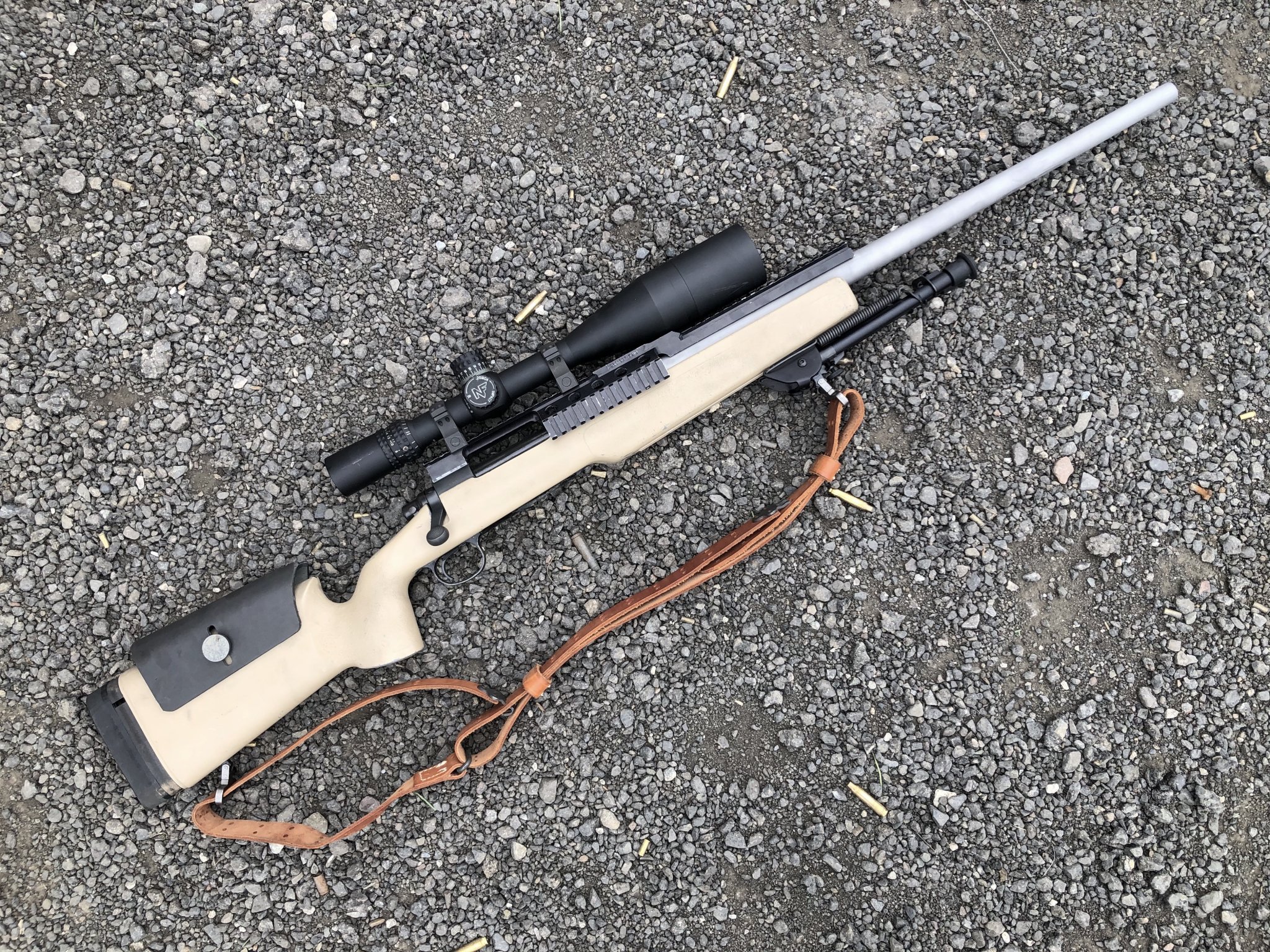

First pic shows the Mod 3 barrel with a new Lilja blank, second pic shows the jigs he just made
I just received my Mod 5 from a guy who was also connected with the program. He looks to put Alan's work to shame. I also notice that some people say that they have the correct profile, but in looking at what they post, I do not believe it to be correct and from looking at a lot of photos of real guns, it to be correct. If you look at crisp, clear photos, you will see it too. If you look at a lot of the reproduced and mutiple copied pics on the internet, the detail gets lost in the degradation of the photo. I included a picture of the correct profile to show the difference.

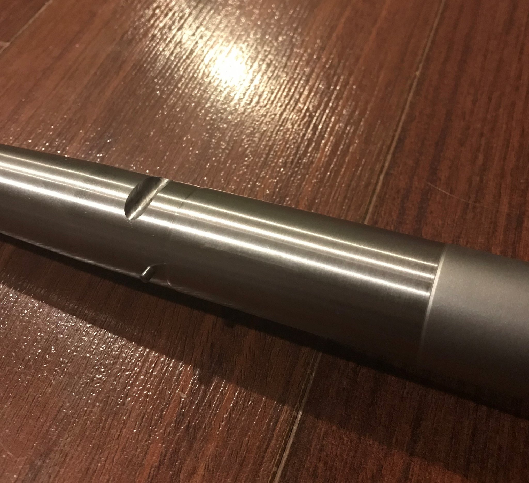

I noticed the non bead blasted portion of your barrel extends well beyond the notches/pin area in the direction of the action...I haven’t seen any mod 5 with that feature.
Mine and the mod 5’s pictured in the hands of US service personnel all show the bead blasted portion of the barrel extends nearly to the pin such that when the suppressor is installed, only a very small sliver of unfinished stainless barrel is showing.
Was that a personal choice or did your smith state that is correct?
Here is mine, for example
Here is one at Ft Benning circa 2009ish
M and the mod 5’s pictured in the hands of US service personnel all show the bead blasted portion of the barrel extends nearly to the pin such that when the suppressor is installed, only a very small sliver of unfinished stainless barrel is showing.
Here is mine, for exampleView attachment 7298240
A buddy of mine has a real Mod 5 barrel, it's bead blasted, then it has a section with machining marks (similar to what's seen on Schneider M40xx barrels) and bead blasting, then finally the polishing to the muzzle. If USMCsean's barrel had some deeper machining marks in the section behind the index pin, it would perfectly match my buddy's barrel. If it were my gun, I'd be extremely happy with the way it turned out, I wouldn't change a thing!
SMGLee has some great pics of a Mod 5 on other forums, that rifle has the bead blasting up to the index pin, exactly as you just talked about. That's 2 slight variations for a legit Mod 5 barrel, go with either, both are correct.
I have pics that show this profile on issued guns. I have compared it with a rack full of these, and is spot on. I wish I could share the pictures that I have. I am not.
I also have seen the earlier profile going back close to the Mk11 suppressor, as you have questioned. I supposed I should have stated that it wasn't THE only profile. It came out that way, and I am definitely wrong for portraying it that way. The goal of my build was to have a "Stiller Mod" gun built. This was the profile that was used on those. I have also seen the same profile used on earlier guns that didn't have the Stiller Mods on them.
I'd really be interested in knowing why the change occurred. Any idea on that @USMCSGT0331?
very nice looking rifles!!!
Reactions: nn8734
Interesting, thanks for the information. I look at SMGLee’s pics frequently (he’s a hell of a photographer) but wasn’t sure if the bead blasting pattern on USMCSean’s was correct or not (suspected it wasn’t) so appreciate the clarification.

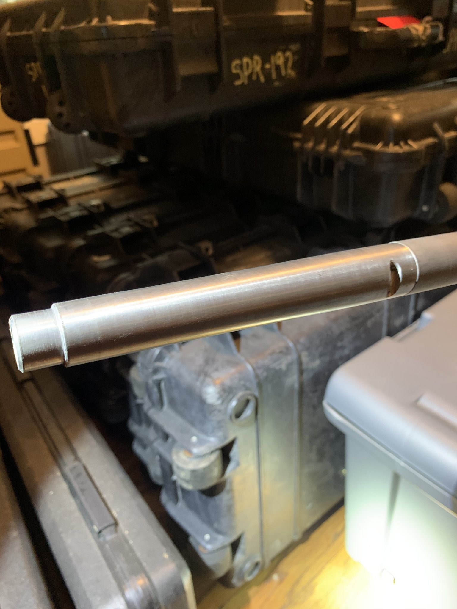

The guy who profiled my barrel has the CNC program, the actual dimensional drawing, and a set of go/no go gages. So I did not have to have my Mk11 can for him to profile the barrel.
That was my barrel from Allen Brown. Yes I need a complete new barrel and yes I’m running the MK11 can but only on that barrel. God knows what damage may occur. I was referred to Chris Higgins at Red Bull armory to replace the barrel. He’s going to do it right. I’m having him completely redo the build. I’m out 1k plus shipping from Allen. Then 400 for a new Lilja barrel. With shipping and all probably 1800-2000. Not the end of the world but 2 years waiting for it to only have to send it away again before firing one round totally sucks. It has to be right though. It is what it is.
I specifically asked him to taper the barrel. I heard some smiths did this step profile. I asked him to please taper it. Yet here it is.
I’m hearing some solid things coming out of Red Bull. I wish they had a website to check out. I’m planning on having a convo with them about my MK13 build. Thanks for sharing your misfortunes with everyone. That’s a tough one to come across. Hopefully this wakes up a bunch of those who have been waiting on Allen for some time now with builds sitting on some shelf for 10-18 months.
So sorry you have had to deal with that shit. Alan has essentially flushed his legacy of a lifetime’s worth of work down the drain in these past few years or so.
The stepped profile may also render using the Mk11 suppressor a no-go. The last inch or so of the barrel muzzle has to be .75” in diameter for a length of 1.1875” to engage with mounting lugs inside the front end of the can. Not sure if that final step will facilitate mounting.

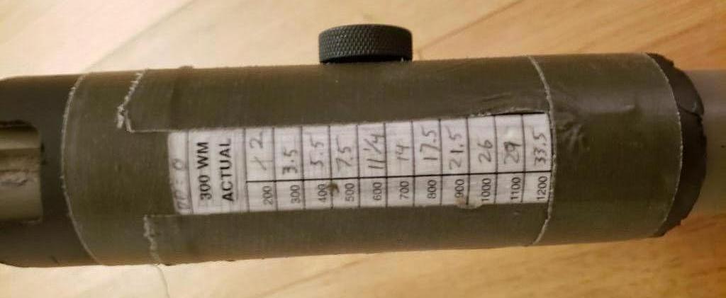

Finally took my mk13 mod 0 built by RWS out for sight in and mild stretch. Rifle shot beautifully out to 1000 yards. Looking forward to taking it further.
Very nice. What loads are you planning on, and are you gone get the Mk 11 can in the future?
