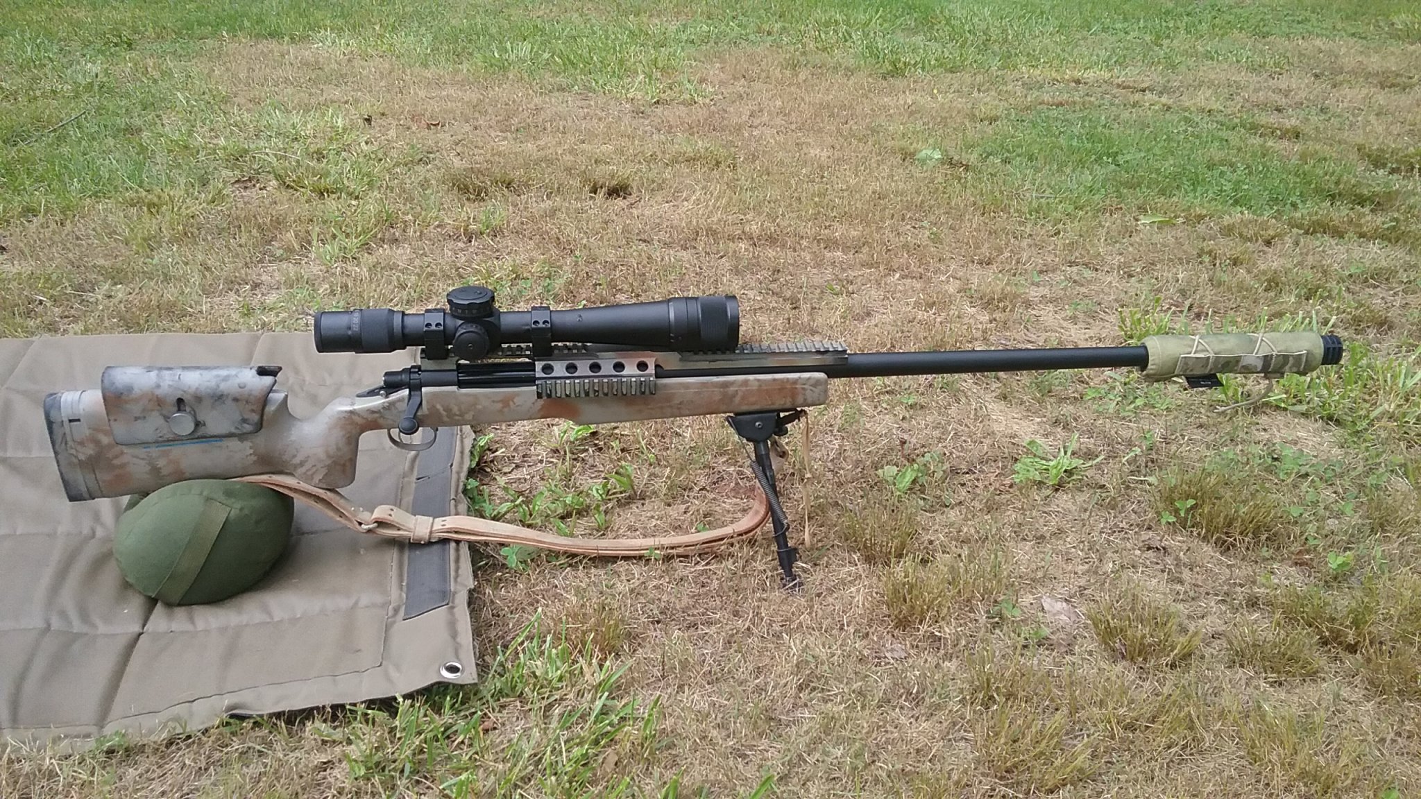

that 16x looks perfect. I need to change over. I assume the scope clears the rail? It looks TIGHT. I love them sitting low like that.
Looking at the old dope chart, I wonder if your guy was a lefty?
Congratulations!!
^^^ You'll have to talk to the man who built it! But, yes, it's very... precisely fitted.
Hey, if it works....

A 20 Moa rail isn't needed with a 140 MOA of internal travel. I would go so far as to say, not even desired. the orginal 700/300 wore a 0 MOA Leupold mk4 base, so the mcCann's taper configuration may have been a carryover, as Leopold still ruled the roost in the mid 90s and the 16x was what the Army guys had until GWAT I think.
Do you have unit markings on the stock? I ask because maybe, just maybe, if you're really lucky, that stock is from an SF or Ranger unit, as they both used them too ;)
Alan Brown said that the MK13's left the shop with Mk4 10x's on them, they only have 90MOA of travel. I'm torn on which to use, I have a 1995 Mk4 10x and a Mil-Spec Nightforce.
Nice rifle sirhr! I have to agree with Fatboy, the scope looks rather ~Tight~ to say the least. "All those adjustments and scope won't go up any further?...":unsure: lol

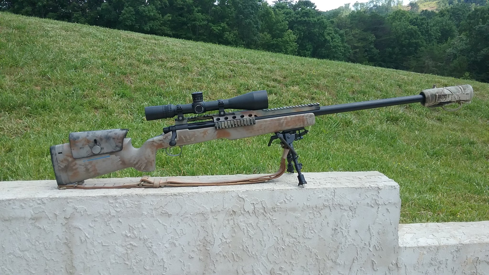

Unpacked it this morning... bore sighted it this afternoon. But didn't get a chance to get on paper and dialed in, yet.
Probably next weekend. It's an utter beaut!
BTW, it is a 16X scope. When I brought the parts to Alan he said that there were rifles that left Crane with 16X Leupold's on them. Also that those were used on other rifles (ie. the early Barrett's) and frequently re-purposed as needed.

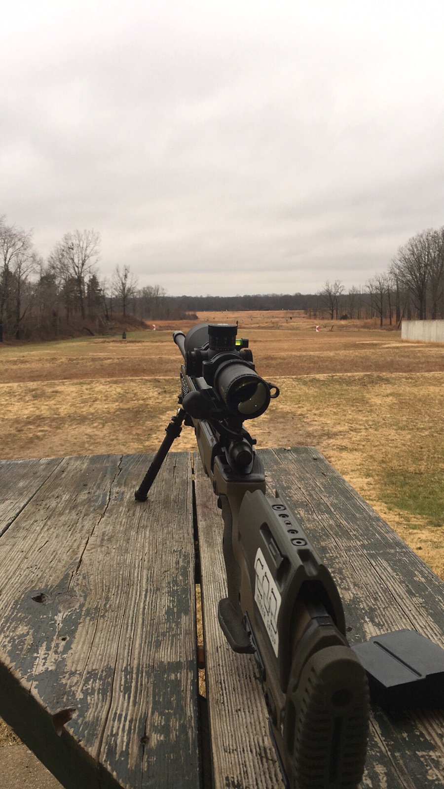

So the big day arrived.... out here at Clarksville... and for those familiar with the area... the home of both 5th Group and Jack Hinson... more on that later...
Not able to get on base today... bummer. But went up to an NRA range in Land between the Lakes. Great public range. Empty... except for that one moron who has to come pick brass and then hangs out behind us blabbering on endlessly... for the love of all things holy... go away. But he did, eventually.
Conditions were.... light wind quartering out of the 2-O'Clock but very light. And we were in a big horseshoe berm. Hazy. Thunder brewing to our West. A lot of mirage and churn visible in the scope. But since this was just a first few shots....
Started with 10 rounds of factory, soft point Federal Ammo. Came free with the dies I bought. WalMart stuff, probably. Used it to go from bore sight to 'close' to the dots. It grouped like... WalMart ammo. Then ran a dozen patches with solvent up the bore (these were the first 10 shots)... and a couple of dry patches. And we were ready for the good stuff.' This is handload 220 grain HPBTM. Not a heavy load. But it's to fireform the brass... so again, not expecting great things. I picked this powder charge at random (well, out of a book... but no testing at all.) And brass is FL resized. Next time, it will be neck sized only.
Recoil on the rifle is not only manageable, but it's downright light. None of the 'ferocity' one expects from a .300 WM hunting rifle. Not as tame as the .308 Sako. But really, not a kicker at all. Scope is... everything a 30 year old scope with fine reticle is... which is tough to use. And it's in 1/4 MOA.... and I've been shooting Mil's for 15 years now... so just took some thinking to go back to MOA. Not hard, though. Easier than the other way around.
So I took a go on the bench.... Also not my favorite. Bipod too tall for bench. I had to engineer my scope cover and sock bag to support the rear worth a damn. But got a good weld.
Let go my first 5-shot 100 yard group.... This is it!
This rifle shoots! And this is with no messing with loads.... a 'testing' and fireforming load only. And that's about a 1/2" group with the one on the left being the cold bore shot after cleaning. Shot a couple more 5 shot groups... and they were about like this!
Moved out to 200... and group size is about the same MOA... with a called flyer, about 1.5 inches. Without the called flyer, the group's about 1 inch. I shot a few flyers... I just don't like shooting from bench. And this one was all wonky.... seat too low, bipod too high. I should have gotten down on my mat. Next time.
In addition my buddy-since-we-were-teenagers from 5th Grp. MSGT "Bull" (ret) took a go. Loved it... and talked about the ones they inventoried over the years... (a few of you know Bull, I am sure)
