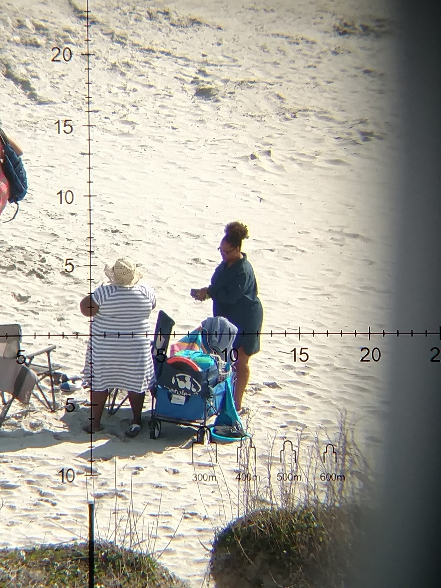

A shining example:
Ok...on page 3....had to stop a bit. I have some great study material for you Chicharone. Im old and don't wanna risk forgetting.
Now make note of the cart wheels, the hat, the chair. Now I apologize, cause this is a mil reticle, mostly my apologies are to @TheHorta
I hate that he had to learn i use mils this way. Oh not that I use it to range hot chick's on the beach, but that I'm participating in this dumper fire.
Now where was i? This getting old shit..oh yeah!
So note the objects and look at your ruler, that reticle is your ruler. If you study the picture, and your ruler, it becomes immediately clear, that is one.
Big.
Ass!
It also opens your understanding of a new unit of measure....AH(axe handles) now if that ass was subtending half the AH you currently see it would be twice as far away.
Hope this helps.
Big.
Ass!
Hope this helps.

7mils high
4.3mils WIDE
This target is known as "non standard" and if you use the silhouettes on the right, your range will be WAY off.
This is known as a "bigern"
