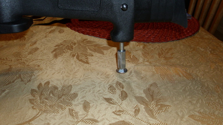

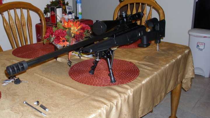

Here is my build. Of course if you have a machine shop you can really do one up nice too.
Build two, for my .308 and 338LM, for under $5.00.

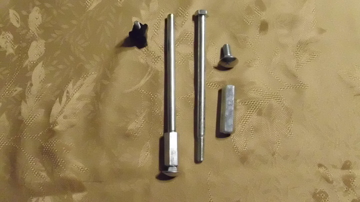

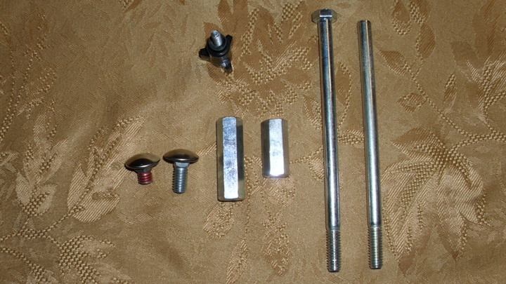

Materials from OSH or your local hardware store (5/16 bolt):
Thanks for looking, Ed

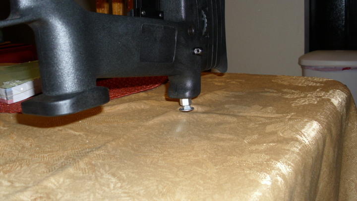

<span style="font-weight: bold"><span style="font-size: 14pt">Shorten to your preference secure carriage bolt with red Loctite or wife's nail polish:
</span></span>

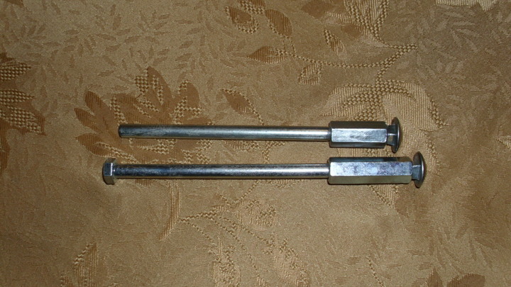

<span style="font-weight: bold"><span style="font-size: 14pt">Long version</span></span>:
<span style="font-weight: bold"><span style="font-size: 14pt">Short version if you don‘t want it protruding out as much</span></span>:
<span style="font-weight: bold"><span style="font-size: 14pt">Shaft extended and ready for Aprox. 1" of fine adjustment</span></span>:

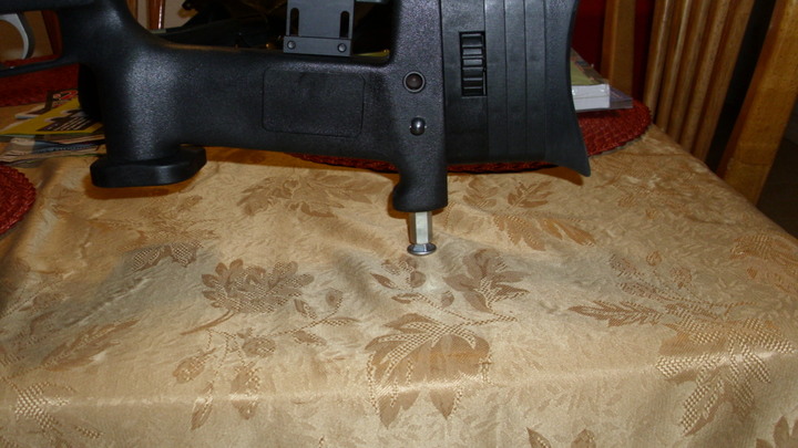

<span style="font-weight: bold"><span style="font-size: 14pt">Shaft all the way up</span></span>:
<span style="font-weight: bold"><span style="font-size: 14pt">Finish to match your rifle</span></span>:
