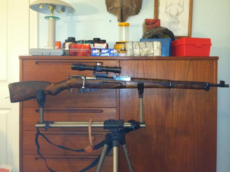

Read through this thread for the odyssey so far. It should showcase the trail of astonishment and woe that accompanies the task of mounting a scope on a Mosin, and finally reveal a simpler, better way to do it.
Nikon? Really? I'm making a $50 NCStar Long Eye Relief scope do enough of the job for now. Some day, when I really lose my mind, this is on the wish list....
The key advantage of applying the Scout scope system is in how it allows a much simplified way of aiming/zeroing the rifle. Some means of raising the cheekweld with the scope should help, too. Just plod your way through the "Cheap Shooter" thread and methods will be revealed.

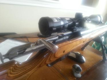

Here is my 1932 Tula that I sporterized... keeping the original barrel.
You can find the specifics here... Surplusrifle Forum ? View topic - Mosin Nagant Sporter Project-With Range Report
One thing that I will say is that even if you have a perfect bore... bright, strong rifling, etc. These are not match grade barrels by any means. This rifle has 2-3 fast paced shots before the barrel heats up and starts to walk. If I pace my shots, and keep the barrel cool to the touch... she hammers. Here is a five shot group @ 100 with 174 grain SMK's over 55 grains of IMR 4350 (spaced over 20 min).
