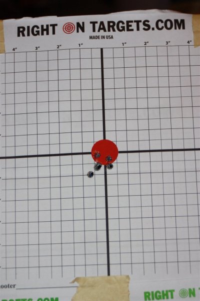

Even though the temperature was about 25 degrees this morning, I decided to take the Tula out and run some rounds through her. I grabbed my old Soviet WWI backpack as a rest and headed down the hill to my range.
I ran 20 rounds of 184gn standard Privi through her at 50 yards and started to zero her. One adjustment had me just outside the bull to the right but with the cold I found it hard to make the minute adjustment and kept bouncing back and forth from one side to another.
After a last adjustment, I opted to switch to some hand loads. Based on a bullet test, I had decided to try pushing Hornady 174gn .3105s through her - with 43.5 gns of Varget. I took 3 shots and was almost dead on.
At this point, my hands were getting pretty cold so I decided to push my target out to 100 yards and fore 6 check rounds.
Here is my result. I was using a 6 O'clock point of aim so I am still a touch low - but given the temperature and bulky clothes...and my rush to finish...I am very happy. She's shooting a tad over 1 MOA - and probably better had I not pushed the first round left.
Many people like to push the rumor that the ex-snipers were taken out of service because they are shot out. Both of my restored ex-snipers are tack drivers and kill that rumor - in fact, they both have much stronger bores than my actual '43 Tula.
I think I'll bring both with me to Quantico next weekend - will probably use myy '42 Izhevsk for the match since that's the rifle I have worked with extensively. I need more driving time with this one - but she sure has great promise.

I think most (not all) of the ex-snipers are "ex" because they had broken scopes, not because they were "shot out." Why put another scope on a sniper with a broken scope once the war is over, and thousands were still remaining. It wasn't as if they had a shortage.
Nice rifle, and shooting...
Varget is the ticket for mine as well...also 43.5 grains, but under the 174 SMK.
Now, if I could only get some Varget (and some H4350, 8208, and CCI 200 primers, and, and....) I might actually be able to shoot...
