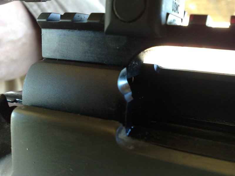

This brings a question to my mind... If the 30 moa base is suppose to be installed on a milled flat receiver. That receiver has to be milled to a certain height on the backside to get the correct 30 moa. If it's only milled a little bit... the base is going to sit at an angle higher than 30 moa... Correct ? This picture is from the A3 build guide thread from a while back... and it is milled totally flat...lower than yours...
JMO... But I would have the right side scallop cut lower like in these two pics of actual M40A3's... now would be the time to do it..

Mcm,as long as the rear reciever is flat and the base sits flat youre good.youll need to seek this feature later i presume.exact 30 moa wont be a factor a little plus or minus ,thats why youll zero your scope when you put the rifle together.my opinion.

That's wrong... Your dealing with two different heights on the receiver to work with a given spec 30 moa base that is designed to mount onto the milled height.. If those two heights are not what they are suppose to be... the base is going to be off the 30 moa.... Now who knows what the base angle is... it could be 40 moa but your scope will still work... And if that's the case... the front of the base will not sit totally flush on the receiver...
Re: My rifle back from the "Smith"??PIC HEAVY!
Its not the whole rear bridge that milled off, the milled off area just slightly bigger than the flat rear bottom of the base. From the way the picture taken the light make things look bigger.

Thats what I'm saying... if you look at the picture of the clip slot I believe done by GAP I posted, The whole bridge is milled flat unlike Jose's where it is just a strip down the middle that is flat...
No it probably wont just like the rear wont be sitting flat without the rear being milled. I believe that with the 8-40 screws bolted down tight and occasional shooting sessions all this wont affect zero much.if youre going to jump out of Helos and crawl thru the jungles with the rifle you might want to secure it and go the whole distance and achieving the milled rear reciever.Not that i want to settle for the minumim but the rifle has come miles away from how i recieved it.I think that for me its good enough,its been freaking butchered everyway you look at it.Will has cleaned it up very much from the origianl state it came to me in.lets not forget the broken stock.Its the most rigged piece of gear ive had ever and yet the most costly.Damn.

Thats what I'm saying... if you look at the picture of the clip slot I believe done by GAP I posted, The whole bridge is milled flat unlike Jose's where it is just a strip down the middle that is flat... </div></div>
You are correct, the pic taken by Newb 308 on his rifle built by GAP, clip slotted by GAP.
Zero is not a problem, it could be off a few MOA, the scope can pick it up within its range.
Problem is the base, will it hold or not. I look back at the last pic I took on Jose's rifle, there's a small gap between the base and the rear bridge. That's the reason why I said in a couple previous post that DDRoss did not mil off the rear bridge. The area of intact is too small, one is radius and one is flat, the screws will hold the base on the receiver but they withstand a lot more torsion from recoil which they dont suppose to and easily break off after time.

If the bridge is not milled off the correct amount, wouldn't that prevent the front of the base from making full contact with the receiver?
<div class="ubbcode-block"><div class="ubbcode-header">Originally Posted By: RADcustom</div><div class="ubbcode-body"><div class="ubbcode-block"><div class="ubbcode-header">Originally Posted By: GoB</div><div class="ubbcode-body">Its not the whole rear bridge that milled off, the milled off area just slightly bigger than the flat rear bottom of the base. From the way the picture taken the light make things look bigger. </div></div>
If the bridge is not milled off the correct amount, wouldn't that prevent the front of the base from making full contact with the receiver? </div></div>
Thats what I said in my earlier post...the front won't sit flush...
No it wont fully sit right as it should, the base will probably contact where the 8-40 screws tighten,but the sides will have a small gap.
