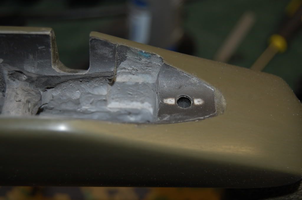

Here's three pics of Jose's rifle. It's all packed up ready to go home. All metal in KG Gun Kote Flat Black.

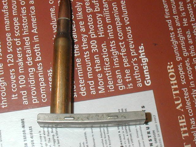

quote:
"Here's a functional clip slot - the clip cannot be allowed to go down into the receiver if it is to remain functional. This one is a bit hard to see, but the radius in the rear corners is wider than the slot and does not go all the way through the top of the receiver, holding the clip captive while the rounds are stripped off of it."
The clip has nubs on the side that stop it from going into the action. The slot is just a guide for the clip.

81sfo said:
The M40a3 model isnt made for those provisions.The m40 during Vietnam was.Im not sure about the m40a1.
I'm aware of that, now that I read this thread. I was just posting on how a stripper clip worked. It was one of the things that got the US in trouble with Mauser before WWI when they built the Springfield. It wasn't that the Springfield itself was a copy of the Mauser. It was certain features incorporated into the design.

<div class="ubbcode-block"><div class="ubbcode-header">Originally Posted By: n64atlas</div><div class="ubbcode-body">quote:
</div></div>
The rem 40x version and similar clip slot cuts ( they wrap around the front of the clip to hold it back ) from what I can see are not true clip slots in that sense. A clip slot on the old bolt action battle rifles (1903 Springfield) do not require you to pull the clip out before closing the bolt. The bolt ejects the clip when closing.

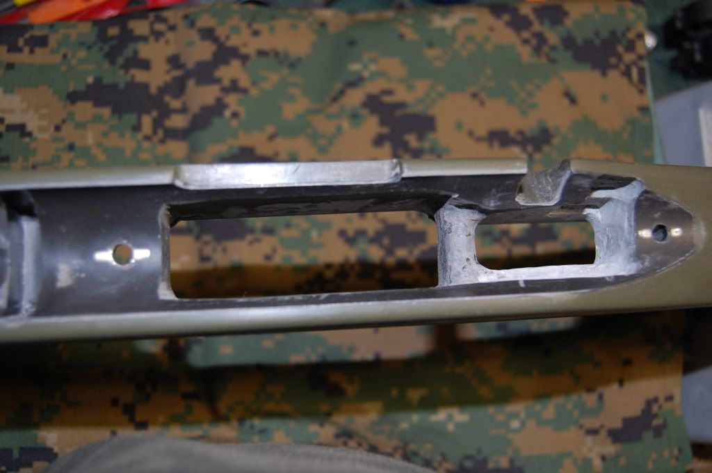

<div class="ubbcode-block"><div class="ubbcode-header">Originally Posted By: Terry Cross</div><div class="ubbcode-body">Do not send it back to the same shop. I would have someone inspect the barrel and action work also. If the same person built the whole rifle, logic brings me to think that the chambering and machine work was possibly completed with the same flair for detail.
TC </div></div>
Not trying to defend anyone but the "smith" might be very good at barrel and action work but lousy at bedding. If so he should stick with what he is good at and let someone else do the bedding. Hopefully someone who knows what they are doing. If, however, this is how all his work comes out he needs to find a different profession.

I did in fact recieve the barreled action from William today. I Cant really describe with words how clean and professional his work turned out.The pictures dont do justice for it either.I was very happy with the machine work he did on the side of the reciever. William corrected the "step cut" and fixed the crown and applied an awesome baked coating that looks amazing.Im very happy with his lightning fast turn around and attention to detail.Communtication was top notch, William contacted me before each step he took and asked my opinion before taking action.William is a TOP NOTCH GUY to say the least.Im going to pillar bed the rifle this weekend and post further progress.Thanks William, and everyone else for the positive input and encouragement.

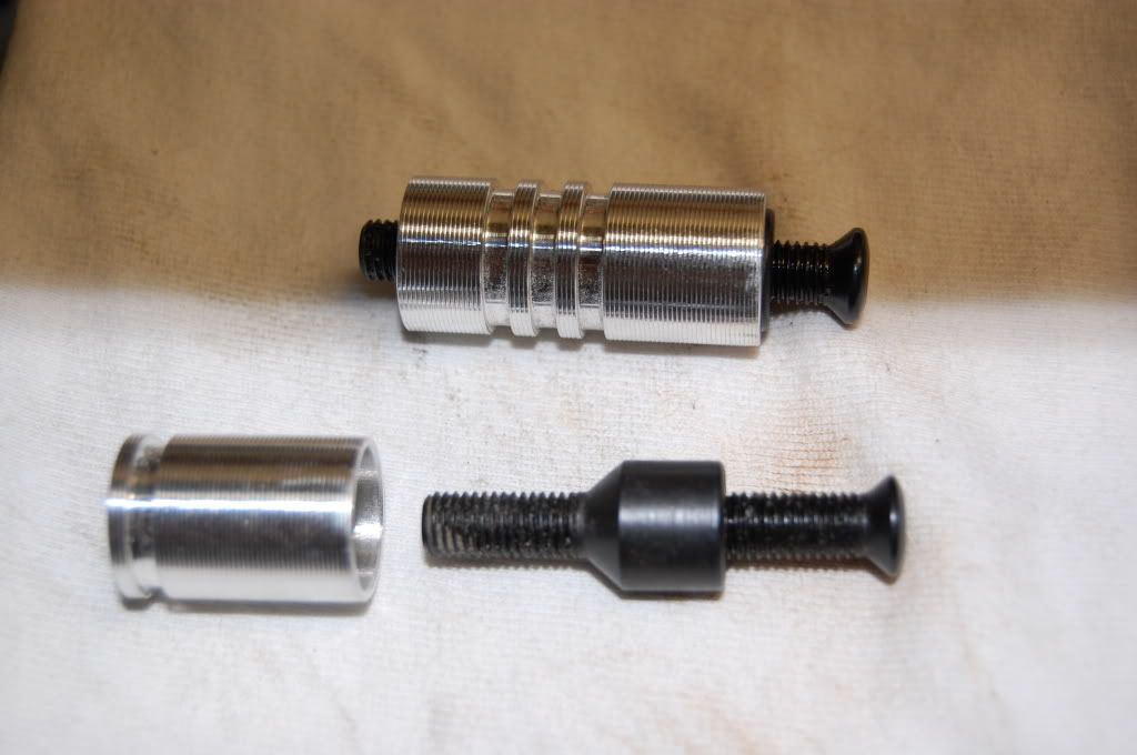

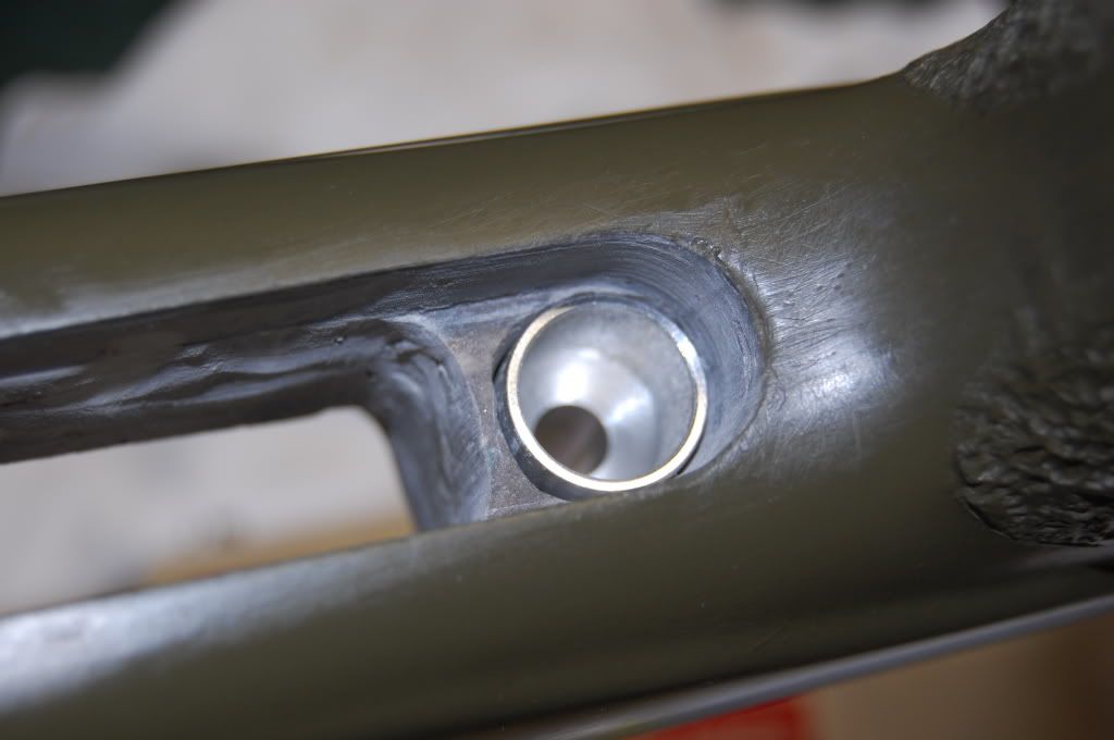

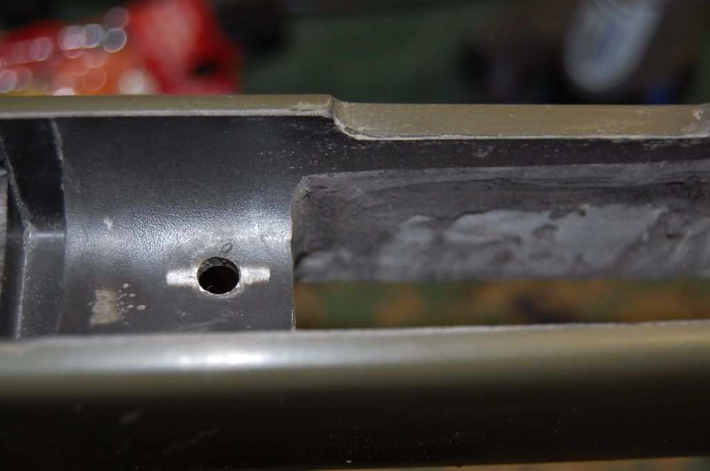

Heres some pixs of the bedding i did last night, it turned out ok, just one fault in front of the recoil lug.I re did that area and its drying now.You can barely see the contact of the pillars.I ended up using Holland Pillars instead of the badgers.Used 5 minutte Devcon epoxy for the pillars and Marine tex for the bedding.I know its not the best job but its my best.Its the fourth rifle ive bedded and im happy with the results.Ill post some pics of the fix when i pop it open again.

<div class="ubbcode-block"><div class="ubbcode-header">Originally Posted By: chris112</div><div class="ubbcode-body"><div class="ubbcode-block"><div class="ubbcode-header">Originally Posted By: Terry Cross</div><div class="ubbcode-body">Do not send it back to the same shop. I would have someone inspect the barrel and action work also. If the same person built the whole rifle, logic brings me to think that the chambering and machine work was possibly completed with the same flair for detail.
TC </div></div>
Not trying to defend anyone but the "smith" might be very good at barrel and action work but lousy at bedding. If so he should stick with what he is good at and let someone else do the bedding. Hopefully someone who knows what they are doing. If, however, this is how all his work comes out he needs to find a different profession. </div></div>
Sorry man but I'm calling bullshit on this. If you aren't good at a part of the job and you know you aren't good at it (anyone who has ever seen a bedding job knows this one sucked) then have the integrity to tell the customer and outsource the work. If something is as screwed up as this was then have the integrity to back up a product with YOUR NAME on it. If you are going to put your name on something it had better be perfect, especially in this business.
I have the feeling that as the result of this topic one smith has lost a lot of future work, I know I'd never use him, and another smith has picked up a lot of business for being a stand up guy.

81sfo,
Not to kick you in the nuts but if you are still running the Badger M5 DBM I hope you cut the holland pillars to .720" and 1.070" these are a set dimension that Marty specifies so the mag will seat properly and have the correct standoff and orientation to the receiver. I think there is a little wiggle room but not much.
BTW - I thought you had a vertical mill, you might consider using it to cleanup the inlet after bedding. Not that this will make the rifle shoot any better, it will just look better when you take the B/A out of the stock.

FNG23, yes i cut the pillars down to fit, and it fed great today that i shot it,I do have a vertical mill and will go back in and clean it up.My mill is only capable of a 3/8 shank bit and i wont be cleaning up the barrel channel with it.I wish i could fit a 1 1/2 ball nose bit in there.

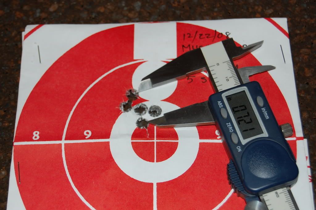

Well heres my first range report today at 35 degrees and freezing my TEXAS ass!Im no longer a discliplined shooter in the cold.I shot it at 100 yds and using 168 FED GOLD MEDAL MATCH.
The group is about the size of a quater.I know it shoots better.
