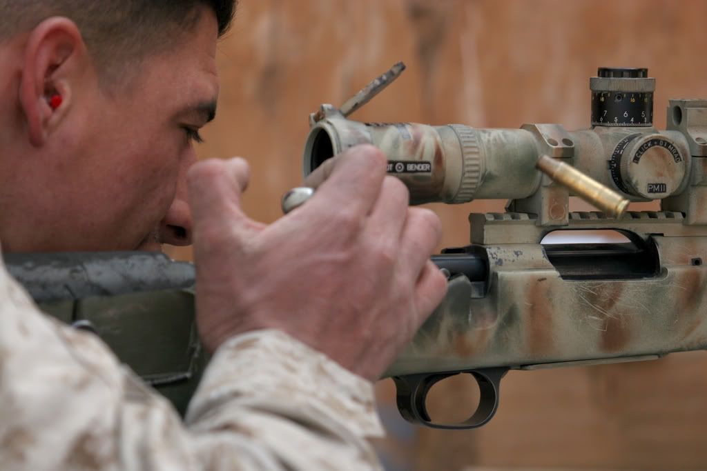

<div class="ubbcode-block"><div class="ubbcode-header">Originally Posted By: mcm308</div><div class="ubbcode-body">This brings a question to my mind... If the 30 moa base is suppose to be installed on a milled flat receiver. That receiver has to be milled to a certain height on the backside to get the correct 30 moa. If it's only milled a little bit... the base is going to sit at an angle higher than 30 moa... Correct ? This picture is from the A3 build guide thread from a while back... and it is milled totally flat...lower than yours...
JMO... But I would have the right side scallop cut lower like in these two pics of actual M40A3's... now would be the time to do it..
</div></div>
Hey how can the guy in the second pic shooting the M40 see with that big ugly moustache? J/K TODD is a hell of a guy and a HELL of a fine shooter glad to see He is still around. If Todd reads this when you coming to S. Texas to visit us bitch?

i'd double check the arc on the ejection port slot, I think it mabye should drop down more, but that is just "eyeballing" based on the m40a3 pics... I don't have one to measure or anything. not trying to second guess you, just wondering more or less...
either way though, you rescued it from a fate worse than death, so you are really a miracle worker!
