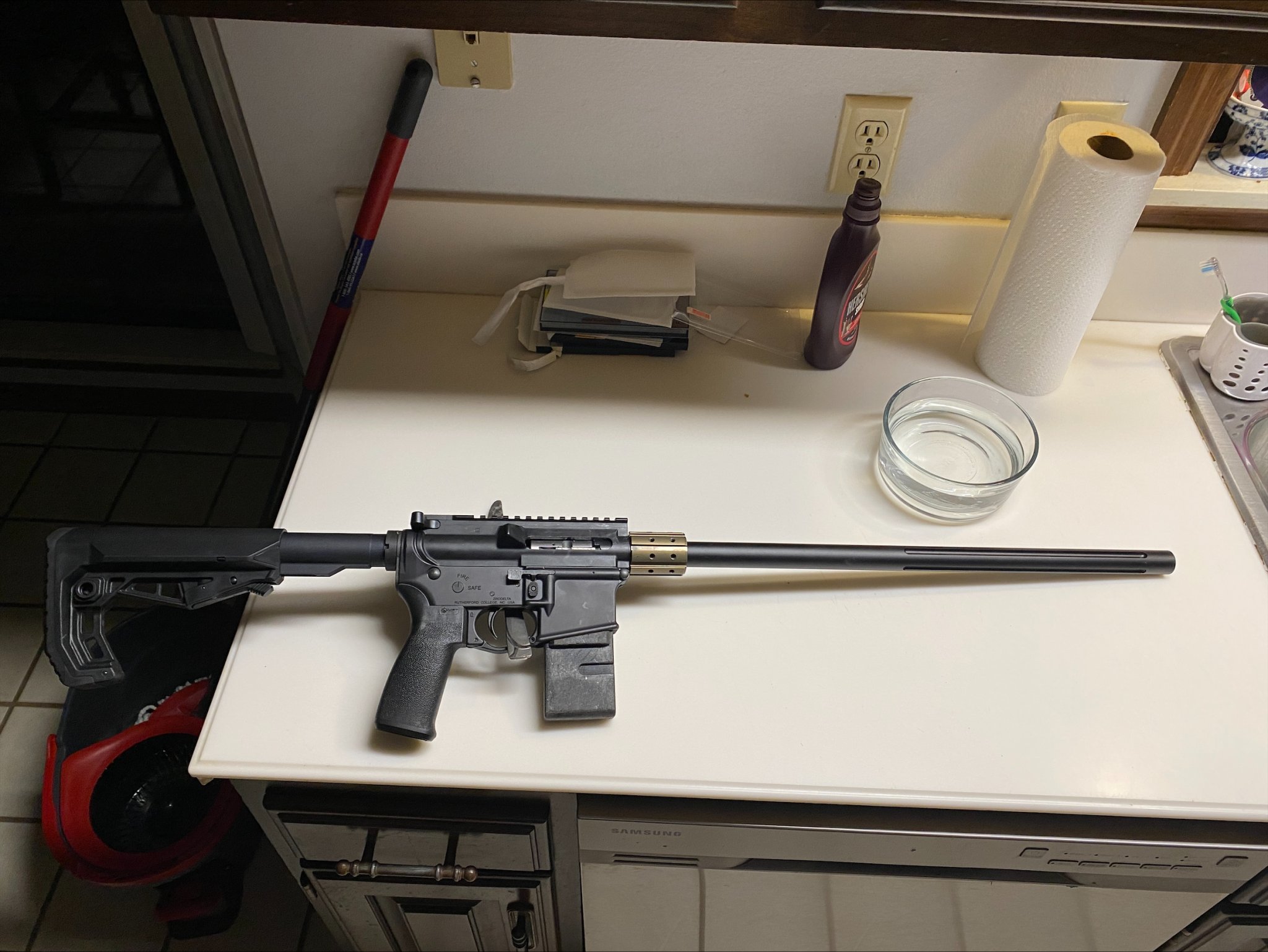

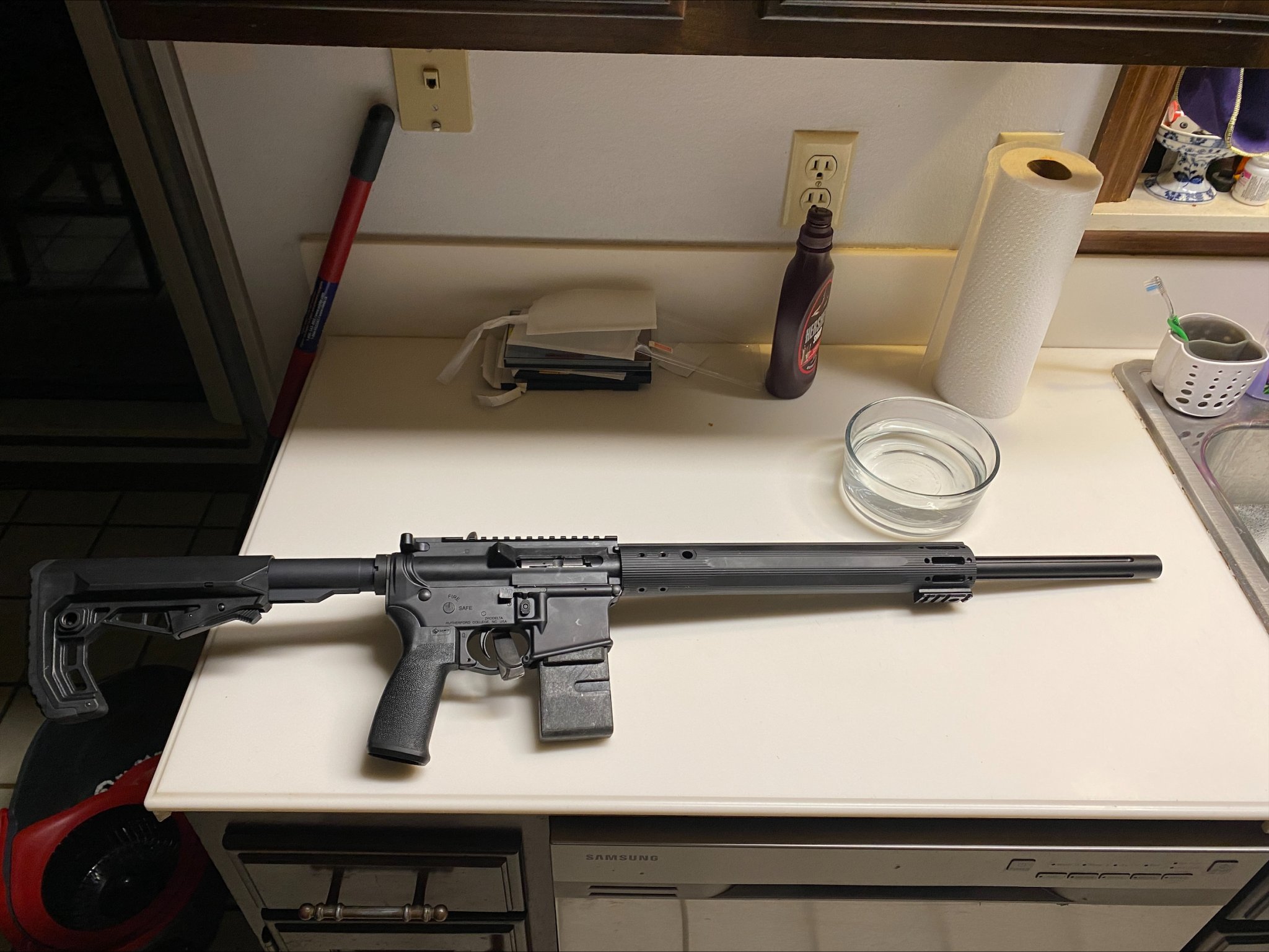

This is pretty interesting....I have also acquired a KRISS DMK22 upper. The original KRISS Barrel was swapped out for a 24" Green Mountain bull barrel. It shoots pretty dang good. I don't have any good targets I can share but it's a good shooter. So that got me thinking about the 10/22 barrels available on the market. I purchased an adapter from KRISS and bought a barrel from acculitebarrels (Whistlepig). It was on sale so if my experiment didn't work, I would be out too much. Anyway, the KRIS bolt is just a slightly modified CMMG bolt. A set screw is drilled & tapped in the guide rail to keep the bolt from launching off the end but the KRISS adapater essentially makes the barrel look like what Keystone Accuracy does. The KRISS Bolts are on backorder so I modified a CMMG bolt to fit the KRISS adapter. Just some filing to narrow the guide rails and open up the ejector cut a little bit. So far, this is running great. No accuracy reports yet but a 24" acculite barrel is very deceiving...and fun to shoot. I'll attach a couple pics.
The long and the short of it is...some AR22 stuff has come and gone but there has been some good stuff brought to market in recent years that makes this venture even more interesting. See Taccom3g.com and Borebuddy.com as examples.

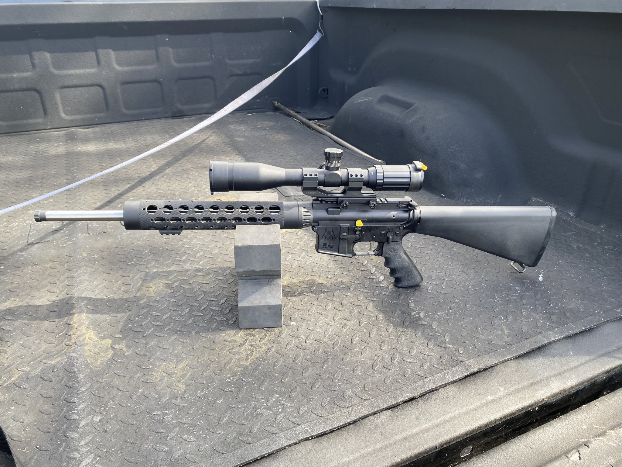

1st pic is the JP
then the KRISS/CMMG/Acculite frankenbuild.

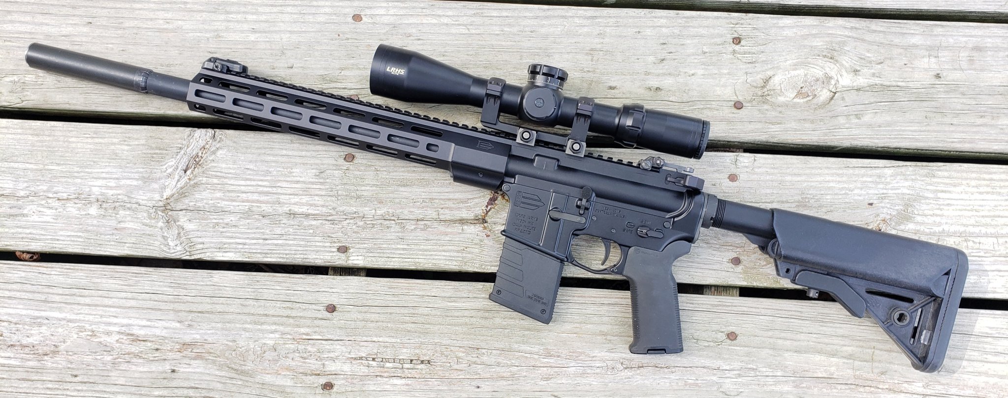

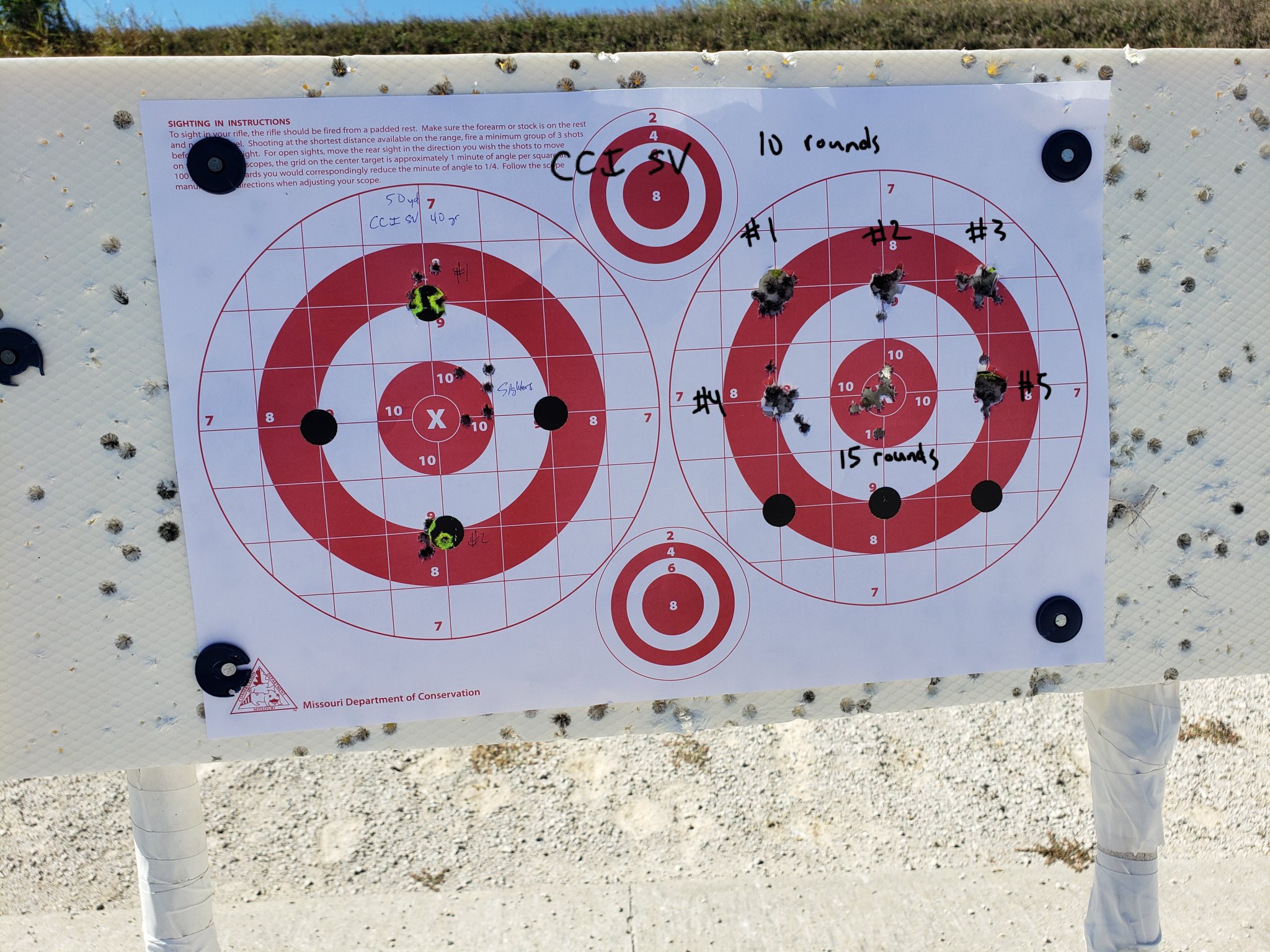

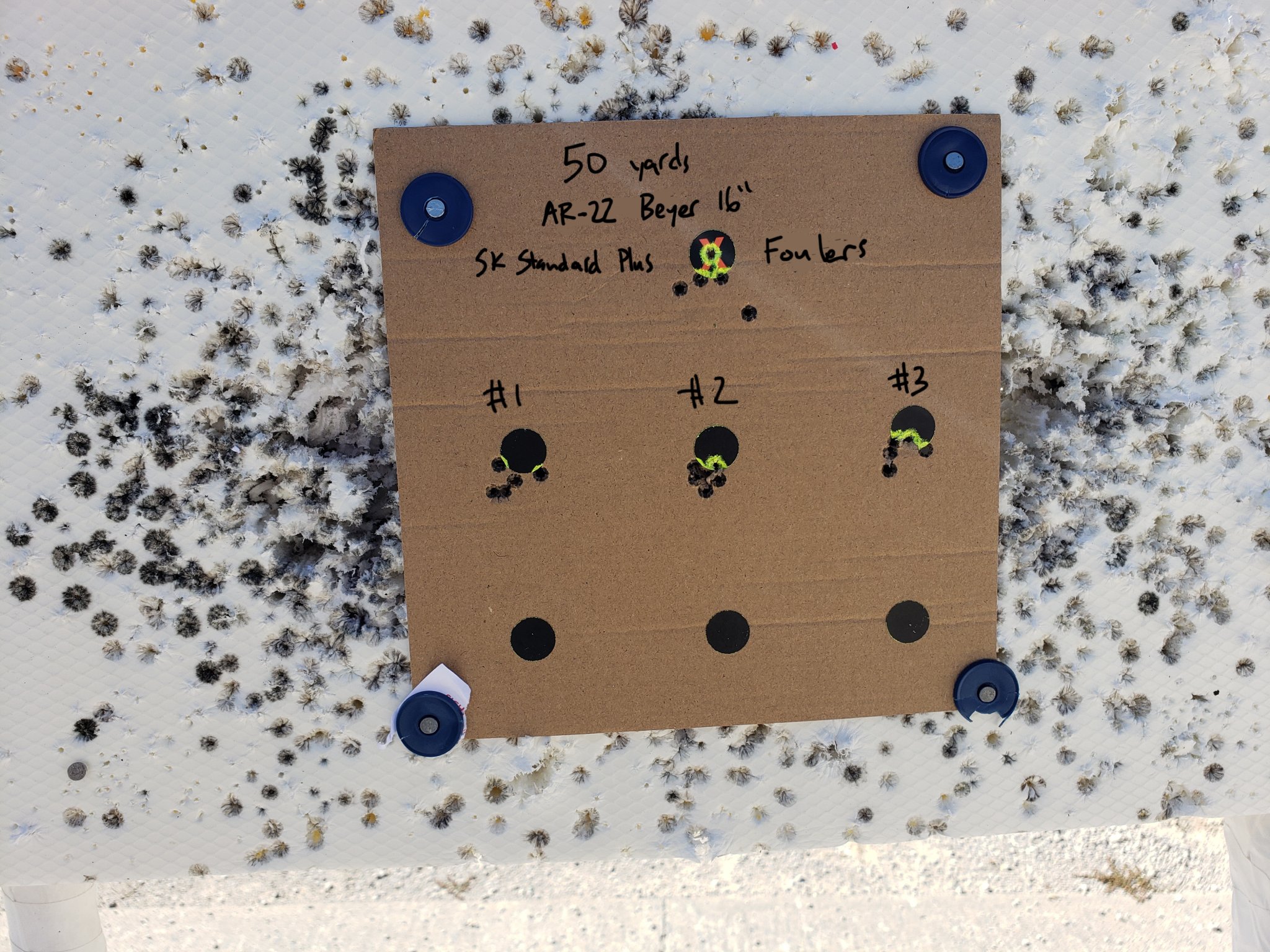

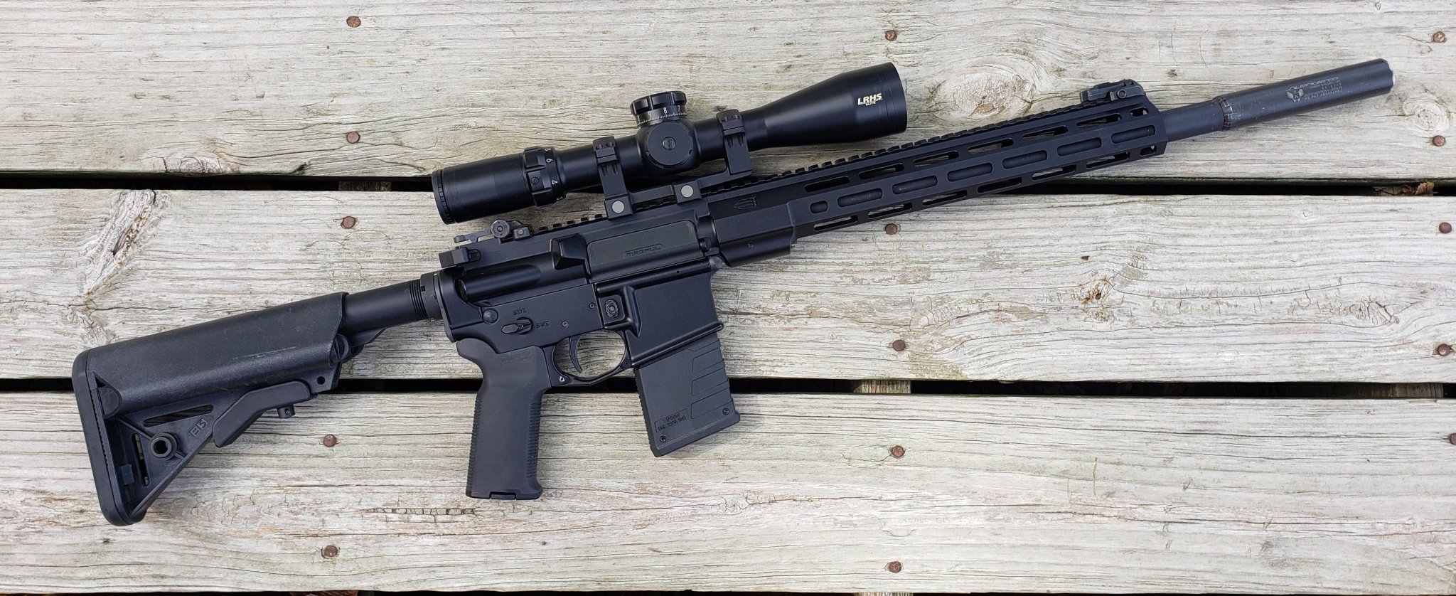

I recently put together a 16" using a Beyer Barrel and I'm happy with it. I've only had a couple hundred rounds but no issues besides the trigger not resetting but that's because I have Bore Buddy's adjustable weight kit and am still tuning it. I'm shooting mainly CCI SV and SK Standard Plus.
The Kriss 15rd mag let's me shoot comfortably off the bench but the spring seems weak and will not put enough pressure on the bolt catch to lock back on the last round. The 25rd mags are tight in the magwell in 3 different lowers so I've had to sand one down to fit. I have not live fired with them but lock back when manipulating the charging handle at home.
Build List:
Expo Arms® AR-15 Builder Kit - 13" M-LOK Enhanced Wedgelock Handguard
Beyer 22 LR Ultralight Target, AR15 16"
BoreBuddy Quiet Bolt (nitrided)
BoreBuddy 22lr Adjustable Bolt Weight - Gen 4 Adjustable
BoreBuddy Dedicated AR22 Pressure Plug (buffer replacement)
LaRue MBT-2S
BoreBuddy Bolt Catch w/ Kriss AR22 mags, 15rd and 2x 25rd
SilecerCo Sparrow
Bushnell LRHS 3-12x

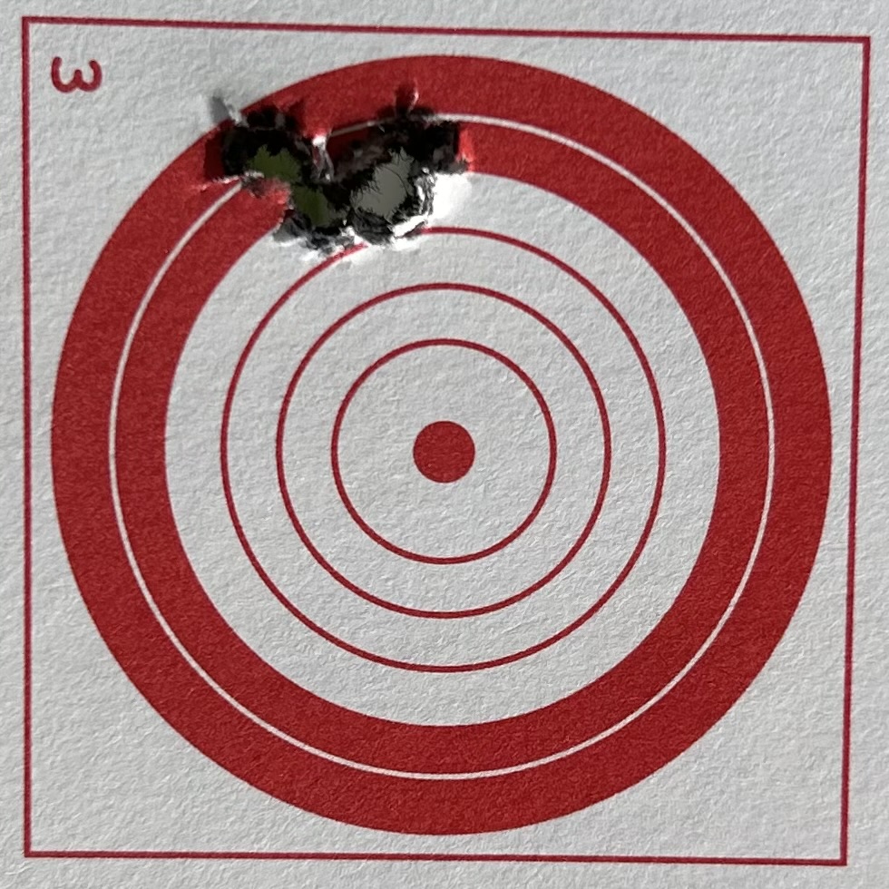

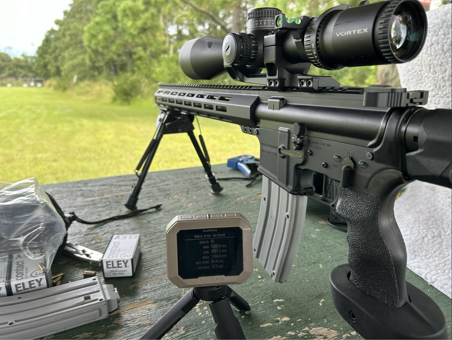

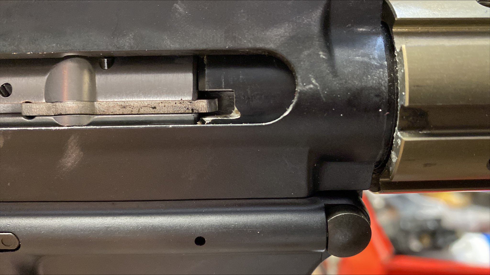

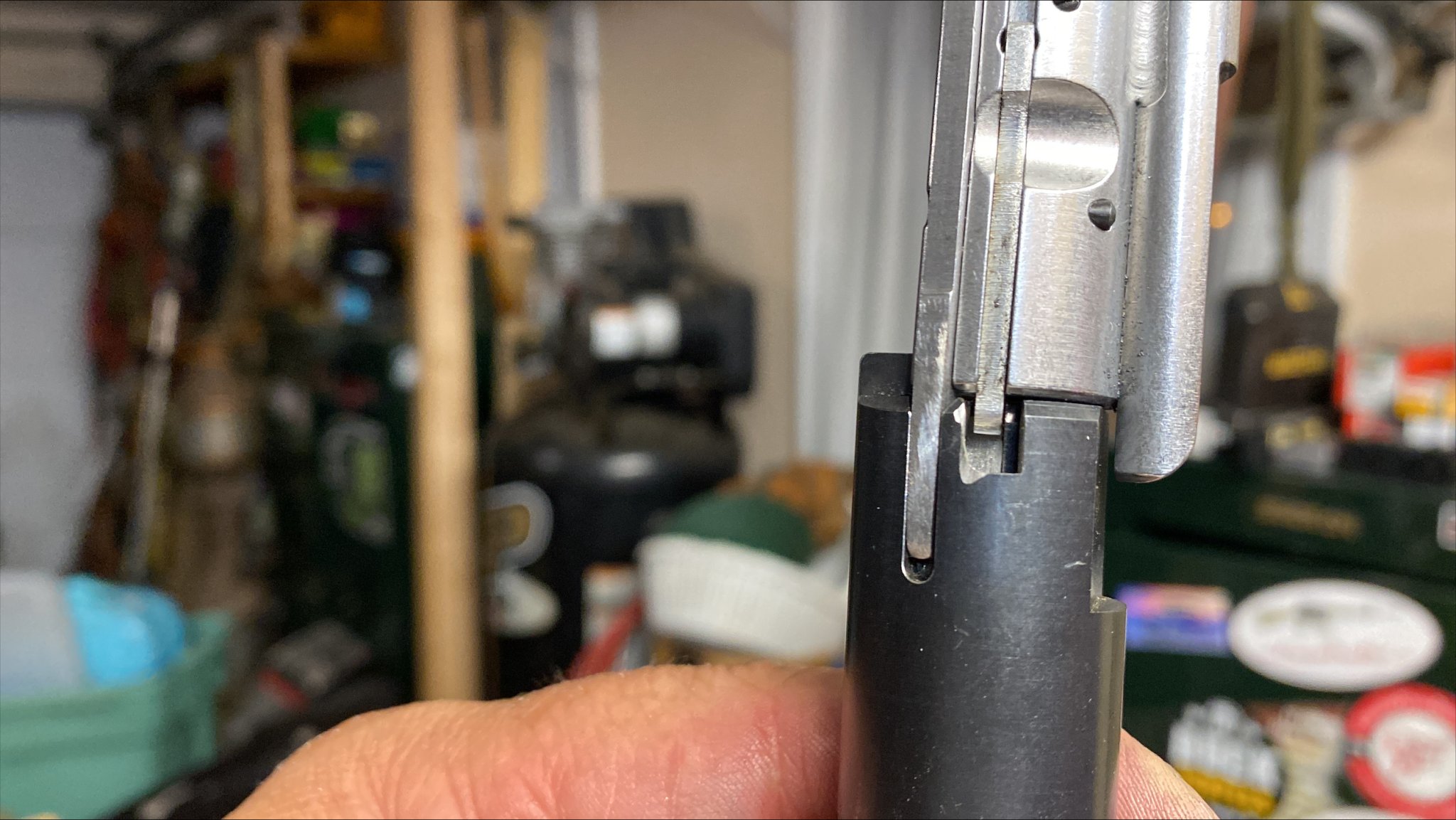

I’ve been working with a couple of these AR conversions for a bit, most recently testing 3 different but identical profile barrels (16.25” alloy shroud bull from TacSol), however the chambers (and feeding) are completely different. Last month I took it to 400yards on a 12oz soda can, and a couple of weeks ago shot this 5 round group at 100yds. Yesterday I tested the same rifle with different magazines, and while I didn’t have feeding issues, the groups were 2 1/8” for 10 rounds, so I now have to have a magazine test day not just for function, but accuracy.
