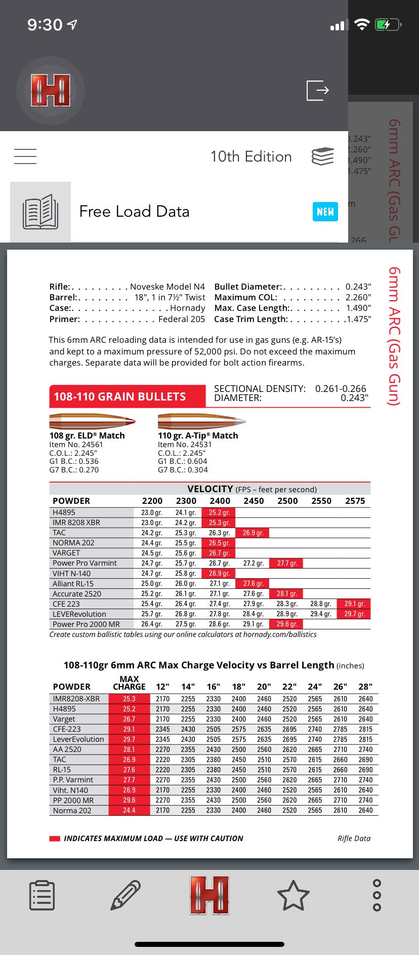

Edit: just saw hornadays reload data......cfe223 may be the go to powder.....even tho its sensitive to temp.

There are several powders that fall around the same burn rate but according to the Hornady load data that was published several of them despite similar burn rates still don't give the same results as CFE223. I am not expert enough to know the subtle nuances in powder characteristics to tell you why this is so.

I should also add that this cartridge is for both bolt guns and gas guns. Bolt guns per Hornady's info and load data says bolt guns have different published load data than gas guns.
Did anybody ever get an H2O/capacity measurement on a fired case? I've modeled the case in gordon's reloading tools, now I just need an accurate measure of case capacity (fired). Also, did anyone else notice that the case diameter at the base is improperly converted into metric on the SAAMI drawing? .441" is not 10.44mm.
Anyone have any guesses of what kind of velocities the 6mm ARC might be able to achieve with hand loads and a 26" barrel in a bolt gun? Wondering just how close it might be able to get to a Dasher.
On the gas gun side it lists 2785 fps out of a 26" barrel for 108-110 projectiles. I would think it's safe to assume even faster velocities out of a bolt gun.
