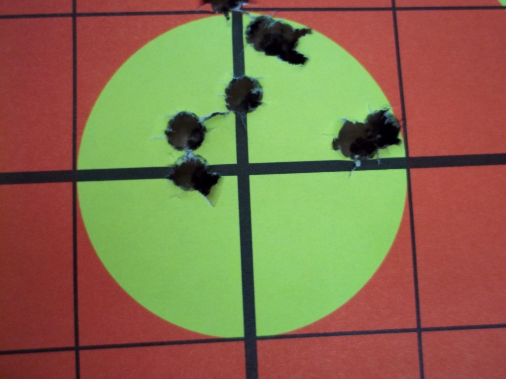

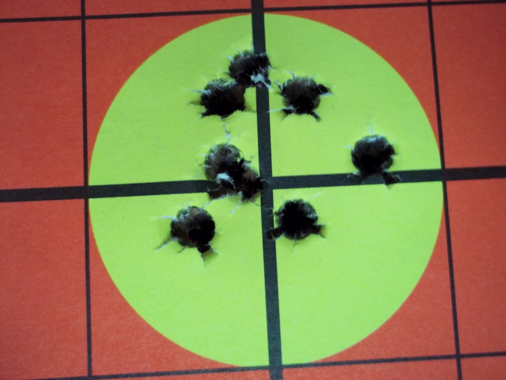

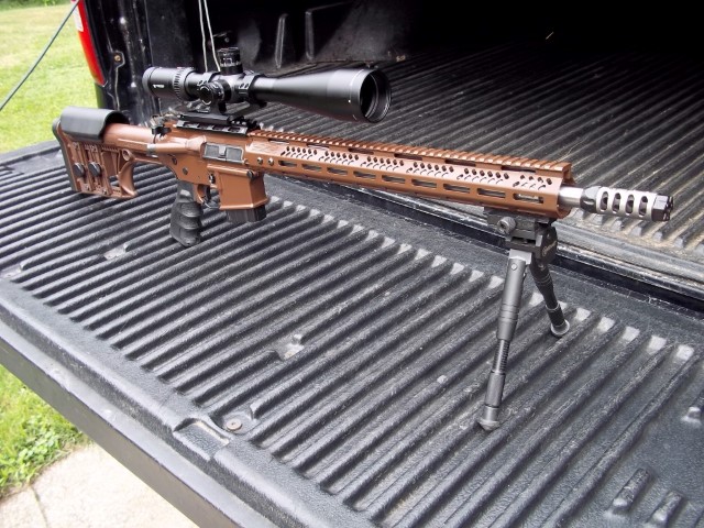

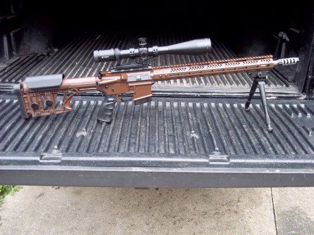

Pictures added

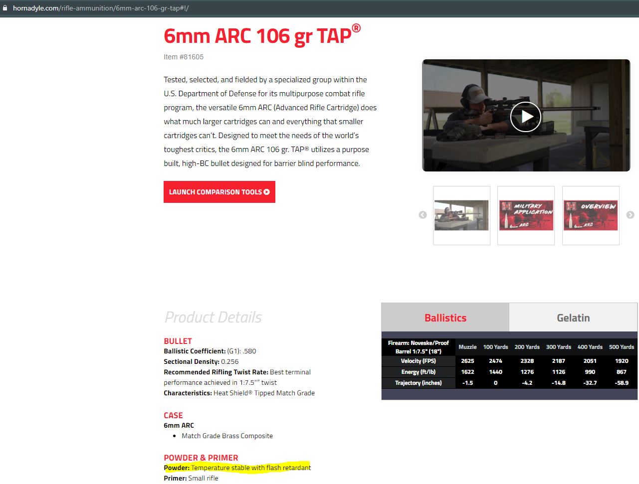

Found this as I was surfing this afternoon...has this been discussed? TAP 106 grain...claims it has temp stable powder w/ flash retardant...I would guess proprietary? If you go to that link, they have thumbnails and data table with barrier penetration numbers
Hadn't seen that one. I hope they get a manufacturer or two to put out some powder to match for the reloaders out here. It'd probably make a good powder for various cartridges, so we'll see if there's interest.
