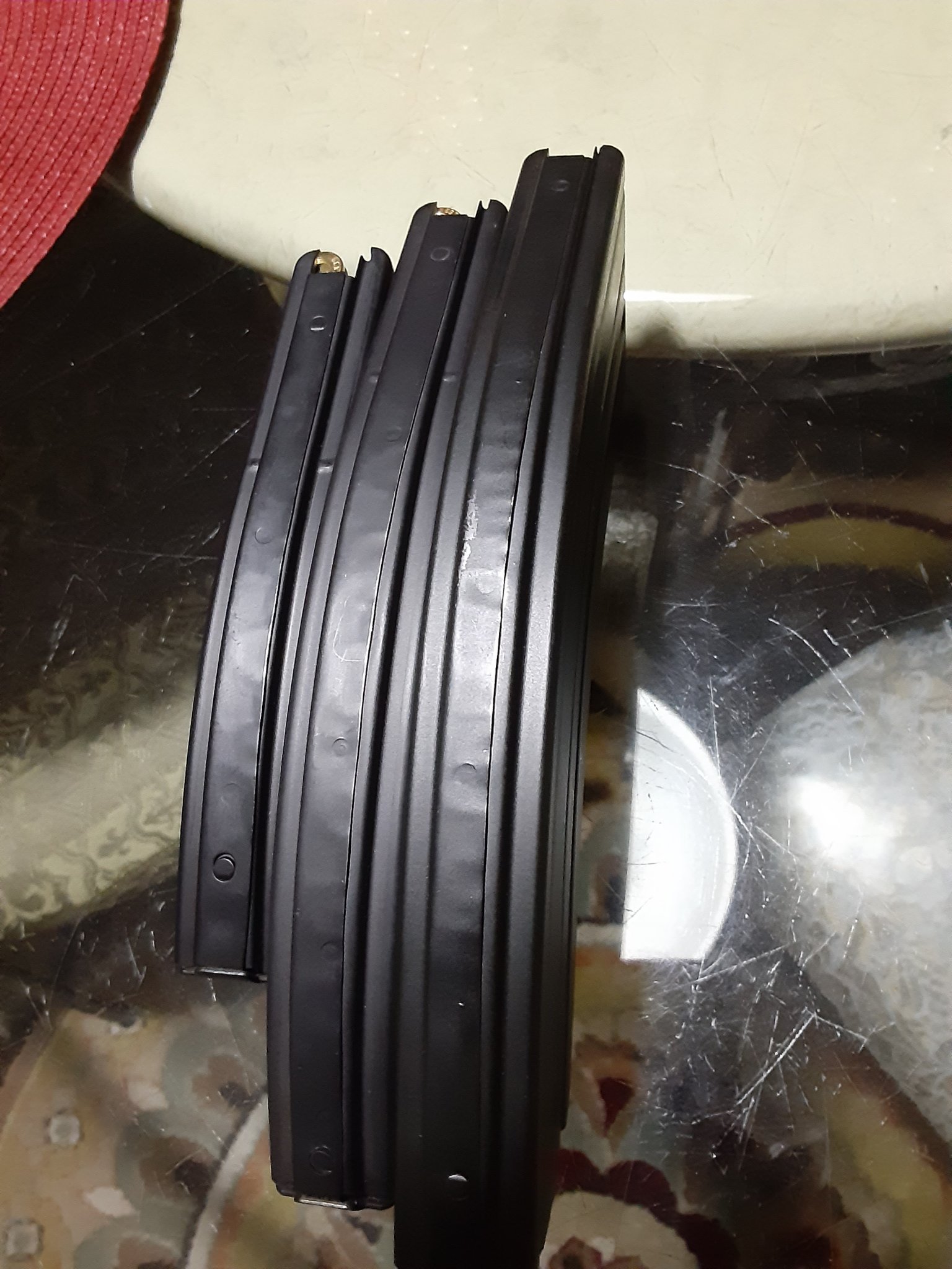

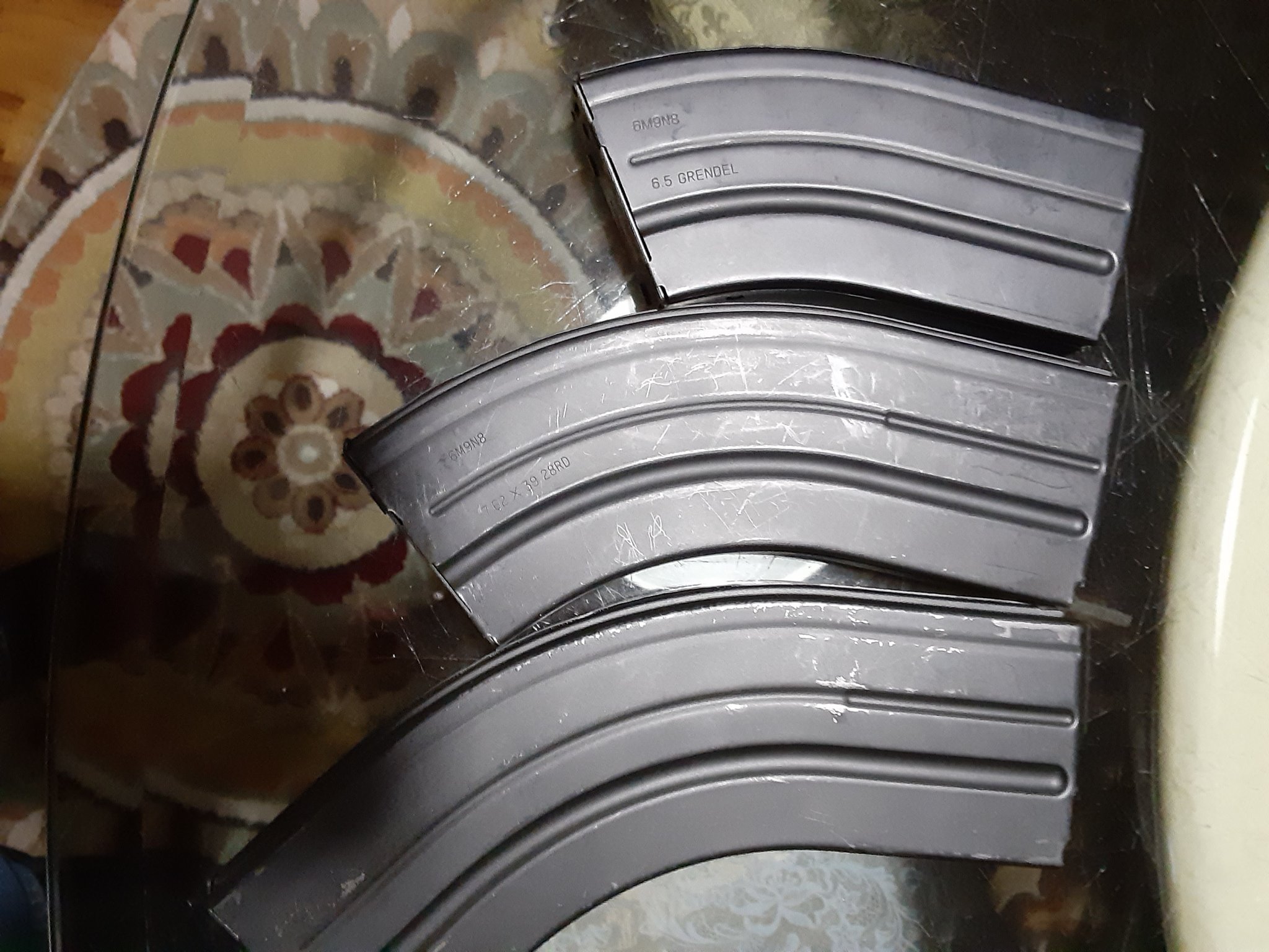

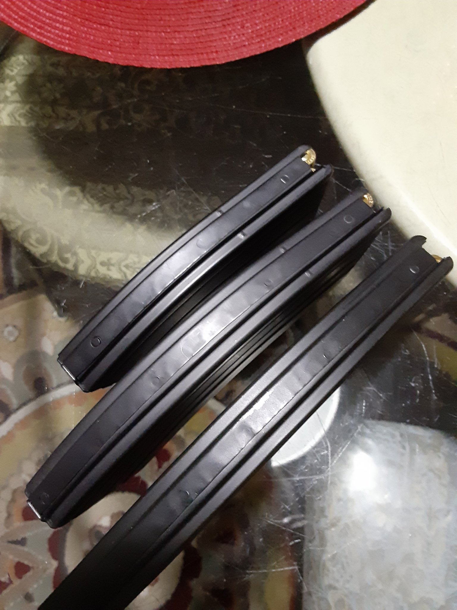

Yondering , Smallest to largest are :20rnd Grendel ,28rnd 762×39,30rnd 762×39. Without including caliper pictures, the 762×39mags are wider. You can see how the spine is tack welded with a gap instead of overlapping. The smallest(Grendal) mag also has a thinner center support rib(because of the straight Grendel case) I think the curve helps the case rims "space"a little better. Remember; the 5.56 case has a smaller rim and a longer body. Stanag mags were designed for ONE cartridge with ONE spec. My point is both Cproducts mags work for both cartridges (granted, it is easier to load the mags with their proper cartridges).That being said: Don't be such a jackass. Obviously,I have a lot of experiece with these mags. The other obvious thing is ;you don't. You can believe you are God's gift to Grendel and this forum but I am 53 years to old to be BS' ing anyone. Semi auto/military type rifles are my hobby. I have several AR uppers and lowers and many parts as well. I also enjoy VZ 58s,CZ bren2, Sig MCX, and all the old school U.S. military(Garand,M1carbine,mini14, mini30, etc.) My opinion is based on experience and intellect. I am not some blowhard newbie that just BOUGHT his first gun....and yes I reload: CFE BLK for 762×39 and Grendel....so I am efficient as well.
Suck it Yondering,
Suck it Yondering,

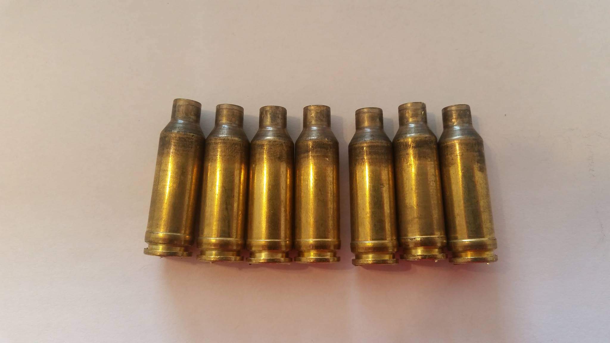

What was your load of LVR with the 105?? Were you seeing any brass marking on the case heads??

Just go back a couple pages and all my load dev is there. I have pics of case heads ect...

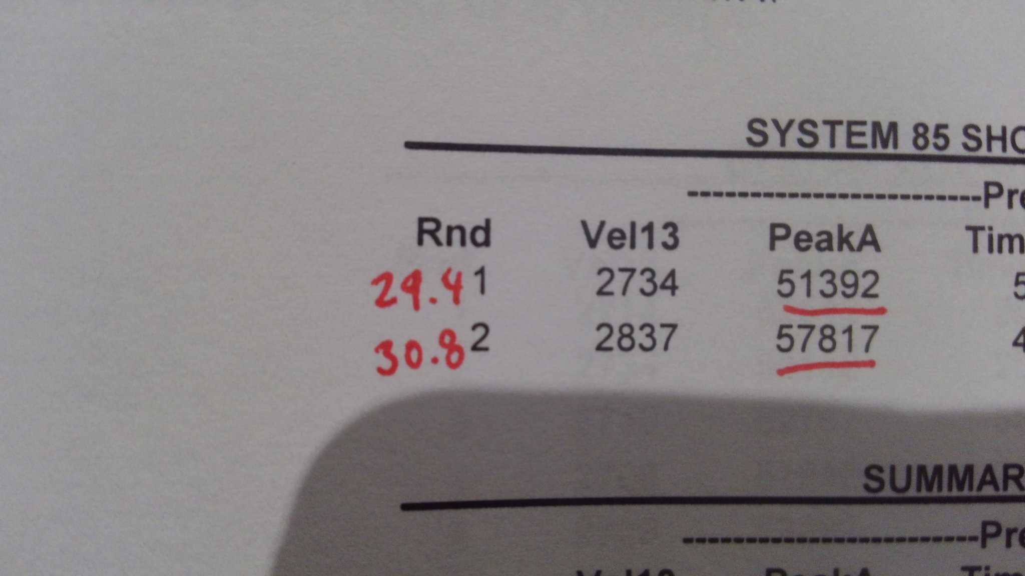

Correct me if I'm wrong, but the working pressure in a DI gun for the ARC, as with the Grendel, is based on the affect of increased bolt thrust on the life cycle of the bolt, not on what the brass can safely handle.
Based on Gordon's Reloading Tool, both of these loads are above 70k psi, while the safe working pressure for an Alexander Grendel bolt is stated as 50k psi. So while you may not be seeing pressure signs on the brass, you are probably beating the snot out of your bolt using those loads in a gas gun (jbailey, I'm not sure if you are using that load in a gasser or not, so excuse me if not).
I think at least for DI rifles, guys need to understand that just looking at your brass may not give you an idea of where you are in relation to the gun's intended working pressure.
I had 30.8 grains of LVR with a 105 at 67K+ in Quickload. The 29.3 load is around 56K, still over the SAAMI 52K. High bolt thrust on a weak bolt design. The thing with a Grendel bolt is they are fine until they aren't fine. Been there, done that, broken bolts, even a broken barrel extension (funny how precision machining, or rather lack of, causes stresses on lugs), case head separation on brand new Lapua brass (that one surprised me, and it killed a brand new elander mag), and a pile of brass turned into scrap. I decided to back off to normal pressures before I ended up a pirate, or learned the nickname "lefty".

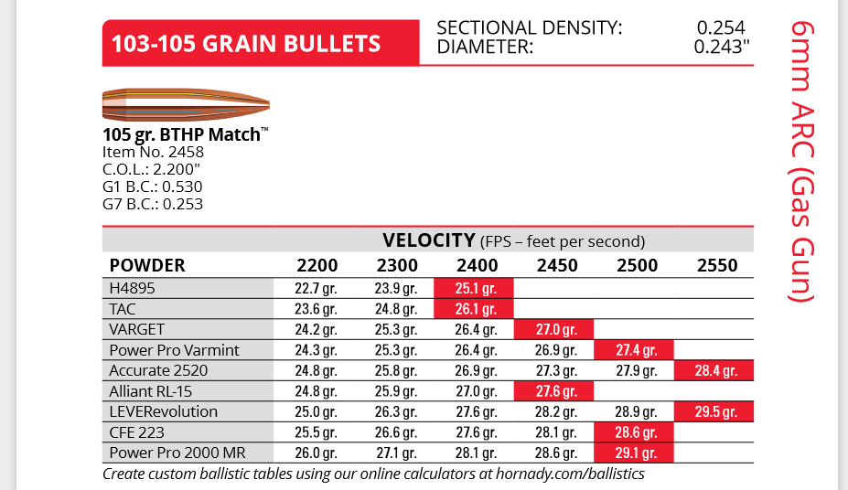

Honady's max load is 29.5gr. behind a 105gr. bullet. The problem with these ballistic calculators is they are not very accurate predicting the 6mm ARC round, I have seen this on more than one of them. You have to tweek them to get the match between what you are shooting and what they say is correct. I got Quick load very close to what it should be.
This is a screen shot of Hornay's gas gun page.

Bad call. The load data is done in a properly corrected SAAMI pressure test barrel and is up to the full 52,000 PSI that is recommended in Grendel/7.62x39 bolts.
I believe the RDF has less bearing surface than the Hornady 105 BTHP, and the max book charge is 29.5gr so you're probably fine at 29.4. Not arguing that.
I continue to see this trend of people thinking that book data is "lawer loaded" or conservative and it's not. I've seen the process and it's just not lol. The "lawyer" part is in the front of the book where they tell you they're not responsible for you blowing your stuff up. Obviously component changes can change pressures (more dramatically in some cases than a guy might think), but for the most part pressures signs that you can see on the case head start showing up in the low 70ksi range (semi-autos can be much lower-- in the 50's, depending on gas system arrangement from bolt unlocking/timing issues). There's lots of knobs to turn but the point I'm getting at is that when the pressure limitation is there for the bolt lugs, not the brass necessarily, the standard "pressure signs" aren't going to show up before you're in the red zone and all you really have to go off of is published load data, and the published load data is not "lawyer loaded".
With a properly tuned gas system, a guy could run 60-62ksi all day without visible pressure signs and fatigue load your bolt in short order. Equal pressure in a Grendel/PPC bolt face is putting ~30-40% more thrust on the bolt than 5.56/.223 sized cartridges. Cuts into fatigue life pretty quickly.
Hornady tells me that at 29.4 gr. the pressure is 51,800, psi, with the 105 gr. bullet. That is within the 52,000 psi limit of the bolt. And their is a buffer margine calculated into it. Hornady is not going to publish unsafe data on any round, let alone one of their rounds on a platform that they developed.
What I was replying to is that their is no way that load was coming close to 70,000 psi, and I believe that the ballistic calculator spit those numbers out. As I had stated... I have yet to see accurate information from any of them. You have to tweek the input numbers to get a more accurate output. And I would not put my life on the line from any data from them, they are simply just a guesstimates. At least with 6mm ARC. I would never determine my load from any information from one.

Shot-to-shot variance is on the order of 1000-2000psi on good loads, often worse. 51,800 effectively is the same as 52,000. You're talking less than a tenth of a grain to average 200psi difference over a large enough sample size to matter. While I agree they're not going to publish anything very much over 52,000 psi on the nose (in their gun, with their brass, and their bullet, with their cleaning regimen-- which is not the same as yours necessarily), that doesn't mean there's a ton of leeway.
And again, I'm not arguing that you're not safe at 29.4. The RDF is probably going to have lower pressure for the same charge as the Hdy BTHP because it has a shorter bearing surface. However, I maintain that while you may have some success guessing what's safe, without a pressure barrel you don't know and there may be a window of performance that exceeds safe pressure but doesn't show you anything. That doesn't mean it's kosher. It just means you can't see it. Recognizing that is an important part of trying untested or unpublished loads, especially in this situation where the brass won't show anything until significantly higher pressure than what the gun should be fed.
Realistically, odds are that if you ran hot for a long enough time you'd break a lug off and have a bad range day, but then again, there's always the inner dialogue of "what if it's worse than that" in regards to you and others around at the time, etc... Anyway, banking on 'soft' max charges in published reloading data isn't a great habit IMO. From what I've seen they're right up to the SAAMI MAP. And that's in a temp controlled lab in relatively clean barrels.

I never said your 29.4 load was 70K, I stated the 30.8 load, with cartridge length to fit in an AR mag is around 67K. That uses default inputs for temp, so assuming load development was in cooler conditions, you should expect higher velocities and higher pressures when summer rolls around. Shoot whatever you want, I just figured a little info might be handy.
That's the trouble with QL or any other calculator though - if you haven't trued the results for your barrel and components, the margin of error is so large that the results are pretty much useless.
From personal experience over a lot of rounds I seriously doubt that 30.8 load is at 67 ksi. That would do noticeable damage to Grendel brass (specifically the "belted magnum" appearance) whether it's in a bolt action or an AR. I'll trust Hodgdon's data way before anything some calculator spits out; real world results always trump theory.
If you start off by truing your calculator to match several different loads from published data, then you've got something capable of putting out reasonable results as a starting point. Then true it further to match your rifle (i.e. if velocity is different than predicted, then the pressure curve is probably different too.).

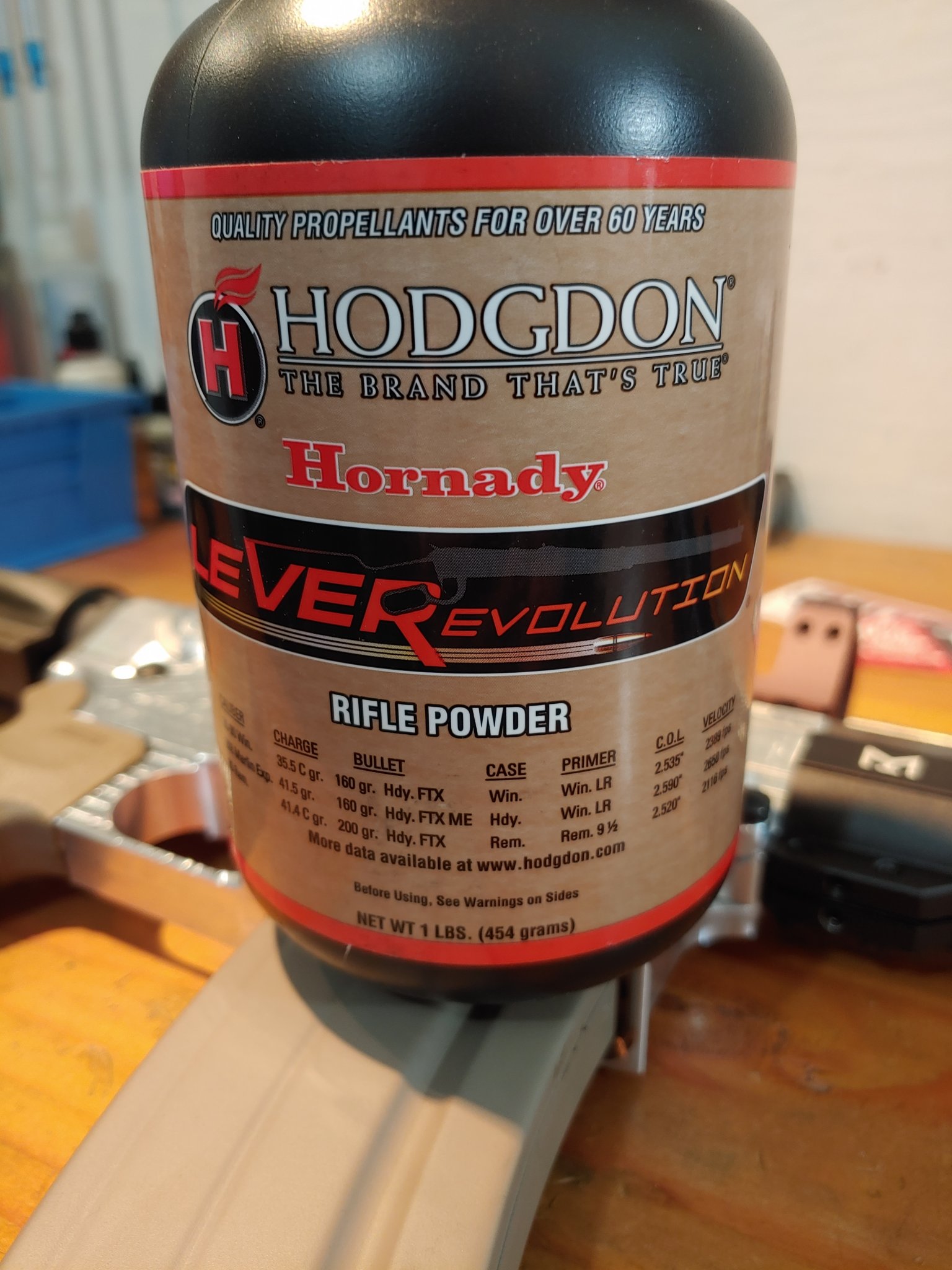

Also if this factory ammo 'IS' loaded with Leverevolution then it would seem to be over book by a full grain.

Just FYI- the factory ammo is NOT loaded with Leverevolution, it is a non-cannister powder.

If it makes you feel any better, I've been loading 31.0gr of Lever under the 105 BTHP as my standard load in my 243 LBC rifles (granted, slightly more capacity but not enough to matter that much) for a few years now in 3 different rifles. Two were built on BCM uppers, the thermo-fit tight bore pretty much guarantees barrel extension alignment with the receiver, and the other was trued and shimmed so all of them have very uniform lug engagement. The only issue I've had was a broken extractor on the first 24" rifle after ~600 rounds running a bit over-gassed with a .125 bolt (the extractors are a little weaker and early extraction adds a lot of stress). That load is certainly hotter than Hodgdon's data recommends for an AR, although the numbers correlate very well with their 24" bolt gun velocity for the same load. Load at your own risk and respect the potential for danger, but don't be scared of it; if you follow their AR15 data you're not exactly pushing the ragged edge of safety or anything close to it.
And yet you are claiming that a load directly out of Hodgdon's actual tested data is making 67 ksi based on your QL prediction. Their real world results are far more credible than your QL predictions. You'd do much better to tweak your QL model to match their data, and work from
No, I said the load listed above which was a 105 Hybrid, at AR mag length with 30.8 grains would be 67K. The Hornady bolt gun data is stated to be at 62K, and I was pointing out that the data should not be used in an AR, hence the bolt discussion.
So are you implying that if you change the bullet in your model to the 105 BTHP your prediction will match Hornady's 62K data? Because if it doesn't, your prediction is wrong. That's my point. If it does, maybe you should have said so to start with.
If you have a solid starting point like that (closer the better), then the prediction might have some value. But the more variables that change from that correlated starting point, the less useful the prediction is.
I can't tell you why Hornady's data is the way it is. I know if I use Hodgdon's data the QL estimate is lower pressure than they tested, and Hodgdon actually ran pressure testing. The Hodgdon max charge weight is 28.2 for a 107 (51,800psi), and 28.5 for a 103 (51,100psi), both well below Hornady's 29.5 for a 105 (52K AR15 data). Assuming the Hodgdon data is accurate, calibrating to their tested pressure, 30.8 grains estimates at 66,000psi. Without calibrating to the actual measurements of a specific rifle and components, and then performing the actual pressure testing, we won't know actual numbers, and I am not getting out the pressure equipment just to test a Hornady 105BTHP. So the same powder, different bullet, Hornady states the pressure is 52,000 max, and Hodgdon posts the tested pressure number with the load. So either Hornady has a test AR barrel with a longer throat chamber, or they tested that unstable ball powder in cold temps, or some odd conditions exists. In any case, I still would not recommend using the Hornady BOLT GUN data as justification to exceed their stated max AR15 data in an AR15. Have a good one.

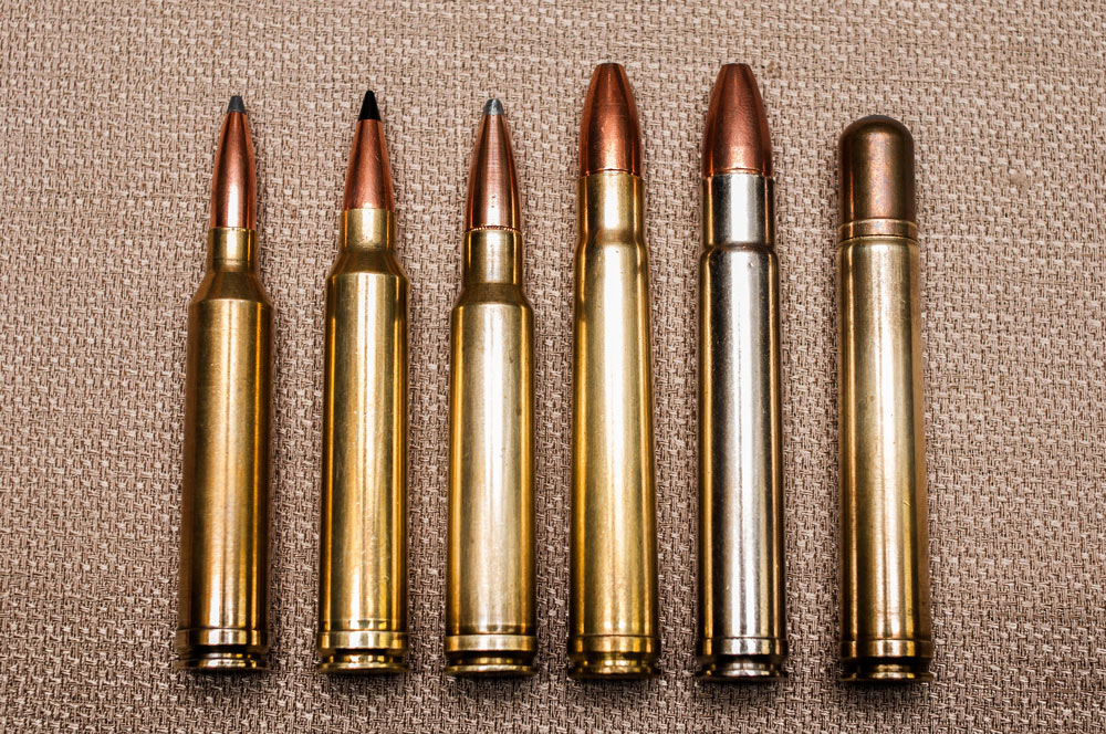

What do you mean by your brass looking like a "Belted Magnum" appearance?? Is this right at the base of the case?? I have seen this on some of my cases but I thought it was because I had "Oversized" my case when I sized it down more than I should have. I had bought some "Once fired" Grendel brass and it wasn't chambering like it should. I thought it was because it had been fired in another chamber and I probably needed a small base die. I actually cranked my die down until I got a slight "Cam over" and I still had some issues with chambering. So I set them a side. This brass had been mixed in with my new brass during the process of making 6ARC brass. So I don't know if it was from sizing or happened during load development. I had never seen it before until I started with the ARC.......
Belted brass...
The lower part of the case is used to headspace the cartridge.
This is an extreme case in a Grendel, "Lapua Grendel belted magnum".
Variation.... Not everyone's SAAMI chamber is the same, not everyone's bore is in the same condition, not everyone's bore is in the same state of cleanliness, not everyone calibrates the same lot of cases, not everyone uses the same primers, the same bullets, etc.. etc... Ball powders vary lot to lot more than H4350 or Varget...
ETA: Hornady has hundreds of pressure test barrels, often multiples for every cartridge they produce. Seen it once.
As pictured above if you get a little sloppy on how deep your chamber chamfer is, or how big a radius you use on the corner break, you can leave unsupported case body that will expand and fill the 'void'. I've drawn this up in CAD before and you gotta goof it IMO on the machining side to create the situation. The deeper grendel bolt face means you have less wiggle room but you still gotta get a little zealous on the material removal to make room for the belt that far forward on the case. Unfortunately the pictures exist (as far as I'm aware, happy to be corrected) with no context to who's bolt/barrel and what the actual measurements were that created that. It's become a defacto "grendel problem" whether warranted or not.
ALL AR barrels have a larger chamfer at the breech to aide feeding. Bolt guns do not need a huge chamfer.
We've had this discussion before. I've spun my own ARC and 556 AR barrels and drawn the ARC setup in CAD and there isn't unsupported case where those pictures show it unless you cut the chamfer *too* deep or make the radius *too* large.
A short 1 minute video explaining belted cartridge, they were manufactured with the belt.
Grendel belted magnum is just a goof on the brass that swells after firing in the same location due to a weak point in the brass wall lining up with the bolt to barrel connection. The brass is trash after it happens.
