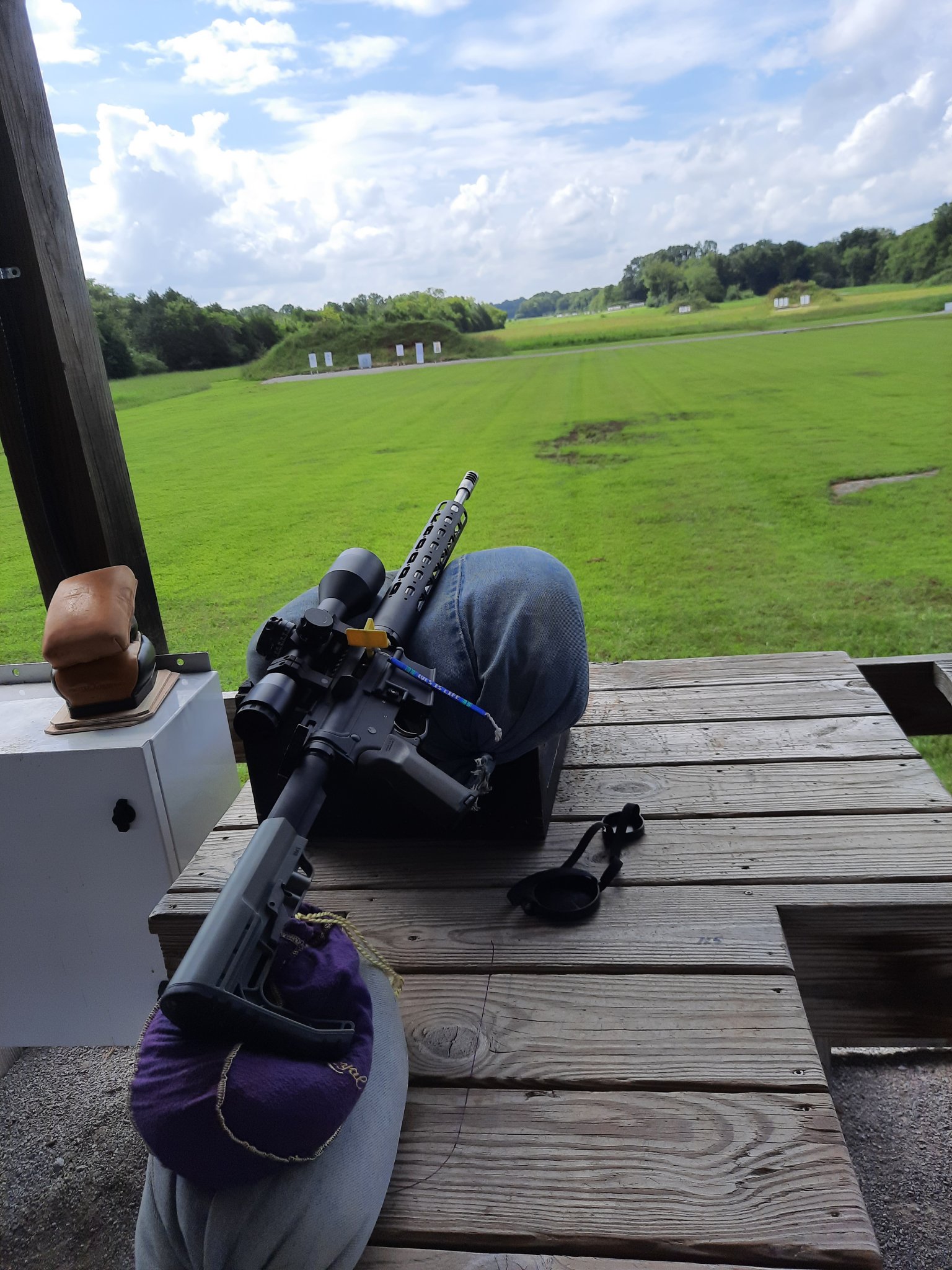

Shot a regional match with my AR in 6ARC today. Factory 108s. Very impressed with the performance out to 1000 and it held its own against the bolt guns. Top 5 overall and most of my dropped shots were because the heat got to me and I had shit for brains. Same can be said for the other shooters though.

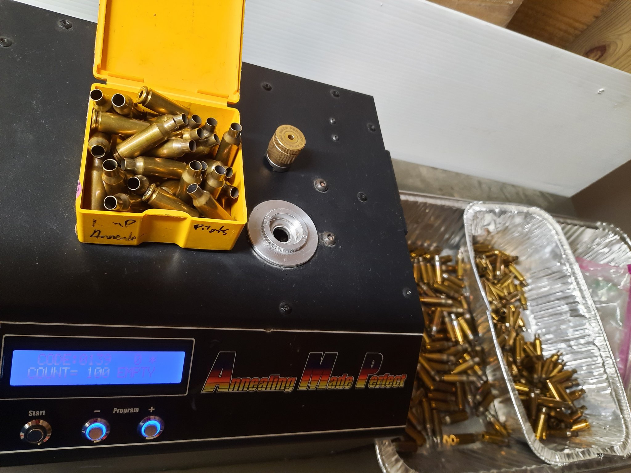

I got to anneal 250 cases and some 6.5CM too.
After the match, everybody left and the wind died. I shot the 1250 plate on my 6.5CM with the new Ivey base and Sightron 10x50 - heaven for me!!! got to test a cool 22 too.
I need to make a better bag system, and I have one in mind. I also will probably off that stock and put one on that will slide on the rear bag better.
