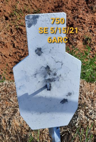

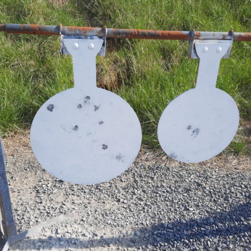

Shot 1k groups yesterday. The Valdada fixed made it possible/easy. Once I got dialed in at 600 I just used holds and no dialing!!!
Shot my sporter Eddystone and the CZ pistols too, it was a great day. The glass on this thing lets you see hits at 1k then listen for the ding.

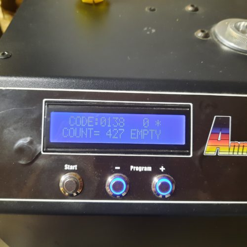

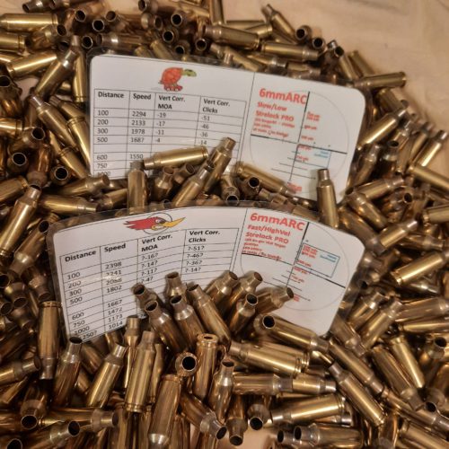

At the end of the day I annealed 427 pieces of brass and I have 1k more on the way - again, goodbye 223...

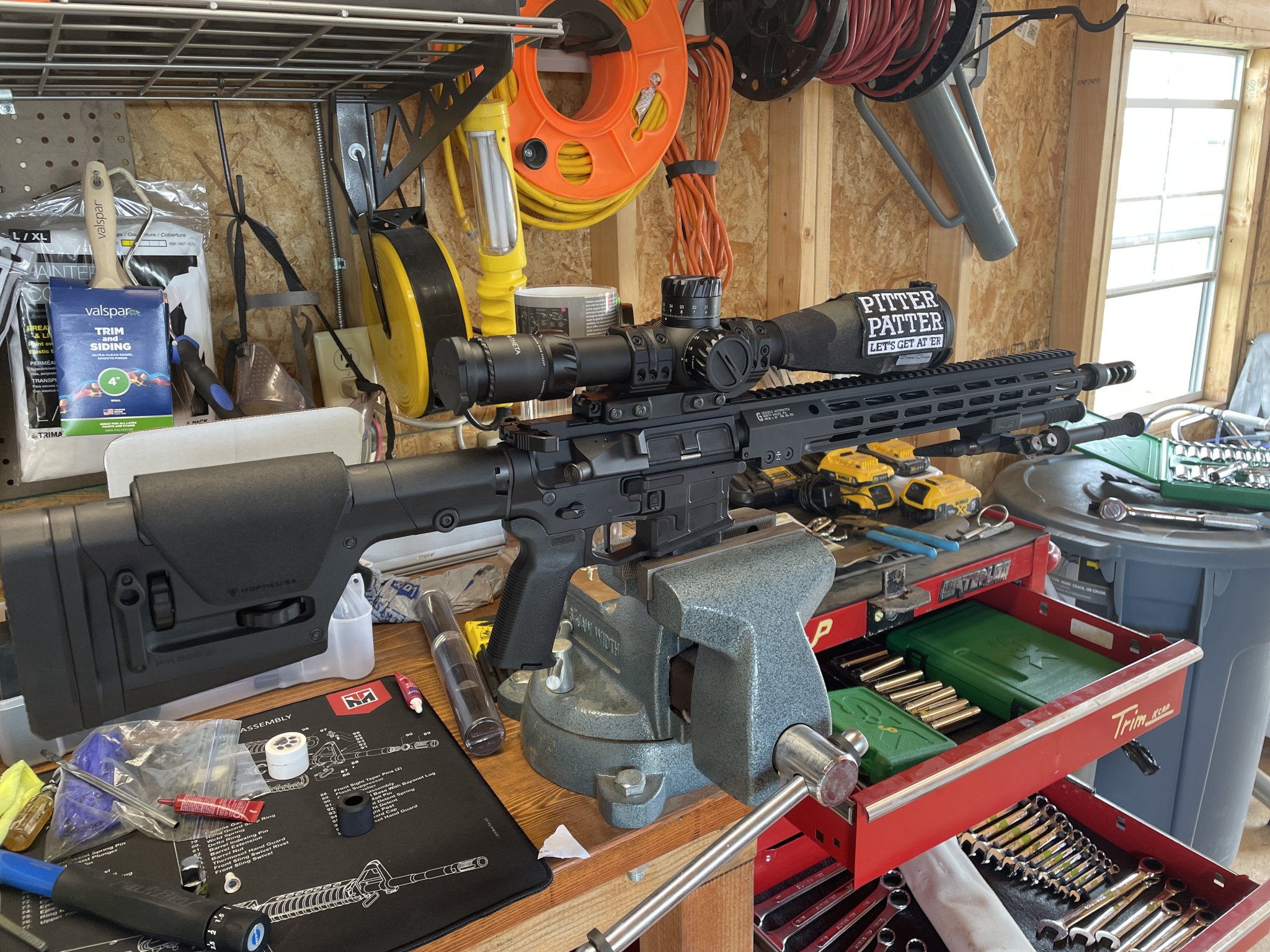

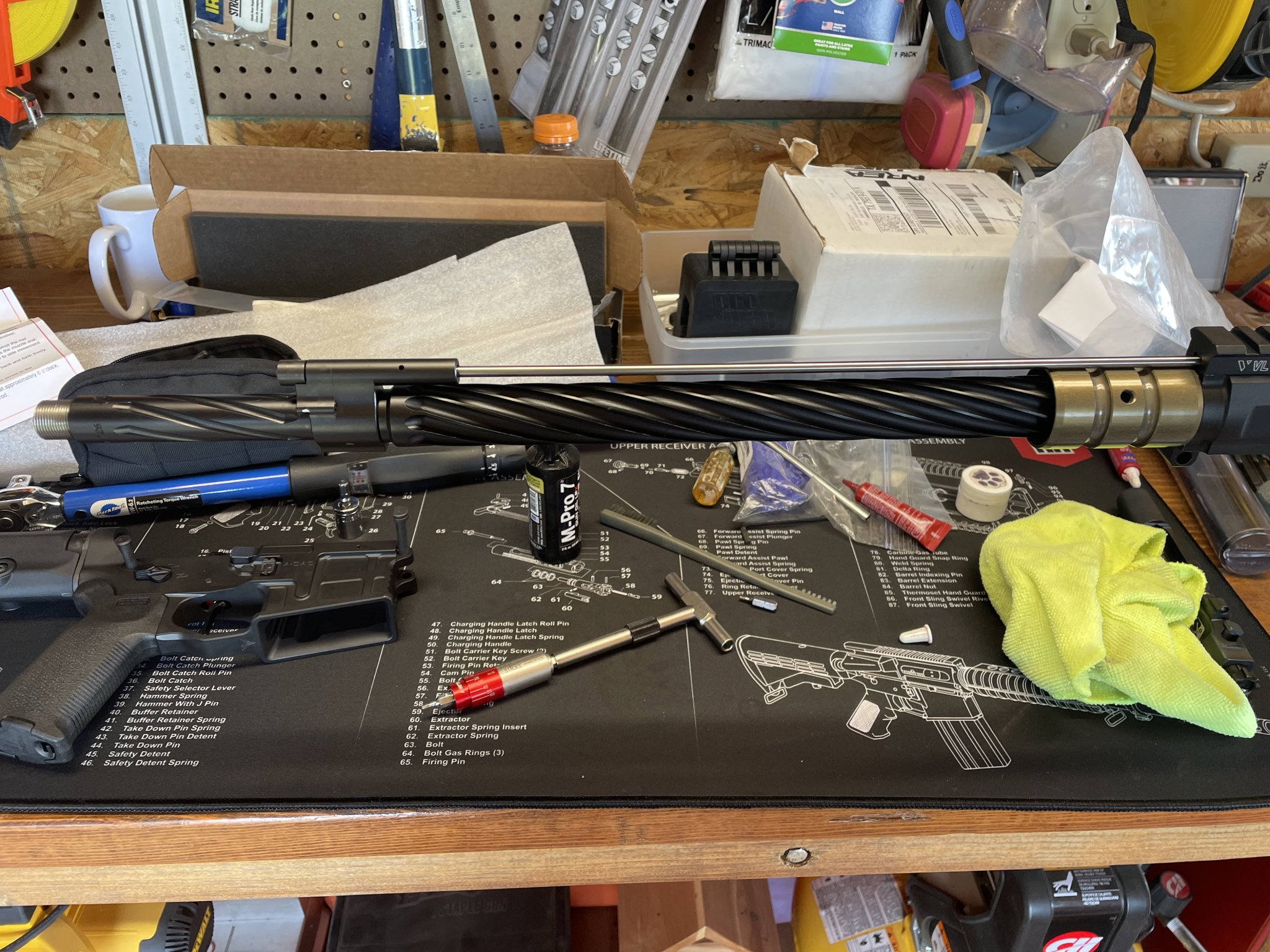

Starting a 6ARC build, my first AR build. I’ve received the upper, lower (SLR), trigger (TT), stock (PRS Gen 3), charging handle (Radian Raptor SD-SL), and other various small parts. I did just get in my 6ARC die (SAC).

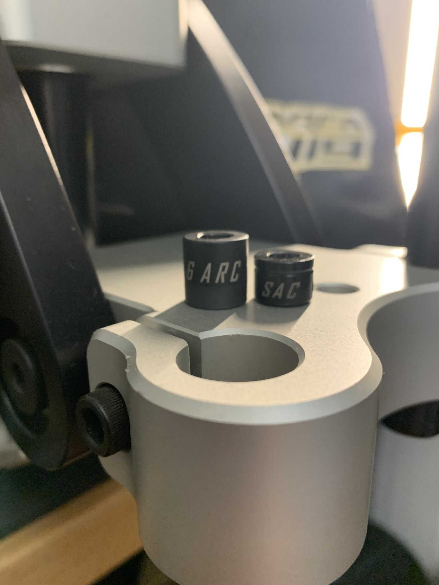

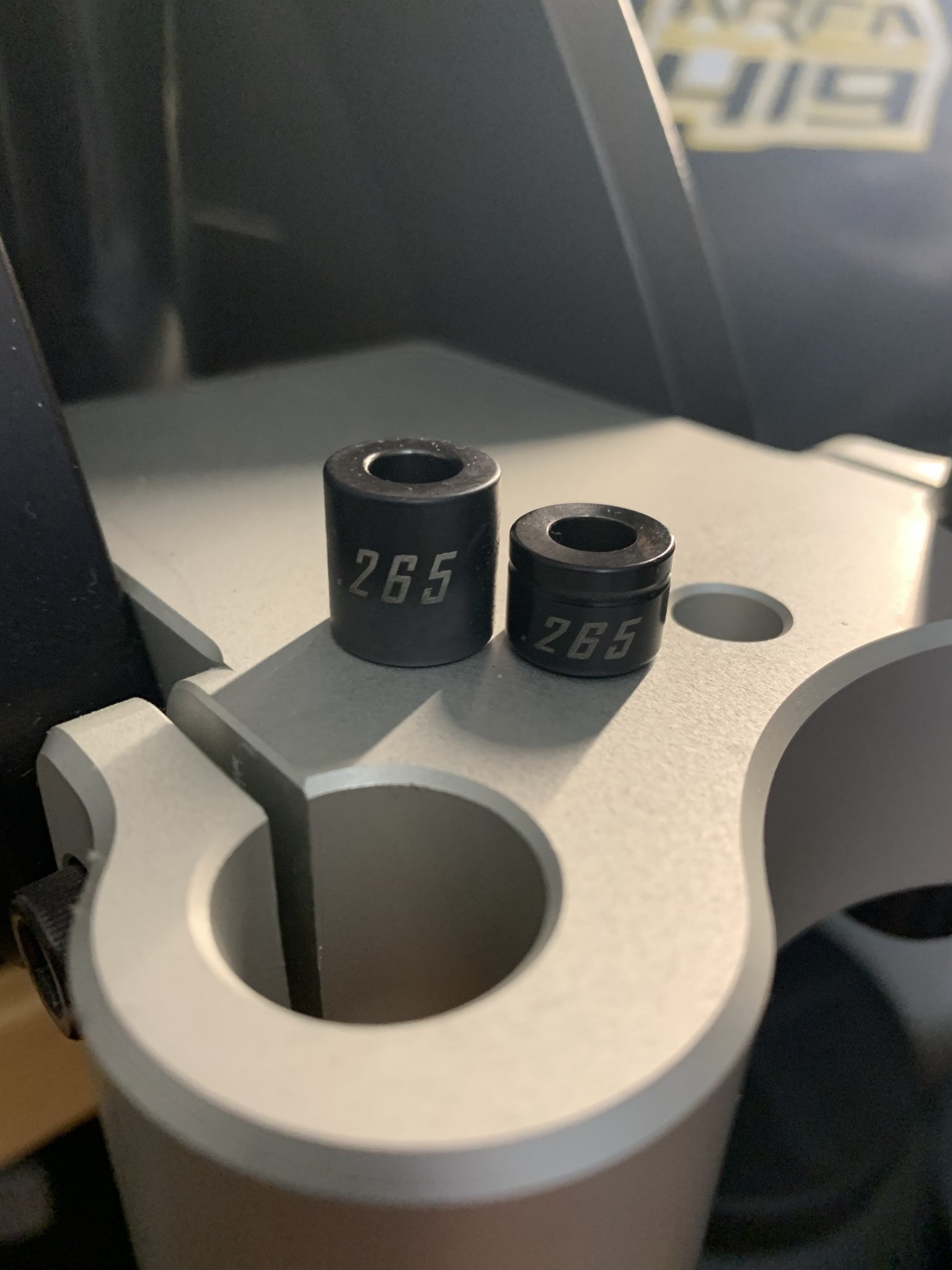

I compared the .265 bushing in SAC 6ARC die vs. the standard .265 bushing in the attached photos.

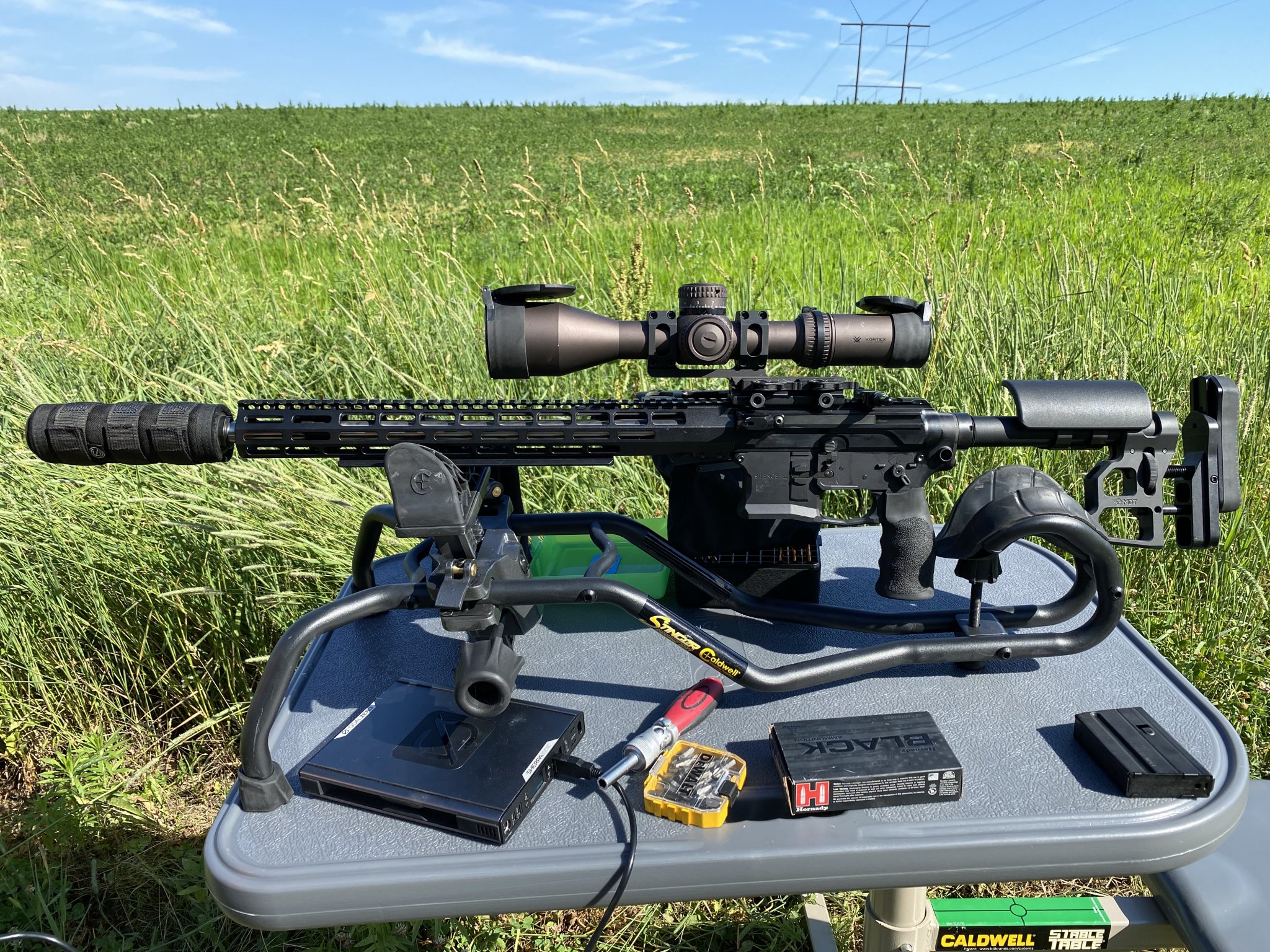

Finally got my barrel from Paul craddock. He’s a great guy to do business with. So threw the build together and off the range to dial in the gas system. I’ve got too many projects going hence the mess.

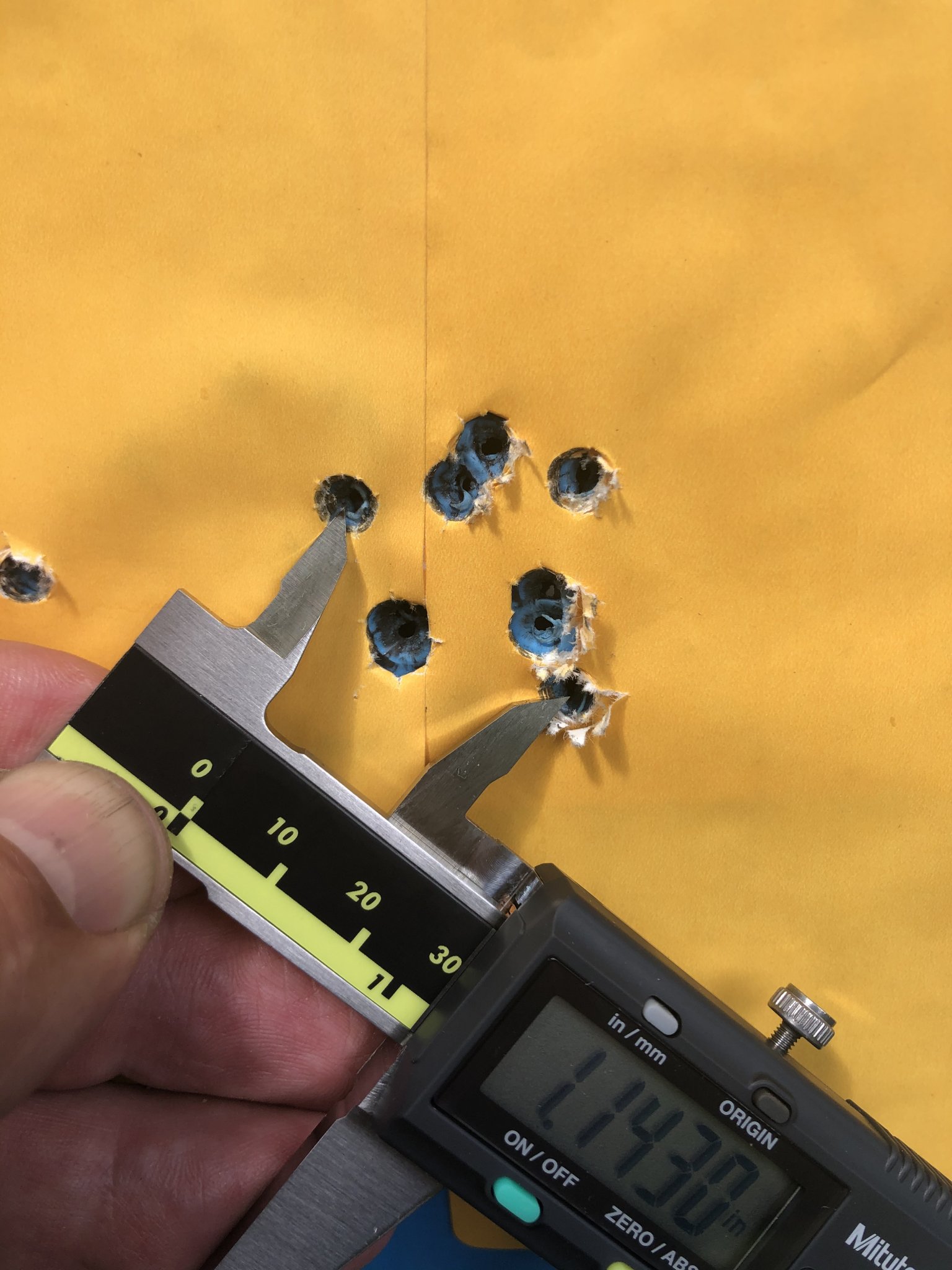

Finally took the new 6ARC AR out to shoot some 5 shoot groups at 100 yards with different loads. Was going to take the PPC but it was too windy so took the AR instead. I think it shot OK. Used Leverevolution from 29 to 30.3 grains and 80 grain Bart's with 0.005 jump. No pressure signs so might go higher next time.
Really nice shooting there.
Question: 80 grain Bart's - could you give us the details on this bullet???
thanks.
thanks.
Thanks. It's a boattail I usually shoot with my 6BR. I bought some 108 Bergers but the freeborn on this barrel seems too short for them so I loaded the 80s.

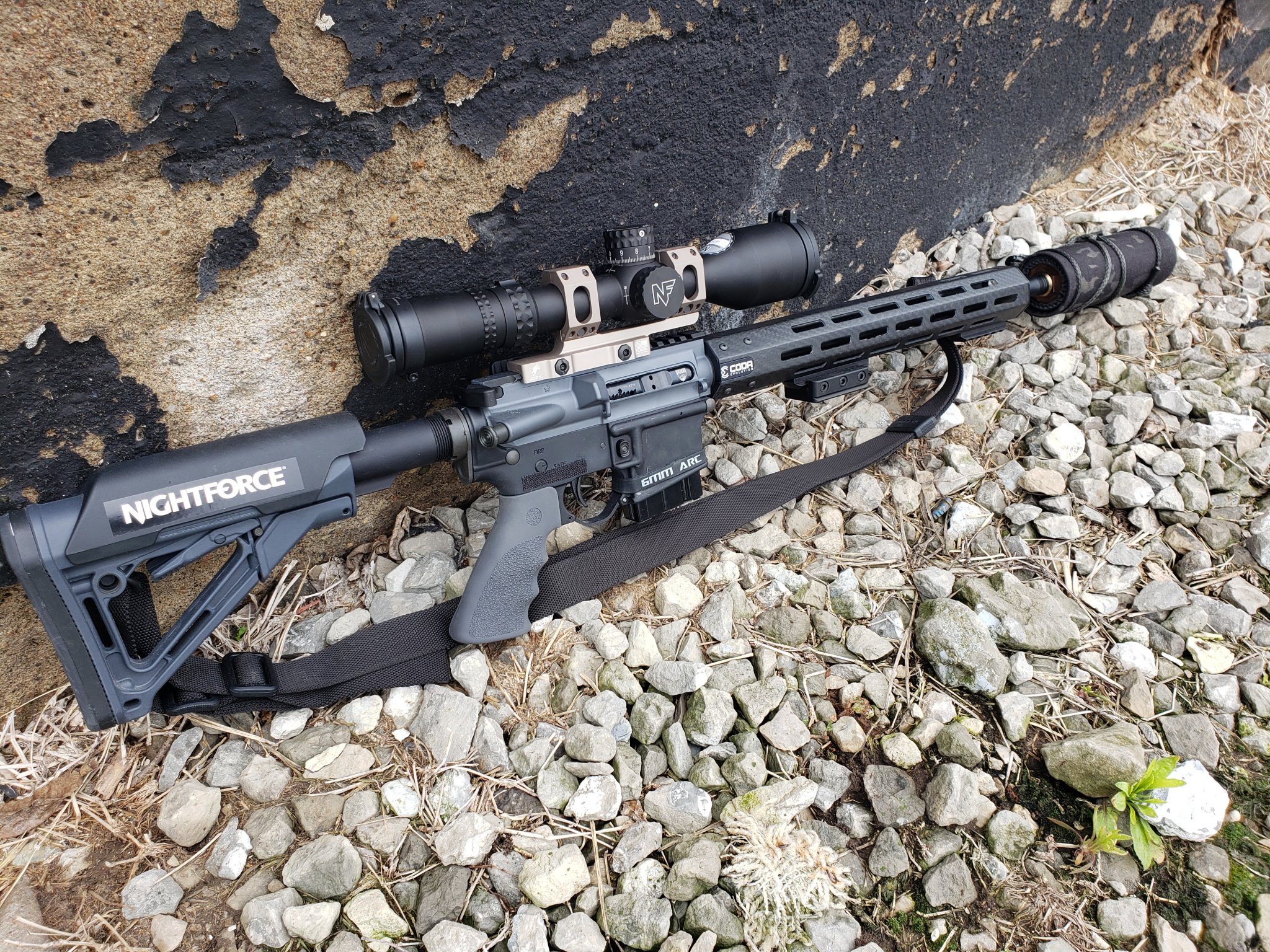

Paul Cradock is the Man, had to start off with that. finally after having this upper since last fall I got out and fired it today. Using factory Black ammo and spending the first ten rounds to zero and adjust the SLR gas block with the tranquilo, the following ten rounds proceeded to print a nice 1.14 group at 100m. I am not one of yawl's amazing shooters and this is the first 20 rnds. thru this barrel, I am stoked.
for you tech folks
Bartlien 5R 20
craddock upper
Aero lower
Larue MB2 trigger and Tranquilo sup
JP silent spring
