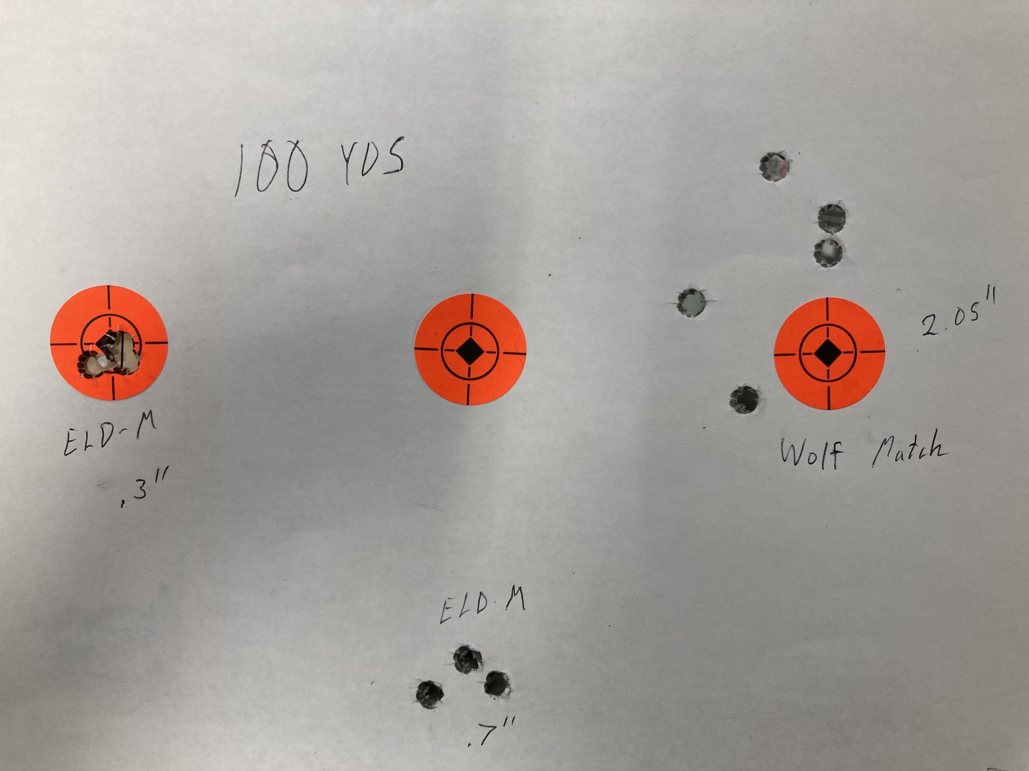

Not a 6ARC, but my 12.5" 6.5G shoots impressively with ELD-M's.

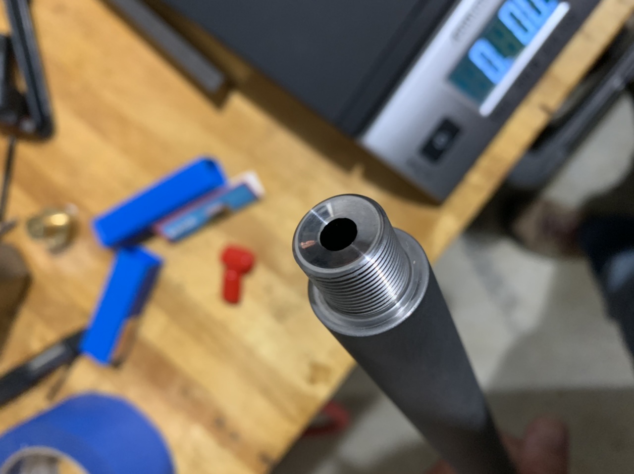

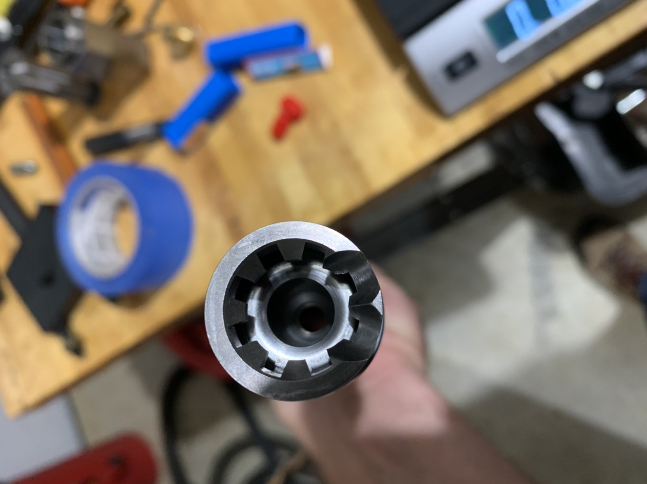

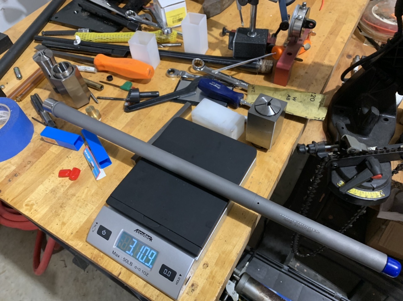

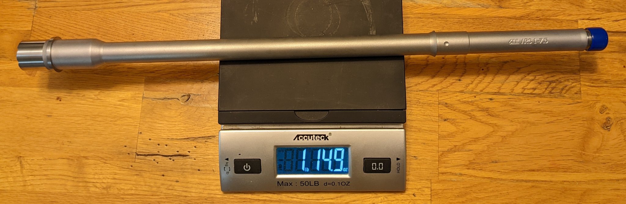

Finally wound up taking this advice and ordering an 18", RLGS lightweight profile barrel from X-Caliber during their Memorial day sale. Hopefully it comes in time to get a couple loads worked up for deer season.
Came in about 6 weeks, fit and finish looks excellent for the price, if it shoots I think it will make a good little general purpose/deer whomping carbine. I'm in the middle of setting up another rifle right now so I'll probably build the upper next month and see what it likes from the 6mm hunting bullets I have around (95gr SST, 85gr SGK, 108gr eld, and 100gr TGK on the way).

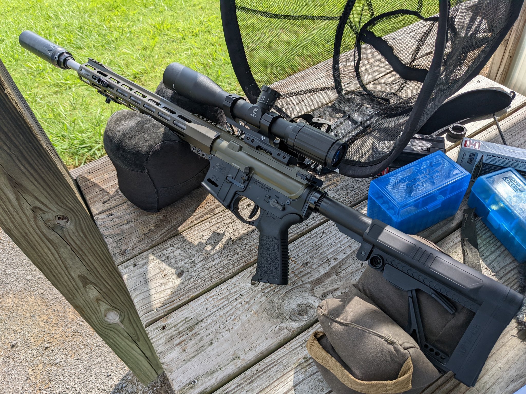

22” Rainier UM 7T. Just got back from the range. It was 96 degrees & heat index over 100 so I was a little worried about the Lever. Especially since I was trying to find upper end loads. Using Lever the SD’s don’t seam to get happy till the top end.
No issues with brass at all.

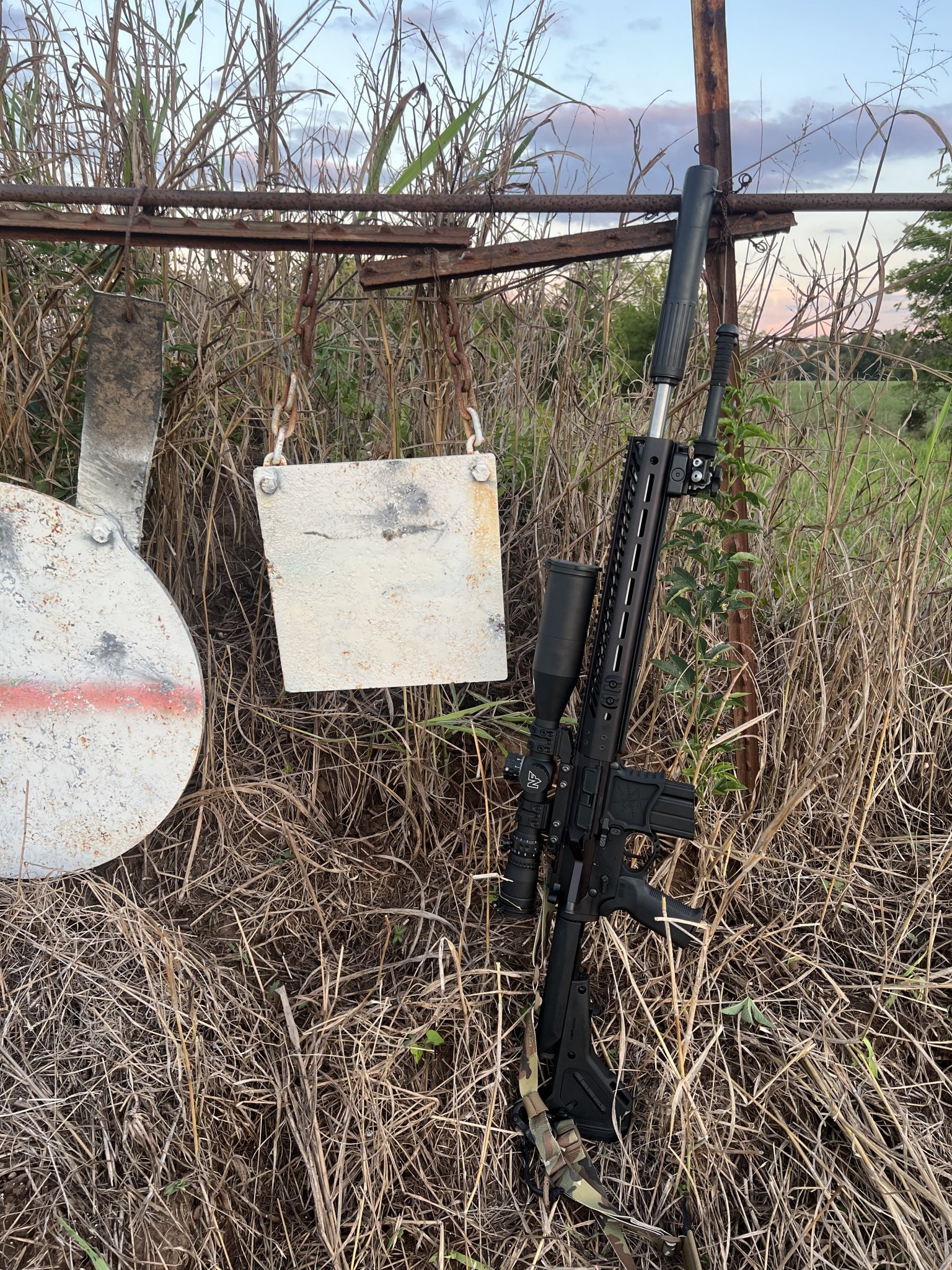

Finally played with my 18” proof SS, Seekins Irmt-3 build a little bit.
Ram some factory Hornady 108 and 105 to zero and tune. About 2650fps avg on both loads and 1/2-3/4” groups right off the bat.
I started load testing with cfe223 and 108 eld seated to the same depth as factory. I ran up to 30gr just to see what it looked like. No obvious pressure signs on the brass but I don’t think I’ll load past about 29.3 as that gave me about 2650 fps like the factory ammo.
Loaded more at 28.3 because the pressure ladder stacked 28-28.6 in the same poi. 28.3 is a 2540avg but it bugholes more often than not. First round always seems to go low for so I’ll have to experiment on that. I’m going to load up more to run for the first 200rds or so and revisit load development later. Maybe I should grab a bottle of lvr to test.
Like others have said a 18” with a RL +1 needs the gas block almost all the way open. I put an slr on it because I had one in the parts box. Need to do further tuning to see if I can find a happy place where it runs with a brake or 762sd. Tubb spring and im using a a5h0 unsuppressed and a5h2 suppressed for now. It doesn’t move at all with a A419 match brake.
750 yds, calm, sent one right over the top of the 12x12 plate but the other 4 are right there. About 50rds on the barrel so I think there’s definitely potential here.
Amp annealed and resized 1x hdy 6.5 grendel brass, trimmed, chamfered and run over a mandrel
108 eldm seated to factory ammo oal
#41 primer 28.3 cfe223
18” proof SS, slr adjustable gas block
Seekins receivers, Irmt-3 upper and rail
TT Diamond
Tubb spring and a5h0 buffer
Seems to run ok suppressed or with a 419 brake. Gas block is completely open and leaking a bit so I’m probably going to swap to a fixed block and as it breaks in further I may end up at a a5h1 buffer.

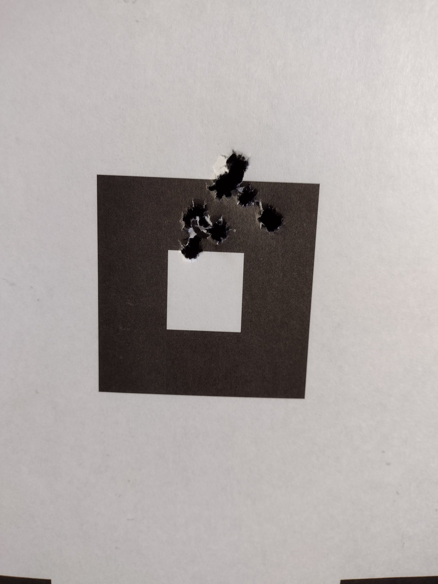

It would seem that my hand wringing over throat length was unjustified, and now that I've shot this X-Caliber barrel some, I think it's going to be a winner. Factory 108gr are right at the lands, and 105gr is a little bit into the lands, but not enough to cause problems.
It likes the 108gr factory and I've worked up a 100gr TGK load with little effort. I had a spread of 108gr loads ready today and managed to fumble and tip over the box spilling most of them.... Like a moron. Still I had two of each load ( 28.8, 29.1, 29.3, 29.5) I was sure about, and it looks like 29.3 - 29.5 will be the area to focus on next time.

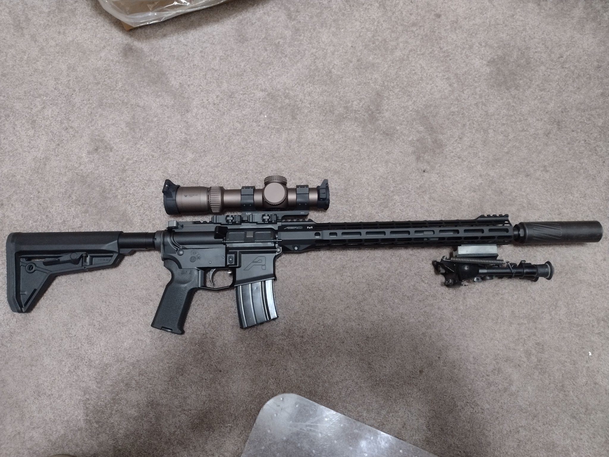

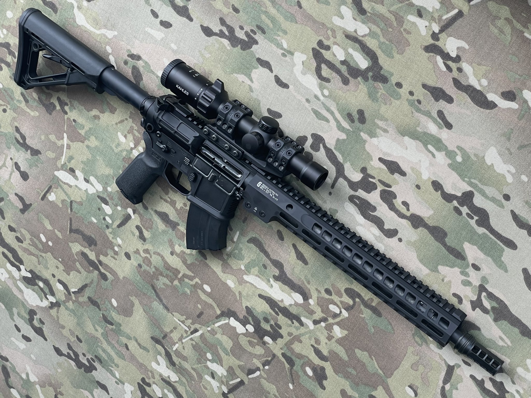

Put together a lightweight upper with a 16" Faxon match series barrel, just for a truck gun and blasting coyotes. Appears to be the best shooting Faxon barrel I've had so far. 10x 108s at 100. 1.09" center to center.
Adjustable gas necessary with the midlength tube and a can.
That’s pretty impressive for a Faxon. I’d kind of written them off With regards to precision. Assuming it’s got their std Nitrite treatment, it should have great barrel life.
Yeah me too. Almost every one Ive seen had the throat off-center from the bore, caused by an undersized bore bushing on the reamer and chasing production speed too far. That alone is pretty bad for accuracy.

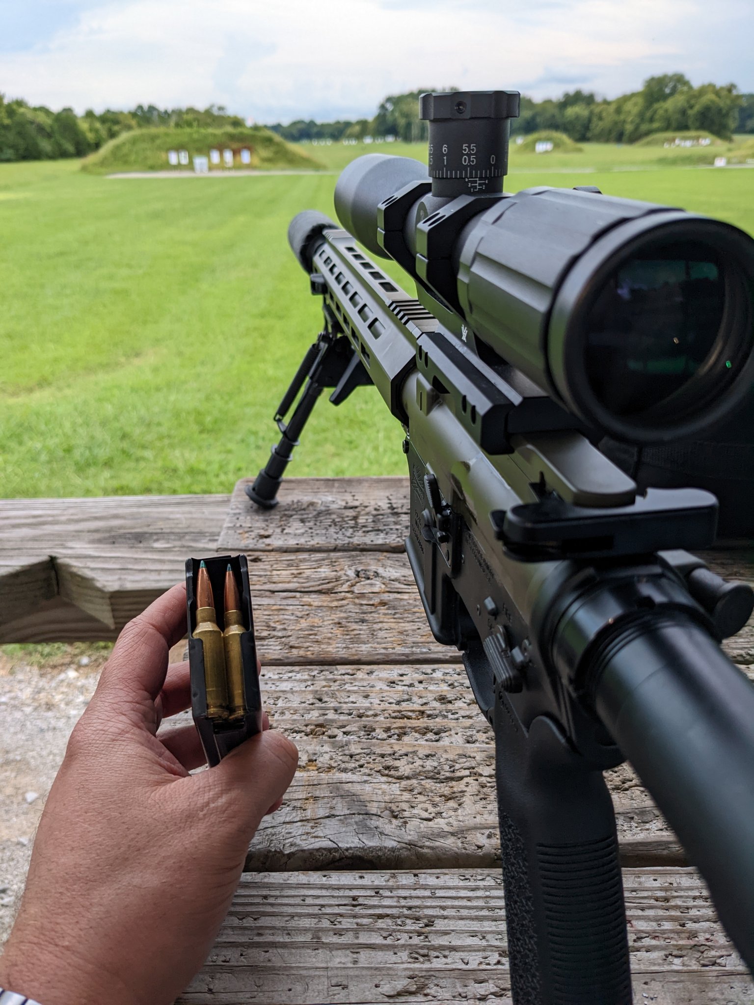

I'll add another data point for the group. I put the first rounds downrange last night with a new rifle. Barrel is a Compass Lake Engineering 22" 7.5 twist from a Criterion blank, +1 rifle length gas. 24 rounds total. A quick 3 shot group of Hornady Black 105 bthp factory ammo yielded a .42" group at 100 yards. The next groups were 5 shot groups with Hornady 108 ELDM factory ammo.... First was .86" and the next was .66". Velocity of the 108s averaged 2702 and the 105s were just under 2700 fps. Chrono is a Labradar and all groups were shot suppressed. So far it looks very promising for accuracy.

It's a varmint profile and 0.875" at the gas block. I'm just over 600 rounds now and accuracy with 105 and 108 factory ammo is consistently 1/2" 5 shot groups at 100. The little load development I've done with Lever and 107 SMKs shot around 0.6" and single digit SD. I'm pretty pleased with the barrel.
