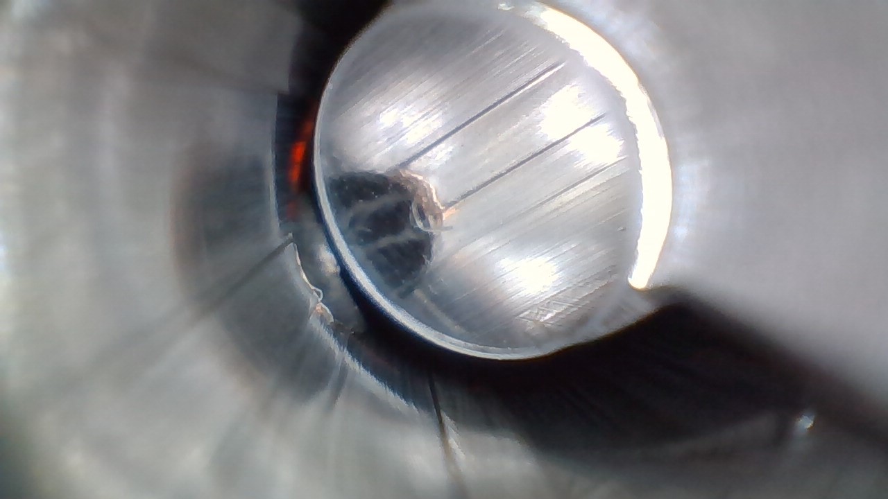

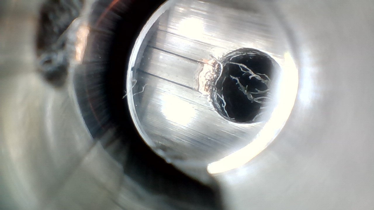

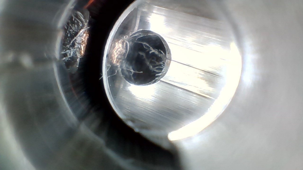

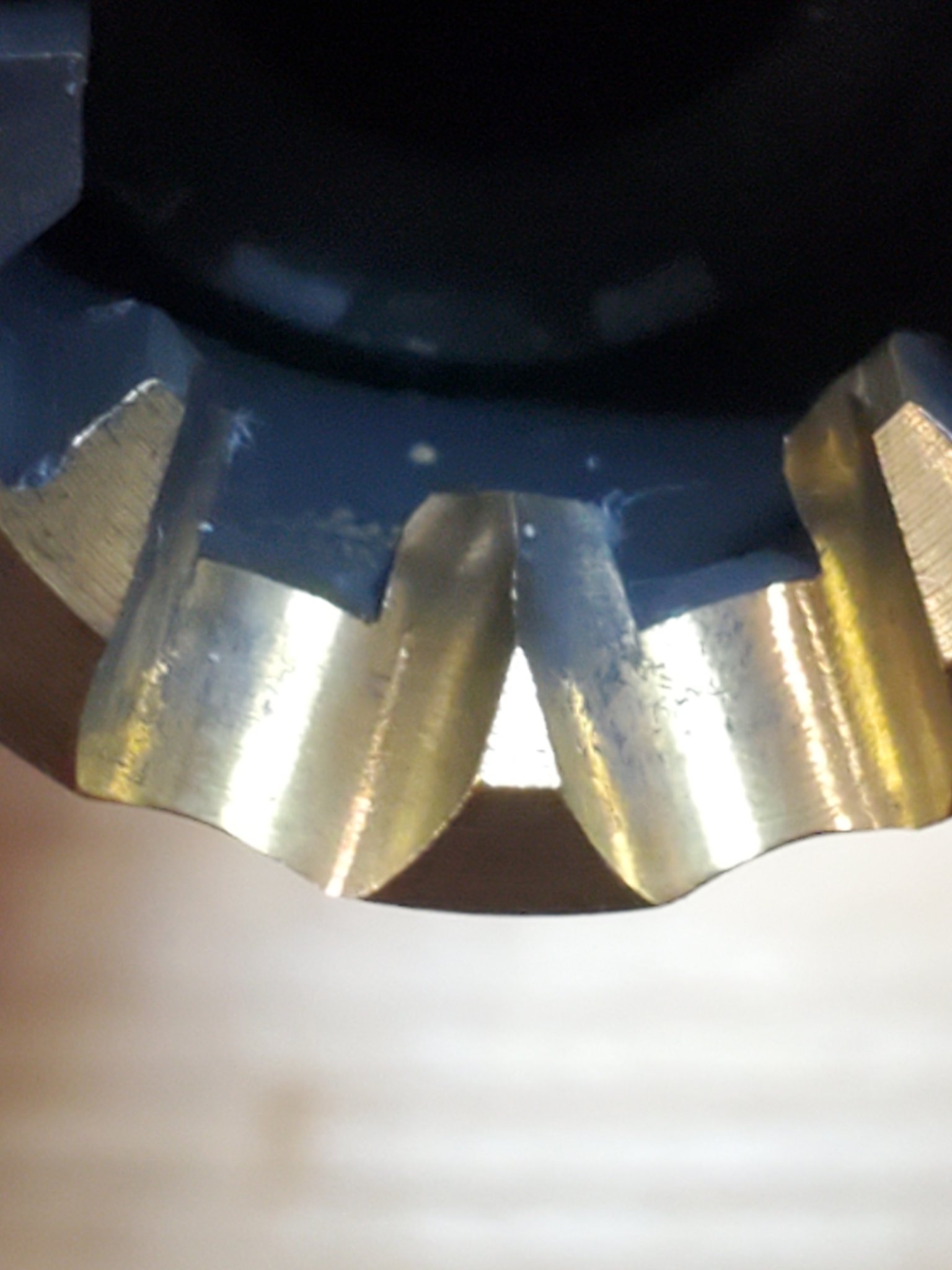

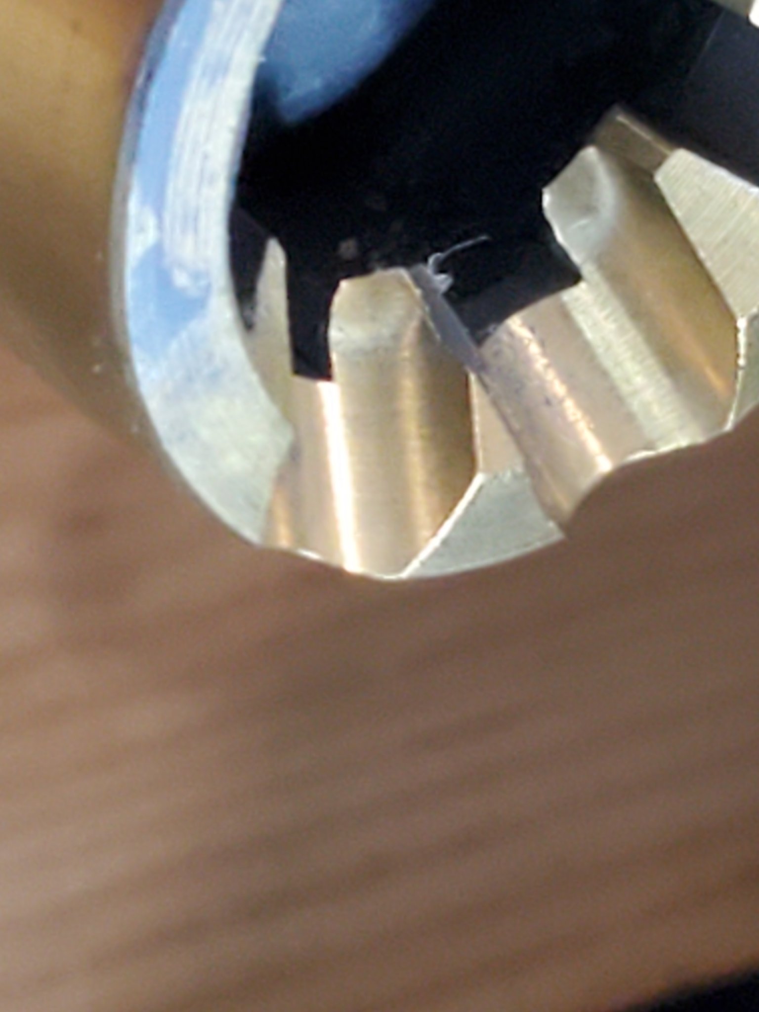

My 1 x fired brass shoulder datum has grown .003" in 90 rounds on this replacement Rainier UM.
Going to pull it now so I don't trash another bolt (JP). Pisses me off since they (Rainier didn't do shit to correct the issue). Also this monolithic is a total PITA to install a barrel in with ss shim stock.
That's interesting, just to clarify, was the criterion that had extension lug setback the .224 Valk that kaboomed, or are you referring to two different rifles in that post.
How are folks monitoring for extension lug setback, using a no-go gauge every now and then or are there other indicators to watch for before the kaboom?

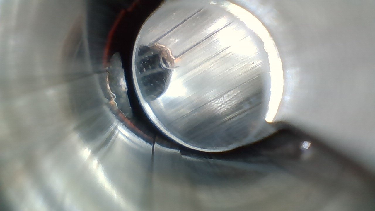

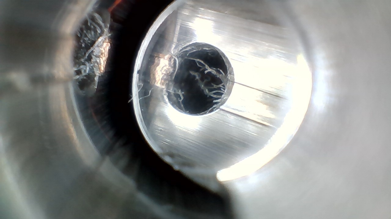

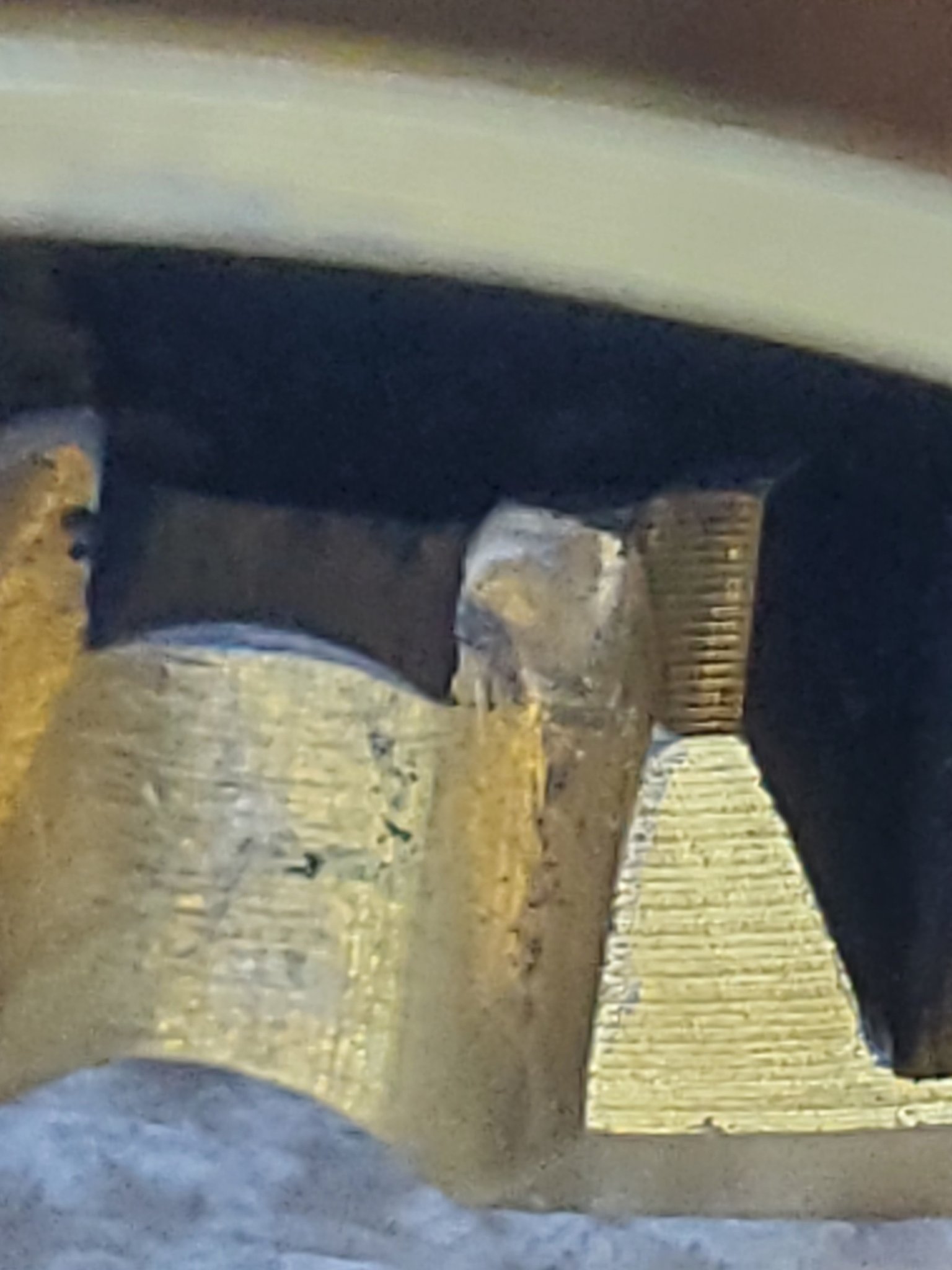

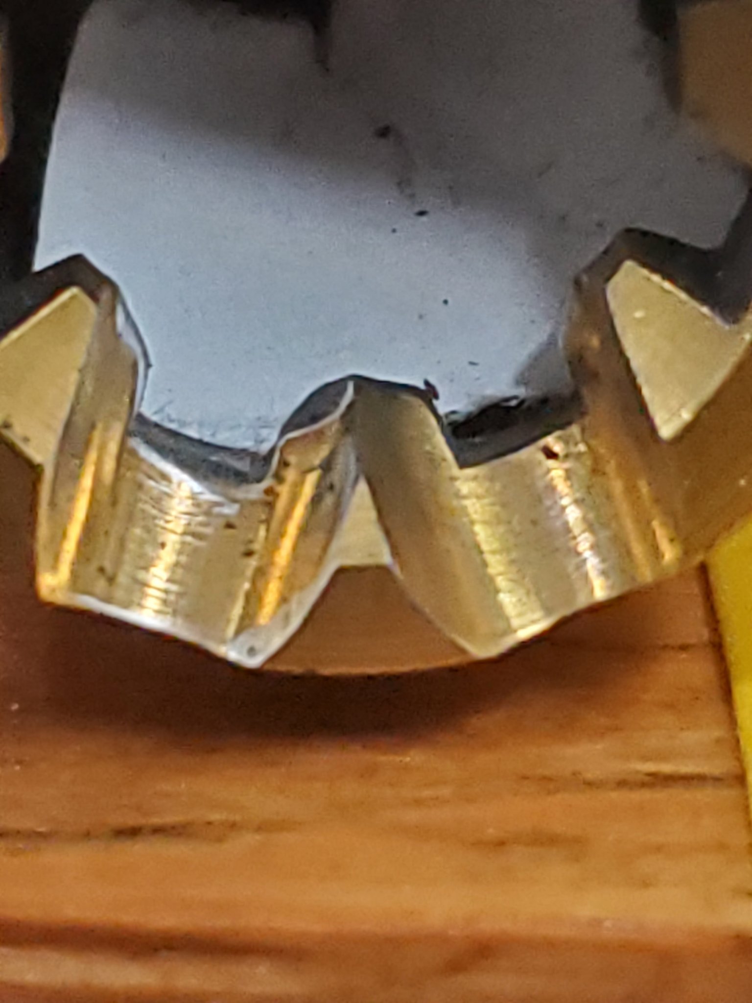

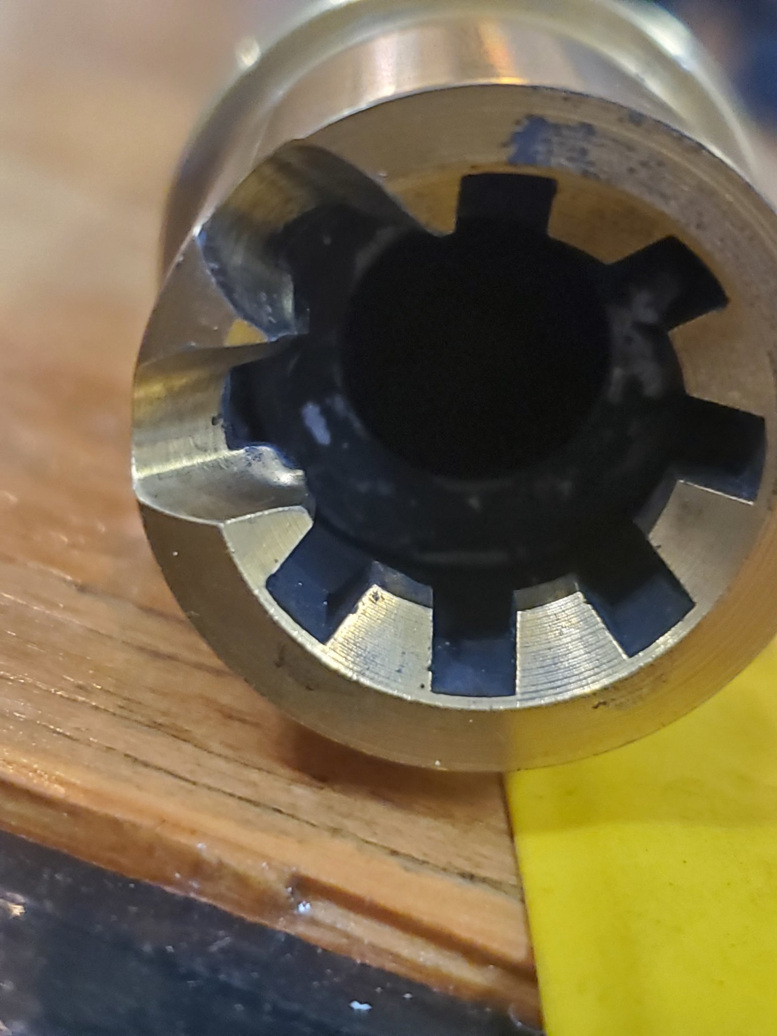

I actually noticed mine with my eye balls. On the second barrel I pulled it to check for the same problem after 15 rounds because they acted like the problem was with me and a one off problem. Had I been measuring my brass instead of sizing and shooting based on initial set up. I would have noticed sooner on the first barrel.
I have never seen a barrel extention in any other brand of barrel do this over about a dozen. BHW, criterion, cmmg, rra, woa, McGowan, model 1, spinta, ar stoner, some barrel I got off ebay before you couldn't sell them there anymore.

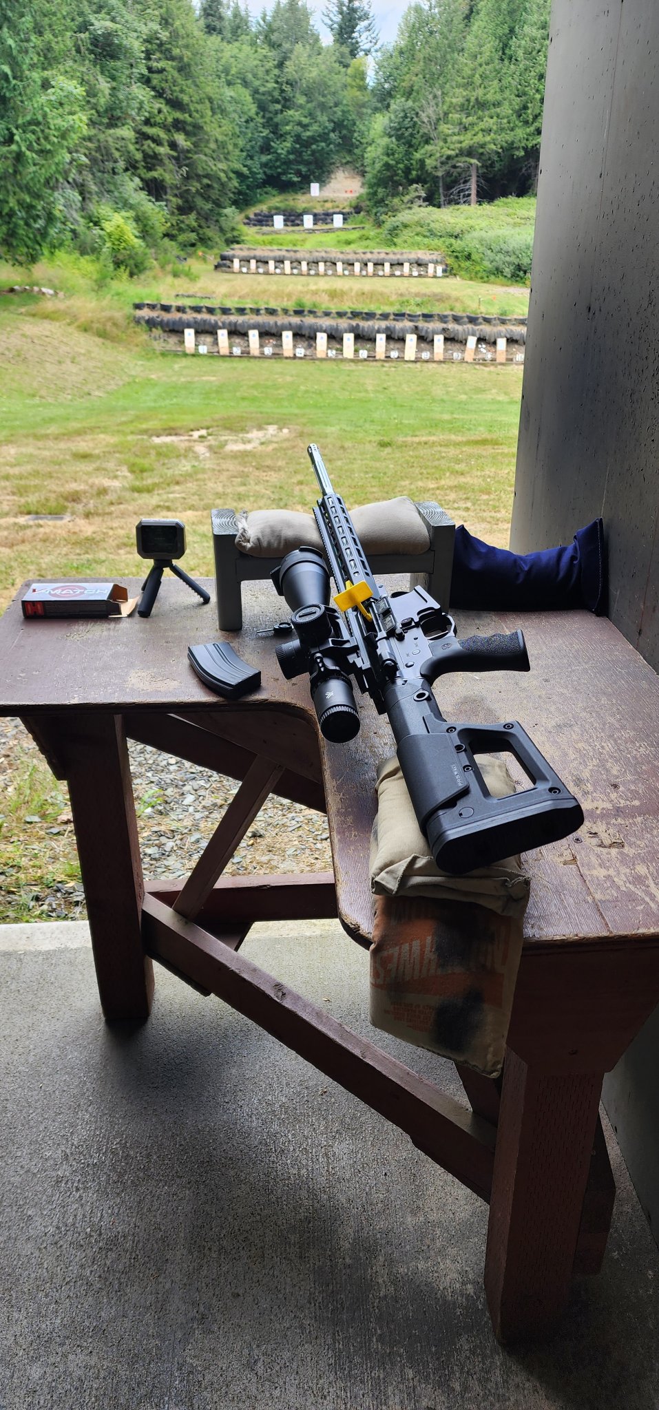

Just put this thing together today and made some ammo
Ran her ....Damn am I impressed !!
I bought a 24" 6 ARC Barrel at EABCO $250.00 1-7.5 Twist
bought a 6.5 bolt from them as well ..
Dropped it into a DMR I've had collecting dust ..
Dropped my new old stock AAC SDN 6 can on her ...
probably gonna leave it on her .
Used the Primary Arms DMR 3-10 scope at first then tore it
off and dropped the Arken SHJ4 to work the load better and see
what I'm doing at 100 yds.
I have a ton of AA2230 powder so I was hopeful I could start a load
from that ...I ordered 600 Hornady 87 GR Vmax as this is a Coyote rig.
800 new Starline brass from Midway .

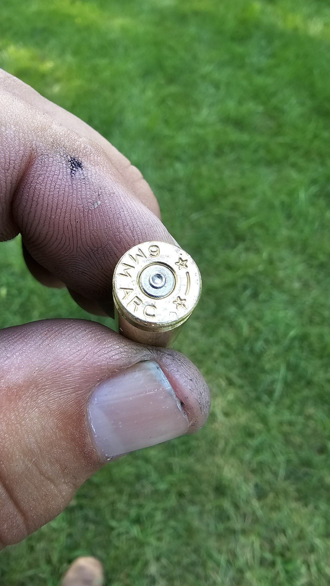

First load was 30 GR of AA2230 with 87 gr Vmax ...made 5 seated @
2.260" Fed SR match primers..
RCBS SB dies .
I put a new Superlative Arms GB on it turned her 18 clicks ccw
then came back 6...would you believe it was perfect ? cycled
and tossed em at 3 o clock ..
first 2 rounds 3100 fps ....whoa !! that's hot !
Reactions: rpoL98 and padom
Cratering was noted until I backed down to 27 Gr AA2230 with the 87 GR Hornady V Max...
I had an average sd of 20 with starline brass..
2800 FPS is average ....she is grouping ...I like ....great performance with only 27 GR of powder !
Now that's efficient ! and pretty bad ass...
cycling 100% no issues ...dropping brass on top of eachother at 3 o clock

There 's not much data out there for this cartridge with regards to us Varmint hunters
so we will have to pioneer, I see loads sold by others are pretty slow in this configuration ..
example ...https://coppercreekcartridgeco.com/product/6arc-87vmax/
I can push this thing to 2900 fps and stay safe ...

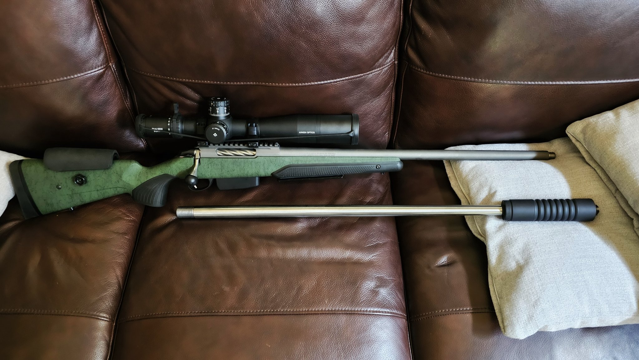

Ill show you what fun is ! My Tikka Super Varmint is getting a transformer job !

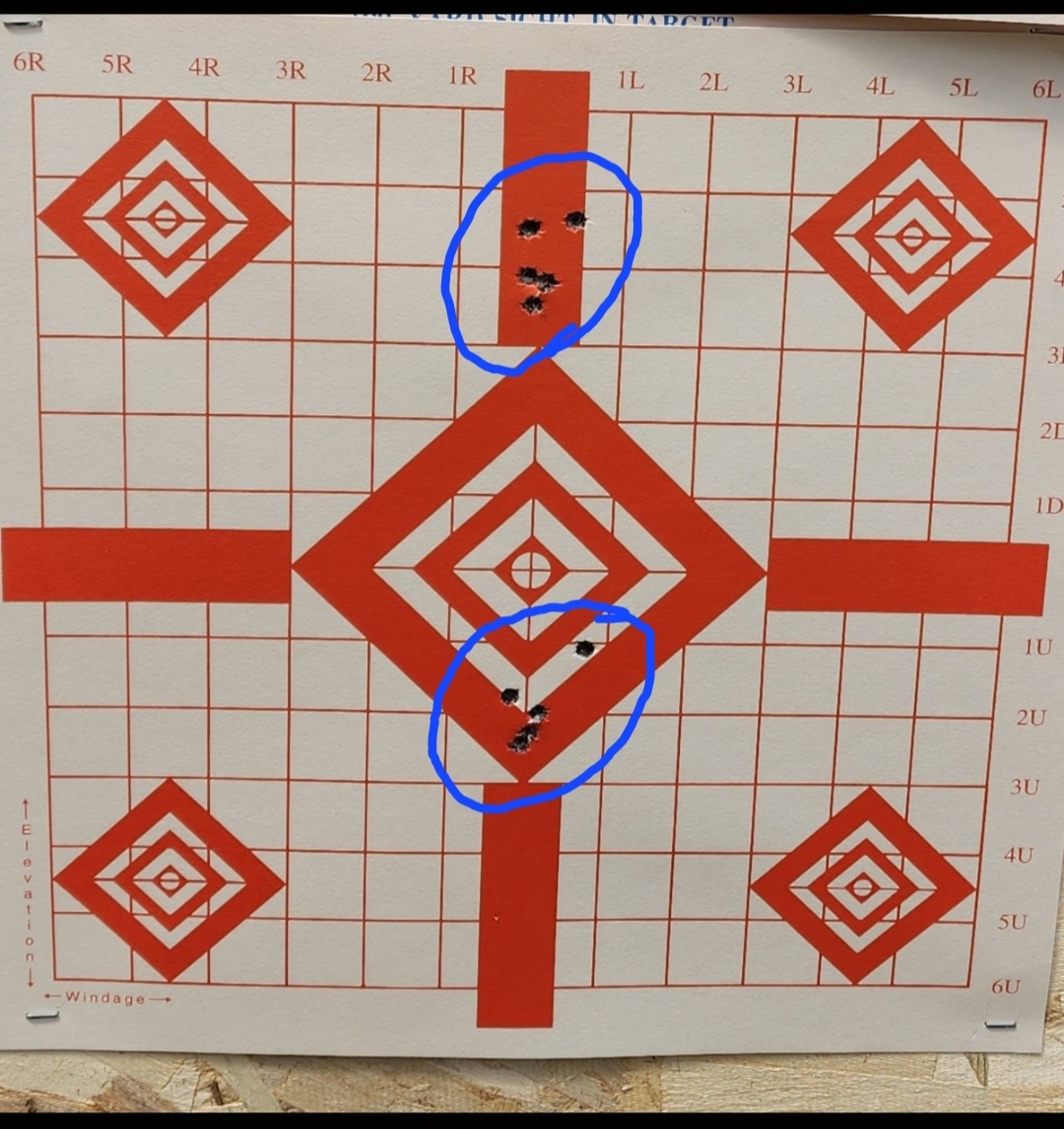

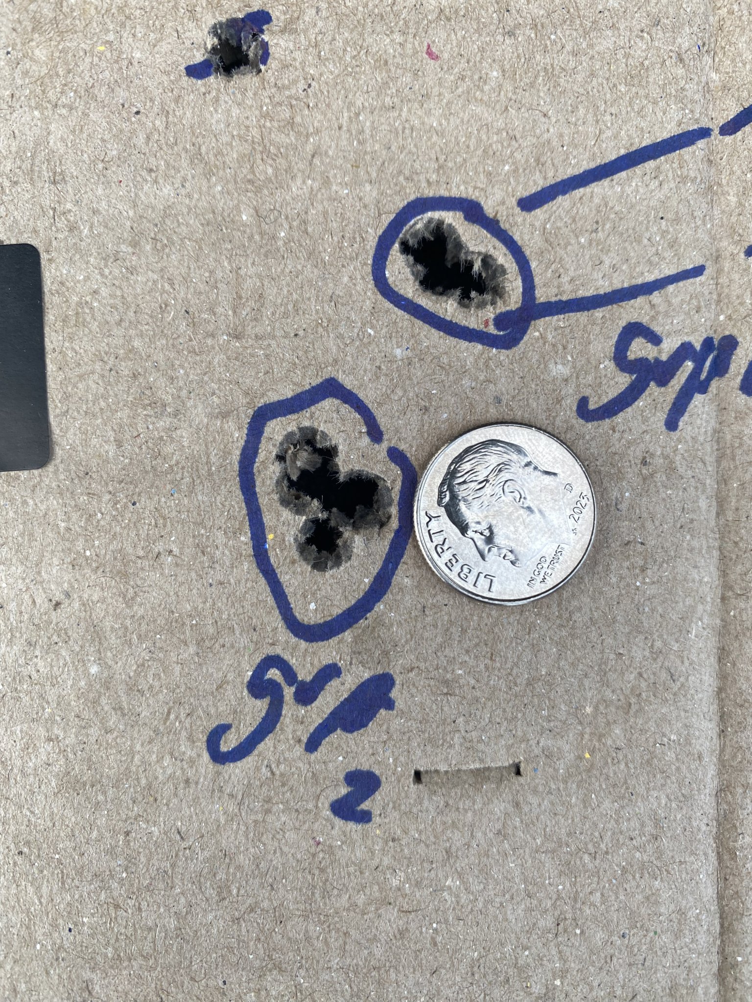

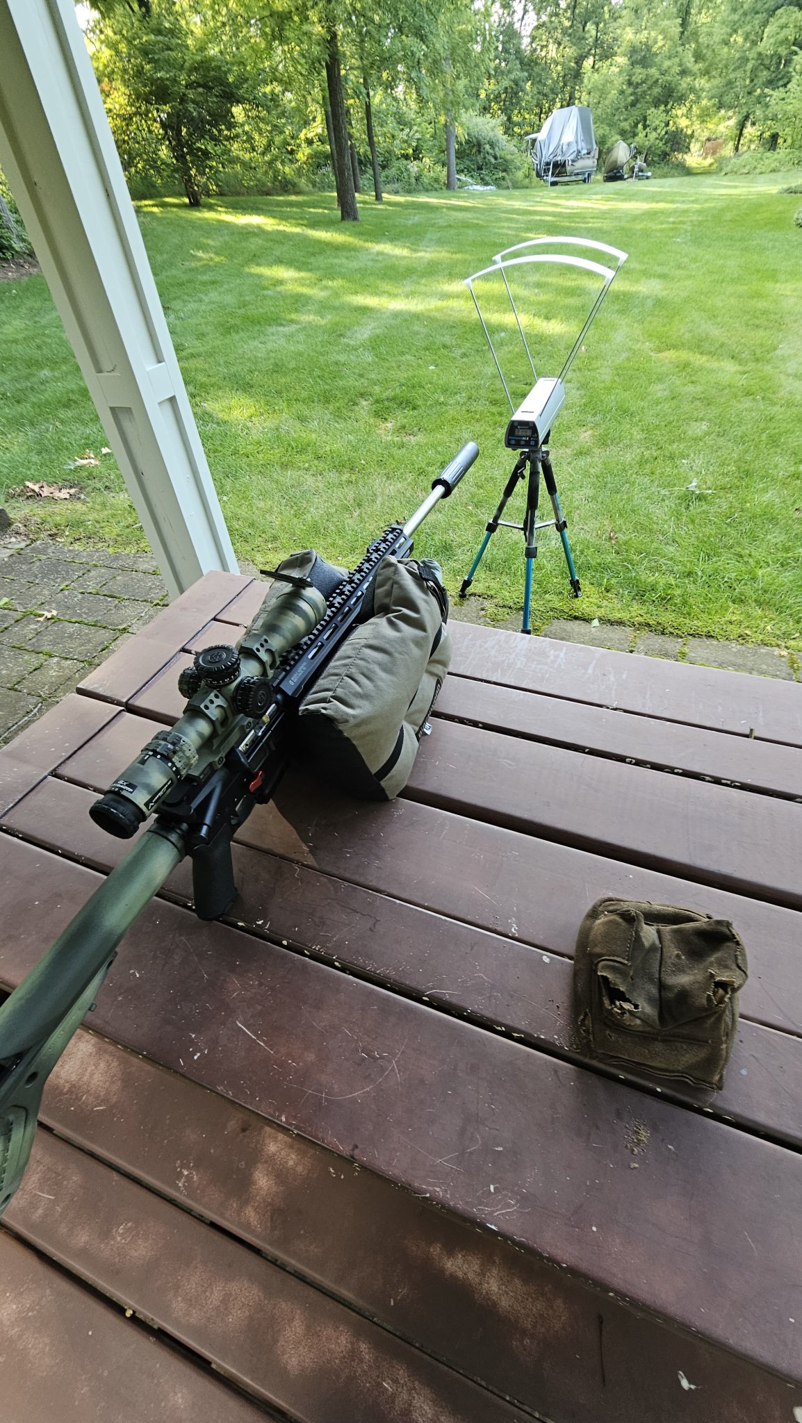

After initially looking really good everything went to shit. After a couple range trips I was thinking bad bullets. Did I mess something up with thermal fit. Then it occurred to me all the promise disappeared when my new gas block was installed. So after a little filing on my handguard. I went out to confirm zero with 95g midway blems smk or nosler maybe clocking 2800fps form a barrel with 110 rounds down it. I only had 40 left so I load 10 90 tgk also midway blemished over the charge of mp501 and shot the second group. I had 5 more but i want to chrongraph them.
18" Proof sped up a bit, decided to chrono after my handloads were a little faster than expected. May order more 103's but don't love that SD...
Factory 103 ELDX: 2699 fps (29 SD)
Factory 108 ELDM: 2627 fps (11 SD)
Handload 75 VMAX: 3008 fps (8.6 SD)
Random reloading question: the 75's have been consistently ~1 MOA and velocity is very consistent but today I had a flier that opened things up to 1.7" (rest of the group was 1.1 MOA).
Anything I should keep an eye on to cut down on fliers?

Whats your sample size to call a flier problem? If I shot 10 5 shot groups or 5 10 shot groups and caught fliers in every one that would be one thing.
Otherwise I'd keep on trucking
Probably have 20 rounds on paper and this was the first one for me. I guess what made me second guess is if that had been on a yote at 250y I may have missed.
Will carry on happy to get that one out of the system on paper

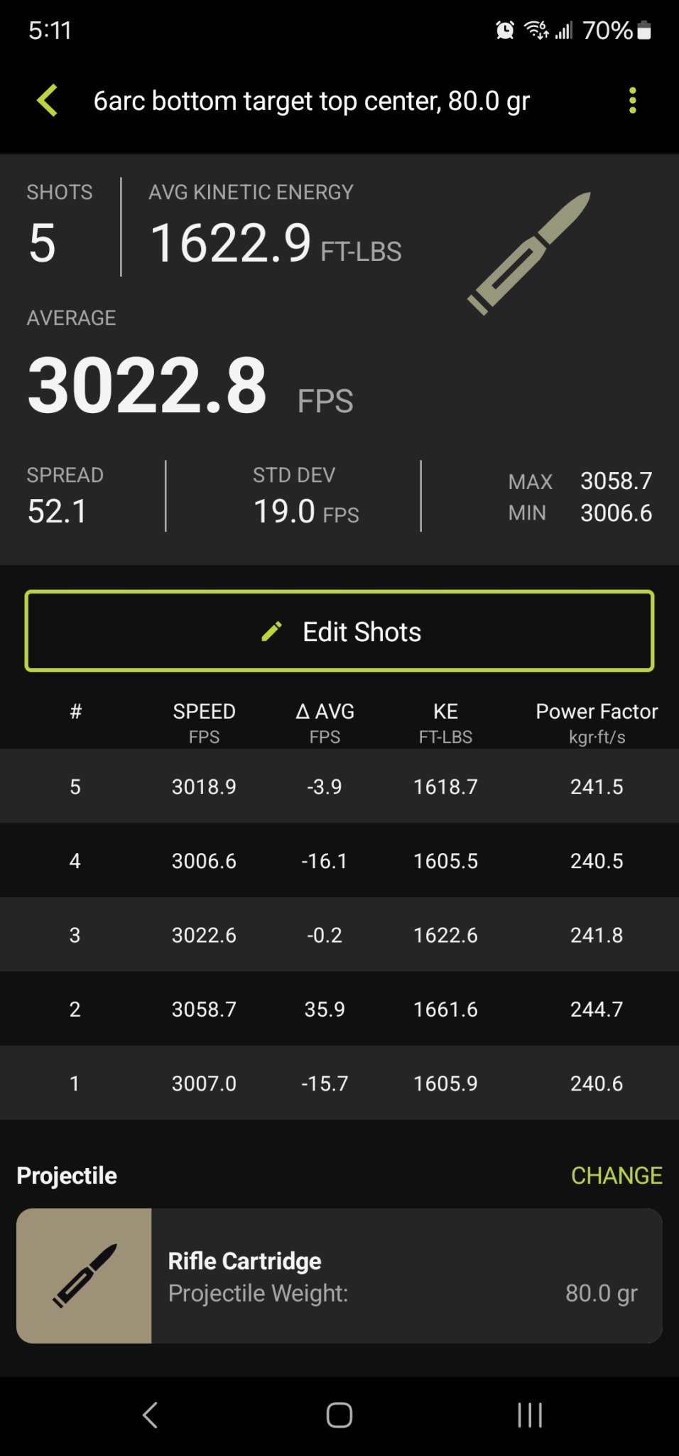

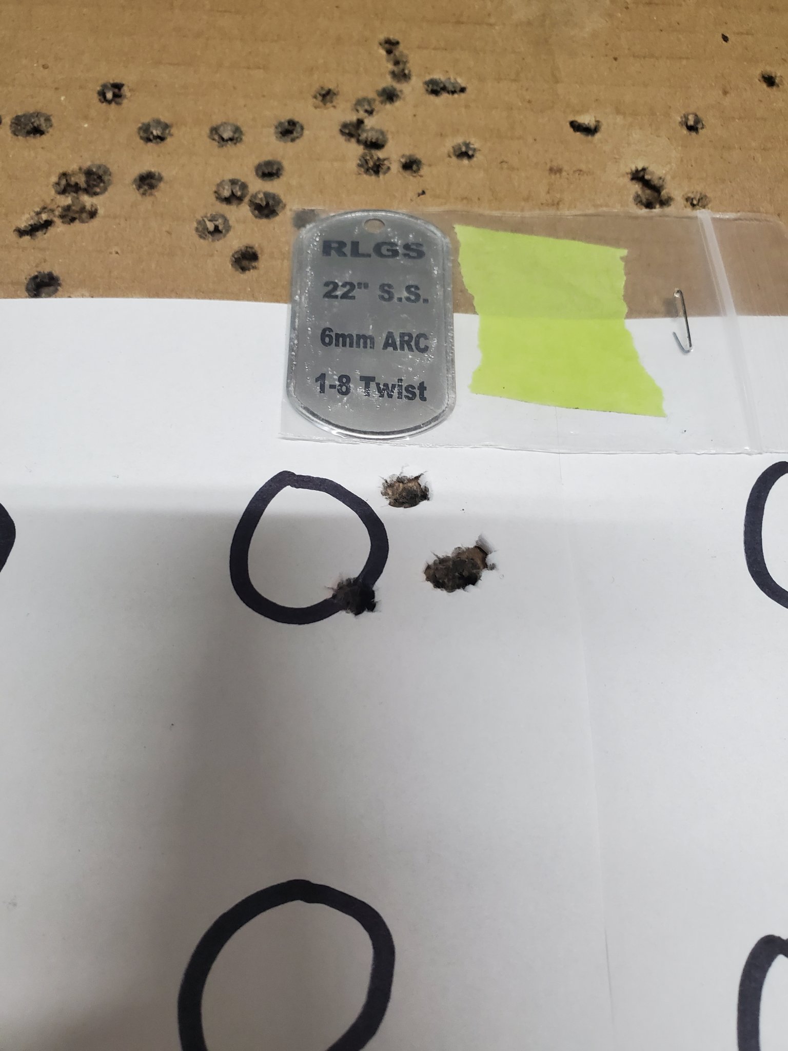

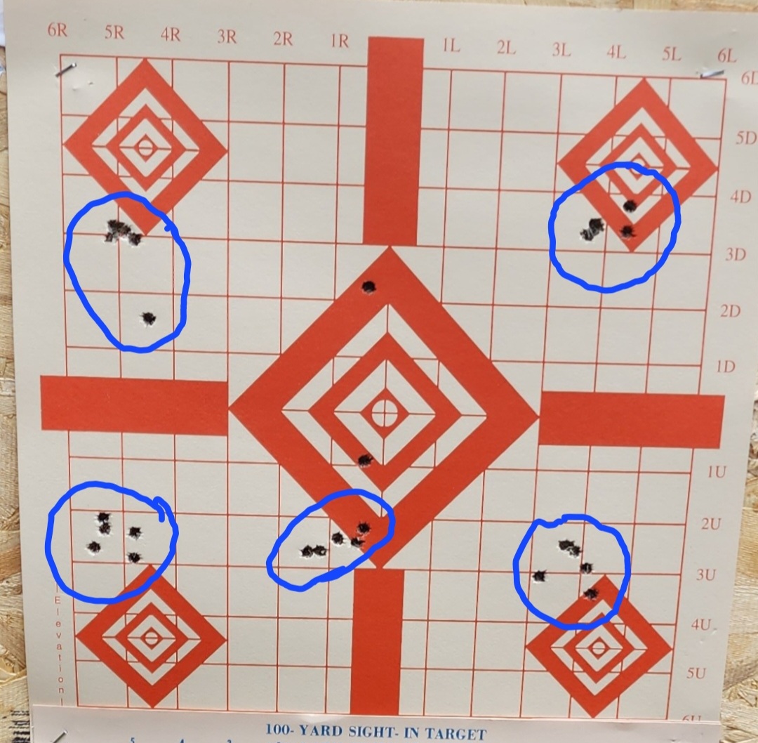

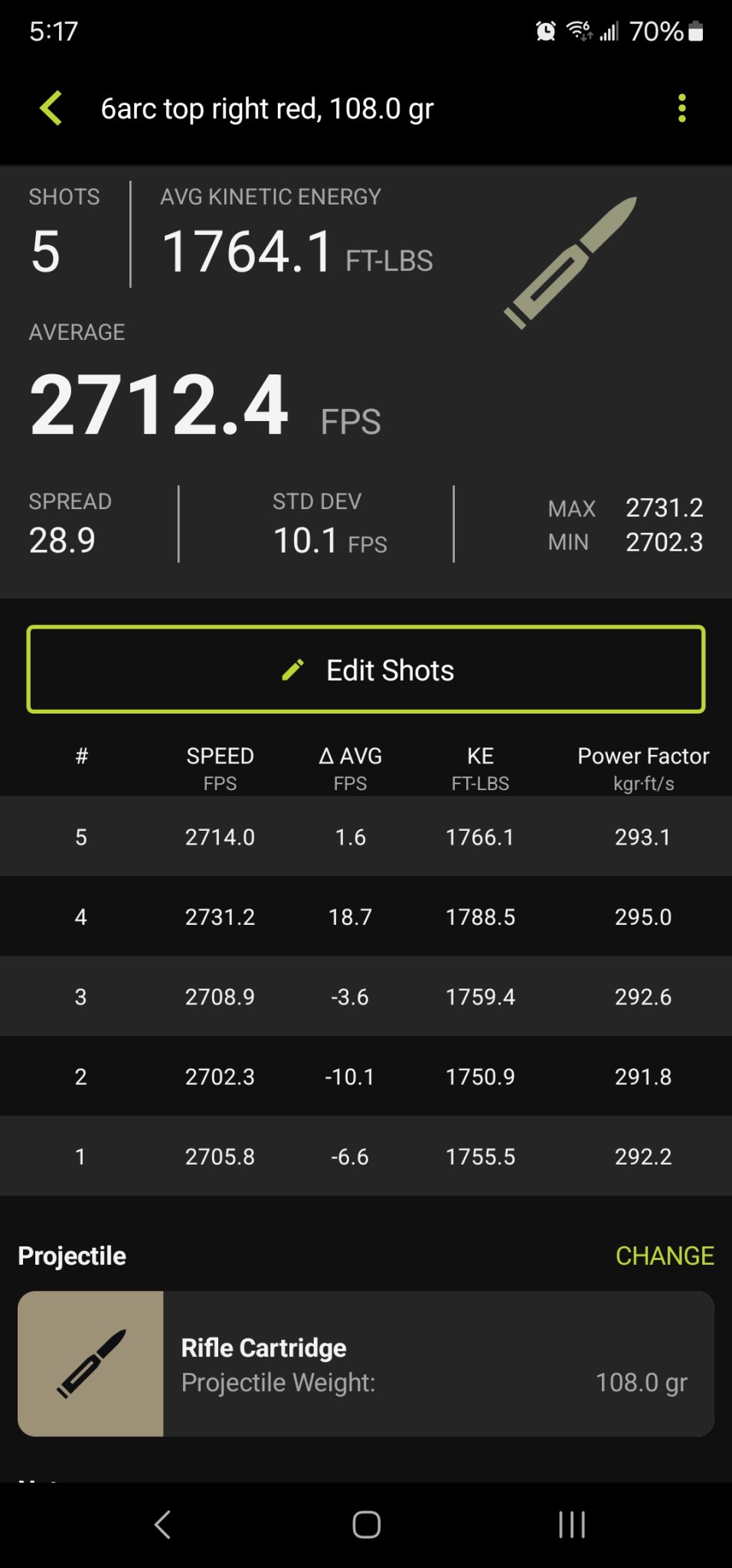

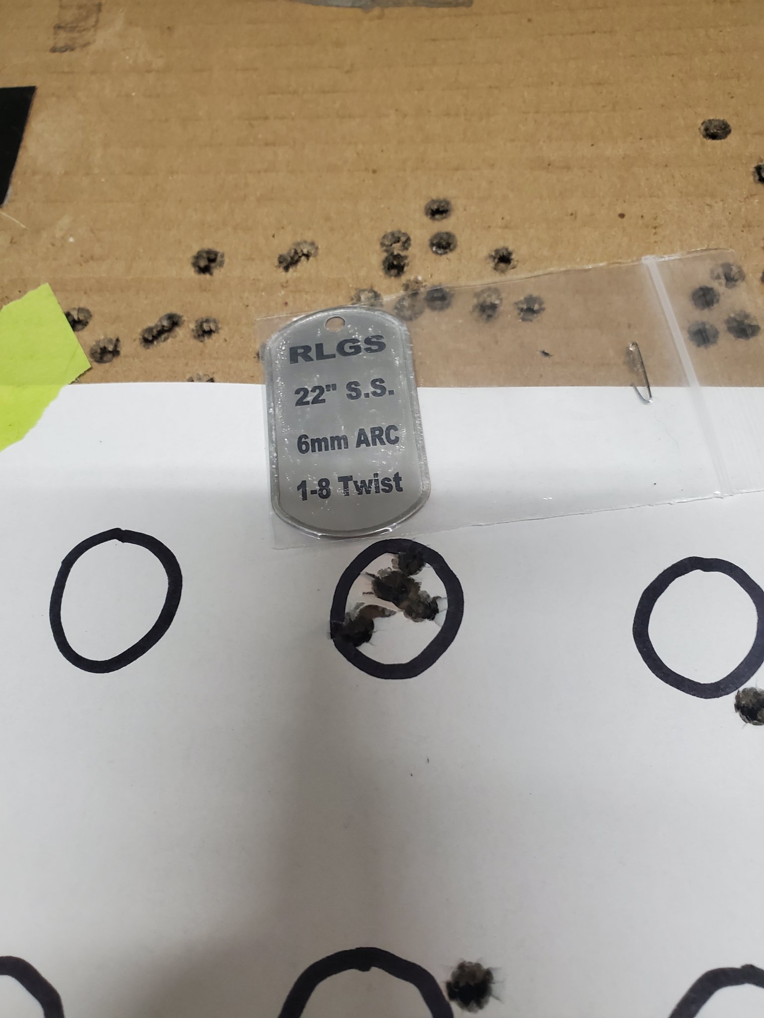

1st time trying for actual groups after breaking in the barrel and sighting the scope in. The gun is definitely not the weak link in these groups, I am. If I can get my act together the group at the top left small diamond could be the normal for this gun minus the flyer. But I was happy to see that the barrel seamed to like both the 108gr eld and the 80 eld-vt factory ammo. The velocities also matched what hornday had on the box's.
The barrel is a 24" xcaliber 7 twist.
These 5 groups were the factory 108's and a sample of the velocities.
These two were the 80's.

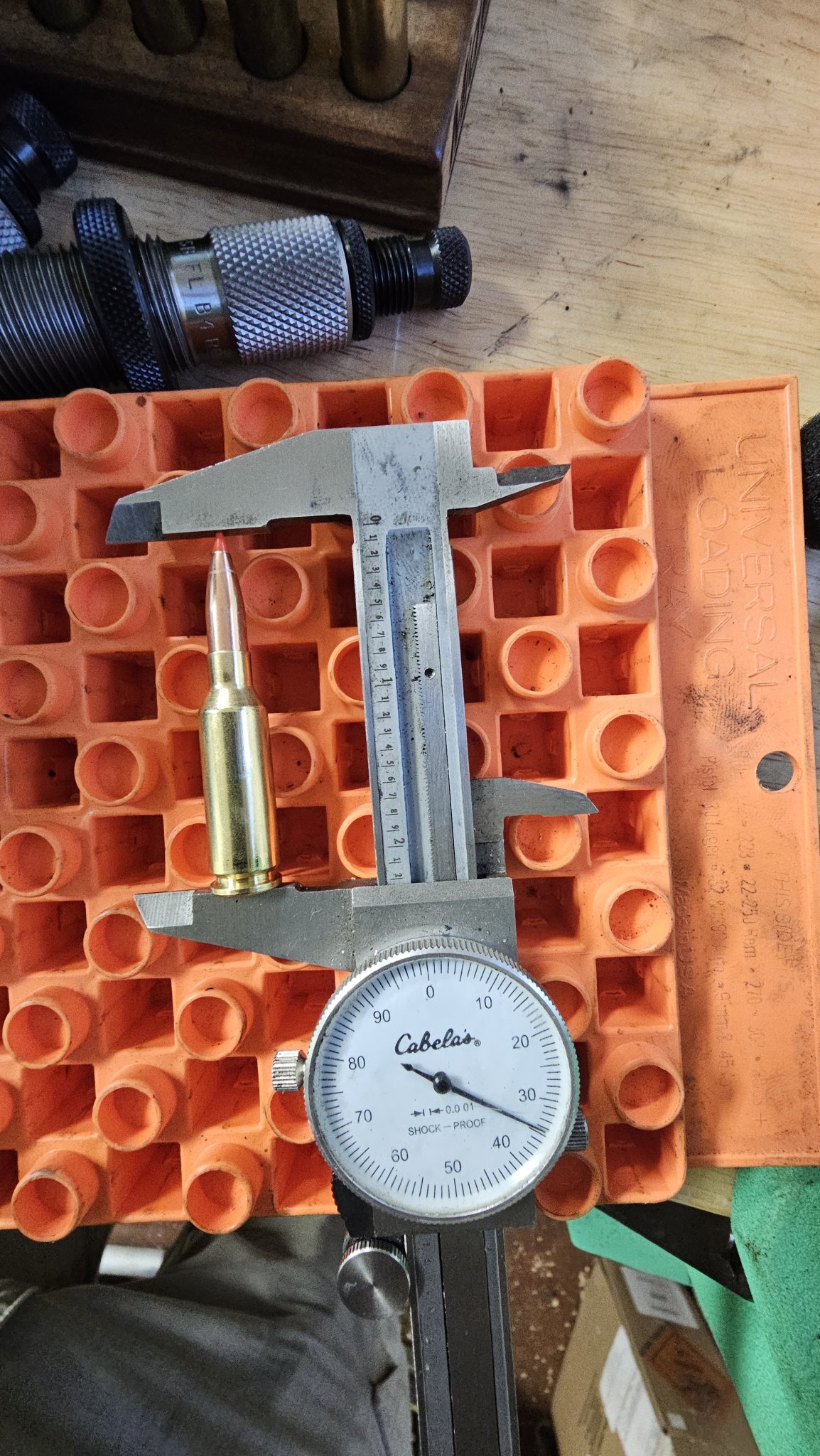

Does anyone have any load data for the 106gr polymer tip hornady ammo? got 300 of the factory seconds and wanted a good starting point. I am just gonna use my 108 data as a starting point with Varget otherwise.
Personally, I'd put them 20 thou off the lands and load up 5 each of 29.1, 29.3, and 29.5 gr of LVR. I've had several different bullets like a LVR charge in that range.

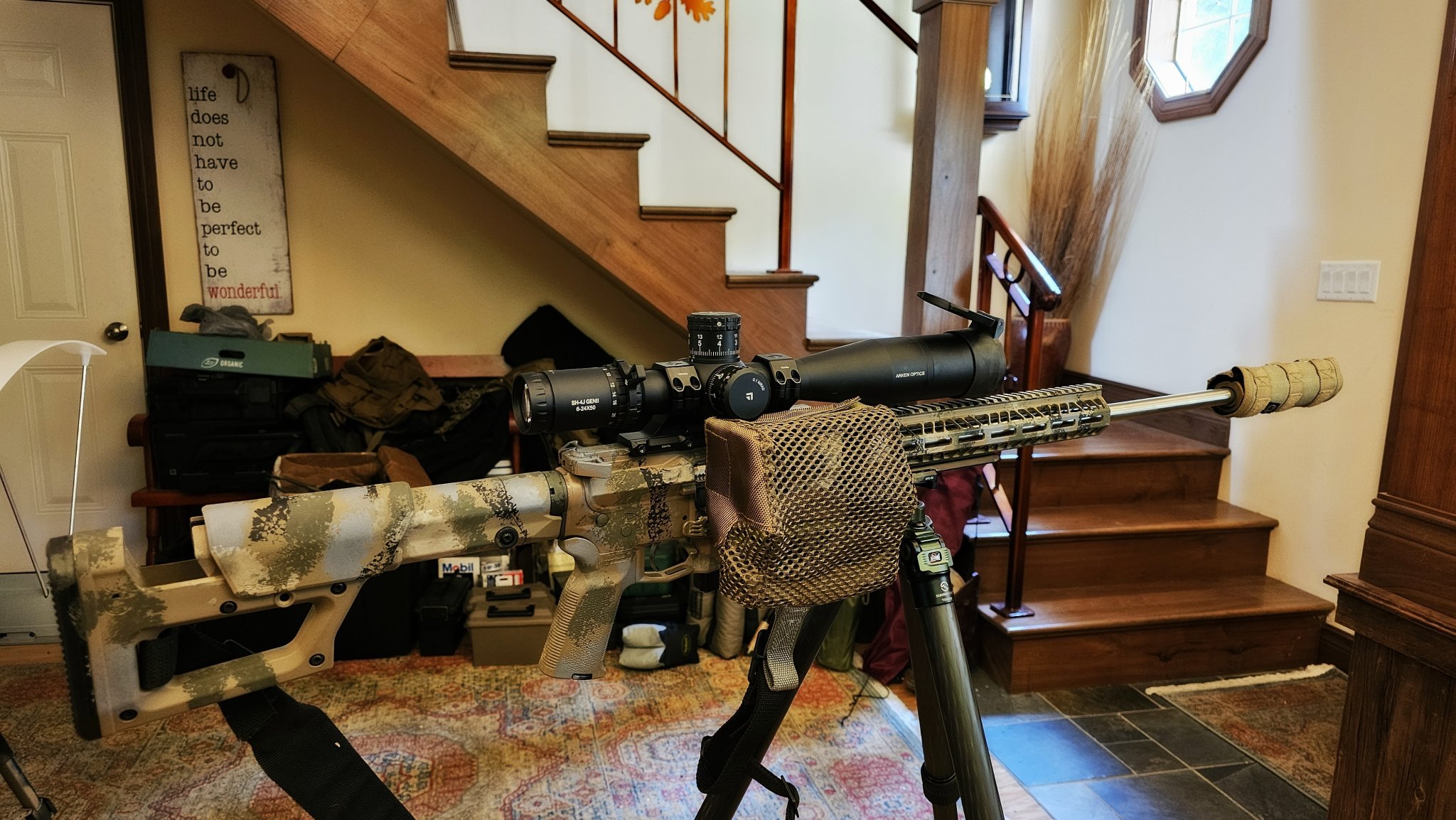

My 22" RTR, low profile SS gas block, Forster Ultra Micrometer seating die and Wilson SS FL Bushing sizing die showed up today. I can finally finish this build and load up some ammo to get some initial rounds down it!
Looks like Craddock is having a 13yr in business sale today on their in stock RTR barrels 13% off. Thinking hard about just ordering a 22 ARC barrel as well....

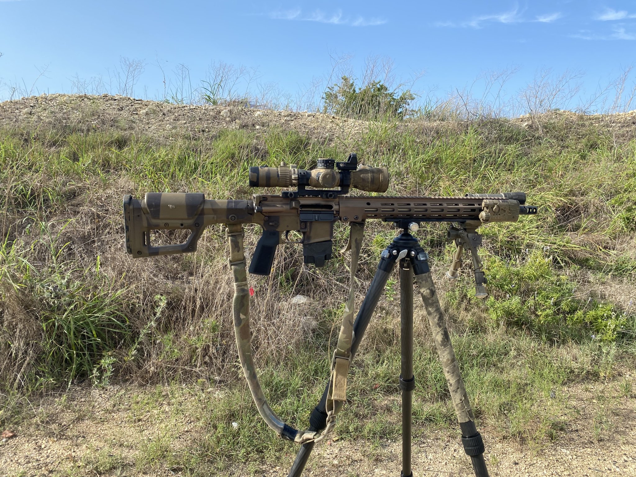

All put together. Just gotta swap out the stock and mount up some glass.
Now to decide what to load up first to break it in.
The Berger 95vlds surprised me. Easy to find a load for in 2 different barrels and speed was great from a 22”.
I was using Lever.
With 108 eld’s 29.2 - 29.5 = 2680 - 2720 with 205AR or Cci41.
I’ve had the best luck loaded 2.290ish.
Reactions: padom
Nice looking setup! There’s some good loads over in another 6ARC thread you’ve probably seen. A lot of my guns love VMAX. Some of the most accurate bullets I’ve shot. They’re often lighter for the load though. 60 gr in .223 and 57 gr in 6 ARC but incredibly accurate. A2230 in 6 ARC is 3500 fps from 18” 😳
Nice! I have a bunch of 75 and 87 vmax and 88 smk. That's what I built the gun to shoot. Looking for fast and accurate with these lighter pills. Not real interested in shooting 100gr or heavier in this little case
Reactions: db2000
Didn’t have any lever laying around but I had some staball match. Loaded up 26.8 and sent 50 of em down range, 2550 fps sd of 12 out of my Odin barrel. Groups were alright. 3-4 rounds would be touching and then a random flier but they were sub moa at 109y. This was two seperate 5 shot groups.
FYI -brass bulging at base on my barrel
When loading close to max - case bulge when resizing. I am familiar with the issue with the RCB and Hornady dies
I have a Whidden die on the way
I have some case gages as well (using a 9mm empty is not fun) … could be my chamber.. although the chamber should be gtg.. as it is RTR craddock… bout something is off as it will not group with 87vmax no matter the charge w/ varget
I resize the cases so they just chamber… with just a thousand more, so should have been RTR…

I haven't shot my new RTR barrel but this was a first for me.. I always run a wet patch then a dry patch down a new barrel. 99.9% of the time the wet patch has a little crud on it from machining or whatever but then the dry patch is clean and I go shoot.
I don't know what was up with this RTR barrel but it was absolutely filthy. I had to use a nylon brush then patch it out to get it clean. Never seen this before on a brand new barrel. Hopefully it shoots well..
Patches down barrel from left to right
My Odin barrel shot like crap even 100 rounds in and I took a .243 bore brush and ran some JB bore paste and Kroil then ran hoppes through it about 20 times. It’s been shooting a lot better since.
Did all of that 2times
Ran over 120+ and it has gotten worse..
Looked with a bore scope .. it has not smoothed out . The gas port looks like it has a burr that foleded over and is just digging into the bullet… I have a proof that looks the same way. I cleaned it prior to scoping it… this time I should have not touched it prior to scoping .. but hind sight …you know the saying…
Just may have gotten a bad one… shit happens
Perhaps ann illusion. But that is what it looks like to me.
Does it look something like this? Like you said shit happens.
That is unfortunate, mine doesn't have that issue luckily. I would just send it in and see if they can fix it, I had dimpled my barrel and ODINworks still opened my gas port and checked the headspace and fixed my barrel when it was belting every case and not cycling. I am not sure if yours is an odin but its worth a shot. I have about 350 down the tube since I got it back and it is shooting great with the 105/106/108gr bullets. ELDVT is still giving me some random problems.
