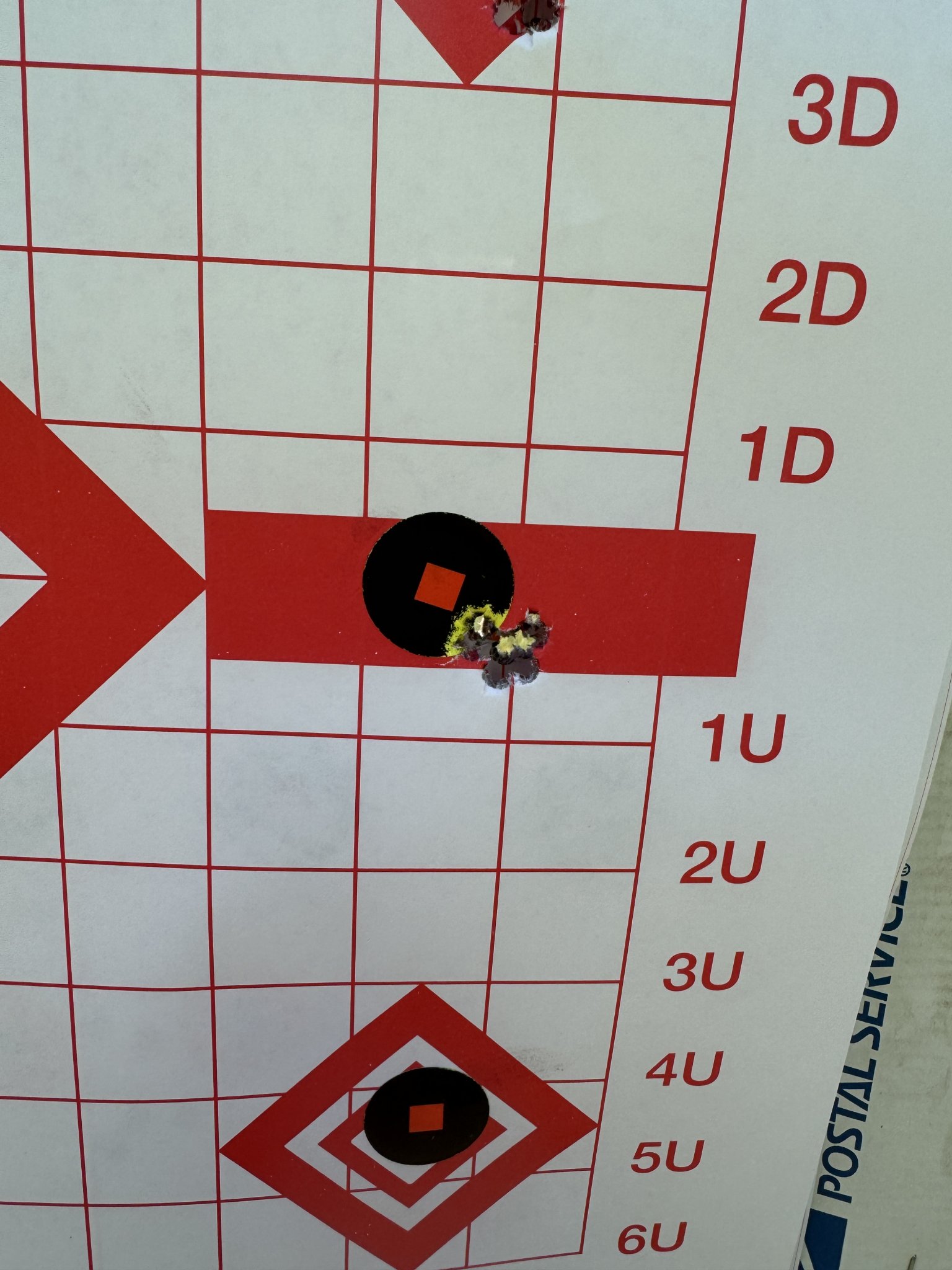

I took it to the range this morning to run a bunch of different loads through it to get an idea of what it might like: Berger 95 VLD TGT, 105 Scenar-L, 109 LRHT - all shot ok, but had some feed issues. For shits and giggles I loaded up some 103 ELD-Xs I had laying around. I’ve moved away from Hornady components years ago for precision loads - they just always seemed to give me problems and I guess I’m really snobby.
But wow, those 103 ELD-Xs fed flawlessly! They also grouped remarkably well in the 29-30gr range with LVR and still gave me around 2530 fps out of that 16” barrel. If you’re running a 6ARC AR15, give them a try (or maybe I’m just totally late to the game?).

What size were the groups?
Again, using my own loads for a different 26" barrel, groups were still < 1.5MOA. I then loaded a powder ladder with the 95 VLD thinking that would be a good bullet for a 16" barrel (and I have thousands of them handy), but groups fluctuated between 1.2 MOA and 0.7 MOA. Velocity range was 2381fps w/ 28gr of LVR, and 2694 with 30.7gr (no pressure). But again, I had some feed issues.
I had some 103 ELD-Xs left over from troubleshooting a 6mm Creedmoor barrel from last year, so I loaded them from 28gr (2360fps) to 30.7gr (2646fps). Looking at the data, groups were tighter with 0.8 MOA on the high end and 0.3 MOA on the low end. These were 5-shot groups and not really intended for load development because this is a new barrel - I was just trying to get rounds down the bore and see what velocities I was getting. The sweet spot in this one was actually 29.5 of LVR giving me 2526 fps. And again, unlike the other bullets, these all loaded flawlessly. I suspect it has to with the more pronounced tangent ogive of the bullet vs the secant of the VLD. The VLD seemed to have trouble getting into the feed ramp reliably, while the more rounded ELD-X jumped right in. I cycled through three different 10-round Lancer mags in the testing.
So it's still early and this is fairly anecdotal, but I've already ordered some more 103 ELD-Xs to see if I can make a load that matches the results I got in testing today.

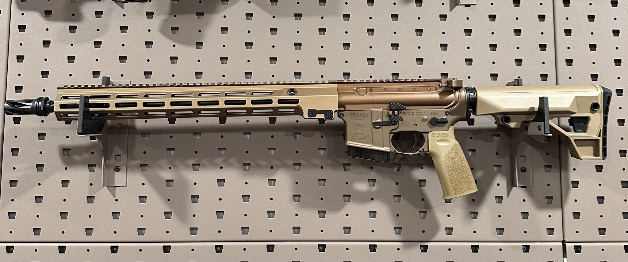

Can you please detail your build? I am brooding about 6 ARC and would love to hear about it.
LMT MARS-L MRP base rifle, Proof Carbon 18” 6 ARC Rifle +1 gas length with SLR Micro gas block. JP 6 ARC bolt in an LMT SA carrier, carbine buffer and spring. Rearden SPB brake, HUB converted AAC SDN-6, NF ATACR 4-16x42 F1 Mil-XT in a Reptilia AUS mount.

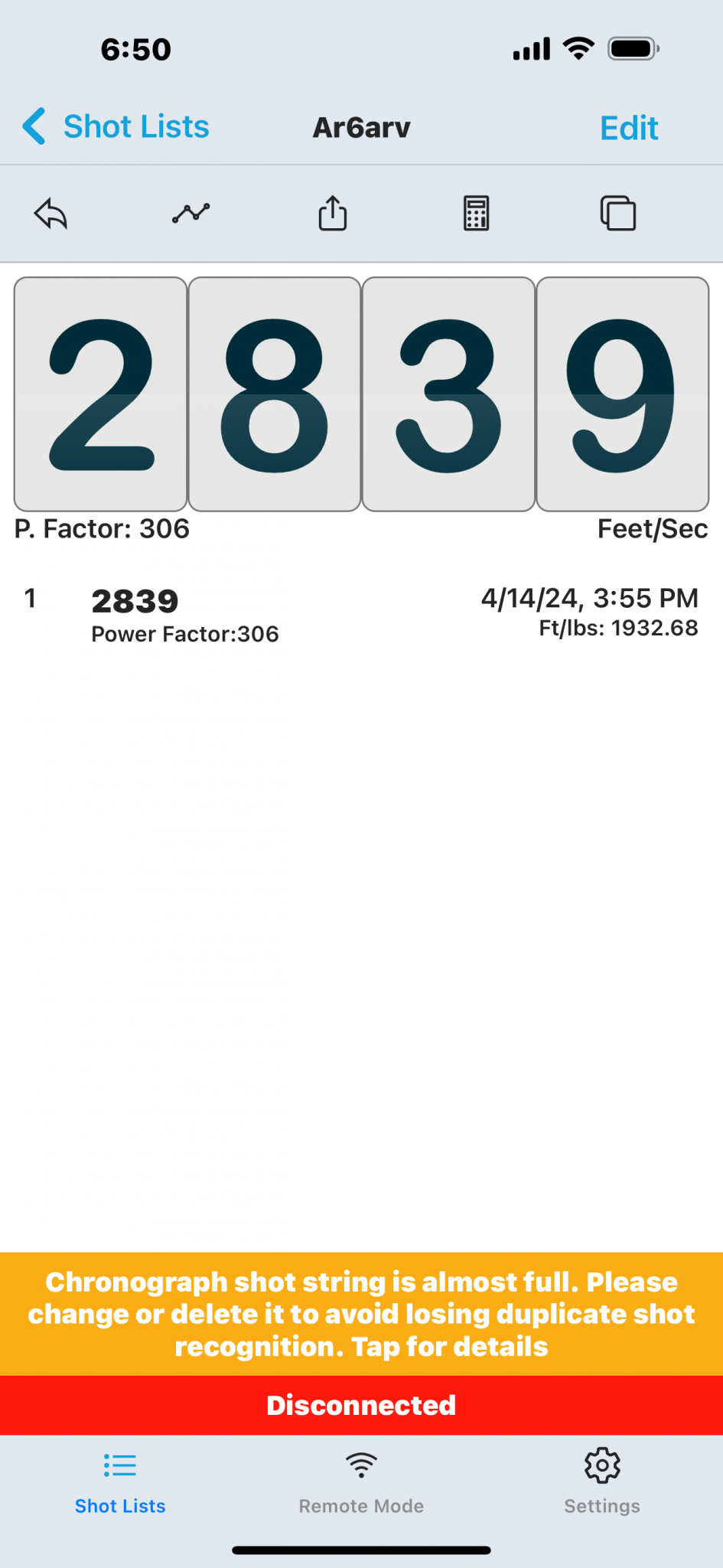

29gr shooter world precision 2700

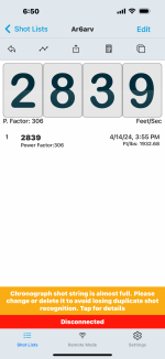

26.7 sw p and 108gr eld= 2839

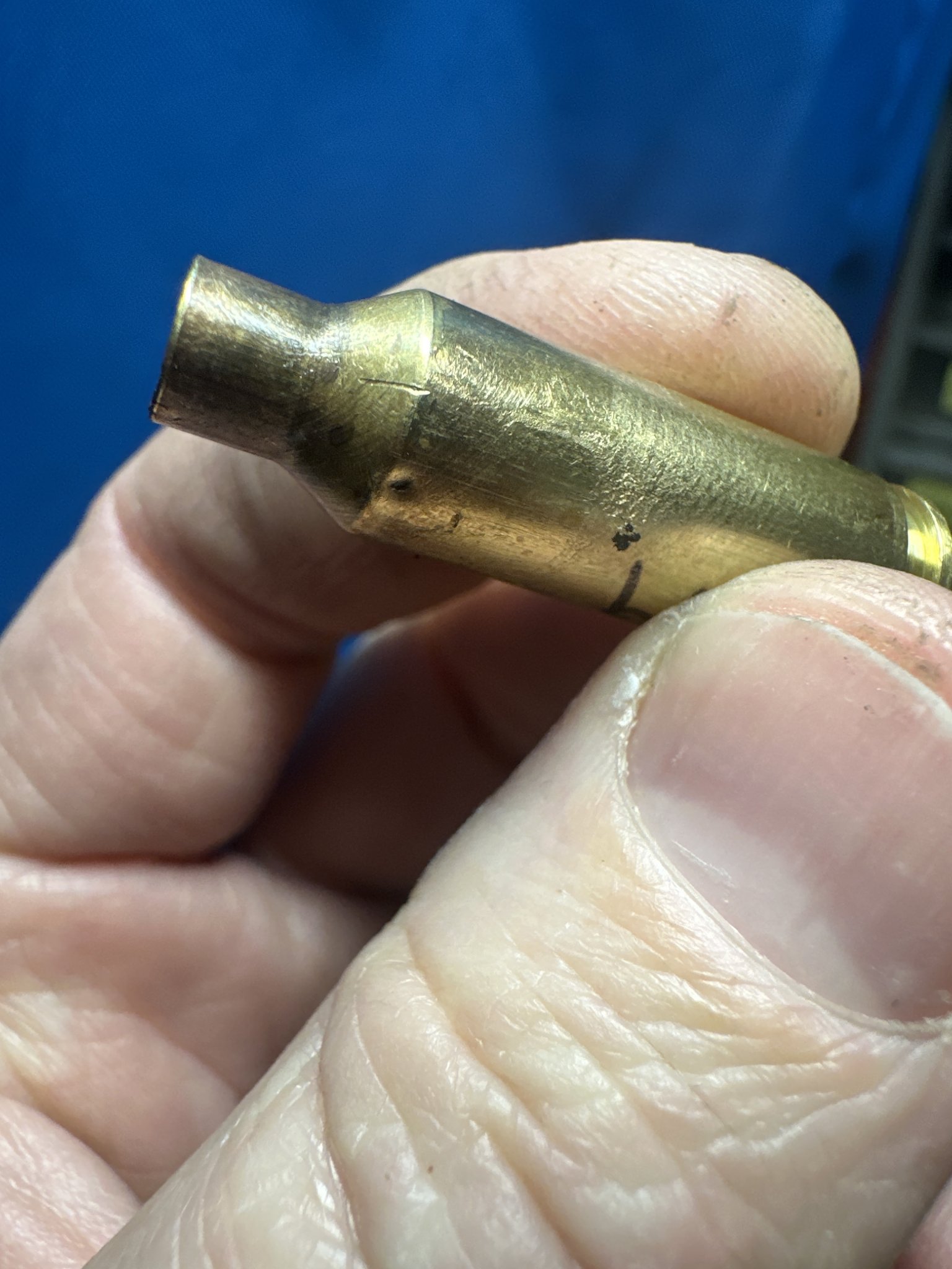

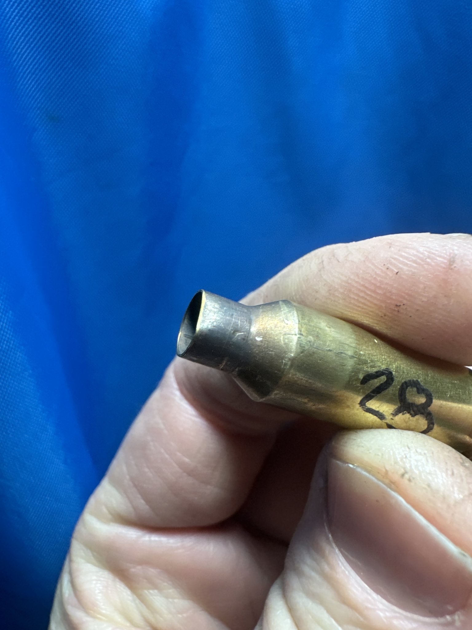

None of these said any pressure signs my biggest issue or complaint is once you and these brass they get beat to fuck when It’s ejected, the barrel extension smashes the mouth, and although the extension was smooth out with no sharp edges where the case will come out , large scratches right at the beginning of the case, head, right as the case starts to taper…
I deberred all of my magazines,
And I smoothed out any area on the barrel extension

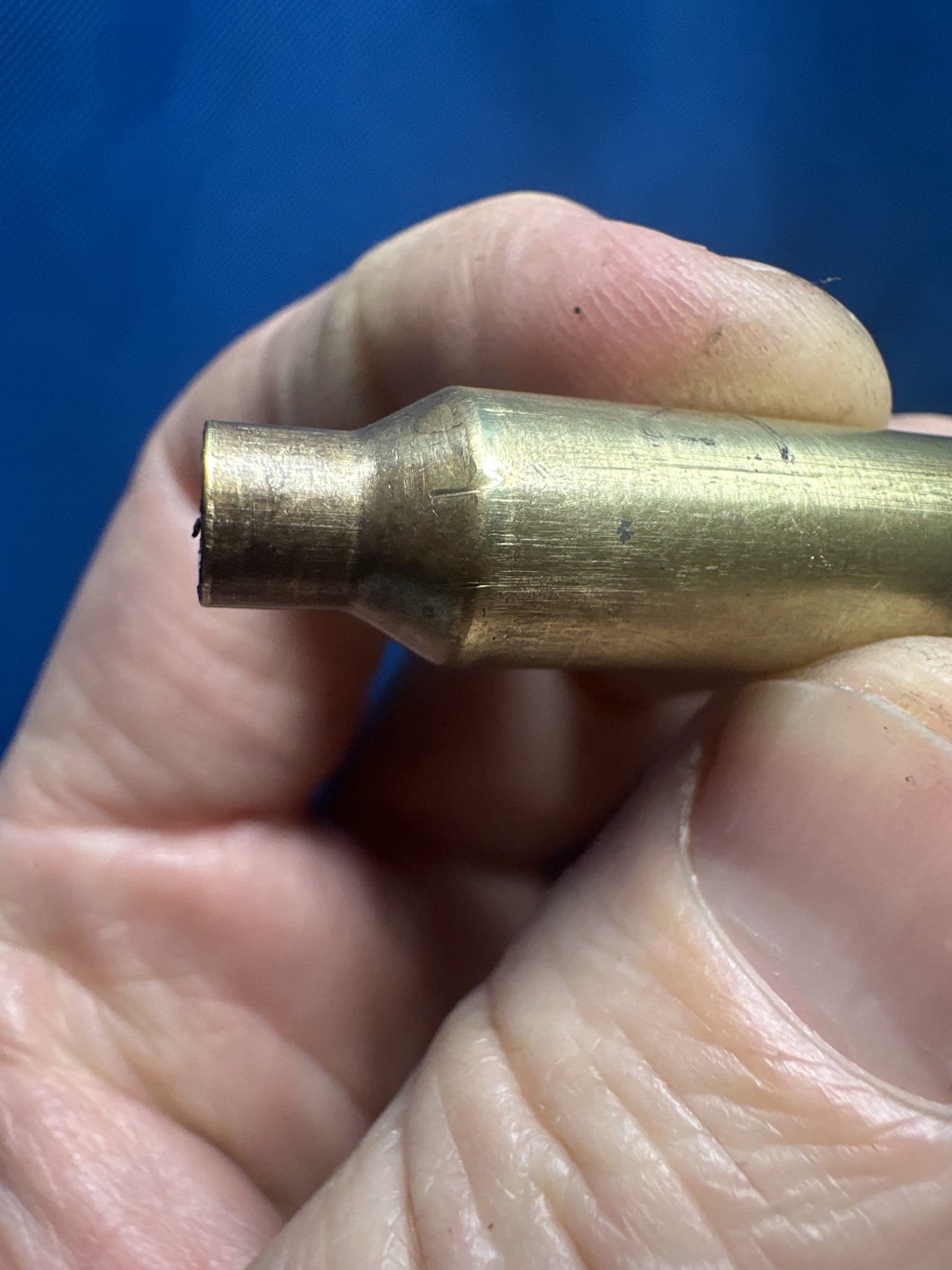

Some of it looks like the dreaded snakebite, but on the beginning of taper…
That’s the issue I have with this case is that it seems to get jacked up when you do any sort of softening of the case/ a.k.a. Ankneeling

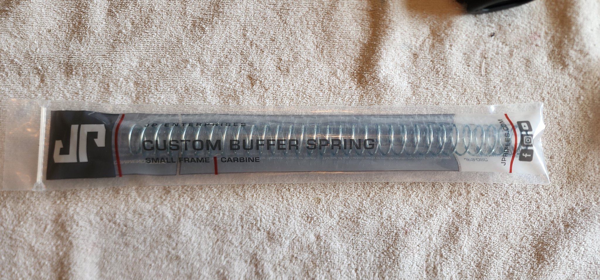

I’ll be honest I don’t know the answer to that question and with this gun so far.. I’m not sure having a heavy buffer or bolt is the way to go and a heavy spring to boot??
Perhaps a lighter spring and I have your bolt and more gas would be the way to go then it may allow the bolt to go back far enough to lock, but yet unlocked later due to the heavier buffer??

As far as the case, scratching, I’ll just have to go in and do a little more fine polishing.
This is a short fat with very quick taper, which equals dented case mouth, especially if you aneal it… these cases were work hardened coming from Starline and they need to be annealed…jmho..
Probably because they needed to make sure the base of the case was hard enough and didn’t want to do the extra step..
I had dented casemouths at first as well. I super glued a pice of old style thick mousepad to the receiver rubber side out and fixed on the cheap. Just checked the rounds I shot Saturday and they are perfectly round.

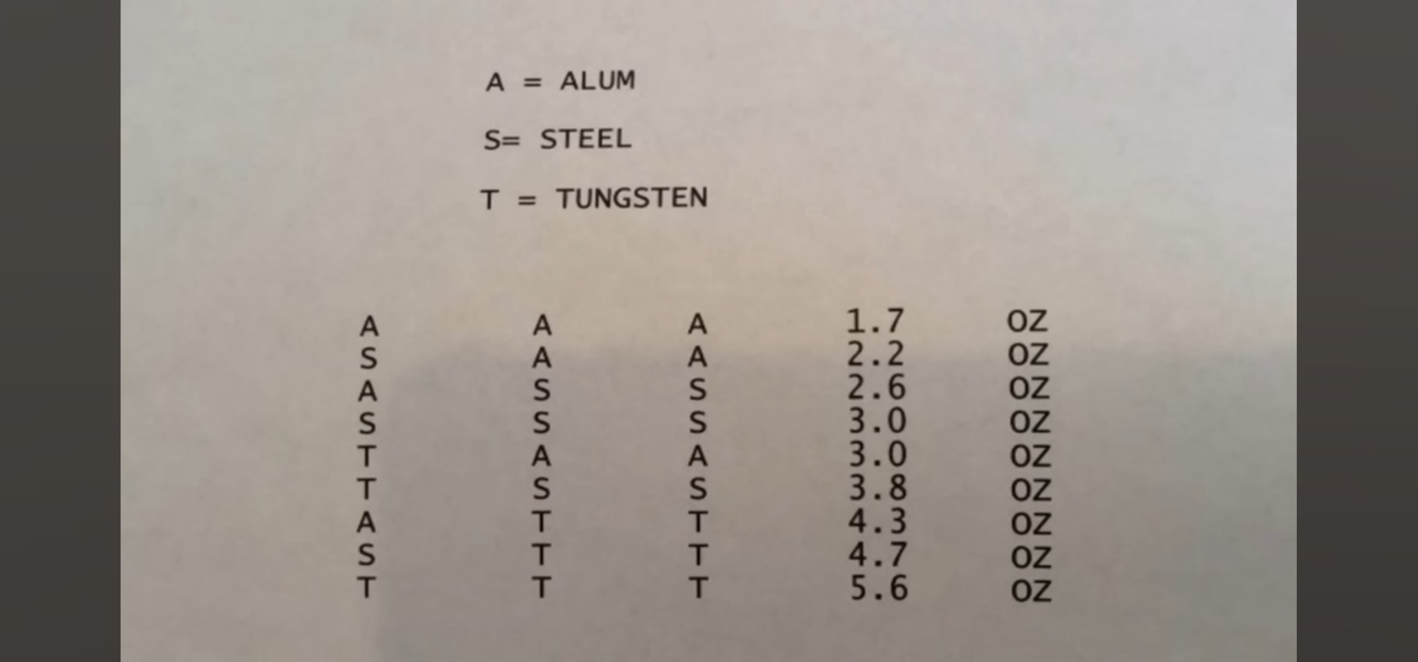

Do you want more heavy bolt / spring and buffer with MORE GASS??
or lighter bolt/ buffer and normal spring with lLESS GAS???
similar here too. I have used one side foam tape on the deflector and case mouths are stay round. My buddy bought the “pads” someone sells with good results.
Reactions: Kocher
not sure if you saw this, from TOS. It might help to get those inside corners of the barrel extension at 3 o'clock. Brass whacks those corners when it's pulled out of the chamber.
https://www.ar15.com/forums/Precisi...woods-Guide-to-the-Ultimate-AR-fixed-/4-6919/
ha ha, that’s pretty much what I was doing.. I went and smooth all the edges on the lugs of the barrel extension…
I found out the scratch on the case, is actually caused by the magazine just like that article. I did smoothing on them already. —. Lots
I still think it might be just the ejection throwing the case, directly into those hard barrel lugs.
Will be adding the mouse pad as well…
Hornady 108 Elds = 2,839. With 27.6 Sw precision (shorter cut than varget)
Judging by what others are getting for their velocities that’s good. 22” barrel .. I think I was right at the max as I believe I saw a bit of ever so slight smudge on the case..
I can’t comment on the grouping as it was only 50 yards as they shut down 100 yard range due to a trap meet
