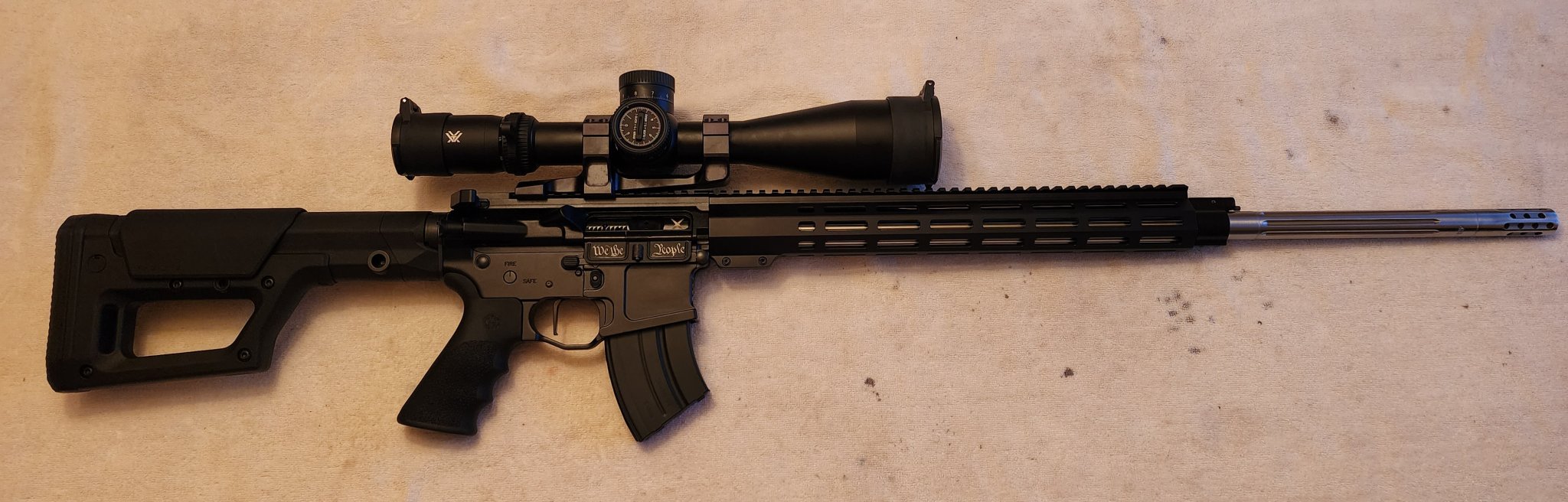

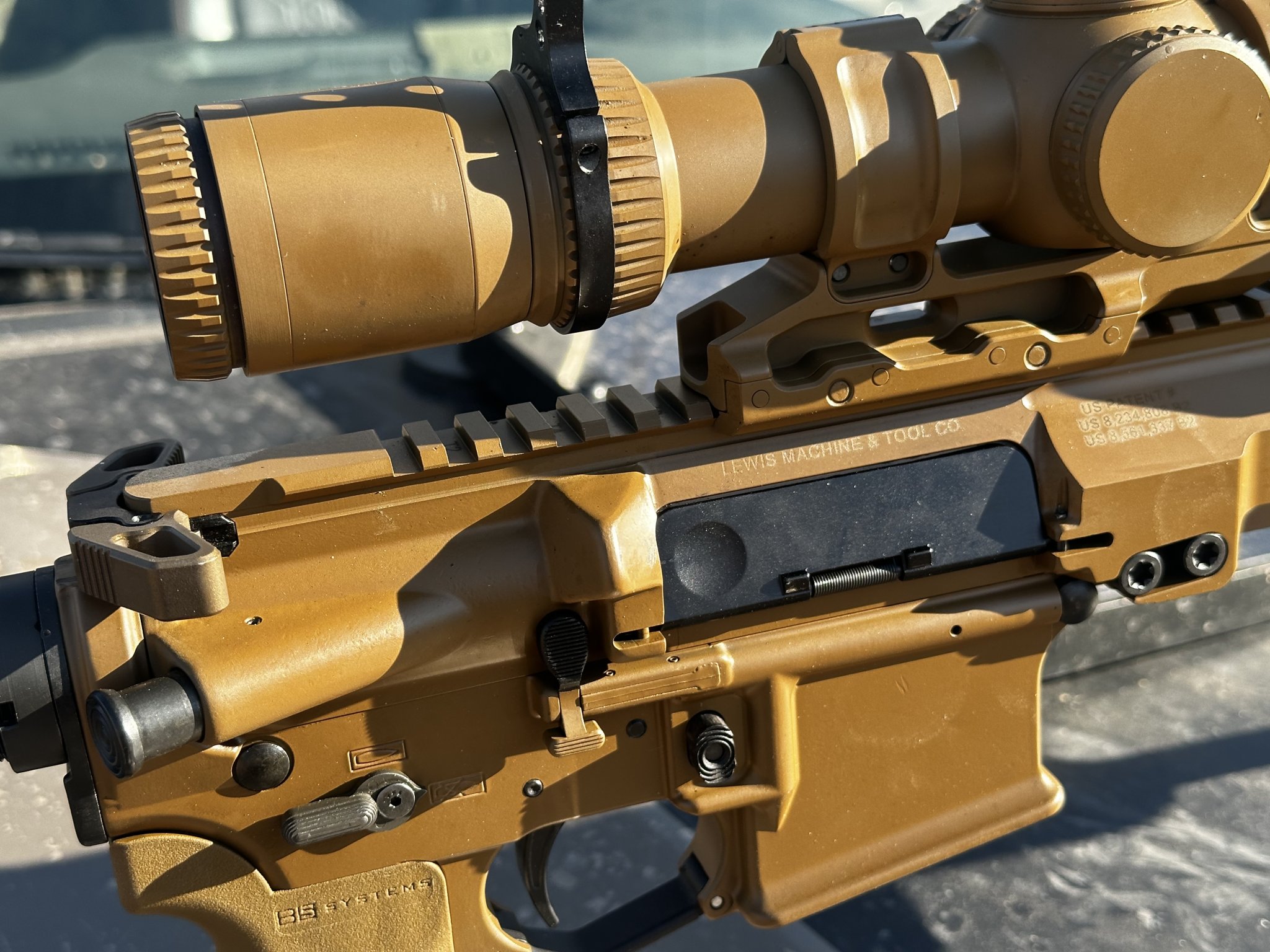

Shit pic I know, but it's what I've got. I am still waiting on a few more items to further fine tune the build (trigger, grip, optic level), but other than she's pretty much done. I might throw the Acro back on top after my next range trip. I thought about moving to a shorter and lighter suppressor but this thing will live at the range in prone or from a tripod so I don't really see the point in the change if it's working reliably. I still love the look of the SDN-6, such a timeless can IMHO.

At 13.5lbs its finally ready to rock! I'm taking Thursday off from work for a range trip and barrel break in.View attachment 8440041

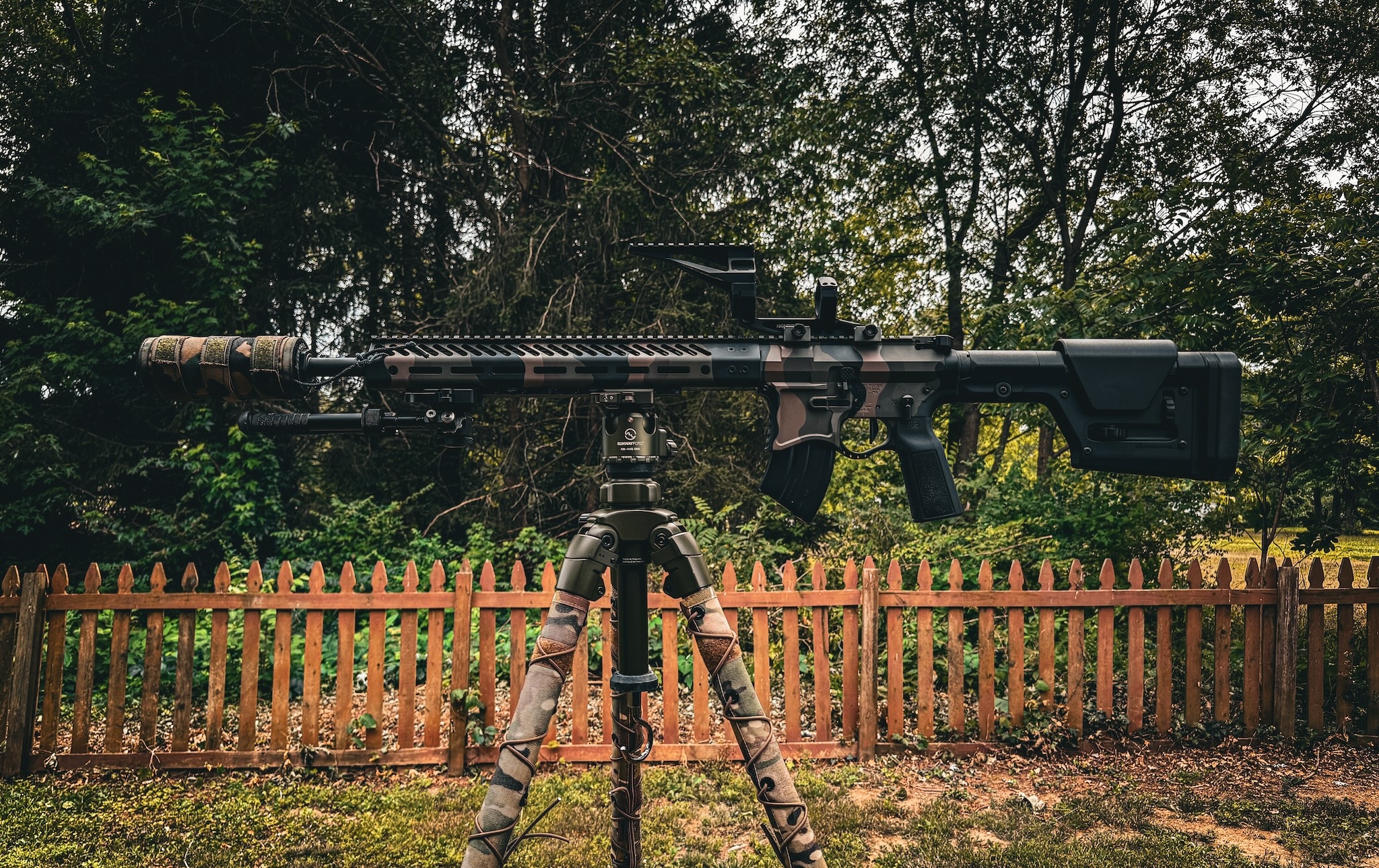

Weight adds up so fast my 20” gun is 9.8lbs. My heaviest accessory is my scope. It is 26.5 ounces without the mount. After adding my suppressor, and bipod, and A5 rifle stock. It’s only gonna get chonkier lol.

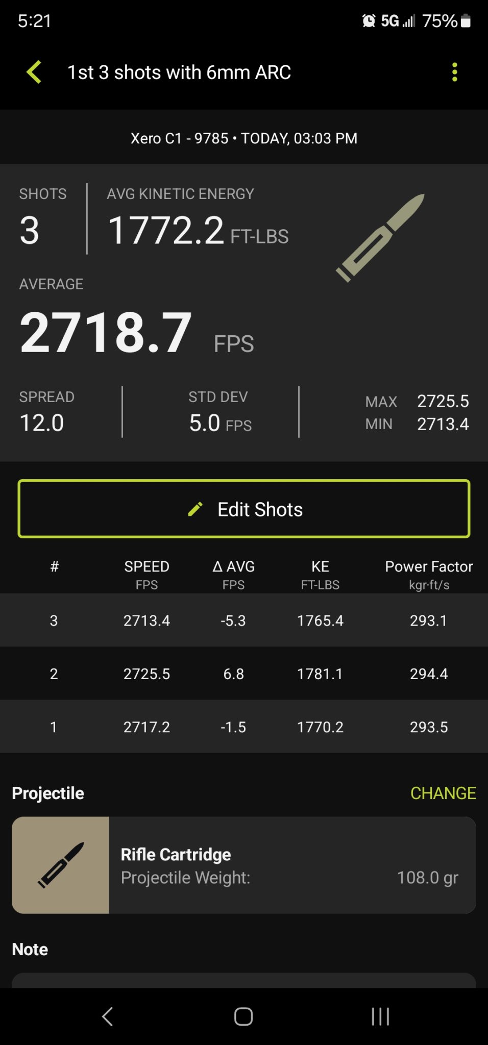

I ran out of time at the range with prioritizing breaking in my 300blk. But I did get the 1st 3 rounds of hornady 108gr factory ammo down the 24" xcaliber barrel and chronographed. I sure hope it speeds up as it breaks in.
My 18" with can and an empty mag came to 11lbs 7oz, definitely not a lightweight. That said, the can is a SDN-6 which is long and heavy, B5 Precision stock is heavy, NF ATACR 4-16X isn't light and the LMT monolithic upper and barrel system aren't exactly light either.

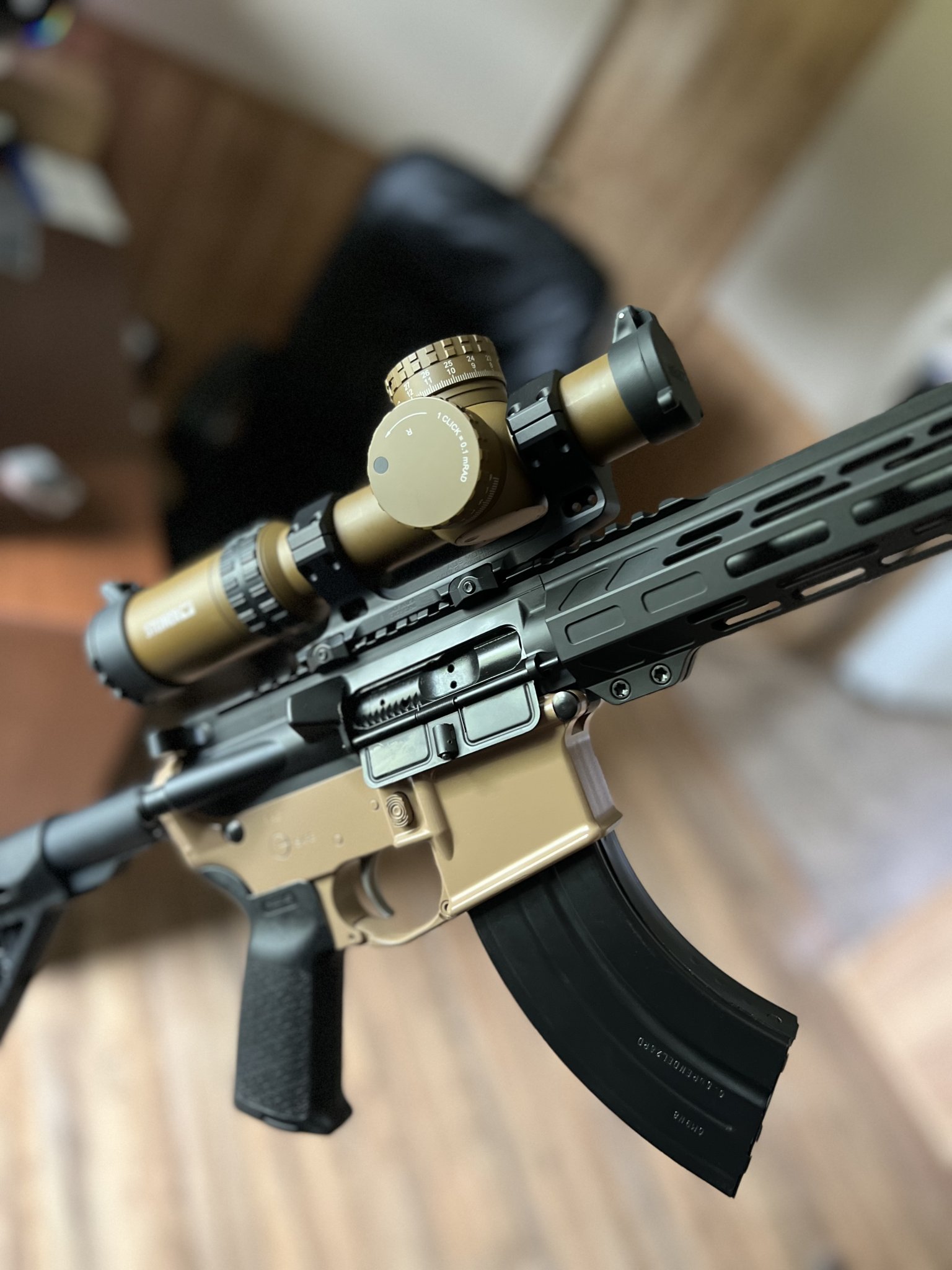

Laid up and recovering from surgery but this is my almost complete 6ARC. Just waiting on the NF ATACR 4-16 to top it off.
Seekins Receivers | Seekins Handguard | Proof Research 18" 6ARC | OCL Polonium | NF 34mm Mount | Geissele SD-E | Magpul PRS Gen 3 | Atlas Bipod
beautiful. let me know how that polonium does on there I am interested in getting one myself.

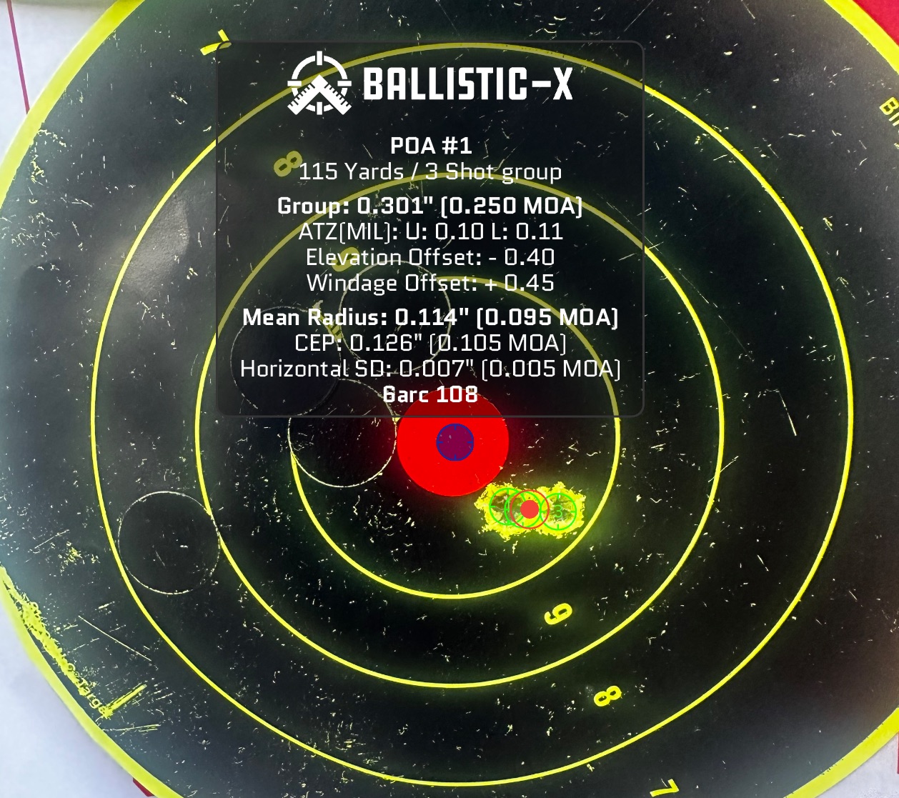

I found a few hours today upon returning home to get to the range. Factory loaded Hornady 108 ELD-M's did great, this is the best group yet from the rifle out of every factory Hornady load it has seen (80 ELD-VT, 103 ELD-X, 108 ELD-M). I forgot to bring the chrono once again so I don't have any numbers there.
I sighted the rifle in to be 1.8-2" high at 100 yards for a 200 yard zero. The final 5-round group with the 108 ELD-M's printed a 0.498" group. For a factory load from a gas gun I couldn't be more pleased and I still don't have a light pull match trigger in the rifle yet so I have to believe it can do even better. I am sitting at roughly 100-120 rounds down the tube on this setup so I expect things to get better in the next few hundred rounds as well.
I wasn't sure about the Ecco Machine HUB converted AAC SDN-6 on this rifle at first, thinking I needed to have a back pressure reducing can like most everyone says but so far the recoil is light, gas to the face is minimal and it tosses the brass 4-5 feet at 3:30-4 o'clock. I believe I'll keep it as is for now.
