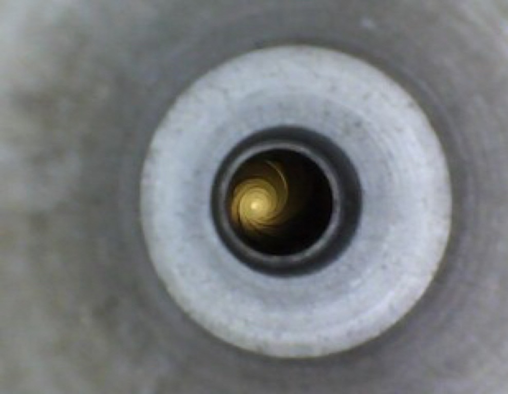

It does sounds like something building, carbon ring certainly. I used a bore scope and looked in the chamber and throat and didn't see anything. I have never seen a carbon ring. Should it be appearant? I thought I knew how to clean a rifle, maybe I don't and I don't mind being corrected.
I believe I took some pics, if I still have them I will post them and see what you think.

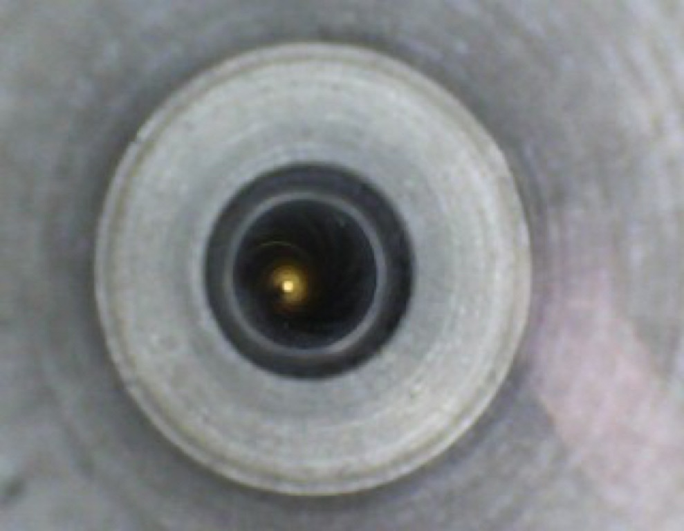

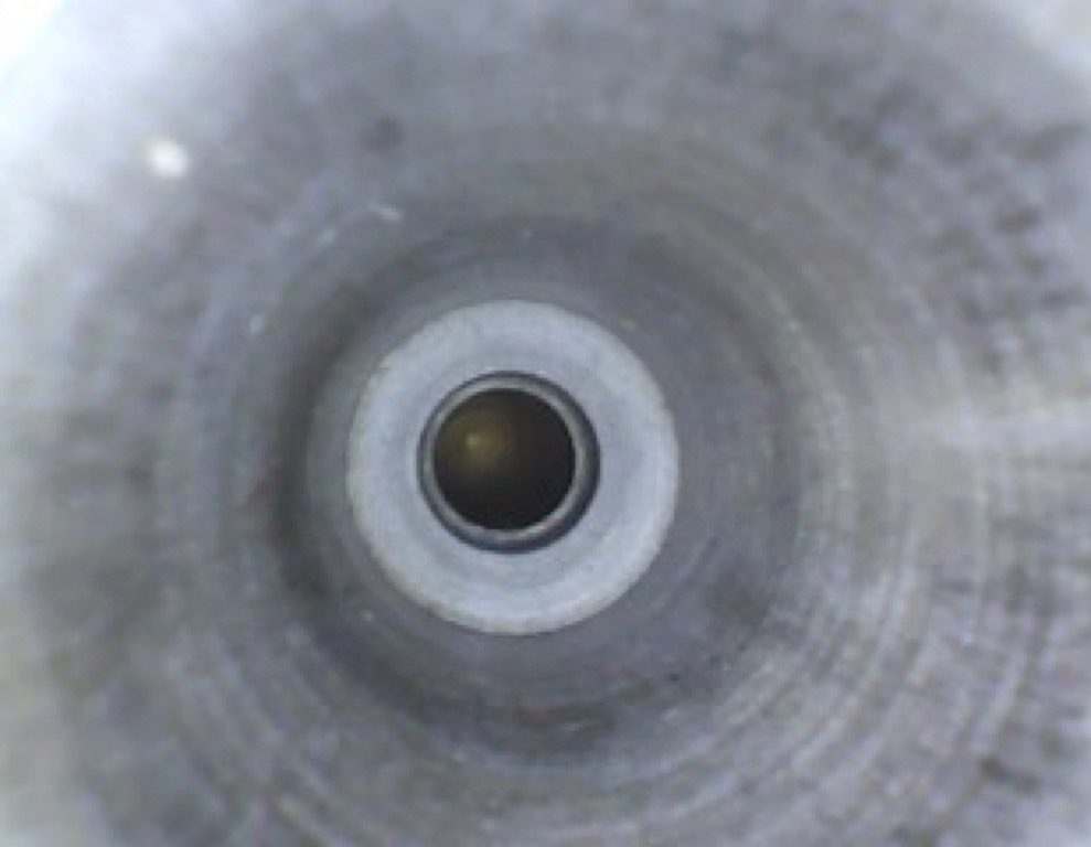

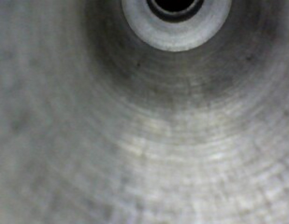

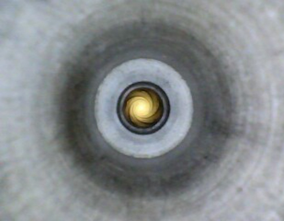

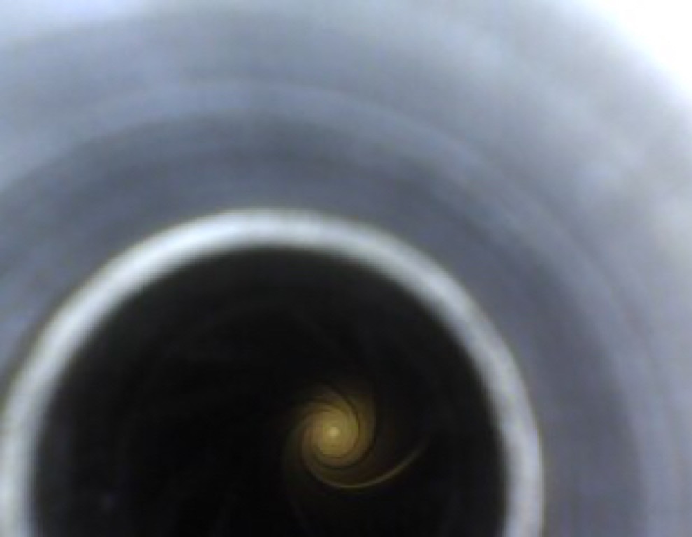

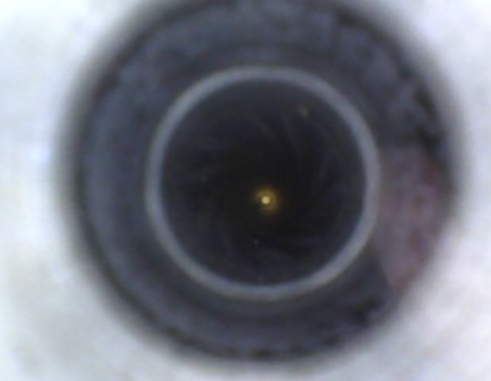

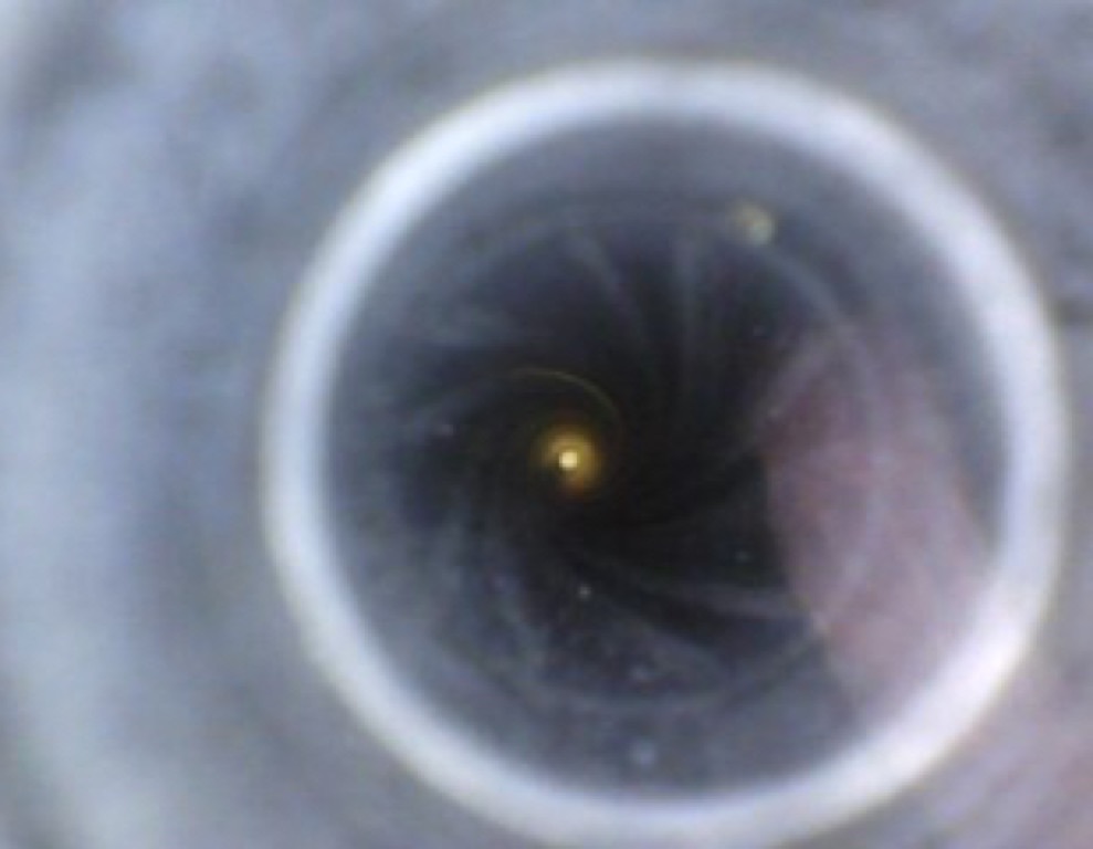

OK here's some pics I took last week of the chamber of my AI. The borescope I used is used for inspecting the cylinders and valves of aircraft so the focal length is a little too far for seeing close. Pics are great, but hopefully they can rule out carbon ring or other problem with bbl.

I know it's had to actually see the bore, not the right bore scope, but does it look like there is a carbon ring? I have never heard or seen one until I read about it here. Should it be a ring that is on the lands, or just in the grooves? Just in front of the beginning of the lands and grooves?
