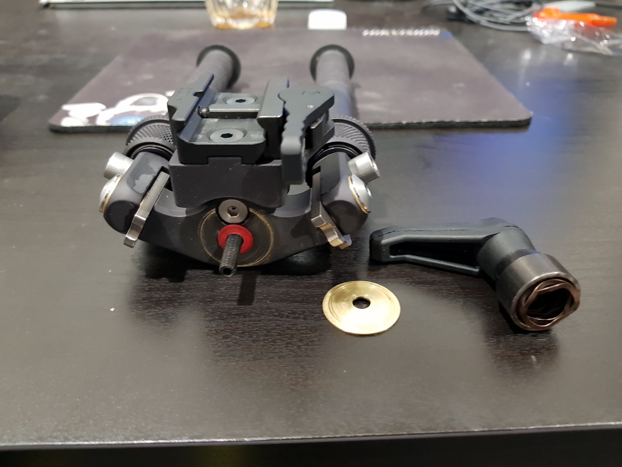

I have the same complaint about the CAL's function. I disassembled mine and believe the problem lies in the contact between the brass washer and the anodized face of the leg bracket. The anodized texture of the leg bracket does not slide easily against the brass washer - which results in the either locked up or loose condition. Anywhere in between is a jerky movement as your have to push to overcome the friction between the bearing surface of the washer and leg bracket.
I coated the two contact areas with white lithium grease and it improved the feel, but would be hesitant able using it this way in the field as it would likely trap grit and dirt. Perhaps polishing the contact point smooth would help.
I haven't received the official spring yet from B&T, but did find one about the right length to go between the lever and brass washer. I also put three .020" thick delrin washers between the brass washer and the bipod body. My bipod cants very smoothly with the delrin washers, and also has a much more gradual increase in tension. Once I receive the correct spring from B&T, I'll swap it and see how it feels. Adding a delrin washer really smoothed out the cant motion.

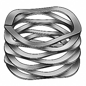

Can someone post a picture of the spring? I’m not sure if mine has it or not
It looks similar to this spring. if you unscrew the pod lock lever off of the stud, it will come right out of the cavity in the lever.
