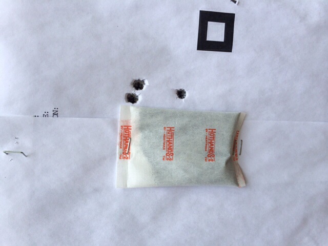

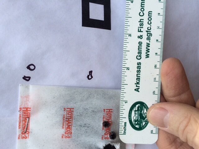

Yes RS64-35, not doing very good posting photos but here is a sight in photo. First photo I drew in second group approximately to measure, second photo shows second group. Had scope at 8X zoom shot 1st 3 shot group, moved scope 1 adjustment right 1 adjustment up. This moved group about the 1.67 right and at least that much up. Would have thought would have been a smaller move at this level of zoom. This was to far off so moved back to original settings and went hunting. Chart does not go to 8X zoom but would have thought it would be an even smaller adjustment. Will have to mess with some more but seemed like original zeroing at 4X also gave me about the same movement. Love the scope for the pigs and thanks for the tip on the wrap going to go measure my cans and order some, big help not to have to figure this out from scratch.
