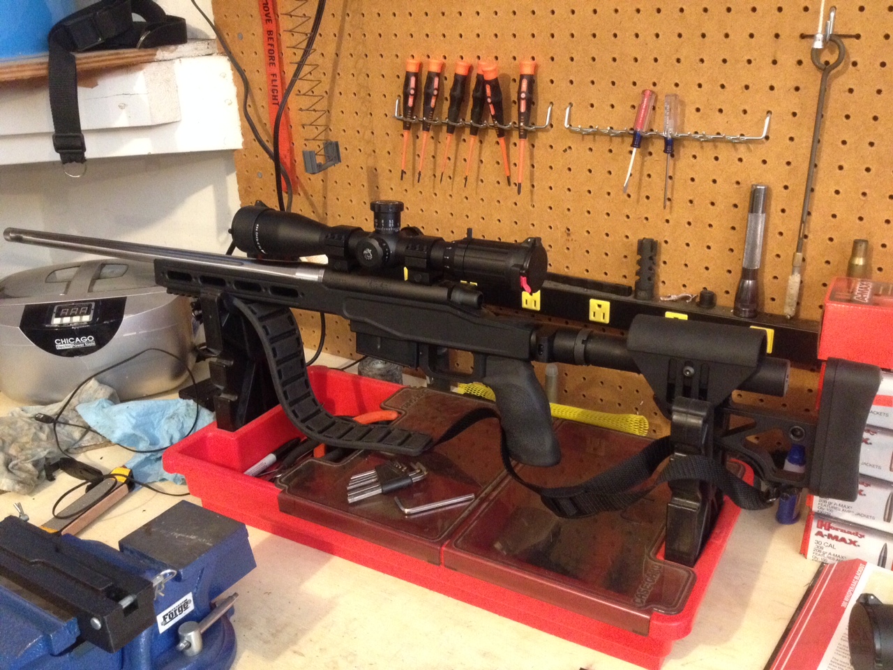

I won an Element that Kyle and the XLR guys generously donated to the Silencerco PRS shoot. I love it! I have decided that all of my comp stuff is going to be Crimson, and so I have been Cerakoting my guns. Most people hate it, but I am tired of "tactical" colors.
Thanks again to Kyle and XLR!
<a href="http://s791.photobucket.com/user/fireguyty/media/XLR_zps4258a28b.jpg.html" target="_blank"><img src="http://i791.photobucket.com/albums/yy195/fireguyty/XLR_zps4258a28b.jpg" border="0" alt=" photo XLR_zps4258a28b.jpg"/></a>
Sorry about the upside down pic. I can't figure out how it fix it and it is giving me a headache.

Refreshing looks great

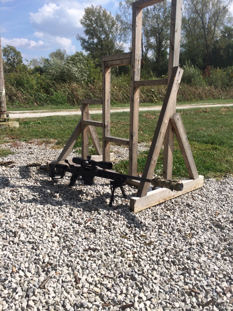

I love mine! Had a benchmark barrel in 6.5CM installed on a blueprinted M700 action and bolted in this thing... shoots perfect!

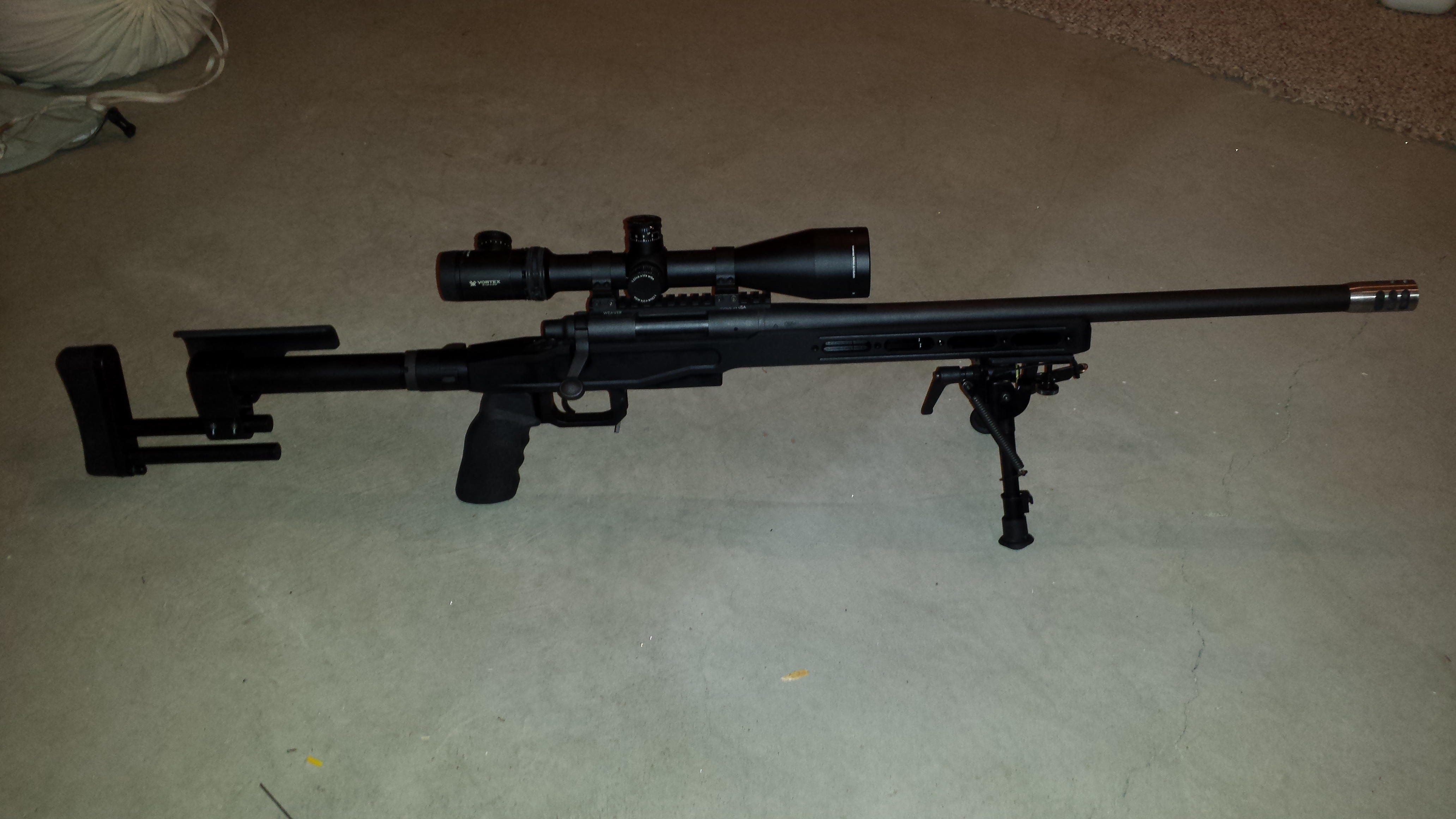

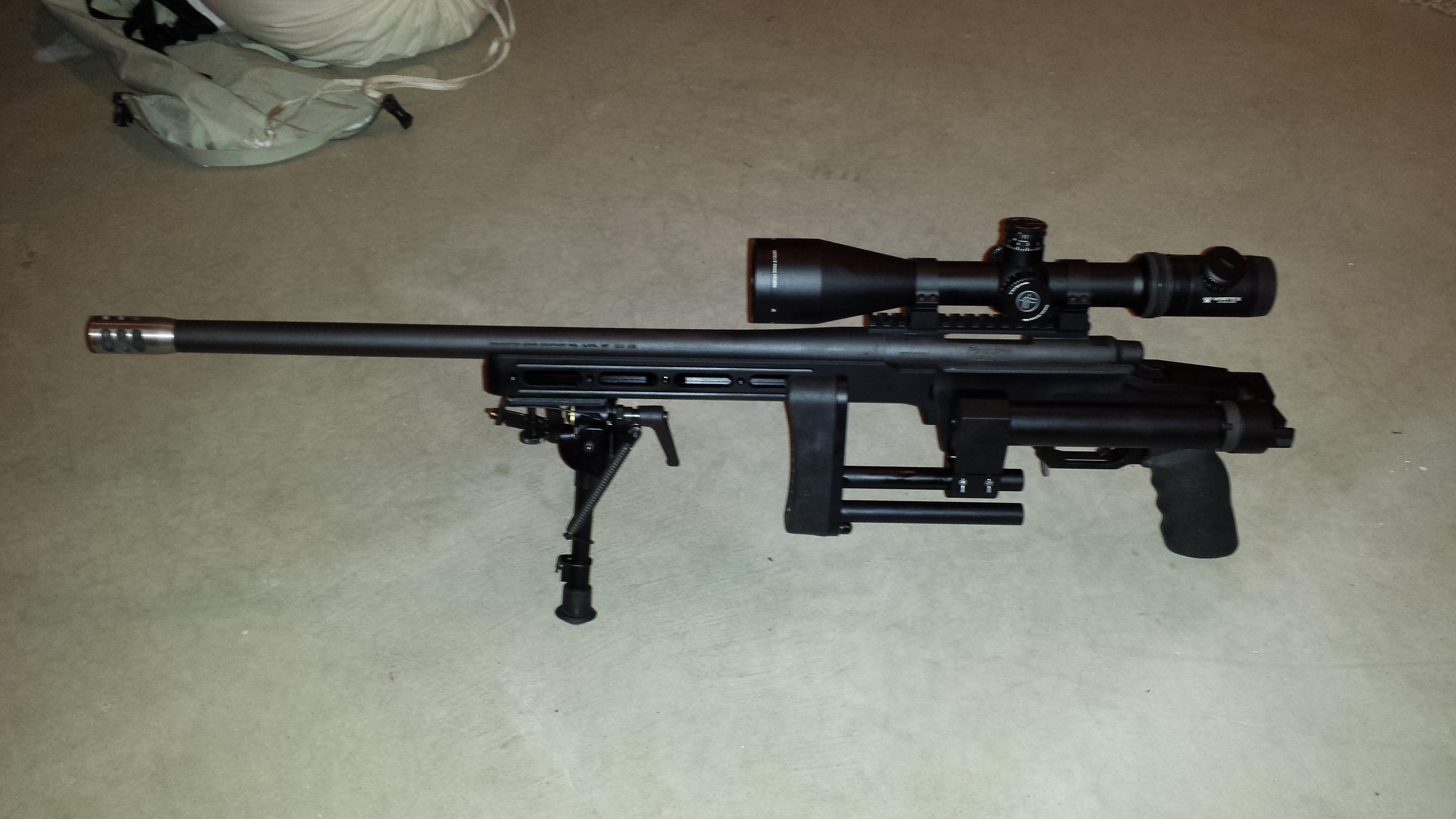

It was done by my buddy Kevin at tactical firearm finishes. He's on the hide as well. I ordered the chassis with foam pad removed and applied it after coating. The finish is duracoat tactical OD green and tactical black.
