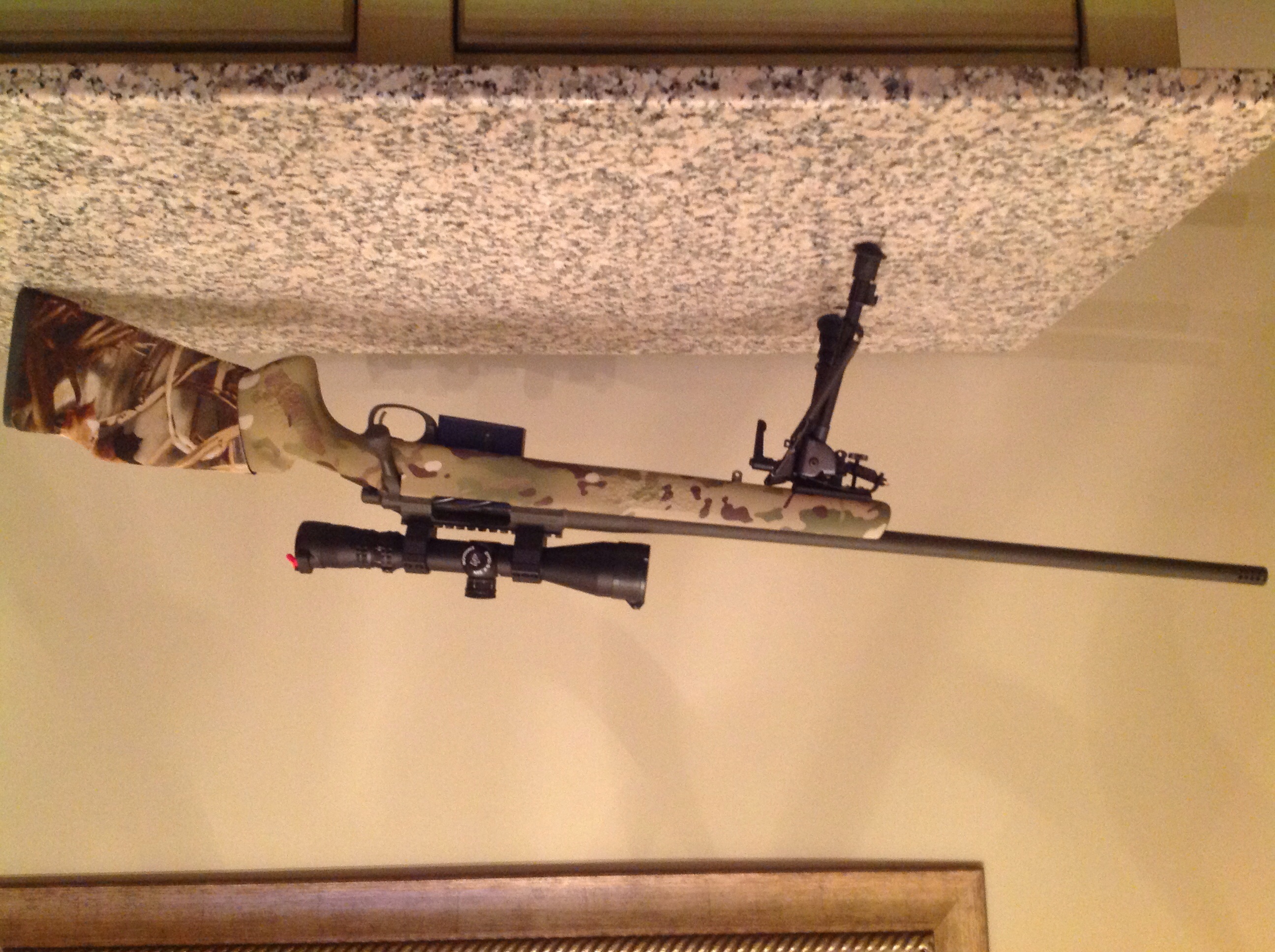

What neck turner are you using? What is the angle on the cutter? I have turned quite a few necks in my time and haven't seen that much of the shoulder removed. I have a GAP 6.5 SAUM on order and have prepared some cases and they do not look like that. Mine are slightly cut in to the shoulder but not up the shoulder like yours. I bought some Copper Creek prepped brass and tried to copy it on my brass. Yours is much different than the C4 brass. I guess I will find out if my brass is OK when I get my Rifle.
