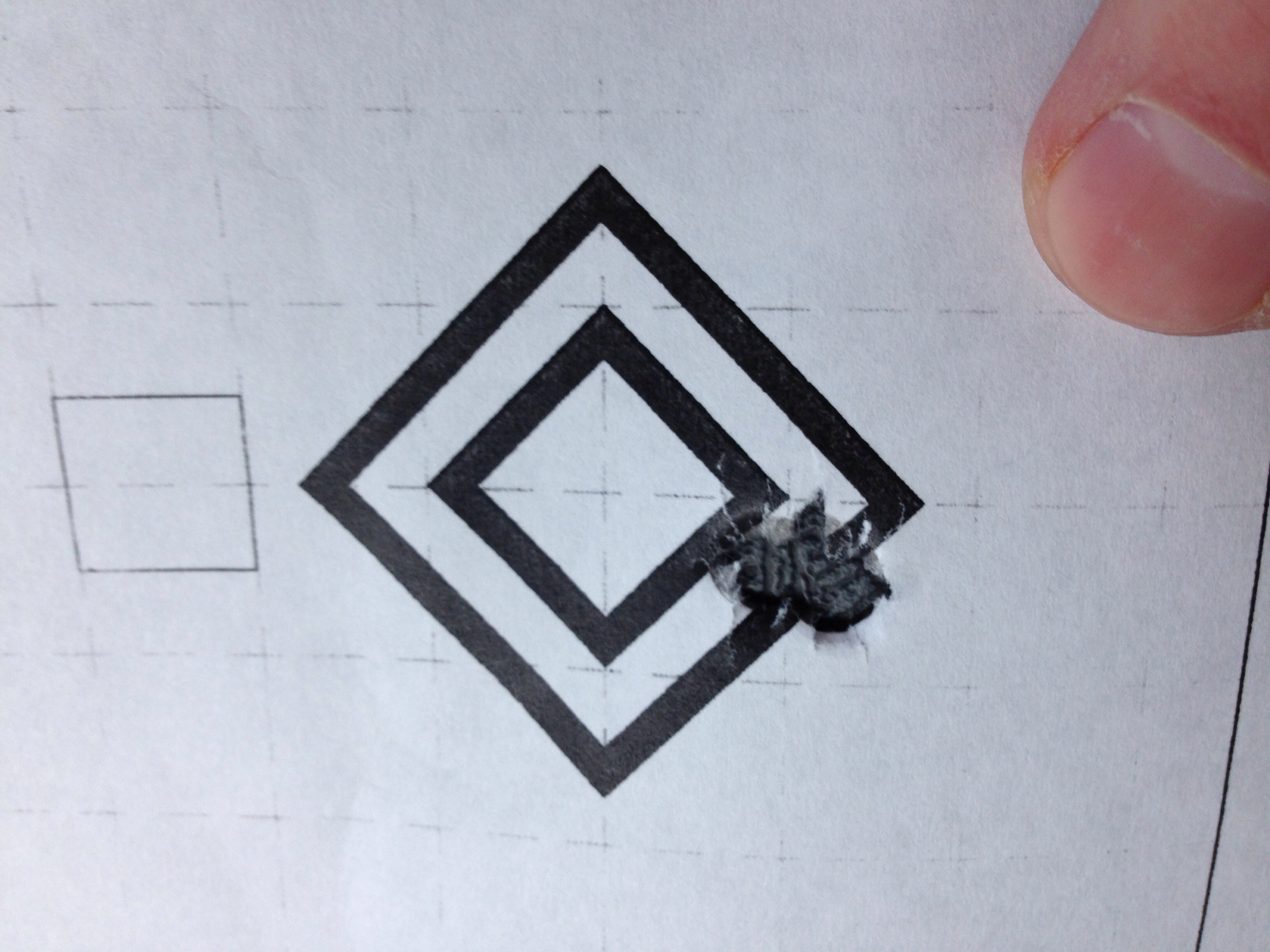

How's this for real testing??
I'd be more interested to know velocities to powder charge ratio. Pressures at that load. And how quickly heat was generated since the burn rates are slightly different.
Is that a 3 round group? It's fine. I was more or less wanting to test the physical differences in the loads/powders over looking at group sizes.
That load is 62 grains of magnum. Velocity is 3030 w 140 JLK. Pressures according to quick load is around 55k. This group is 64.7 grains of magnum at 3180 fps. I believe pressure was around 61k. Yes both are 3 round groups. The 3180 load shoots under half moa at 1050.

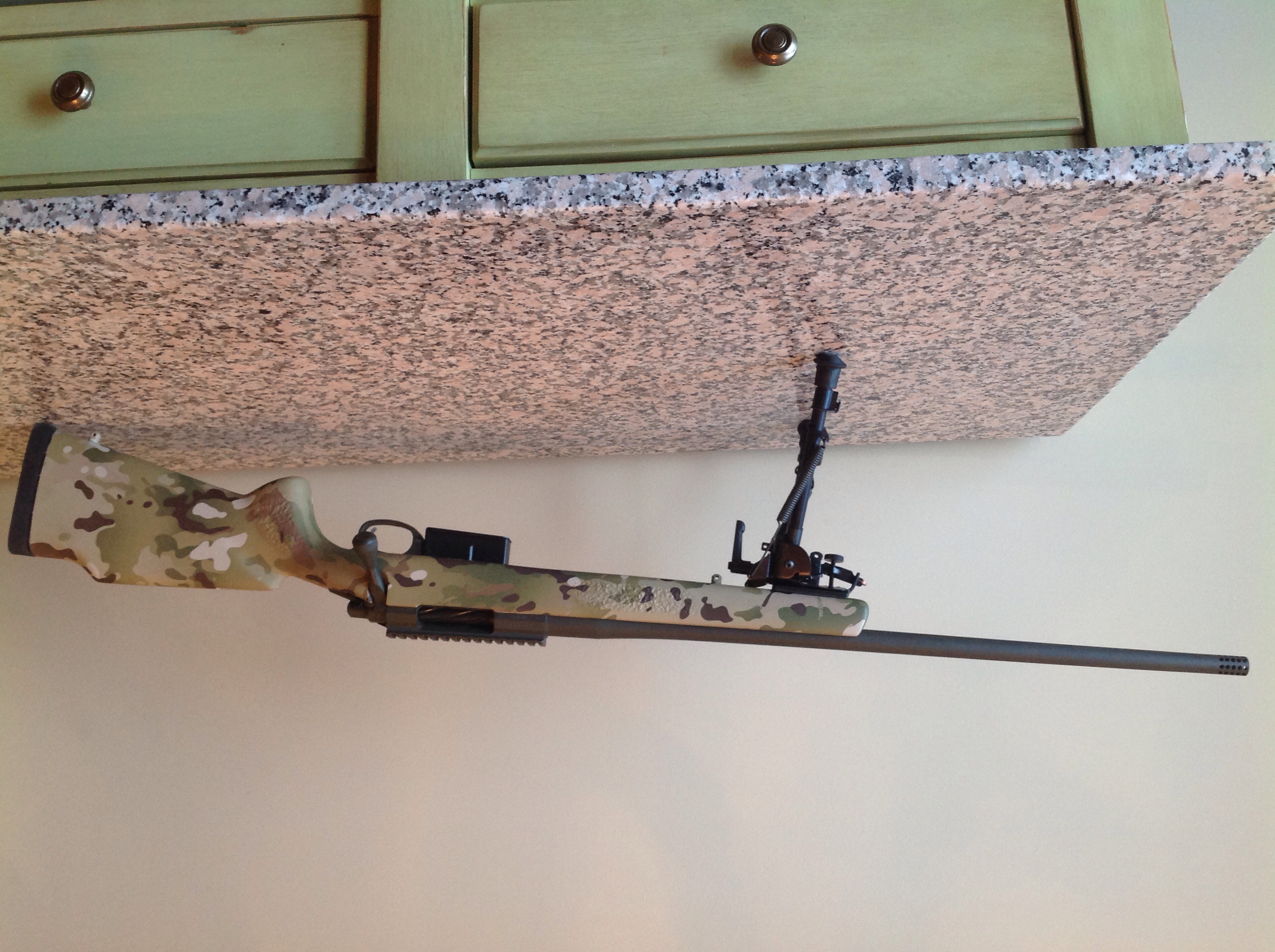

So. Freakin. Happy. Got my 6.5 SAUM from GAP today! Now all I need is some decent weather to go shooting. I'm thinking a mil/mil NF 2.5-10x42 for glass - opinions?
Specs:
Templar V2 lefty
Manners T
Rem trigger
Bartlein #3 w/ 1-8.7 twist finished at 24"
Vias brake
APA bottom metal
2 accurate mag 300 WSM mags
8 3/4 lbs (rifle only)
Specs:
Templar V2 lefty
Manners T
Rem trigger
Vias brake
APA bottom metal

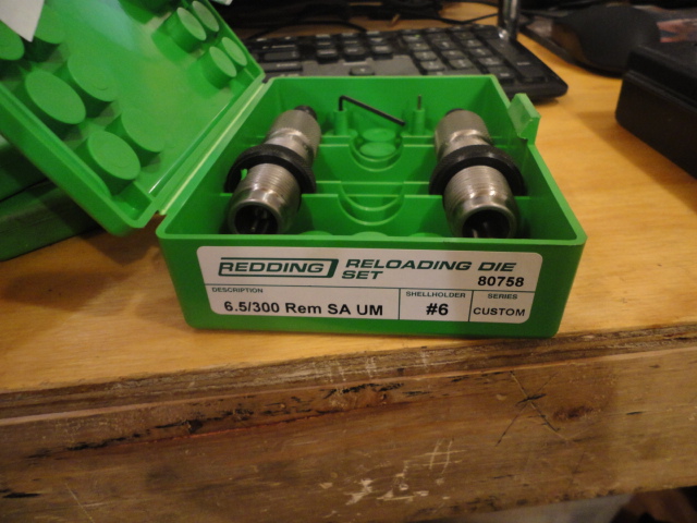

Guys and Gals,
I have 6 sets (when they are gone they are gone) of 6.5/300 SAUM dies. This is a Redding custom standard 2 die set. There is a 6.5/300 seater and a FL size die. The die sizes the neck to .298". I MUST BE CLEAR THESE DO NOT SIZE TURNED NECKS, But they are the tits for making your own brass. These are completely different than the die sets we sell for the turned brass.
These are $165 shipped and can be found here.....First come first serve.
6.5/300 SAUM Dies - $165.00 : Copper Creek Cartridge Co.
Add one of these VLD seating stems from Sinclair and you have micrometer adjustment on the seating die....Part # 749-012-722WS
REDDING VLD BULLET SEATING MICROMETERS | Sinclair Intl
Thanks all!
Specs:
Templar V2 lefty
Manners T
Rem trigger
Vias brake
APA bottom metal
That rifle is so damn light it defies gravity!!!!
You were so excited, you had the camera upside down......grin!
Nice rifle!
Lol, not gonna argue with that! I haven't been this excited about a rifle since my last GAP! If this things shoots as sexy as it looks it's going to be a screamer.

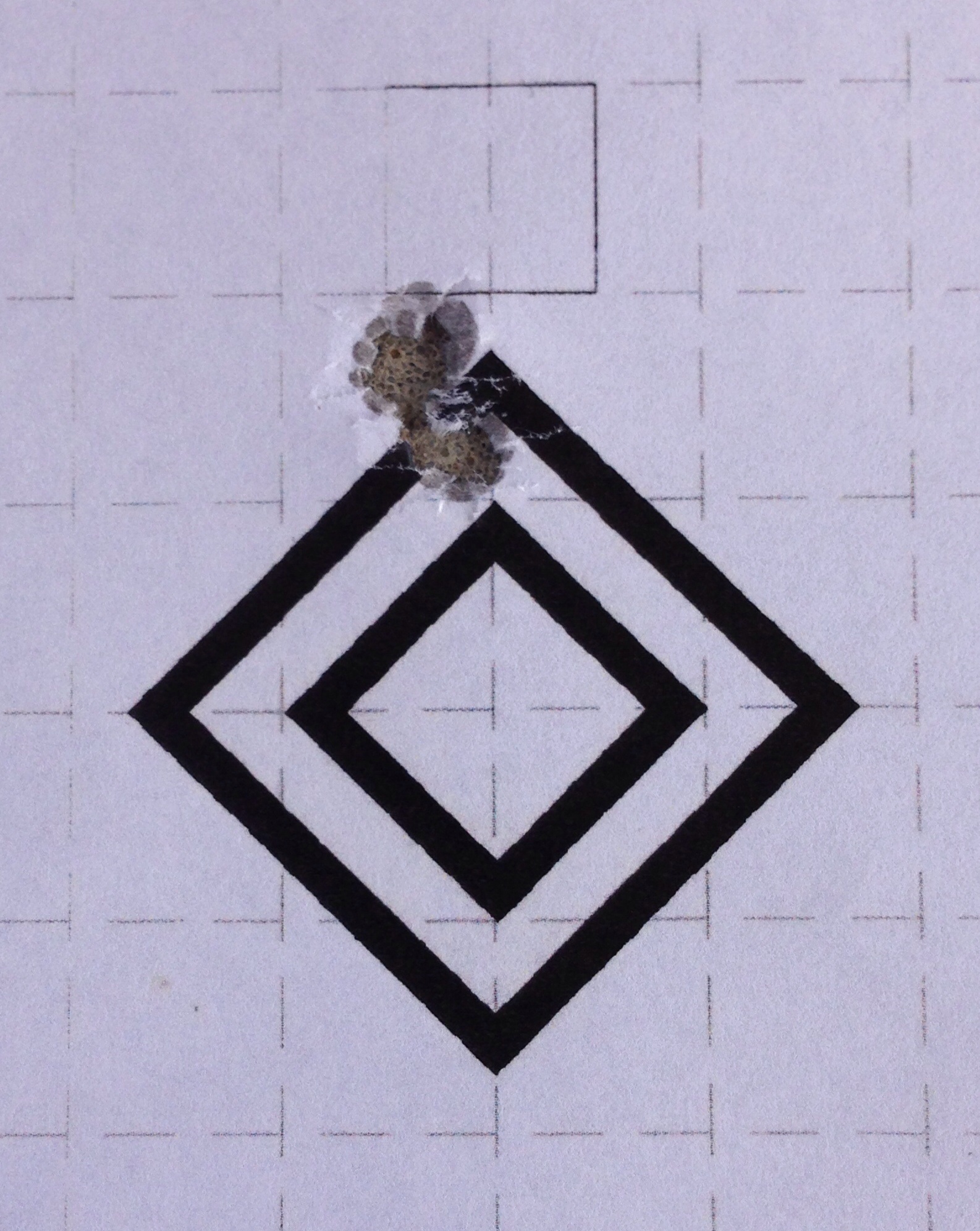

3 shot .180" group at 100 yards 61 grains Retumbo, 140 Amax, neck turned 300 Saum brass from the Atlas bipod
<a href="http://imgur.com/dx9do3s"><img src="http://i.imgur.com/dx9do3s.jpg" title="Hosted by imgur.com"/></a>
