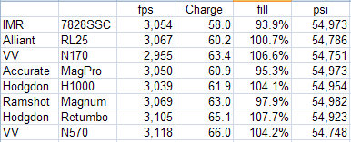

Attached is a table showing some QL runs with the powders you named above. They are based on the following assumptions:
1. 24 in tube
2. 130 VLD Hunting Pointed, BC assumed to be 0.600
3. COAL 2.825
4. Case H2O 73gr
5. Pressure as close to 55kpsi without going over
Sorry - did not know how to post a table in the message so I turned it into a picture:

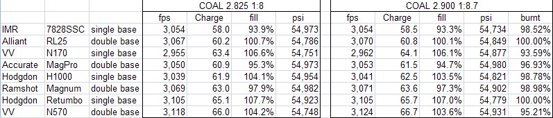

change the COAL to 2.900 and re-compute, add twist of 1-8.7
I asked Josh to do the same computation with all the Relevant data as well will post it when he gets it to me.
Please see attached chart. 2 series are shown with different COAL and Twist. Also added powder type and percent of powder burnt to second series. With the longer COAL and slower twist, 2 MV's stayed the same (but all used more powder). RL25 and Retumbo burning 100% of powder will probably leave very clean barrels ;-)
Re-posted from Ci11's data
These are QL predictions so they vary from rifle to rifle, but should be very close within 5% Using this data will be safe and work up or down accordingly. I do know that the 63 gr load of H1000 on the 130 at 2.900 nets real close to 3200 when the rifle is good and broke in. And pressure trace shows 55,300 PSI
