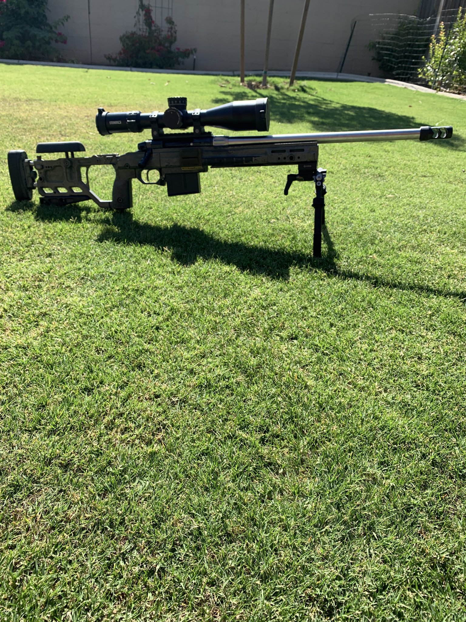

Badass looking setup. Which reticle did you go with?
MSR-2. I don’t really care for grid/ tree/ Horous reticles. The price was right with a mil discount through DSG Arms and Steiner has the cooler promo so I figured it was a decent incentive to try one out as I initially passed on them because they were released without locking turrets and wanted something other than another Nightforce.
