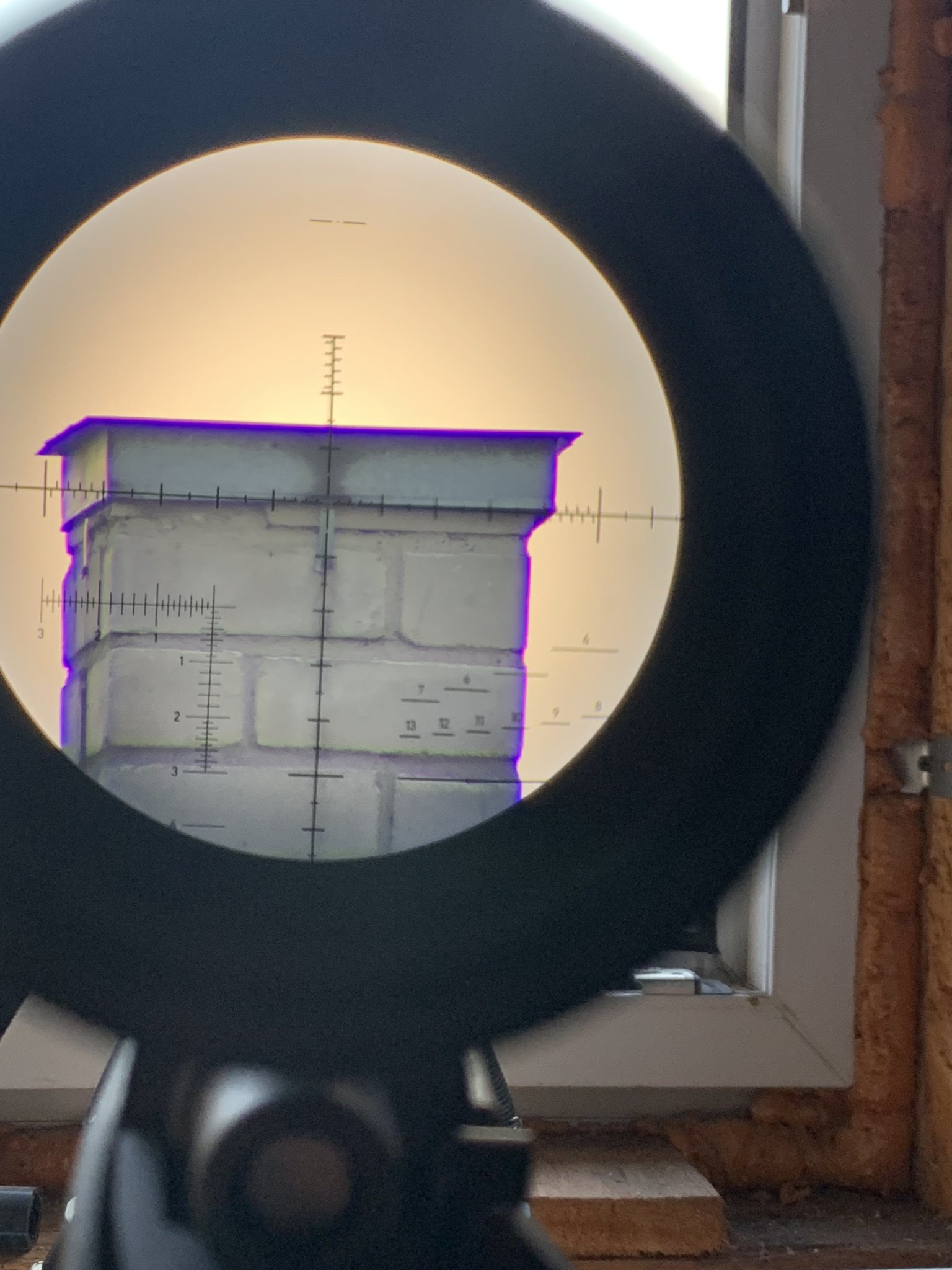

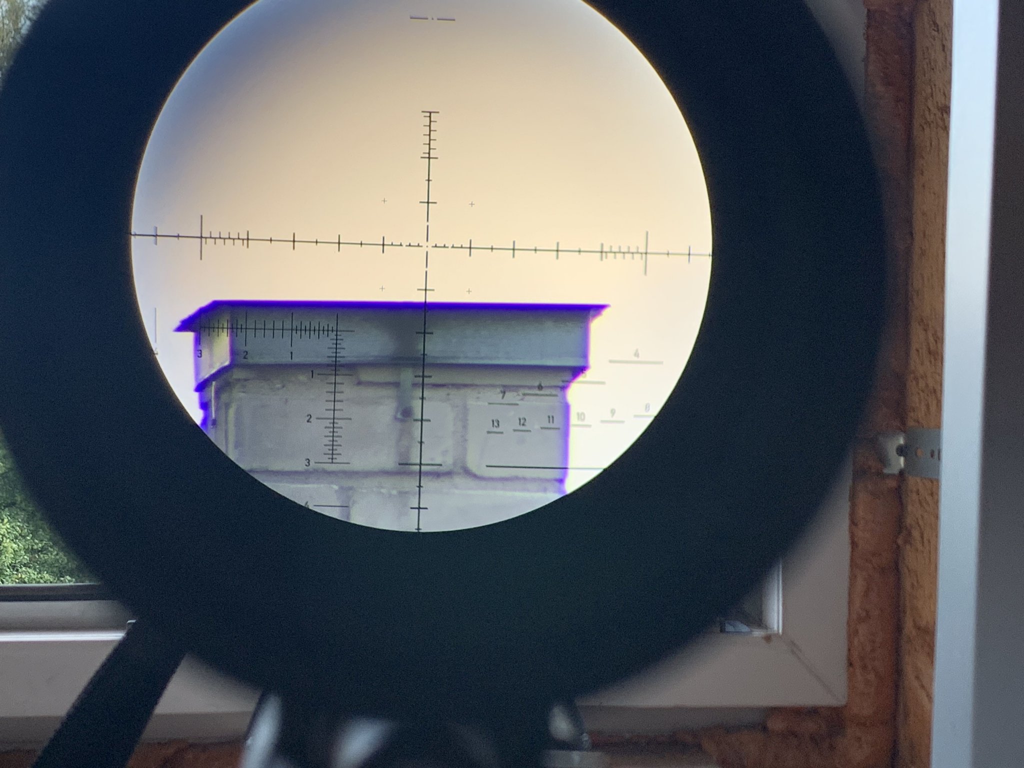

If my recollection is correct, it controls CA at high magnification better than M5Xi and K624i. It has similar amount of CA to K525i, but without the tunneling and with better depth of field.
Generally, I spent the last couple of days carefully looking at the optical performance of M7Xi and will do a video on that shortly. The gist of it is that based on the model I have, above 15x, M7Xi slots somewhere just below S&B, but above Kahles largely due to CA. Below 15x, M7Xi is almost as good as TT, Minox and ZCO. There is no tunneling, CA is not an issue and the scope is easy to get behind.
The turrets are definite step up from M5Xi in terms of feel. The scope is easy to get behind and it does offer the broadest magnification range here, so it is a very viable option. There is a nice feel to the image through this scope. Reasonable texture, good contrast, decent distortion control.
ILya
... I have only seen one sample of each, so I do not know for sure how representative these are. There is always some sample variation.
ILya

M5Xi had some of the same behavior as well, but M7Xi is better.
ILya
